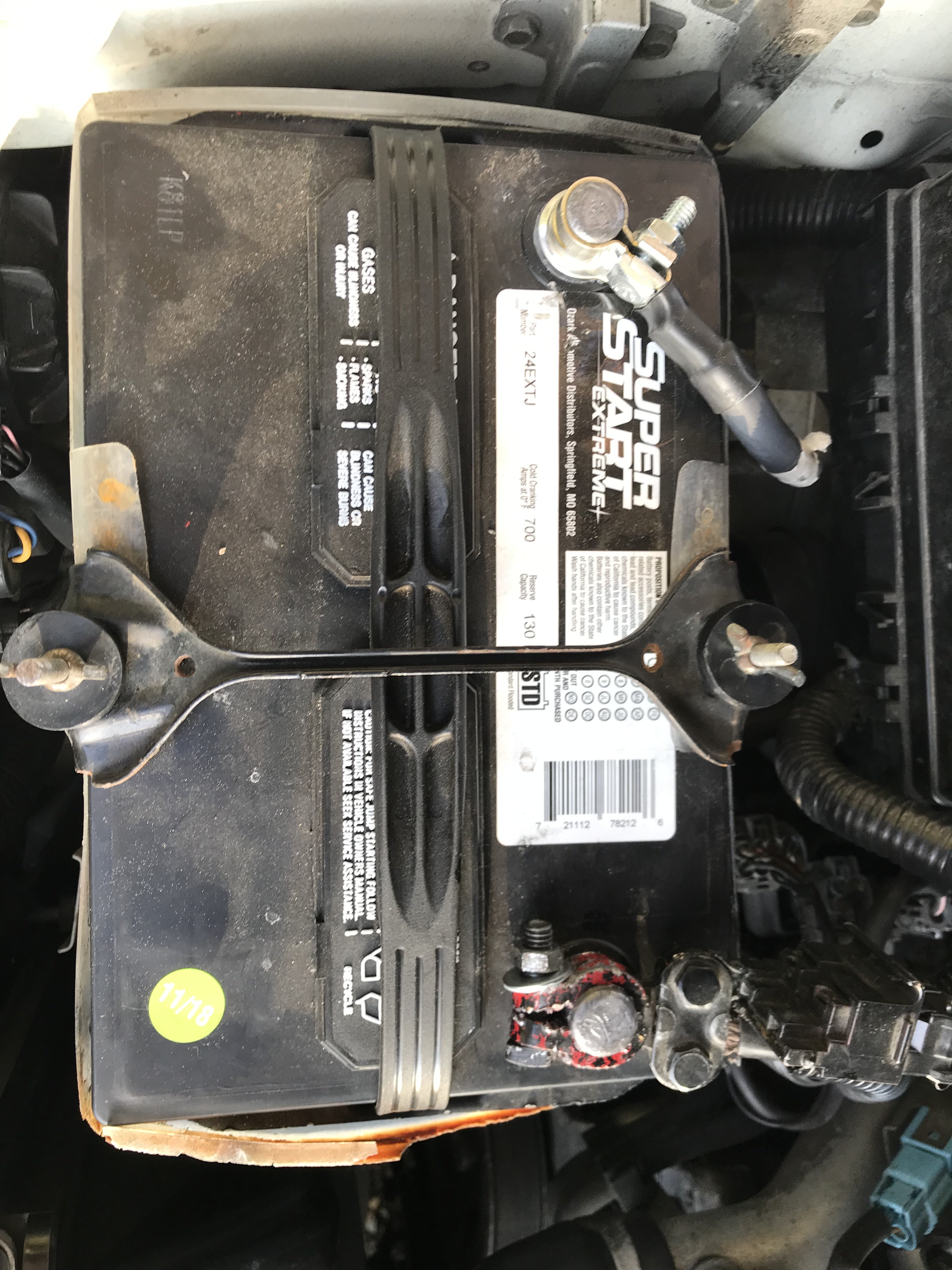

When I walked up on him he was pulling the battery, and I stopped him. We put a volt meter on it and it read 12V. The battery is some no name, with a tag stating made 10/18, 700 cranking amps.

I ordered a new grounding harness which runs from the negative battery terminal, has a 'Y' and an attachment point on the passenger's side fender. The strap continues then grounds to the right side of the engine.  I cleaned on the points of contact and installed the grounding wire.  Charged the battery overnight and installed it this afternoon.  Car will start, hard cranking and then has all the same symptoms.
Thinking of buying a new battery, but the fact it is only two years old and takes a charge gives me pause. Posting here as Furbird used to work in a Nissan shop, Oscar is an accomplished mechanic, and well this place is often a wealth of knowledge. 😃  I suspect it is some silly ground. I see evidence some critter chewed on the insulation under the hood, curious if it grabbed onto some grounding strap I may not be familiar with.

Everything you mentioned screams alternator or battery.  Instead of trying to find ground straps that are OE just add new ones with 10 gauge or 8 gauge.  Battery to block, battery to body, body to block.  But the gauges going batshit while the car is operating is tell-tale alternator failure.  Suck it up and buy the Nissan one.  I know of no aftermarket LOCAL source that makes an alternator worth a crap unless you can find someone to rebuild the OE one for you.  We replaced multiple aftermarket ones with OE ones and all the problems went away.

As I started reading my first thought was a bad connection, or maybe a fucked up battery.  Make sure the positive is clean, looks a bit questionable, and make sure the other end is also clean & tight.  Make sure that not only the terminal to battery post is clean, but also the cable where it's clamped to the terminal.  It looks like there's the bare cable and another terminal both clamped to the battery terminal, make sure both are clean.  The cable probably goes straight to the starter and if there is another connection there as it appears, that one feeds all the other stuff as well as probably feeding the charge current from the alternator to the battery.
A battery can take and hold a charge, but if you're only checking voltage it can be deceiving.  I've had plenty of batteries that held 12.5V+, but had little amperage capacity.  I've also had a few where the post had a broken connection and would give intermittent power, sometimes perfect and sometimes little to no amperage ability.

Thanks for the insights, I will try a battery I have in my shop tomorrow.
And I have no specific knowledge on that vehicle, just my general knowledge.  While it could be the alternator as Fur said, I'd say it's unlikely.  Or it has a bad alternator and a bad starter and some other shit....or just a bad battery or connection causing it all which is more likely.

The negative terminal is brand new and clamped onto wire brush cleaned off poles. Feels like you didn’t read my whole OP.  😁 I cleaning the positive pole and inside of positive clamp. I will take apart and clean the other parts upstream up from the positive pole. Great call out.

I would have suggested replacing or at least load testing the battery.  I’ve had them show good voltage but die under load.  That battery can be opened, and I’d not be surprised if the cells were less than 50% full of acid.

This reminds me: most places that sell batteries will test yours for free.  Only issue is that many use a handheld electronic tester that doesn't put a load on the battery.  While they're generally accurate, they can miss some faults.  The larger machines do the basic electronic diagnosis, then if they pass that it goes on to test while applying a load then a charge.  My handheld Midtronics tester has lied to me four times that I know of but the big $3000 Midtronics unit caught them.  Clearly the message here is that you should buy a $3000 machine so you can avoid potentially wasting $100 on a battery.

My vote is the battery, we had a similar problem with a VW, the battery tested ok but ok was not what was needed.

Another vote for the battery or a poor connection sucking power. My wife's car acted like it was possessed when battery voltage dropped a little low. Battery was still technically "good" but when it dropped a few tenths of a volt below optimal, shit started getting weird real quick.
