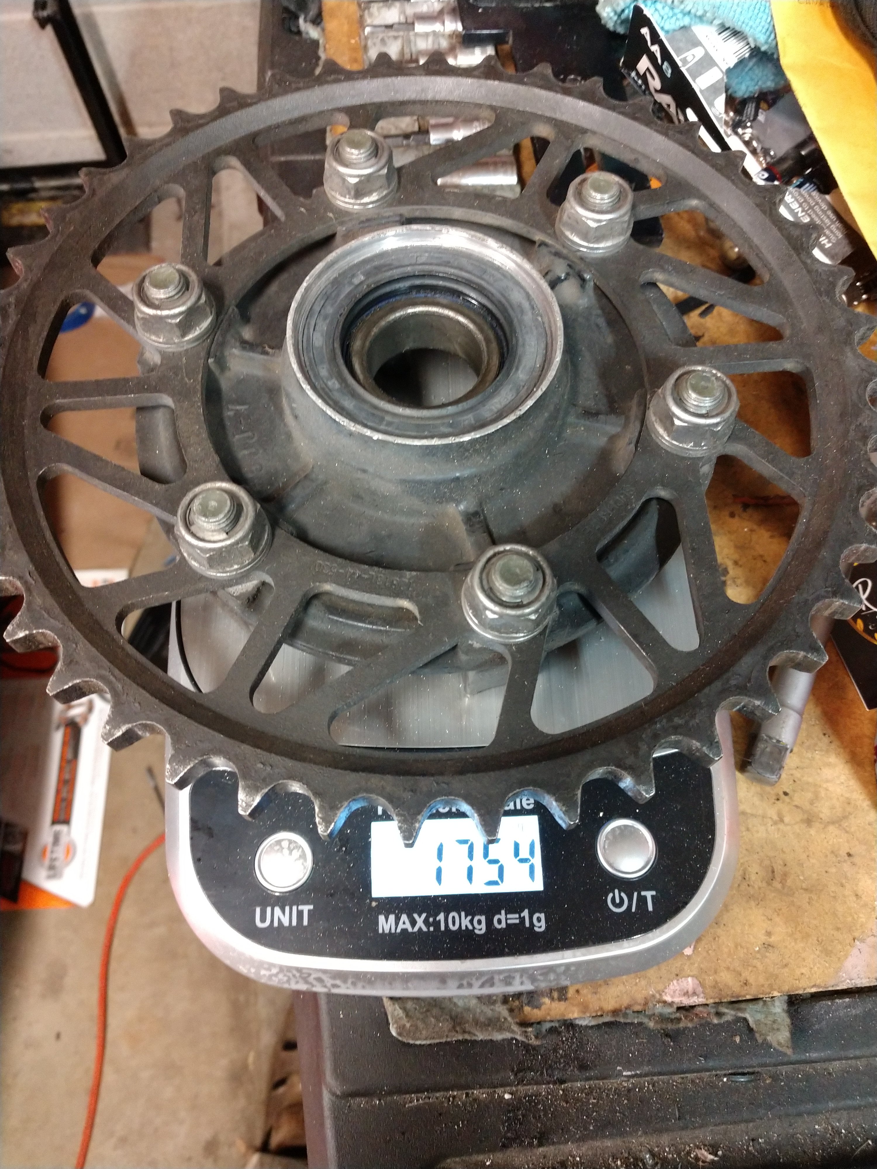

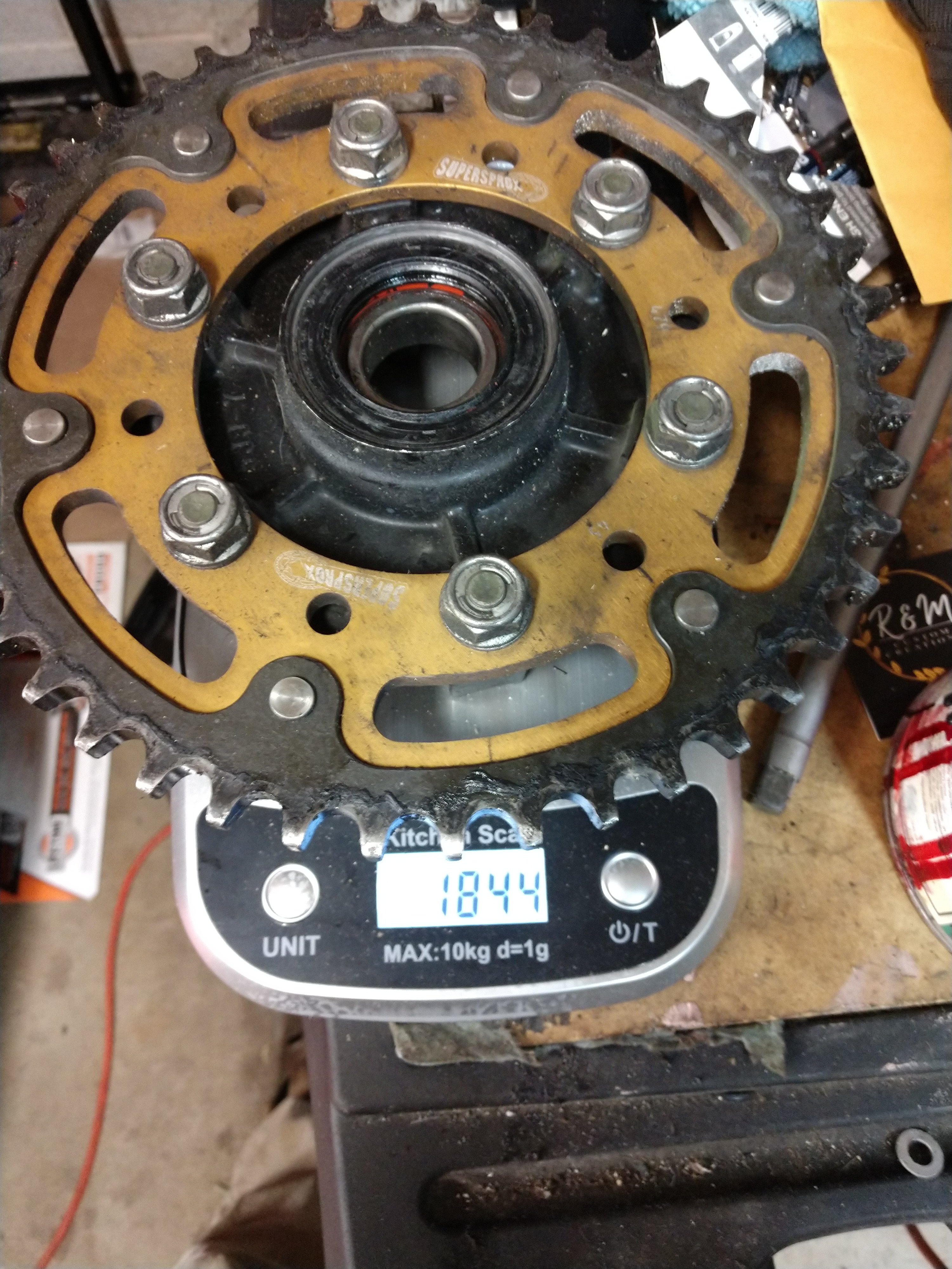

tomek Posted January 11, 2020 Posted January 11, 2020 (edited) Garage clean up today, I bumped into offending sprockets. It has taken a while, but promises made promises kept. Both weights are with oem carriers, 530 chain, 44 t, 2004 r1. As you can see that sprox alu/steel hybrid is 90 grams or 0.2 lbs heavier then steel Vortex ( I guess) sprocket. OEM was similar to steel one, but it was 45 t, can't find it anyway. If you take a look at nuts on both pics you can clearly see alu is much thicker in that area, and steel tooth ring overlaps aluminium center. That is why it is heavy like fuck, pretty retarded design IMHO. Some here owns me an apology. Edited January 11, 2020 by tomek Quote

tomek Posted January 13, 2020 Posted January 13, 2020 (edited) I only insult serial idiots. I simply don't have patience for proving 2+2=4, the wheel is round and other things of that nature over and over and over and over again. It gets old. Some people have bulletproofed learning ability. You doubt it lighter based on what ? Yesterday was the first time I actually put the aftermarket steel sprocket on the scale. I did remember from years ago that hybrid alu/steel was heavier then stocker hence I made that statement early in this thread. Anyway here is a pic of oem sprocket from the web. Does it look heavier then that steel aftermarket ? I don't think so. Edited January 13, 2020 by tomek Quote
jon haney Posted January 13, 2020 Posted January 13, 2020 (edited) 18 hours ago, tomek said: I only insult serial idiots. I simply don't have patience for proving 2+2=4, the wheel is round and other things of that nature over and over and over and over again. It gets old. Some people have bulletproofed learning ability. You doubt it lighter based on what ? Yesterday was the first time I actually put the aftermarket steel sprocket on the scale. I did remember from years ago that hybrid alu/steel was heavier then stocker hence I made that statement early in this thread. Anyway here is a pic of oem sprocket from the web. Does it look heavier then that steel aftermarket ? I don't think so. Definitely, but not by much. Look at the width of thicker steel under the teeth. Checking Ebay, it looks as though Super-sprox has upped their game, and has some all steel versions that look as light as the one you have. Edited January 13, 2020 by jon haney Quote

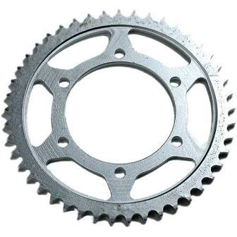

John01XX Posted January 14, 2020 Posted January 14, 2020 (edited) For clarification, back in 1999 thru 2003 the rear OEM sprocket was very heavy and had minimal cutouts. Below is a picture of the OEM rear sprocket I took off a 2000 Blackbird that I parted out a few years ago. Back in the day there was no skeleton steel rear sprockets available like there is today. The SuperSprox that many of us bought in a group buy headed up by Northman was a replacement for the OEM Kawasaki ZX12 as there were none made for the Bird at the time. Again at the time there was a big weight savings to go to the SuperSprox that probably is not the case today which would be a good reason that SuperSprox now makes light weight all steel sprockets that are also lighter than the original Alum/Steel sprockets. As stated the bling factor on my Red Bird with all gold accents was the deciding factor when it came time to replace my original SuperSprox alum/steel sprocket. Back in 2000/2003 the weight savings was significant when going to the alum/steel SuperSprox and it looked cool. The original OEM BlackBird rear sprockets were heavy, ugly and had minimal cutouts but they were strong. Edited January 14, 2020 by John01XX 1 Quote

jon haney Posted January 14, 2020 Posted January 14, 2020 4 hours ago, John01XX said: For clarification, back in 1999 thru 2003 the rear OEM sprocket was very heavy and had minimal cutouts. Below is a picture of the OEM rear sprocket I took off a 2000 Blackbird that I parted out a few years ago. Back in the day there was no skeleton steel rear sprockets available like there is today. The SuperSprox that many of us bought in a group buy headed up by Northman was a replacement for the OEM Kawasaki ZX12 as there were none made for the Bird at the time. Again at the time there was a big weight savings to go to the SuperSprox that probably is not the case today which would be a good reason that SuperSprox now makes light weight all steel sprockets that are also lighter than the original Alum/Steel sprockets. As stated the bling factor on my Red Bird with all gold accents was the deciding factor when it came time to replace my original SuperSprox alum/steel sprocket. Back in 2000/2003 the weight savings was significant when going to the alum/steel SuperSprox and it looked cool. The original OEM BlackBird rear sprockets were heavy, ugly and had minimal cutouts but they were strong. John, you sure that is factory? Neither of mine had 5 extra bolt-holes, and pretty certain the cut-outs were a little bigger than those. Quote
John01XX Posted January 15, 2020 Posted January 15, 2020 1 hour ago, jon haney said: John, you sure that is factory? Neither of mine had 5 extra bolt-holes, and pretty certain the cut-outs were a little bigger than those. I believe it had OEM numbers engraved but I could be mistaken. My original (2001) factory sprocket I thought had the small cut-outs like this but don't remember seeing additional (5) holes as pictured. Quote
tomek Posted January 15, 2020 Posted January 15, 2020 This is oem sprocket. If you are realize majority of weight comes from tooth ring, the fact that inner area is thicker in case of alu/steel hybrid, necessity of material overlap, weight of rivets there is no hell no way there are significant weight savings as John claims. John, you are full of shit and are not man enough to apologise. And everyone can see it. Quote
John01XX Posted January 15, 2020 Posted January 15, 2020 50 minutes ago, tomek said: This is oem sprocket. If you are realize majority of weight comes from tooth ring, the fact that inner area is thicker in case of alu/steel hybrid, necessity of material overlap, weight of rivets there is no hell no way there are significant weight savings as John claims. John, you are full of shit and are not man enough to apologise. And everyone can see it. WOW! You have some serious anger issues. So what is the weight of that so-called Blackbird OEM sprocket? Quote

John01XX Posted January 15, 2020 Posted January 15, 2020 6 hours ago, blackhawkxx said: I just looked at my OEM and the only thing on it is a 45 with a paint dot next to it. So I was mistaken. the 2000 model I parted out, that the picture came from, was possibly not the OEM as the owner claimed. I did sell it as OEM and it was installed on another Blackbird with no issues. The discussion here is about the weight of an OEM rear sprocket on 1999-2003 CBR1100XX’s verses the weight of an early model year SuperSprox alum/steel sprocket for a ZX12. Many of us bought them with Northman’s group buy for the purpose of reducing weight, if you have both, could you weigh them both up and post the results? Tomek keeps referring to R1 sprockets or Vortex skeleton sprockets to validate his claim that Blackbird OEM steel sprockets are lighter weight than a ZX12 alum/steel SuperSprox. If you disagree with Tomek then you are full of shit and if man enough must apologise! Quote

tomek Posted January 15, 2020 Posted January 15, 2020 6 hours ago, John01XX said: So I was mistaken. the 2000 model I parted out, that the picture came from, was possibly not the OEM as the owner claimed. I did sell it as OEM and it was installed on another Blackbird with no issues. The discussion here is about the weight of an OEM rear sprocket on 1999-2003 CBR1100XX’s verses the weight of an early model year SuperSprox alum/steel sprocket for a ZX12. Many of us bought them with Northman’s group buy for the purpose of reducing weight, if you have both, could you weigh them both up and post the results? Tomek keeps referring to R1 sprockets or Vortex skeleton sprockets to validate his claim that Blackbird OEM steel sprockets are lighter weight than a ZX12 alum/steel SuperSprox. If you disagree with Tomek then you are full of shit and if man enough must apologise! Should , could, I thought, yada, yada, blah. Anyone with basic clue about engineering will know know the truth. See to land ratio is not the only thing that matters. Supersprox is simply thicker everywhere other then tooth ring. It uses more material by volume, therefore significant weight savings are non-existent. I will find stock R1 sprocket and will make you look like a stubborn idiot. Again. Im out for now. Quote
