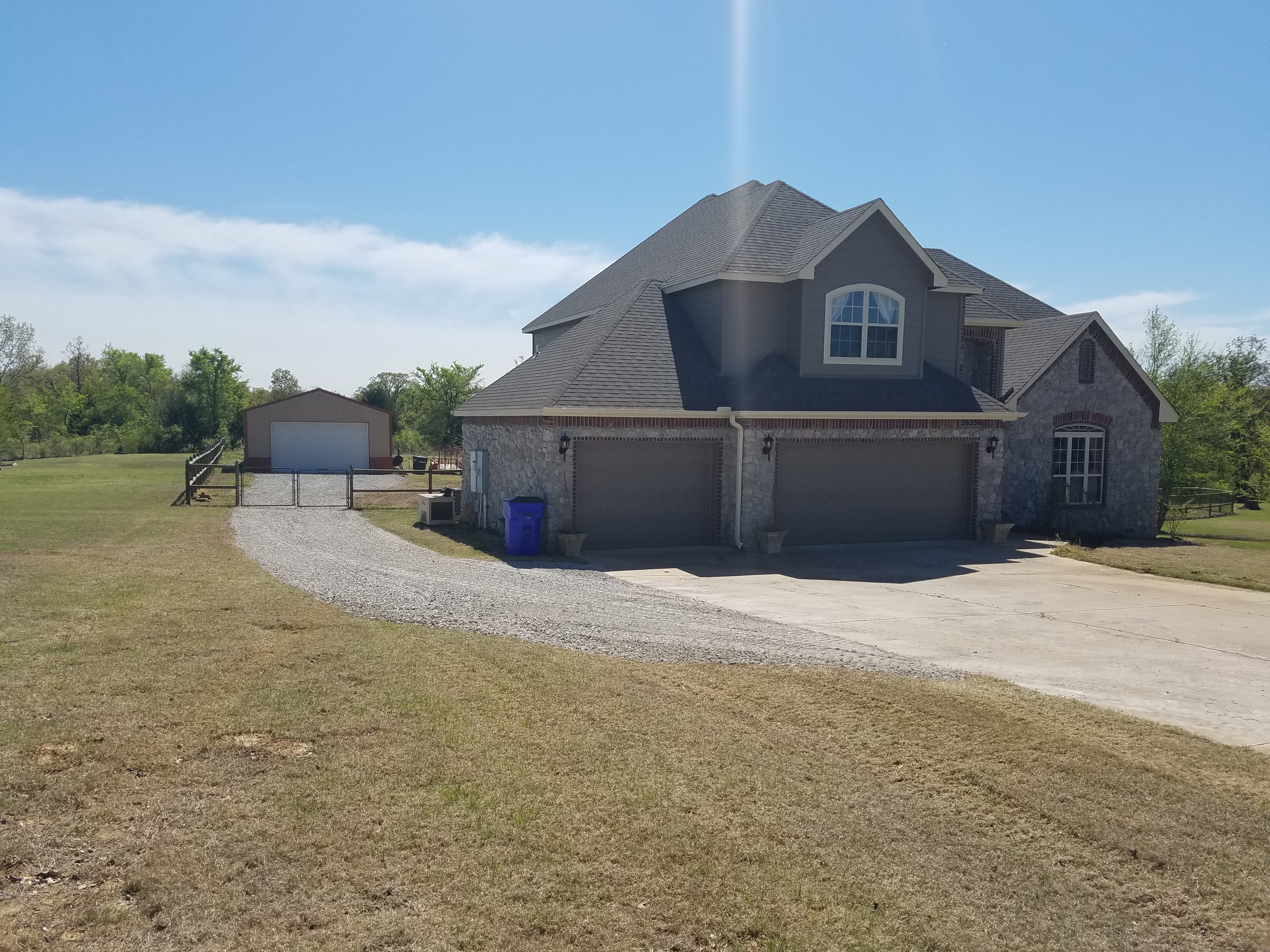

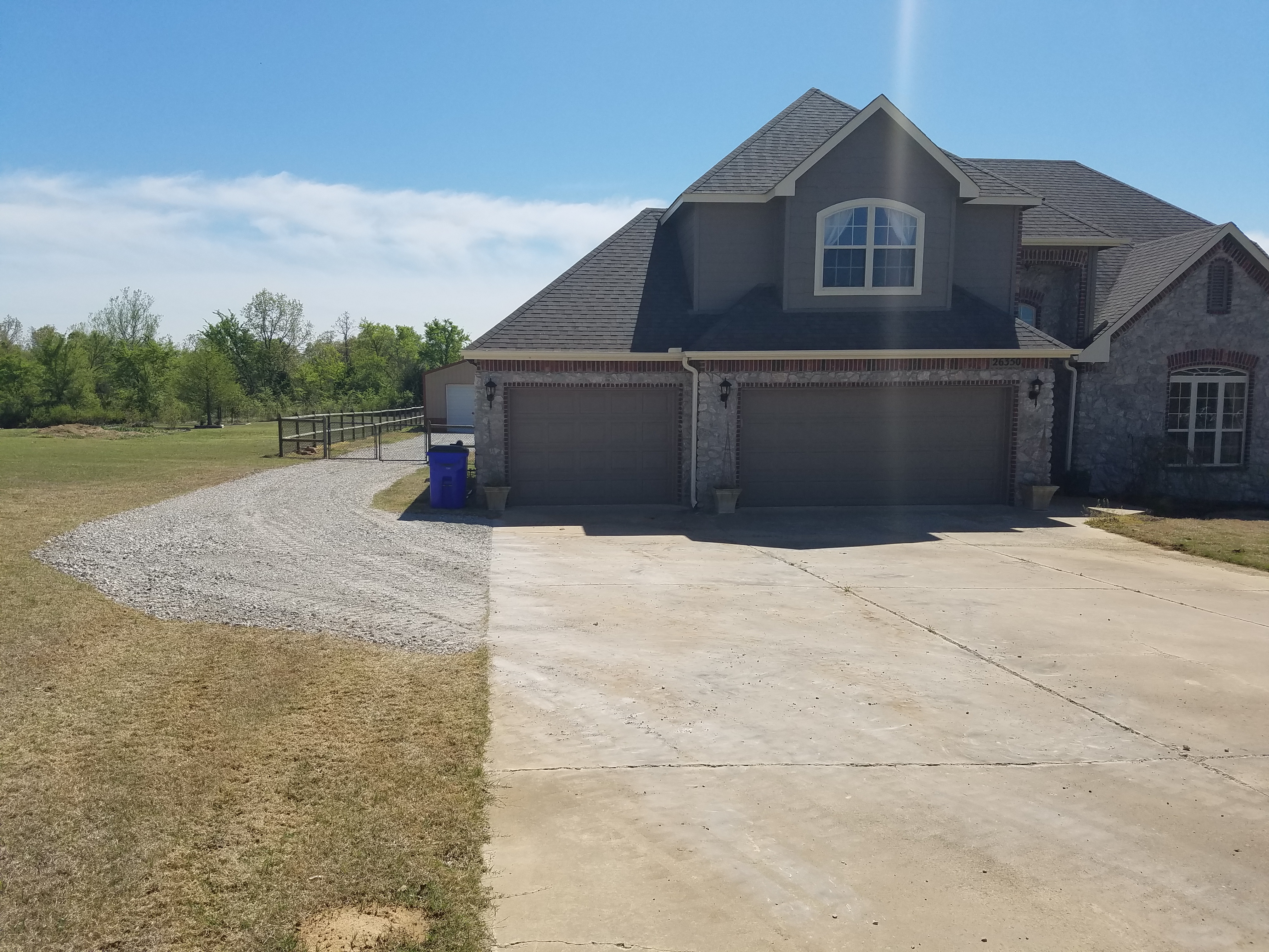

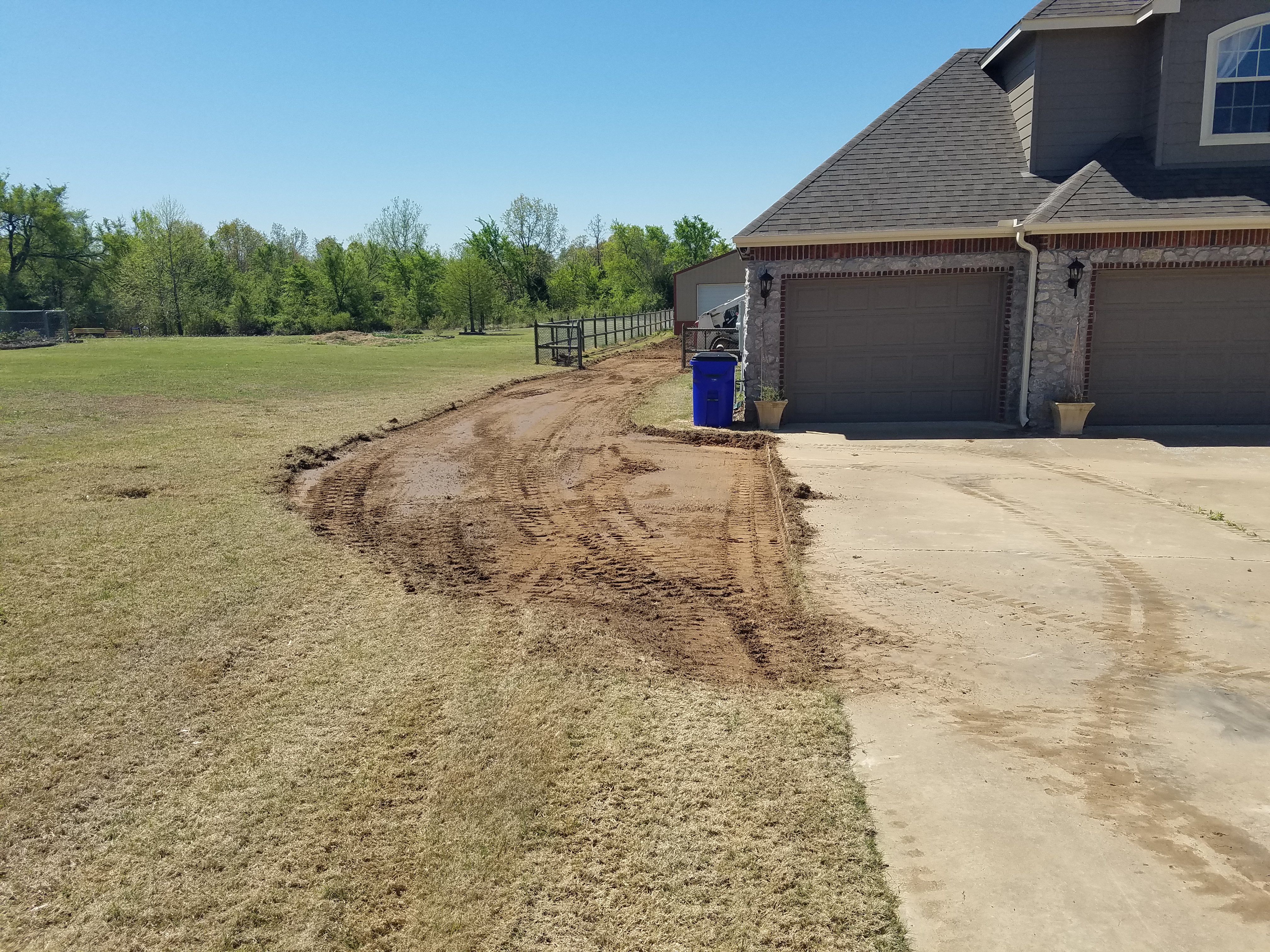

RichardCranium Posted March 2, 2017 Posted March 2, 2017 Best thing I ever paid someone else to do. I'll try to remember to post pics tomorrow. Right now I'm trying to get a server back up so I can go back to bed. Edit: Pics added. I wanted to do this for years. Wasn't quite sure how I wanted to do it. Finally just paid someone to do it and he did a great job. I think he used 2.5" but not sure. He used a skid steer for the whole thing. The attachment he used to to prepare the area for the gravel he called a soil conditioner. It basically just shaved a few inches of grass and topsoil off and then put the gravel down. He used the material he removed to create a slight berm to help direct runoff in the back. That made a huge difference with a swampy area on the other side of the yard. 1 Quote
