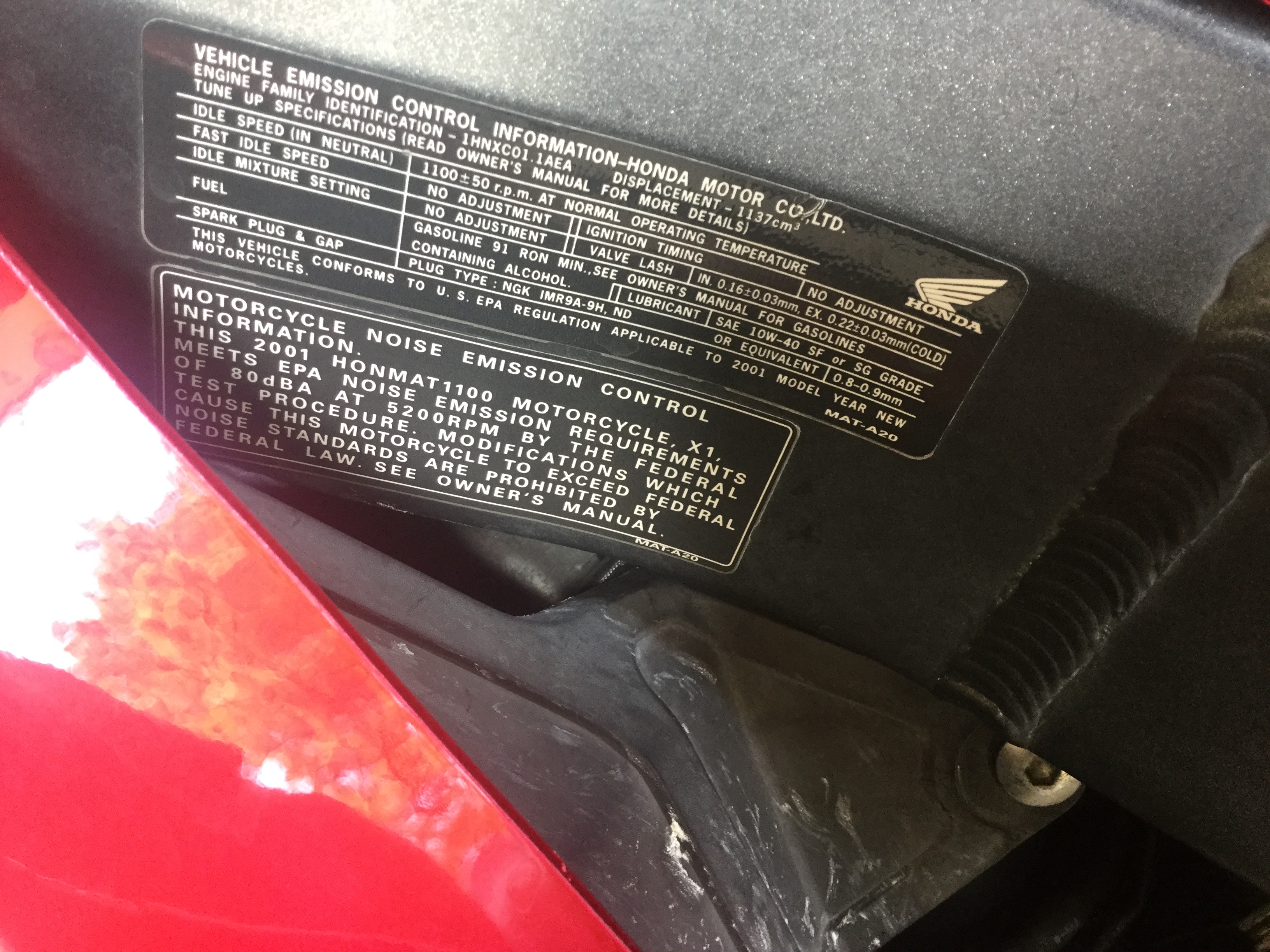

redxxrdr Posted July 3, 2016 Posted July 3, 2016 My 01 has no CAT, or evaporate canister. Purchased new in Georgia. My shop manual to 2003 shows evap canisters for California, but no CAT. Does the VIN plate show California or Canada like some cars do? Quote

redxxrdr Posted July 3, 2016 Posted July 3, 2016 (edited) None of those canisters that Shane showed in his thread on my bike. And my sticker doesn't say California either. And I googled, 91 RON is 87 octane US. Edited July 3, 2016 by redxxrdr Octane Quote

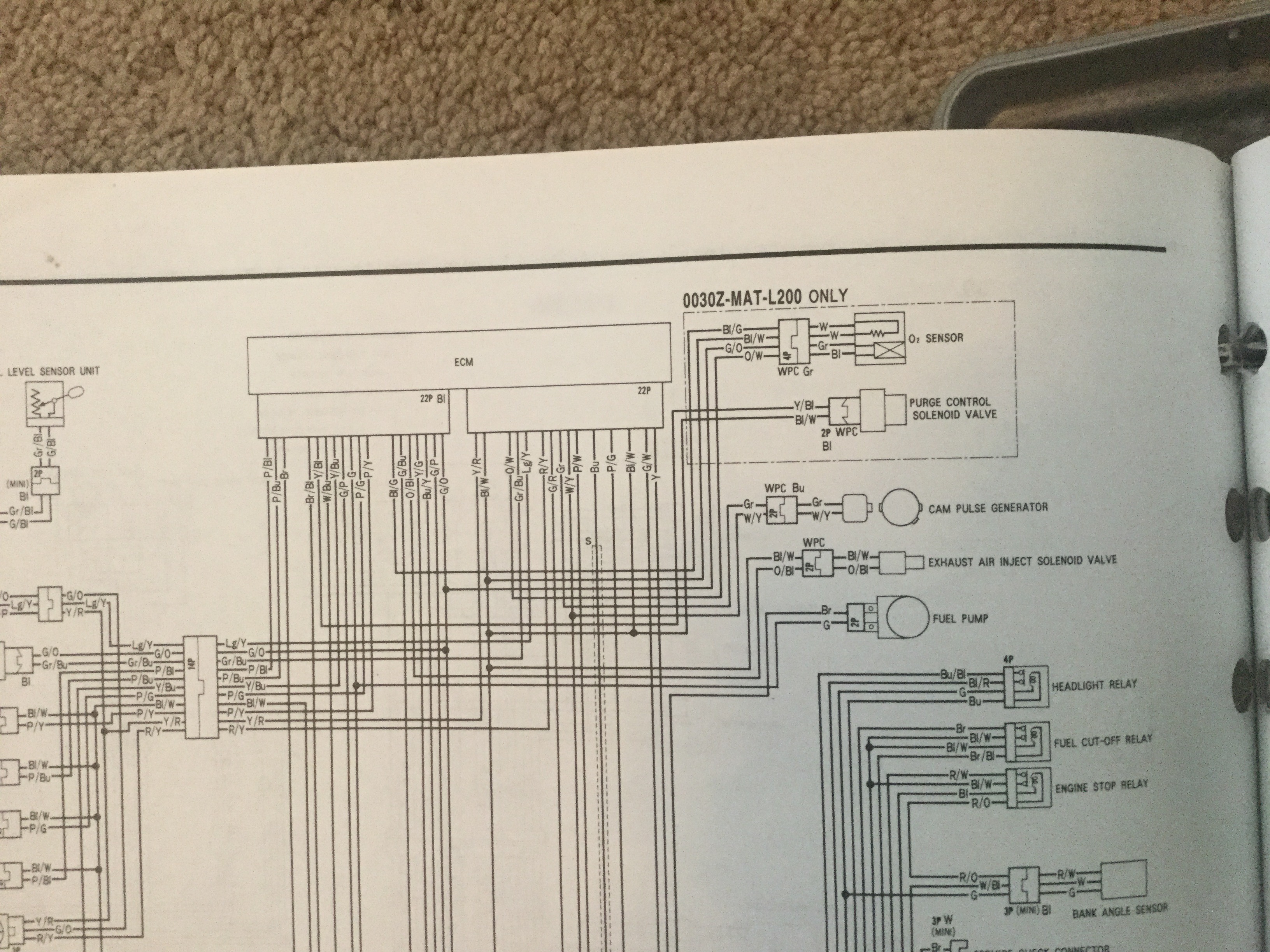

redxxrdr Posted July 3, 2016 Posted July 3, 2016 (edited) I looked at the schematic for the post 99. It looks like a 02 sensor is added for California. I know that O2 sensors are used to clean emissions on cars ( make them lean out), and they will really screw things up if they go bad. I wonder if you could swap ECM and disconnect WPC GR and feel a difference? Edited July 3, 2016 by redxxrdr Add word Quote

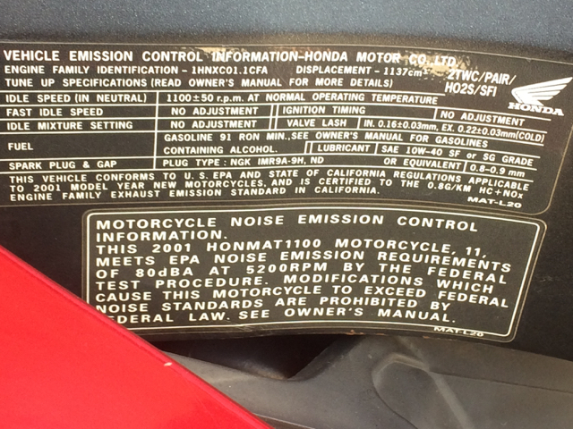

Hooplehead Posted July 3, 2016 Posted July 3, 2016 (edited) This is totally a California Model bike. States so on the sticker near the end. I had the evap can and solenoid with the extra tubing on the ports, tying all together. It also has the o2 and pair systems. From memory only, i recall the 97 being a hell of a lot smoother on the throttle with a lot more oompf. I run stock pipes always. I am getting about twice the mileage on the '02. I see near 40's on the '03 and was getting 22mpg or less on the 97. Always run hi-test non-ethanol in mine. So many variations on bikes because of changing import and emission policies. Hard to know what you are really getting, i suspect. The Fi bike runs a TON hotter on the legs than the '97 did. I suspect it is from increased backpressure in the exhaust from the emissions crap, or maybe i was running WAAY rich on the '97. The differances between models is NOT as slight as one would think at first glance. Everyone else seems a lot faster now on the roads, so BOTH birds seem slower in the year 2016, than they were in 2006. Fwiw, BLACK is the fastest color by far. Edited July 3, 2016 by Hooplehead Quote

superhawk996 Posted July 4, 2016 Posted July 4, 2016 8 hours ago, redxxrdr said: I looked at the schematic for the post 99. It looks like a 02 sensor is added for California. I know that O2 sensors are used to clean emissions on cars ( make them lean out), and they will really screw things up if they go bad. I wonder if you could swap ECM and disconnect WPC GR and feel a difference? I don't know what WPC GR is, but if you swapped in a non O2 computer it would obviously not be looking for an O2 reading. The O2 is only adjusting things at light load, once on the gas hard they go off-line and fueling is handled based on programming and O2 signal is ignored....as far as I know from everything I've read about anything with an O2 that wasn't a wideband O2 which the bird never had. Quote
