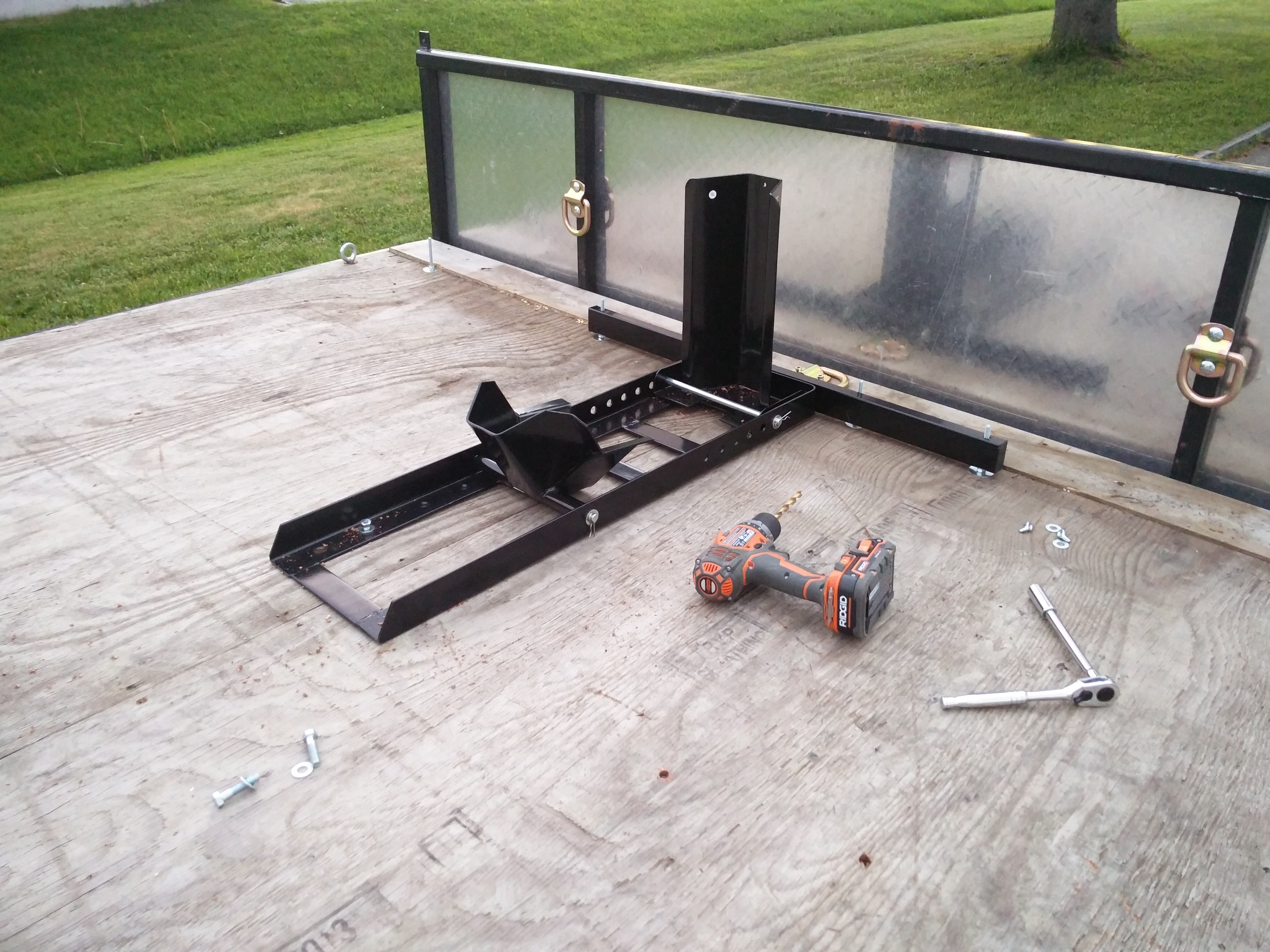

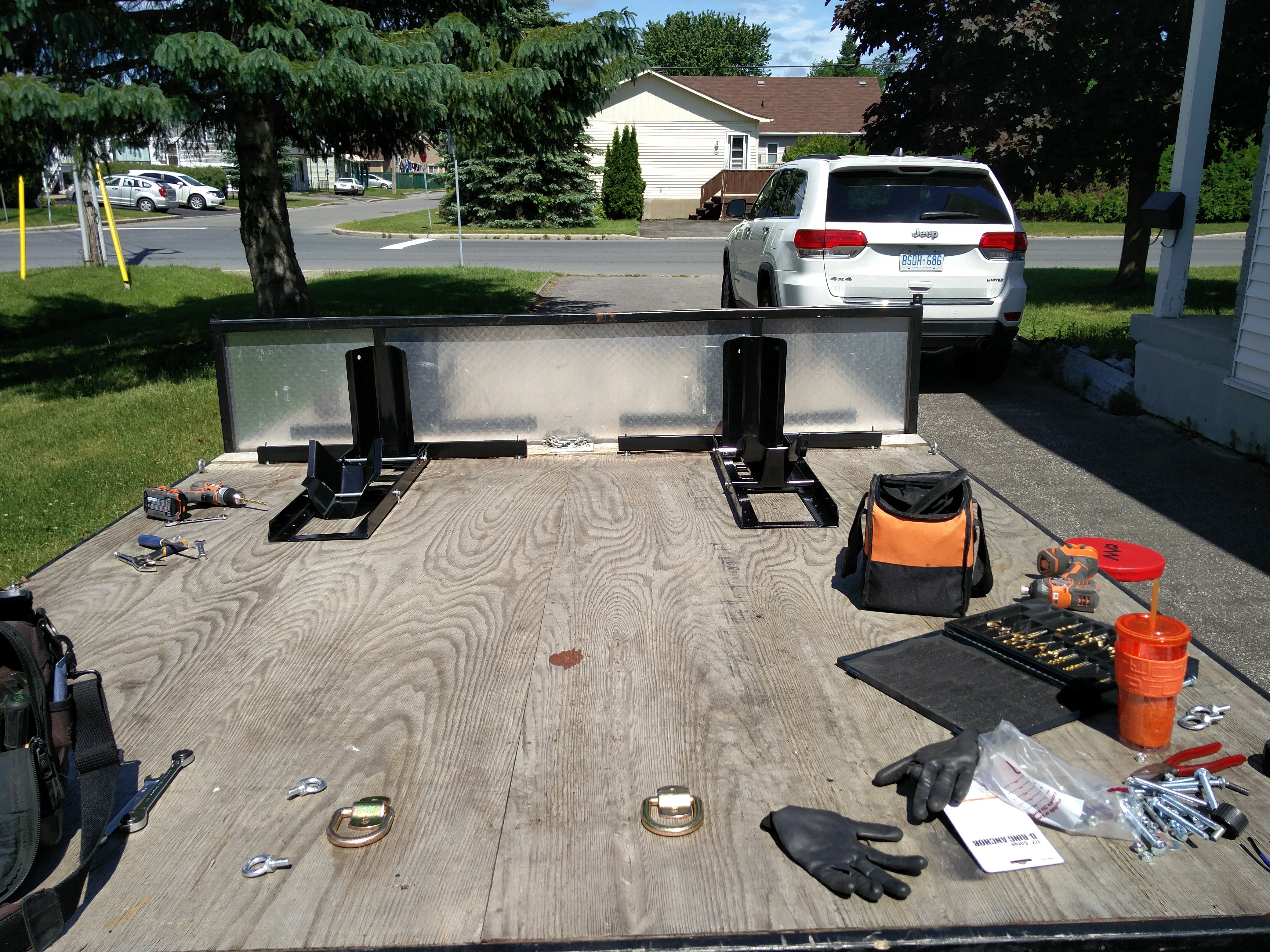

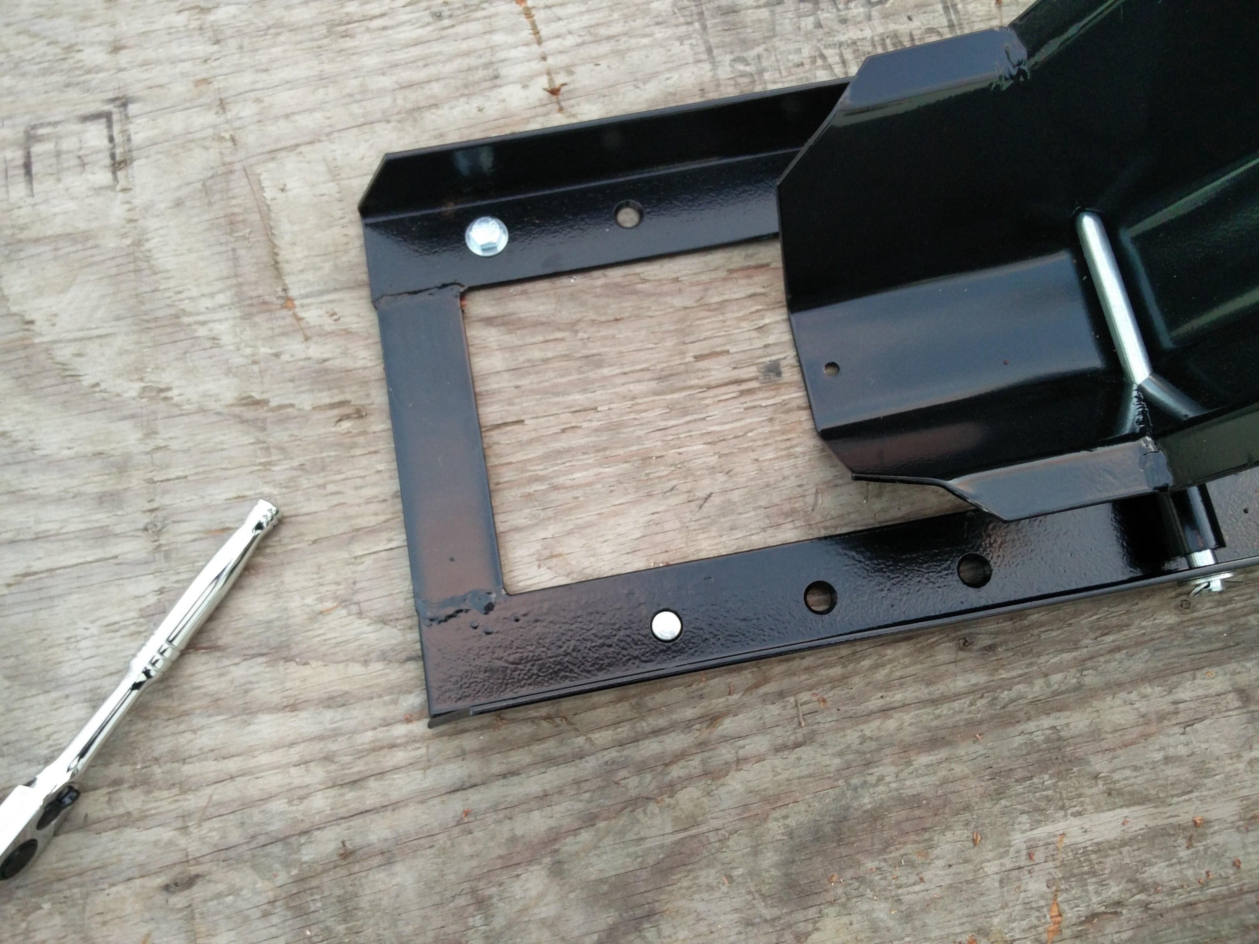

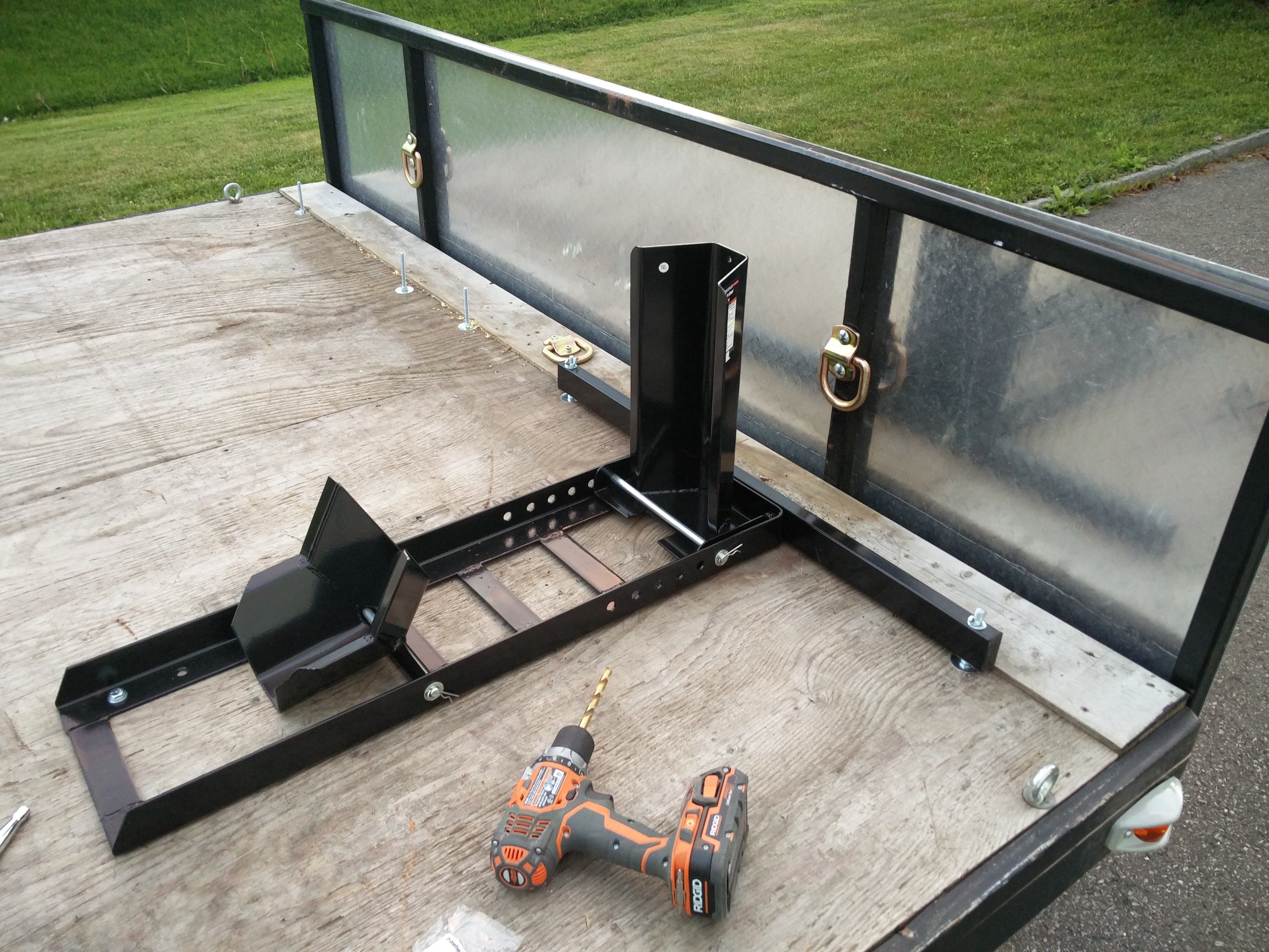

JoWhee Posted June 15, 2016 Posted June 15, 2016 (edited) So being a cheap bastard, I picked up an 8'x8' trailer. It was previously used to transport two snowmobiles. I've redone all the wiring and lights, and picked up two wheel chocks from Harbor Freight. I've run carriage bolts up through the floor and frame and I'll be using wing nuts to keep the front in place, I drilled out the threads on the chocks, to make installation & removal easier. At the back I'm using a clevis pin and a bolt with a bite in nut, I have no idea what they're really called. While measuring, I noticed that the two chocks aren't identical, the mounting holes at the rear are off between the two by about 1/8" , not enough of a difference for the pin, but enough that the bolt would go in cross threaded, so the two chocks aren't perfectly interchangeable, but it's no big deal. I may just use pins instead. As of now the trailer can be set up to transport one bike in the middle or two on either side. Not bad for a $500 trailer, $100 in chocks, and about $50 in hardware. PS Thanks to Ben, Mikey and Stefan for their help patience and advice. Edited June 15, 2016 by JoWhee 1 Quote
Mikey Posted June 15, 2016 Posted June 15, 2016 Now, put a mount in the centre for when you only have ONE bike on there. Quote
JoWhee Posted June 15, 2016 Author Posted June 15, 2016 Second last picture Mikey! it's modular, one or two, and if I was really keen I could probably get a third bike on there. Quote

superhawk996 Posted June 18, 2016 Posted June 18, 2016 There's no need to bolt it down at all four corners and with a bike on it no bolts/nuts are needed just something for them to hook onto. I would use just the studs at the front and add wing nuts only for empty transport to keep them from being able to bounce off. It's not a lot of work to swap them so I get it, just suggesting it could be even easier. 1 Quote
xrated Posted June 18, 2016 Posted June 18, 2016 When I installed the Baxley wheel chocks in the floor of my trailer, I put the chocks were I need them and drilled the holes in the floor. Then I put carriage bolts up through the holes from the bottom of the trailer and nutted them on the inside. The Baxley chocks sit down over the top of the "studs" sticking up through the floor and then they are secured with "wing nuts". That makes them easily removeable if needed.....like for a chock in the paddock. Quote

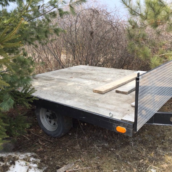

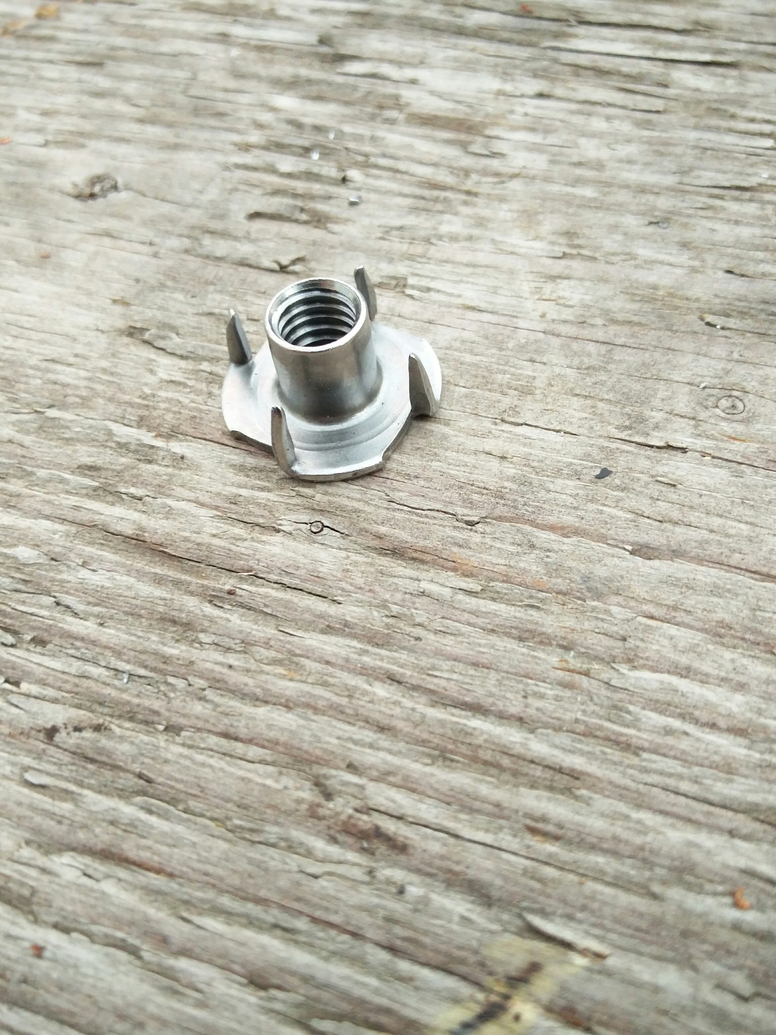

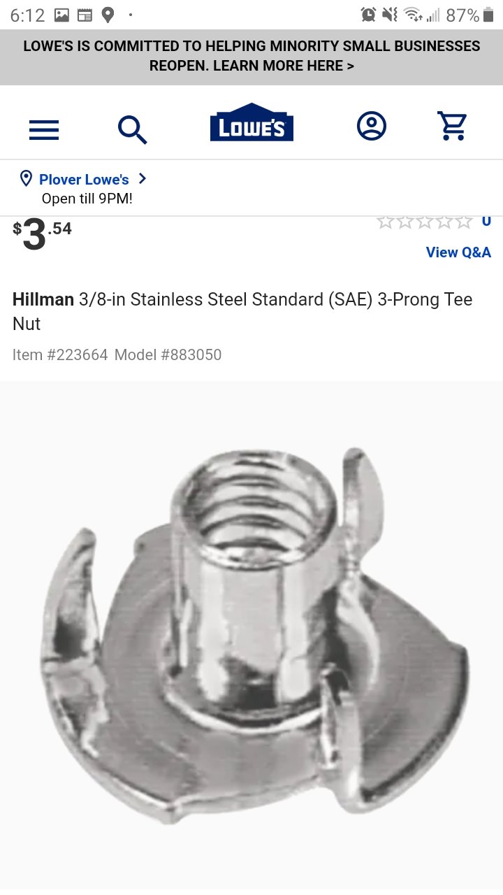

JoWhee Posted July 14, 2020 Author Posted July 14, 2020 48 minutes ago, XXitanium said: That's exactly what I used, however they were "hooked" into some large pieces of oak I had glued and screwed to the underside of the trailer for more strength. Again, operation overkill. Quote
XXitanium Posted July 14, 2020 Posted July 14, 2020 Twenty bucks worth of oak to protect expensive machinery seems legit. Quote
JoWhee Posted July 14, 2020 Author Posted July 14, 2020 Yes and no, it was a large scrap, more to use as a "washer" than anything else. If the trailer floor had been made from 2x10" I'd have just used the prong nuts. The prong nuts were more for keeping the rear of the chock from moving which would have been difficult since the front was bolted down. Quote
