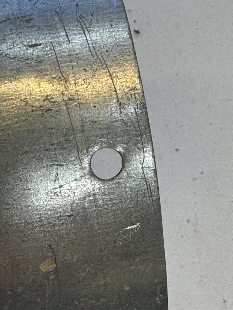

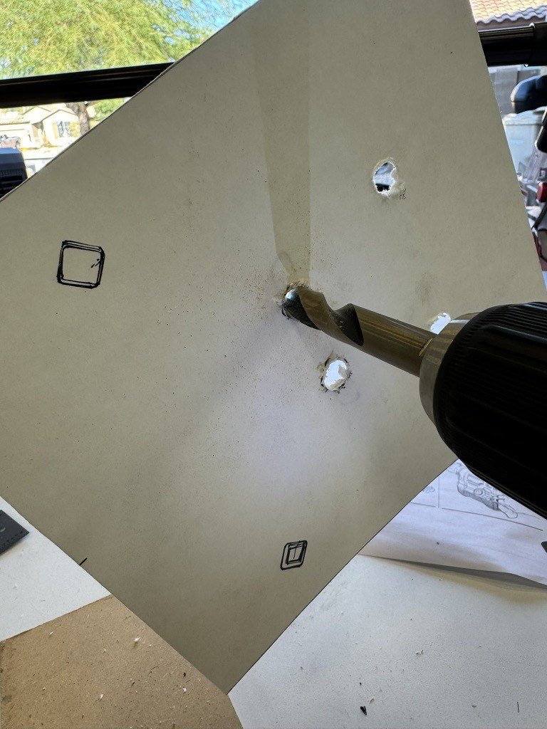

SwampNut Posted October 23, 2023 Posted October 23, 2023 http://www.norsemandrill.com/Vortex-Point-Mechanics.php Pretty much a miracle drill bit. They can cut in anything with zero drama. You don't get fucked up holes in sheet metal, no plastic cracking or rough edges, steel doesn't need pre-drilling, and it cuts stupid things like cardboard. Which sounds dumb, but I use cardboard for templates regularly and want to have good holes in it. And likewise, for durable/reusable templates, I like thin plastic, but regular bits often catch. Wood doesn't push out and splinter off the back side. Etc etc, so many benefits. I bought the largest kit, 29pc. Ultra Dex Mechanics Length Set, and am glad I did. I reach for those middle-size bits all the time. A little extra fastener clearance for tolerance issues, or drilling for metrics and finding that they are not matched to the normal SAE sizes. Just get it. @IcePrick shows up at my house one day, sees them, and says he just bought a set. Hope he adds his thoughts on them here. Unsupported hole in 26 gauge, just free air drilling. Quote
