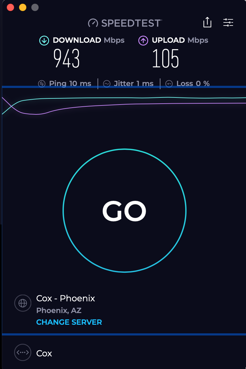

SwampNut Posted July 24, 2023 Posted July 24, 2023 These are very good numbers on our cable, but you really should see latency below 50, well below, and jitter over 20 makes voice useless. Quote

SwampNut Posted July 24, 2023 Posted July 24, 2023 Ah, right, Hughes blows. You need Starlink. That makes the jitter numbers irrelevant outside the network. Normal jitter? Well, voice has problems above 20, and I would be skullfucking someone at my ISP if it hit 10. On your LAN it should approach 0. Are the 5 and 2.4 bands separate, as in, they are two networks you join individually? These days a modern access point uses them together with seamless transitioning to assure better connections. Why do you have a guest network? That eats CPU time, which low end routers have little of. I'll look at the docs shortly. Quote
