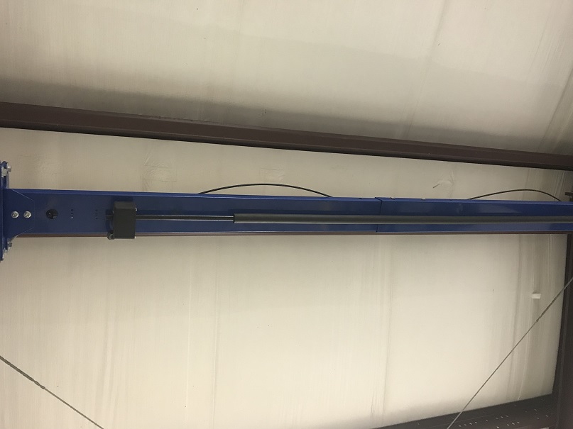

Furbird Posted July 31 Share Posted July 31 Forward DP10A****, overhead bar, asymmetrical. I don't know the science behind the overhead bar/structural rigidity argument but it is my understanding that the towers weigh less vs a bottom bar so the overhead bar is designed to connect the towers as part of the structure. The overhead bar also carries the cables and the hoses that connect both sides together to allow them to work in unison for both lift/lower and the locking mechanism, so you can't just not install it. If I can find the installation manual I'll see what it says. Like you, I didn't want anything on the floor so an overhead bar was the way to go. Plus it has the stop switch to prevent anything from hitting it and the only thing that has tripped it was the roof rack on the Astro so now I know where to stop that vehicle before it gets that high (it's about one click before max height anyway, no big loss.) Symmetrical vs asymmetrical, almost everybody uses an asymmetrical lift unless they are exclusively lifting LWB fullsize trucks. Reason is it allows you to offset the vehicle to the rear so you can get out of it. This is why I ALWAYS tell everybody to get the widest drive-thru lift you can find (and why I went with the Forward) and why almost everybody goes with asymmetrical. There's nothing that's been in my shop that you can't open the door on. As I've said before, my 2500HD has tow mirrors and I don't even have to fold them in. The more stages on the arms, the more adjustment you have, and the more vehicles they fit. They also sit lower to the ground if you're not a big fan of lifting on pinch welds (like me) so you can swing under the vehicle to get to structure. My Forward is a previous generation than what's out there now, so it came with the extended height, truck adapters, etc. which are all add-ons now. It's made by Rotary. If you have a problem with a dirty shop, get over it, ain't nobody got time for that. This is a broom surface concrete finish, ain't no damn museum. That oil spot is courtesy of John Deere circa 3 hours ago. Quote Link to comment Share on other sites More sharing options...

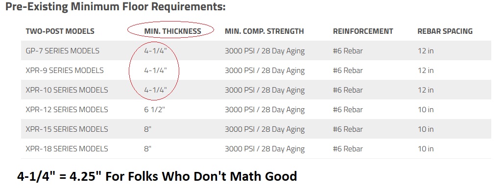

Furbird Posted August 3 Share Posted August 3 Since he's building a shop from the ground up, the entire slab only needs to be 4.25+. If you were cutting into the existing floor to pour a pad, that's when it has to be super deep. The load is spread across a lot more floor than your think. My floor was 4.5+ because any lift installer checks the slab before they install it, otherwise they won't install it due to the liability. https://www.bendpak.com/car-lifts/concrete-floor-requirements/ Quote Link to comment Share on other sites More sharing options...
superhawk996 Posted August 3 Share Posted August 3 29 minutes ago, Furbird said: Since he's building a shop from the ground up, the entire slab only needs to be 4.25+. If you were cutting into the existing floor to pour a pad, that's when it has to be super deep. The load is spread across a lot more floor than your think. My floor was 4.5+ because any lift installer checks the slab before they install it, otherwise they won't install it due to the liability. https://www.bendpak.com/car-lifts/concrete-floor-requirements/ Where does Bendpak, or any other manufacturer, show different concrete requirements for "entire slab" vs. a cut and pour pad? Quote Link to comment Share on other sites More sharing options...
superhawk996 Posted August 3 Share Posted August 3 46 minutes ago, Furbird said: Since he's building a shop from the ground up, the entire slab only needs to be 4.25+. If you were cutting into the existing floor to pour a pad, that's when it has to be super deep. The load is spread across a lot more floor than your think. My floor was 4.5+ because any lift installer checks the slab before they install it, otherwise they won't install it due to the liability. https://www.bendpak.com/car-lifts/concrete-floor-requirements/ Where in that link does it show that an "entire slab" can be thinner than the stated minimum requirement of a particular lift? As far as a cut and pour pad, they show much higher requirements because they're allowing for a very small slabs. Quote Link to comment Share on other sites More sharing options...

Furbird Posted August 3 Share Posted August 3 Oscar, if you read it you would see that it is explaining what you have to do very clearly. If the floor is not of even thickness and reinforced then you have to build a large enough reinforced pad to support the lift and all the weight it is holding, plus it has to prevent tipping/shear and a lot of other factors. Here is a video showing what this guy had to do (it's shown in the first two minutes.) I've said it before and I'll say it again; buy once, cry once. You install this fucking thing wrong, you're dead. I had my entire building designed for lifts, not built a building then decided to put a lift in later. That's also why I had it permitted. They couldn't do jack shit until it was signed off on. Quote Link to comment Share on other sites More sharing options...
superhawk996 Posted August 4 Share Posted August 4 2 hours ago, Furbird said: Oscar, if you read it you would see that it is explaining what you have to do very clearly. If the floor is not of even thickness and reinforced then you have to build a large enough reinforced pad to support the lift and all the weight it is holding, plus it has to prevent tipping/shear and a lot of other factors. Here is a video showing what this guy had to do (it's shown in the first two minutes.) I've said it before and I'll say it again; buy once, cry once. You install this fucking thing wrong, you're dead. I had my entire building designed for lifts, not built a building then decided to put a lift in later. That's also why I had it permitted. They couldn't do jack shit until it was signed off on. You said that an existing floor only needs to be 4.25+. The lowest requirement for an existing floor is 4.5" and it goes up to 8", all depending on which model lift is being installed. So again, show me where it says that 4.25+ is all that's needed. Quote Link to comment Share on other sites More sharing options...
Furbird Posted August 4 Share Posted August 4 https://www.warbyparker.com/ Quote Link to comment Share on other sites More sharing options...
superhawk996 Posted August 4 Share Posted August 4 10 hours ago, Furbird said: https://www.warbyparker.com/ Yes, I was thinking of a different brand's list, you're correct that 4.25 will cover some lifts. It's still incorrect to say "all he needs is 4.25". Especially when there are requirements beyond the thickness. And with that I'm done poluting Joe's thread, it's pointless now since his slab is done. Quote Link to comment Share on other sites More sharing options...

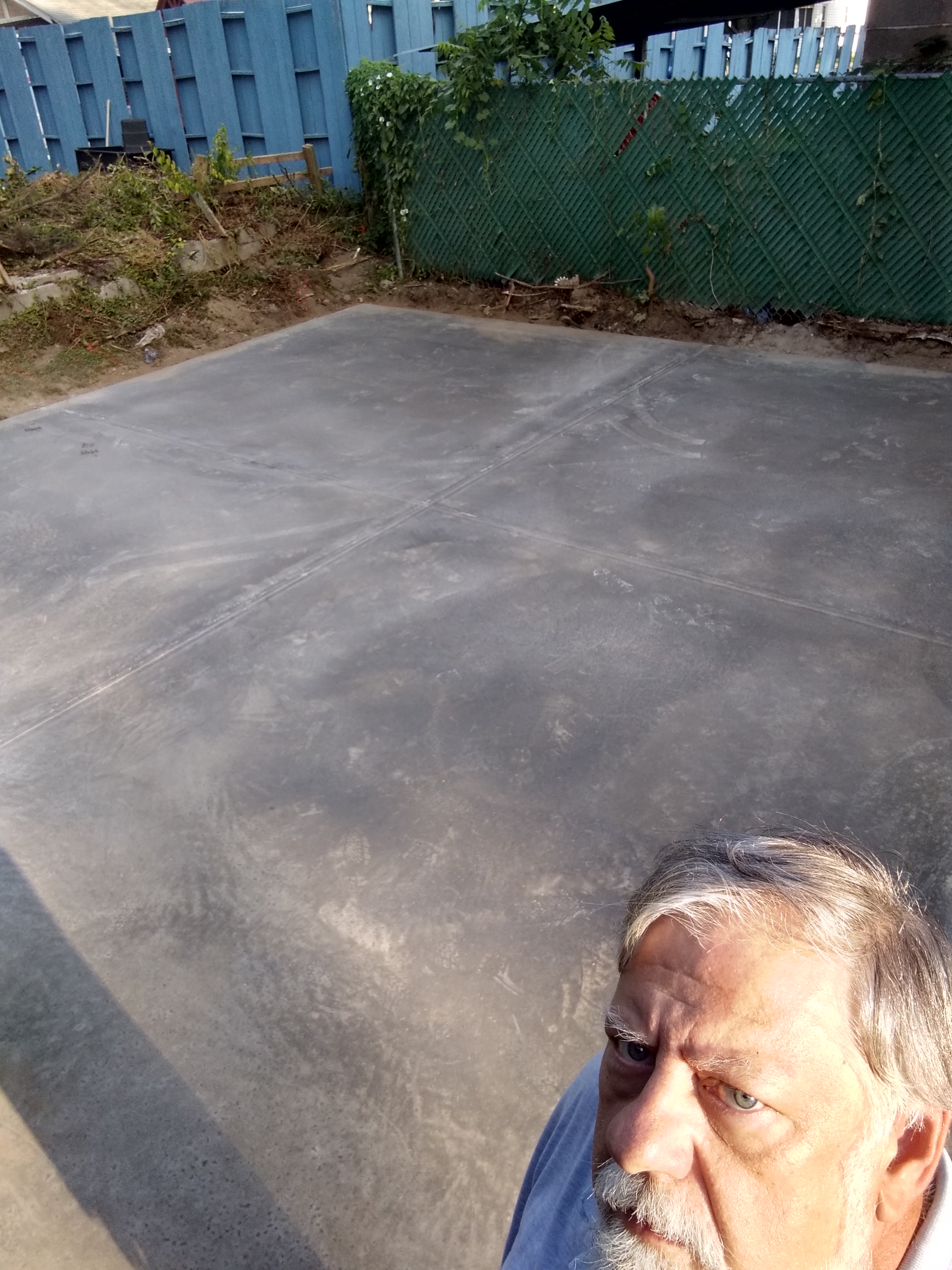

rockmeupto125 Posted August 4 Author Share Posted August 4 24x24, 11 yards. 40 tons of slab ought to hold it. Quote Link to comment Share on other sites More sharing options...
Furbird Posted August 4 Share Posted August 4 As long as it's reinforced. If it's just straight concrete, umm... Please tell me it's not straight concrete. Quote Link to comment Share on other sites More sharing options...
XXitanium Posted August 4 Share Posted August 4 2 hours ago, rockmeupto125 said: 24x24, 11 yards. 40 tons of slab ought to hold it. Back when I used to do maths that's 6.188 in Quote Link to comment Share on other sites More sharing options...
blackhawkxx Posted August 5 Share Posted August 5 12 hours ago, Furbird said: Please tell me it's not straight concrete. It doesn't look gay to me. 1 Quote Link to comment Share on other sites More sharing options...
rockmeupto125 Posted August 5 Author Share Posted August 5 Well, it's concrete, but it identifies as stucco. You know, like that guy that wins all the women's swimming championships. it's 3500psi fiber reinforced concrete. I should have had them put dye in it. Can't cry over poured concrete. It's thicker at the perimeter and under the area for the lift. Minimum thickness is 4-4.5 inches. There's mesh in the lift area. I have no idea what the air mix was or the thermomagnetic coefficient of the mesh, Lowes didn't have the MSDS for it. Quote Link to comment Share on other sites More sharing options...
