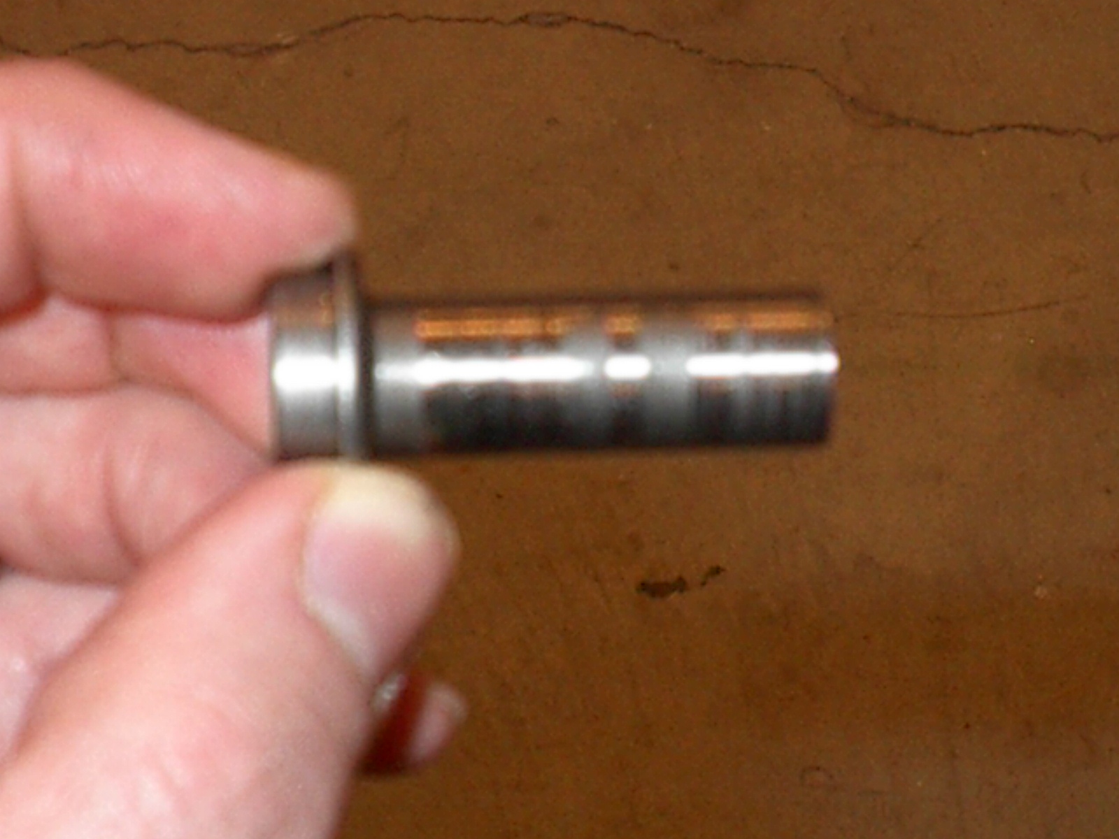

silverbird1100 Posted November 15, 2007 Share Posted November 15, 2007 That rattling noise you get from the clutch while the bike is idleling in nuetral is getting really loud, much worse than when it was new. When warming it up that brief period when the auto choke is done doing it's thing and the bike is still too cold to idle normally, there's a nasty crackling (not the normal rattle) noise that can be felt through the seat, goes away when you pull the clutch in (of course) but is this normal when the clutch is out? Basically the lower the RMP, the worse it gets. Bike has 40K. Quote Link to comment Share on other sites More sharing options...

silverbird1100 Posted November 17, 2007 Author Share Posted November 17, 2007 Yes it's an FI model. I just found some burrs on the clutch rod, the short one right that comes right out Quote Link to comment Share on other sites More sharing options...

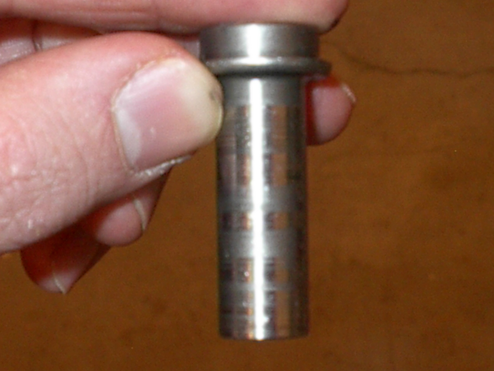

silverbird1100 Posted November 18, 2007 Author Share Posted November 18, 2007 Uh this is bad... The inside of where this was scraping I was able to smooth out but why did this happen and what's to say it won't happen with the new one. Again, the noise was loudest at low RPM in Nuetral, pull the clutch in and it stopped. Clutch rod looks ok, and the inner clutch spins fine. Other than the burrs on the pin and inner shaft, I can't figure out what's happening. Shiftes like crap too. Quote Link to comment Share on other sites More sharing options...
cbrxxquad Posted November 18, 2007 Share Posted November 18, 2007 the short one that comes right out....... now that don't sound right. the clutch rod is three piece made form pieces of different material pressed together. one is aluminum and has a short hard steel end on one end and the other end has a longer hardended steel piece. It should all be together. the long steel end is in the area of the sproket and goes into the clutch slave. If I am getting what you are saying you may have a bad rod and maybe some things bad in the shaft that are the problem. If the rod turns with the shaft it will turn in the clutch slave and that is not good. Will heat the fluid up and clutch master and fluid will have problems. The piece you are showing is in a bearing and that is what will let the rod stay stationary while the shaft the clutch is mounted turns. But the clutch rod is one piece,,,,,,,is yours? Quote Link to comment Share on other sites More sharing options...
tomek Posted November 18, 2007 Share Posted November 18, 2007 That bearing between pictured part and pressure plate,,,is it in good condition ? Side wear marks on that piece ( clutch joint ?),it seems that it spins too much with the clutch on ,I guess that is why it drags,,,,Pure speculation on my part ,I`ve never taken XX clutch a part. Quote Link to comment Share on other sites More sharing options...
silverbird1100 Posted November 19, 2007 Author Share Posted November 19, 2007 the short one that comes right out....... Is the one in picture that is damages, it's called the clutch joint, my bad. Other than the burrs on the inside of the drive shaft EVERY thing else looks and operates fine, including the bearings. The only thing I can think of was cleaning the clutch joint and not re-greasing the outer side of it. Quote Link to comment Share on other sites More sharing options...
CxBXR Posted November 19, 2007 Share Posted November 19, 2007 The pics need to be resized, when I click to enlarge them they get blury & cannot see detail information. If the burrs are too deep I would replace the part before re-installing. You might want to take a look at the inside of the clutch boss, it is cast aluminum & will damage easily, make sure the bearing is properly seated, or you may have to replace the clutch boss. Quote Link to comment Share on other sites More sharing options...
silverbird1100 Posted November 19, 2007 Author Share Posted November 19, 2007 I've already ordered the clutch joint, and de-burred the inside, I'm just trying to understand how to not let it happen again. If that piece way dry, when I inspected the clutch last year would that be enough? Sorry my camera sucks, the first pic is better and is just showing that there's some grinding going on, not the good kind unfortunatly. Quote Link to comment Share on other sites More sharing options...

CxBXR Posted November 20, 2007 Share Posted November 20, 2007 Low level engine oil could have caused it, by not allowing proper lube. to the clutch component's. Very bad for any engine component. Have you been checking you oil level regularly ? I dont think the oil pump is to blame, since the clutch usually just bath's in the oil ? Quote Link to comment Share on other sites More sharing options...
tomek Posted November 20, 2007 Share Posted November 20, 2007 Well,some crap got on your clutch joint,I would check condition of surrounding parts,perhaps something during oil change,,,,,,,, +1 on you camera Quote Link to comment Share on other sites More sharing options...
silverbird1100 Posted November 20, 2007 Author Share Posted November 20, 2007 Well,some crap got on your clutch joint,I would check condition of surrounding parts,perhaps something during oil change,,,,,,,, +1 on you camera The condition of the oil and it's level we always great. IS that part suppossed to be greased heavily??? because I believe it was dry when I put it in last year and only lubed by a small amount of engine oil. It was a about 2k miles before I noticed the problem and got worse from there. Quote Link to comment Share on other sites More sharing options...
CxBXR Posted November 20, 2007 Share Posted November 20, 2007 Well,some crap got on your clutch joint,I would check condition of surrounding parts,perhaps something during oil change,,,,,,,, +1 on you camera The condition of the oil and it's level we always great. IS that part suppossed to be greased heavily??? because I believe it was dry when I put it in last year and only lubed by a small amount of engine oil. It was a about 2k miles before I noticed the problem and got worse from there. No grease. Maybe some assembly lube wouldnt hurt though. Quote Link to comment Share on other sites More sharing options...
