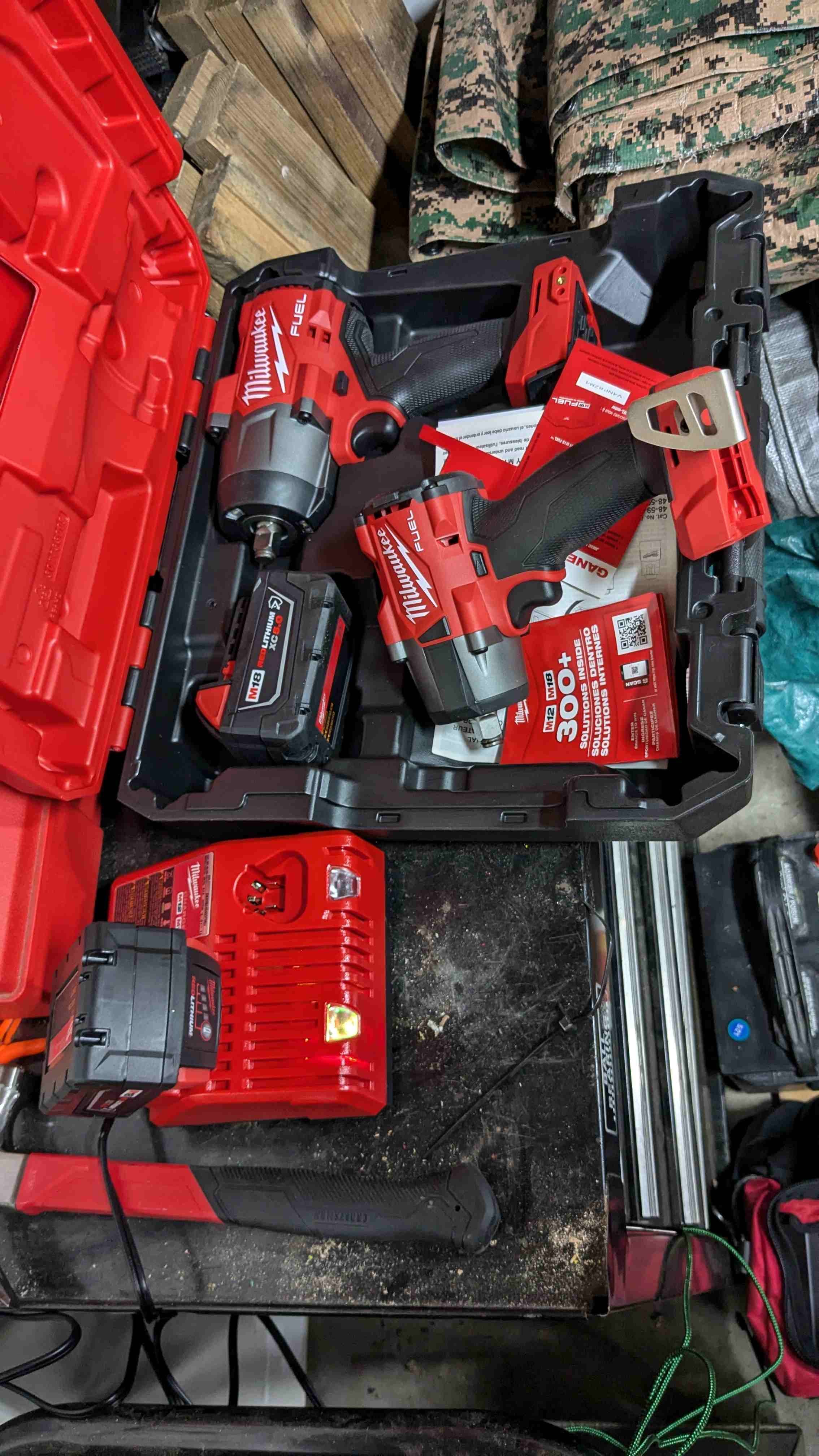

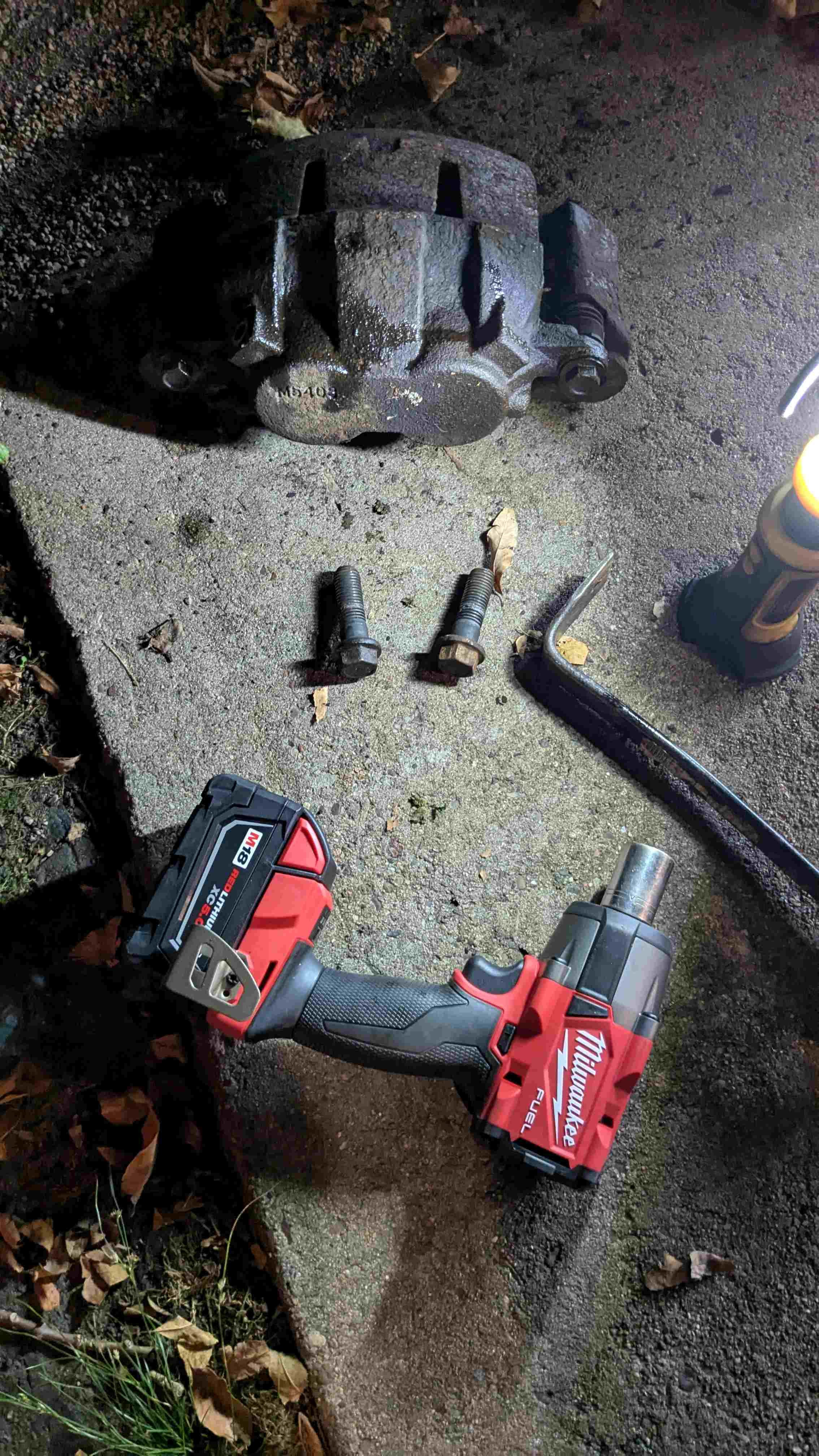

XXitanium Posted September 26, 2024 Author Posted September 26, 2024 @superhawk996 F250 front caliper, salt corrosive environment. Is that 1/2" Milwaukee capable of twisting off the head? I am doubting it. ...no.2 son... Quote
XXitanium Posted September 26, 2024 Author Posted September 26, 2024 Little brother was plenty, spun right off. Not even a strain on my limp old wrist. Quote
blackhawkxx Posted September 26, 2024 Posted September 26, 2024 8 hours ago, XXitanium said: Not even a strain on my limp old wrist. It really does save the joints in the hands and wrist if anyone has those issues. Quote
XXitanium Posted September 26, 2024 Author Posted September 26, 2024 I really don't, but the breaker-bar wasn't doing the job. It was "a bad reach" and I have had back problems in the past. O'REILLY'S made sure I got the part after hours. It should be covered under lifetime warranty. Quote
superhawk996 Posted September 26, 2024 Posted September 26, 2024 11 hours ago, XXitanium said: F250 front caliper, salt corrosive environment. Is that 1/2" Milwaukee capable of twisting off the head? If it's the bolt holding the caliper to the bracket, probably. If it's the caliper bracket bolt holding it to the knuckle, very unlikely. Quote
XXitanium Posted September 26, 2024 Author Posted September 26, 2024 The one on the back of the slide-pin. It was the one that was stuck. I had to take the whole bracket uot as I didn't have the right reducer/socket to put on the impact. I clamped it onto the bench and put a pipe on a 1/2" breaker bar to persuade it. (the kid asked me if we should buy some adaptors too 😳 ) Quote
XXitanium Posted September 26, 2024 Author Posted September 26, 2024 The open-end pictured wasn't doing it. Not enough leverage. Quote
blackhawkxx Posted September 26, 2024 Posted September 26, 2024 Sometimes heat with leverage is your friend. Someone gave me a trailer hitch with ball but wrong size. So I put the hitch on the vehicle and even with a long breaker bar with a pipe on that, it wouldn't come loose. Hit it with heat and came right off, guessing it had lock tight on it. Quote
