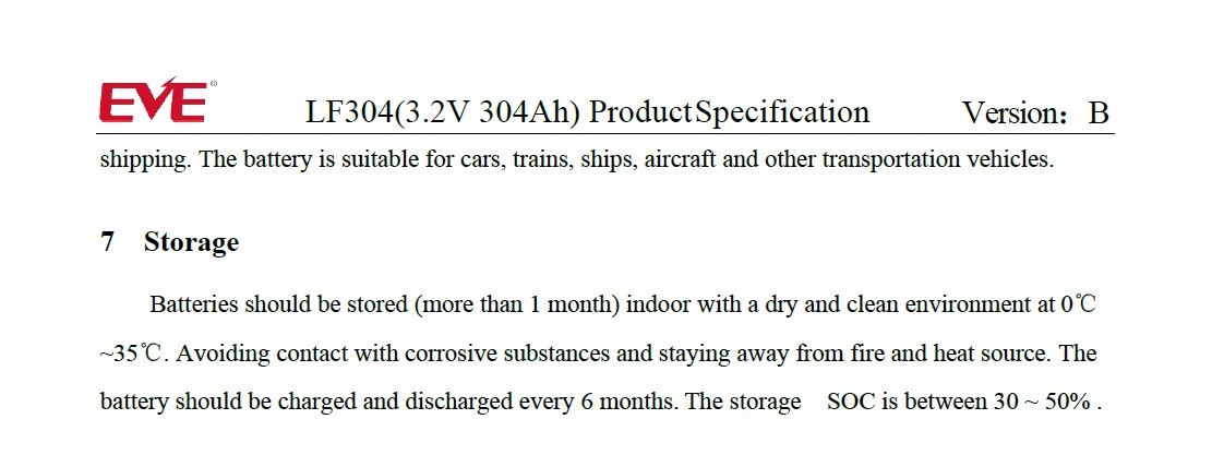

xrated Posted May 27, 2024 Author Posted May 27, 2024 (edited) 2 hours ago, SwampNut said: Every manufacturer says to store them at 100% if possible, and definitely never below 50%. Maybe you're thinking of straight lithium. Ferric-phosphate must be regularly charged to 100% to calibrate the BMS, and can be stored at 100%. Tesla says to never go more than a week between full charges. All of my RC toy LiFePO4 batteries say that too, but the lithiums (-ion and -poly) of course say to store below 70. I'm considering buying a small solar panel to keep them full, and I suspect I can run it without a controller since these have a BMS, but not sure. You can store a fully charged LiFePO4 battery. It is recommended to fully charge these batteries if you want to store them for longer. These batteries usually have a very low self-discharge rate. They normally discharge at 2% per month. It implies that when you store these batteries, they will lose 2% of their monthly charge. Discovering the battery from any attached load is recommended to ensure that no load draws additional charge and power from the battery. If you want to store the battery for a long time, it is recommended to charge it at more than 50% and, ideally, store it in a fully charged condition. The higher the charge, the larger the charge-retaining power of the battery during storage. Users often assume there is no need to charge the battery as they won't use it and keep it in storage. They do not consider that batteries undergo self-discharge whether used or stayed idle. If you store your battery in a low or zero-charge state, then prepare to face major consequences. It is so because if your battery does not have enough charge, then after self-discharge of 2% per month, the discharge level reaches a limit where even BMS cannot protect the battery. Over-discharging can cause serious and irreversible damage to your battery even when it is under warranty. That is why storing the battery with a state of charge of more than 50% is recommended to be at a safe end. Probably not Lipo. This may seem pedantic, but as pointed out above, each type has vastly different needs. This is a screenshot of the data manual that came with the cells that I used to build my battery. There is zero difference between these cells and any other LiFePO cell out there in every single LFP battery made......other than the shape of them. BattleBorn uses Cylindrical cells in their overpriced and expensive batteries, other manufacturers use the style that I pictured above. From a battery chemistry standpoint, there is not difference between the two other than shape.....here is the screenshot and the recommendations for storage of longer than a one month period of time. The cell manufacturer is EVE and they are in the top two or maybe three LFP cell manufacturers in the entire world. I spent months and months on the DIY Solar Forum before diving into the build, asking questions, reading countless posts about anything everything related to building, top balancing, BMS usage, long term storage, you name it. I spent hours on the phone with one of the moderators who lives out in AZ and is probably the smartest individual I've ever spoken to about batteries in general, and LFP in particular. His advice matches exactly what the Data Sheet from EVE states about storing them longer than a month. There is simply no good reason to keep them full SOC when not being used unless it's going to be a short period of time. Edited May 27, 2024 by xrated Quote

SwampNut Posted May 27, 2024 Posted May 27, 2024 Interesting that one vendor has a vastly different recommendation. I don't get it, since as you said they should be the same. Tomorrow I have a meeting at a place that makes LiFePO4 and lithium systems for commercial aircraft, I bet they will have an opinion. Since it would be exceedingly difficult to store them at low charge levels, I hope EVE is wrong. And also all of the LiFePO4 12v in vehicles (Zero, Tesla, etc) are always at 100%, along with all of the battery backup systems. I've always maintained all of them at 100%. Quote
xrated Posted May 27, 2024 Author Posted May 27, 2024 4 minutes ago, SwampNut said: Interesting that one vendor has a vastly different recommendation. I don't get it, since as you said they should be the same. Tomorrow I have a meeting at a place that makes LiFePO4 and lithium systems for commercial aircraft, I bet they will have an opinion. Since it would be exceedingly difficult to store them at low charge levels, I hope EVE is wrong. And also all of the LiFePO4 12v in vehicles (Zero, Tesla, etc) are always at 100%, along with all of the battery backup systems. I've always maintained all of them at 100%. Make sure when you ask them, that it is in reference to "long term" storage.....more than a month is the defining point for EVE and others. I'll be interested to hear what they have to say also. Quote
