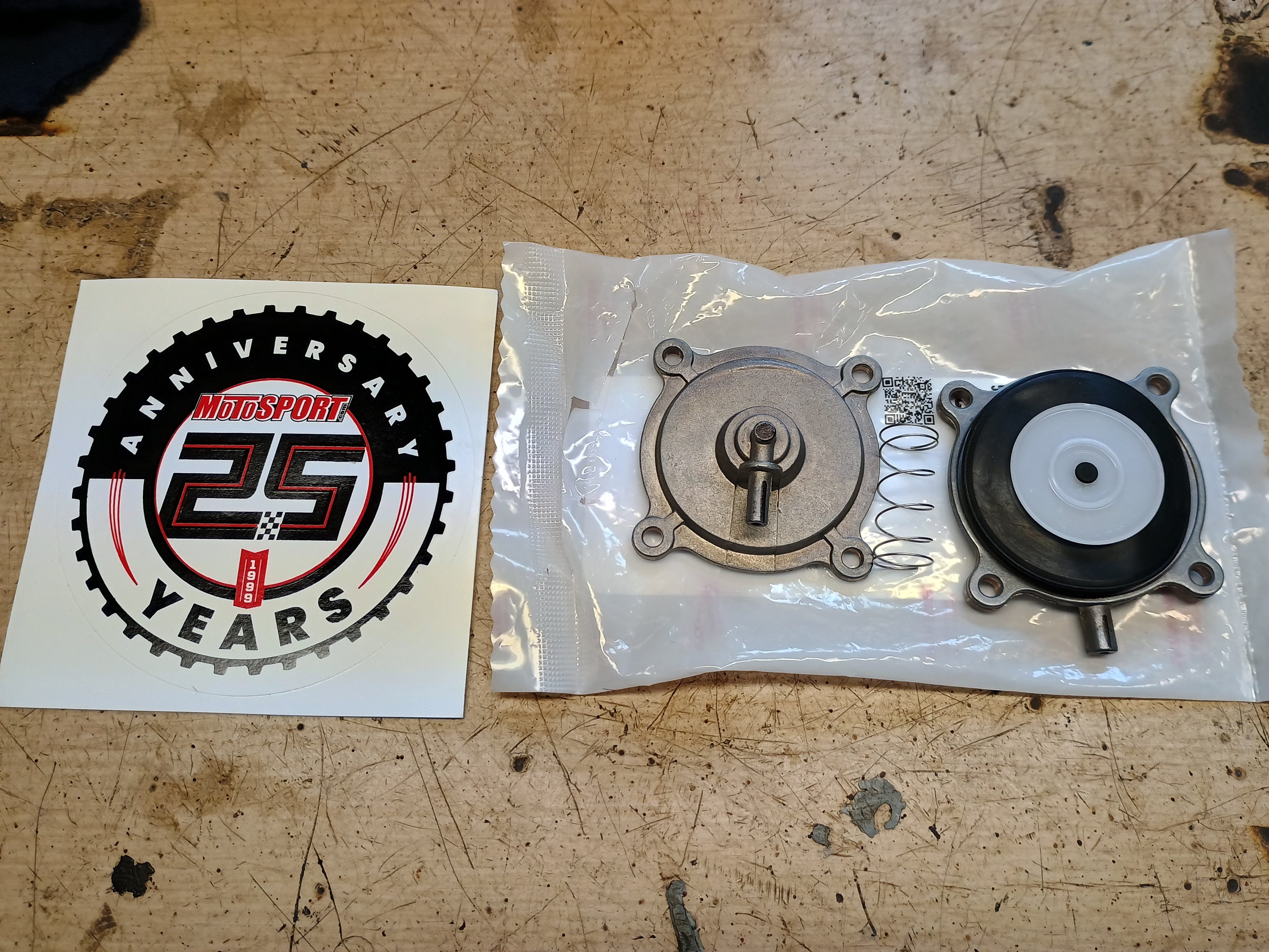

Here are the part numbers used on my XX
16952-MBB-003 Screen, fuel strainer
16953-ML0-034  Cover set, petcock
Edited by TFT
  • Useful/Thanks! 1

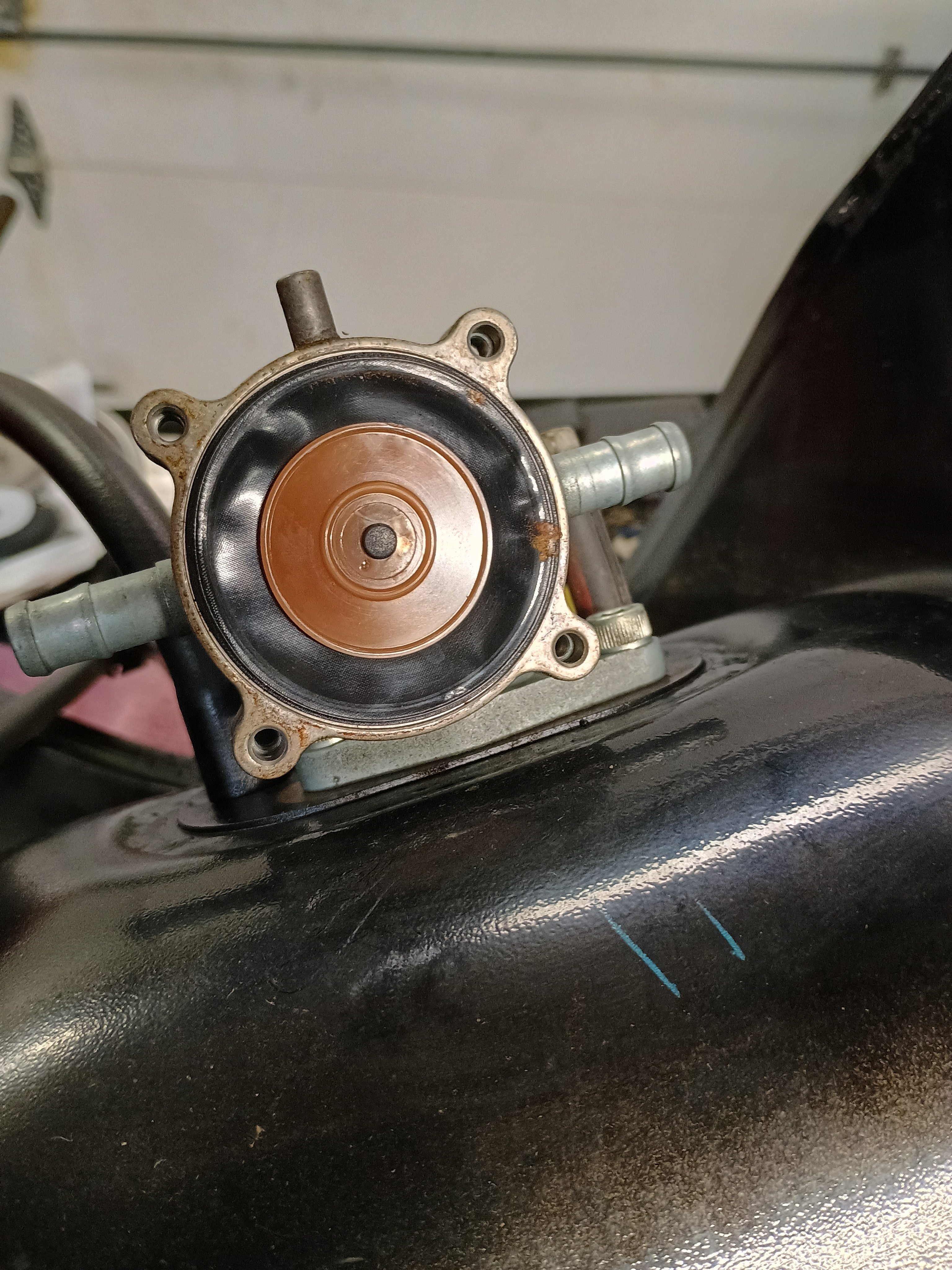

Got the petcock today and took most of the gas out of the tank but not all.  Removed the tank and flipped it over on the work surface, moved the tank around a little to make sure no fuel was leaking out of the filler cap.  It started leaking out of the vent port so I lifted that end up and it started shooting out it.  I grabbed a vacuum cap to stop it.  I think it was the combination of the heat of the garage and pressure built up by moving it that made it come out because after I turned the tank upright and opened the filler cap, there was a good bit of pressure. I was sad that the foam under the tank got gas on it because it was perfect.  Anyway everything else went well and it ran fine though I didn't ride it because of pop up rain in the area.
The old one was OK and I think would have lived for some years but there was a something on it brown colored that could be slightly felt with the finger as can be seen in the photo.  I could see the filter/screen from inside the tank and it looked clean, like new so I didn't take any of that apart but did check the air filter since I had it apart.
