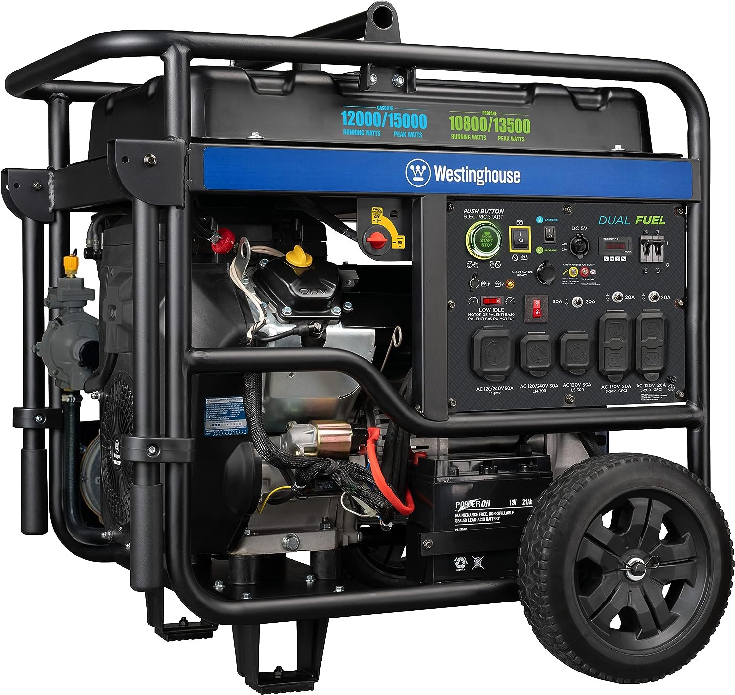

It just depends on what you are going to use them for.  In my case, I HAD to have it for my application.  I bought a 15Kw peak (12Kw running) "portable" Westinghouse generator that is dual fuel and uses the NEMA 14-50 setup.  I am using it for backup power at the house in the event of a power outage.  I went the "cheap" route and instead of buying a large manual or automatic transfer switch system, I am using the main breaker lockout method and bringing the generator power into that house breaker panel via a double pole 50A breaker.  With that type of setup, you have to turn the house main breaker to the off position and then slide a moveable "lockout" up into position to prevent the main from being turned back on.  When you do that, it then allows you to turn on the 50A double pole breaker that is the generator input for the house panel.  So when that happens, you are using the existing neutral/ground bonding inside the house breaker panel instead of having a neutral/ground bond in the generator itself.  It is completely up to code from NEC doing it this way, and of course is a lot less expensive that doing the manual or automatic transfer switch method.  The drawback is obviously, if we aren't at home, nothing happens when the power goes out......because the generator does not start by itself and none of the switch is done automatically.  For the few times that we lose power here, I decided to go that route.......plus I'm retired so I'm home a lot more than most folks that are working.  The generator that I bought came with a generator neutral/grounding bond inside the generator, but the manual gives you directions on how to remove it if you need a floating neutral/ground bond......which I did.  I of course saved the bonding jumper and clearly marked the generator as "Neutral/grounding BOND REMOVED....
It's a hoss.......close to 600 lbs when fully fueled with 17 gallons of gasoline, but a good set of solid wheels on it and handles for moving it outside my garage if/when needed.
