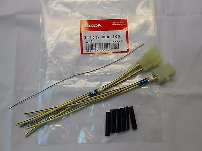

Honda does have a kit for the plug,31105-ML8-305 . Originally an upgrade for GL1200's, but it's a 3 yellow wire connector set.

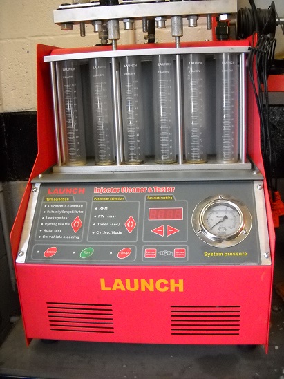

I tried when mine were plugged,then 2 different bike mechanics told me I can't,electronic injection and they only open when told to basically.But hey man I'm all for finding a way.I only soaked the bottom half below the connector.
Can't soak them.They may be able to be cleaned.This is the machine used for car and bike injectors my buddy has,cleans them then flow tests them.
Switch the #4 with another injector.And yes right side is #4.As for the coils that would be rare,did you use the same cap? Those caps also tend to last forever but just trying to think all possibilities. If it turns out to be the injector they are exactly the same as Busa's and some GSXR's. I had mine flow tested by a friend who owns a shop,17 years old and 64k kms and they were fine.My mistake was in not getting them back fast enough since the solution they clean them with will plug the little bastards to their death if left for a few weeks.Got a used set,all good.
