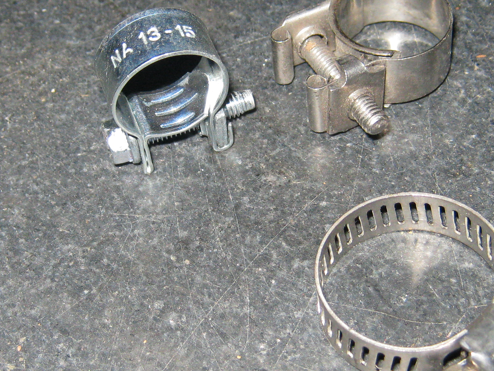

Ah. I see. What is that type of clamp specifically called and where would I likely find them? If I can get hold of them, I agree they look better for the job. I think any auto parts store should have them. They are listed as fuel injection clamps by the Ideal co. http://www.idealclamps.com/catalog/clamps/...p;SECTION_ID=17 See this web page for sizing, it has the following chart, my copy below lost formatting. These clamps have a very limited clamping size range. Sizing / Clamping range Chart SAE Sizes Part No. Min. Dia. (in.) Max. Dia. (in.) Min. Dia. (mm) Max. Dia. (mm) Fits Hose I.D. 4 52F13 7/16 1/2 11 13 1/4" 6 52F15 1/2 9/16 13 15 5/16" 8 52F16 9/16 5/8 14 16 3/8"
The fitting pressure rating is not an issue here, Nor is the flow rate, since your fittings are the same ID, more or less. It would be a VERY bad idea to use barbed fittings without some clamp, and there is a better clamp for your setup than the worm gear style. The only thing that you are doing "wrong", and I mean that in a very general way, is the clamp. Here is a comparison photo.
Good point, but IIRC, there are no clamps on the high-pressure lines...it's banjo bolts. Wrong. the rubber hose is crimped onto the banjo fitting, look at your photos. Band clamps only offer existing spring tension and work well on low-pressure lines. Look at any fuel injection system that has removable screw clamps. This is what I am referring to, not a spring clamp. Supposedly I should not have needed clamps at all, so this was just a preventative measure. ????? Do you really think you can run a pressure hose over a barb and not clamp it???? There are more secure fitting styles from Jiffy-Tite, but they cost more too. For the GPM flow rate of a FI system, these barbs should be more than sufficient. What does flow rate have to do with barbs???? I only know of the worm gear hose clamp for high-pressure applications. This is one of those projects where you have to commit to replacing your fuel line IF you mess up, so once you cut the line, there is no going back. Worst case scenario, I need 2 better-suited Jiffy-Tite fittings and a new fuel line. I certainly will watch for leaks or other problems. Please watch carefully.
