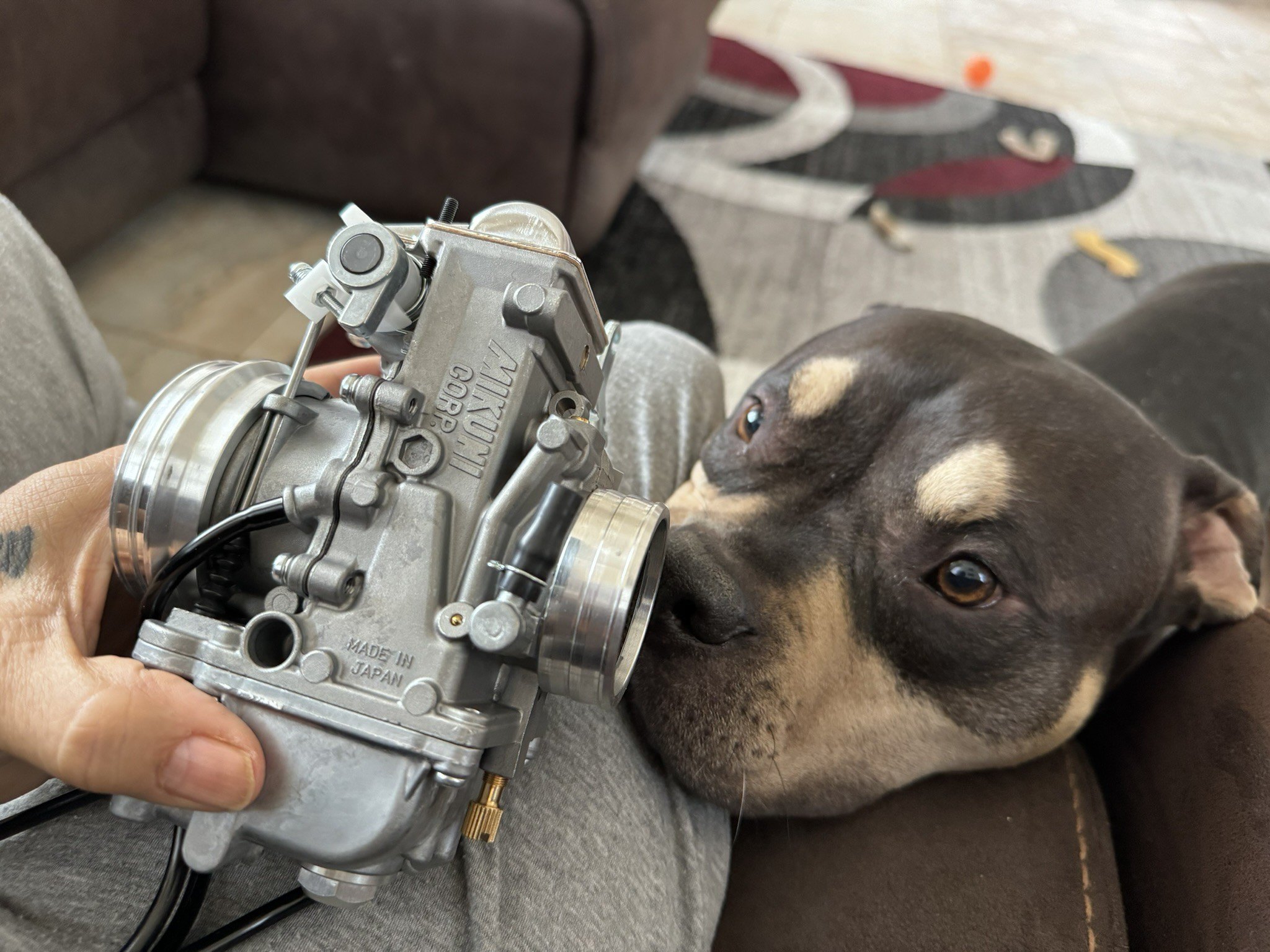

  9. LOL, right? My jets are 150 and 17.5 with the idle screw 3.5 out. One guy fighting starting issues has 140 and 30 at 1 turn out, as delivered. WTF bike is that for? XRs only did ship mine with the pump adjusted to the absolute minimum level, but it ran. They say the bike is perky enough to not need the "common" setting of 1/8" clearance to the pump rod. They shipped it with like half an inch or whatever is maximum. About half the throttle stroke with no pump. Maybe I should go back and try it their way. This is a clear win for advanced FI or electric bikes. It would be nice to push a button on the bars and have a different acceleration curve. I've gotten pretty spoiled by that. Dunno, it's the high side versus low side I think about. Remember my post about CR500 airlines? Oh yeah, it's amazing that so far this bike is less friendly than the CR500. I agree with your overview of the changes with throttle. Towards the end of my ride time I was trying throttle hits with mild roosting, and the bike seems to prefer it over having actual traction. And you think you're lugging it, and the fucker just spins the tire no matter what. Below idle in second gear? Max torque, here you go, good luck.

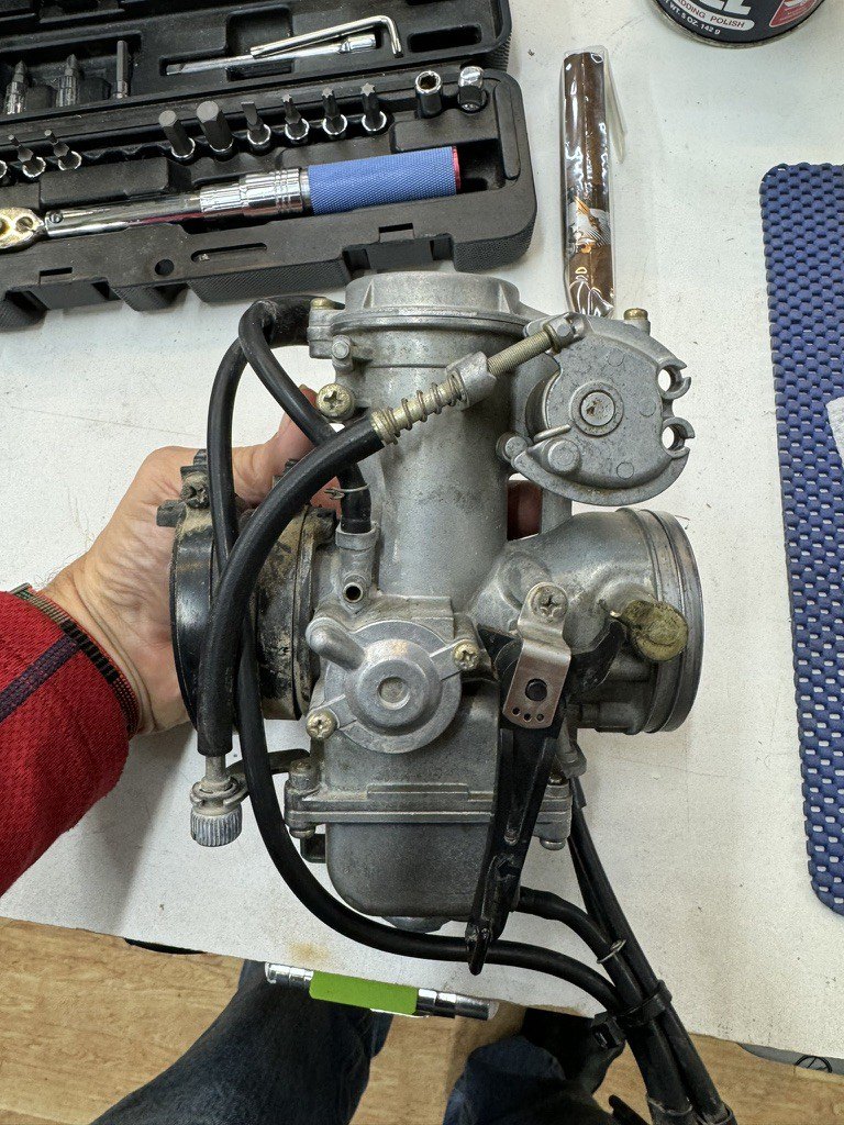

  10. LOL. I've talked to a few people who have "stock" Mikuni pumpers, whatever they ship from the factory I guess. It cost me $50 extra to get one from XRs only with the adapter ring preinstalled, and jetted for this bike. Clearly, this was well worth it, the other people are fighting with jets and leaks using some shitty Chinese adapter.
