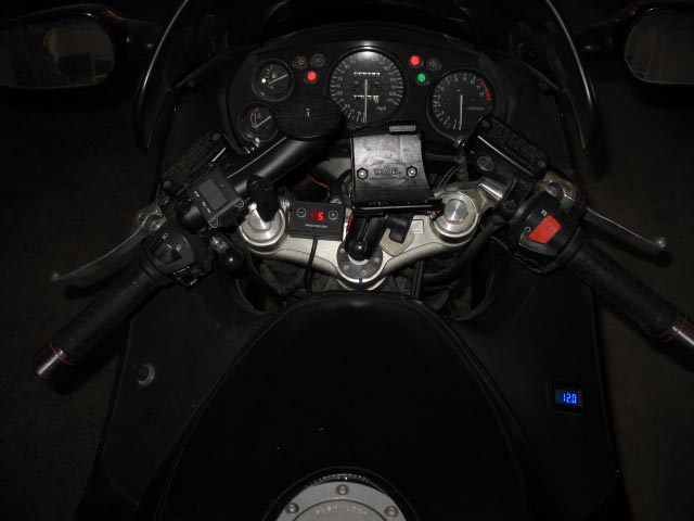

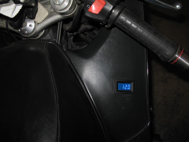

Okay. Sorry I took so long to do this, but so you can see what I did with my Datel....

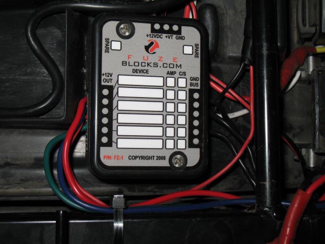

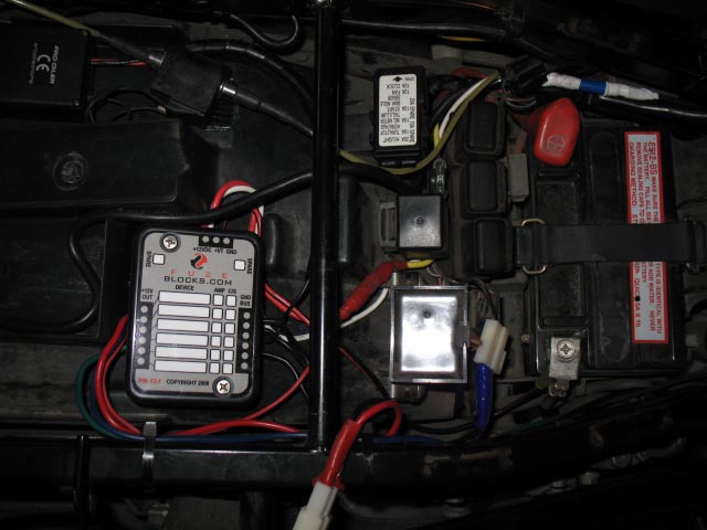

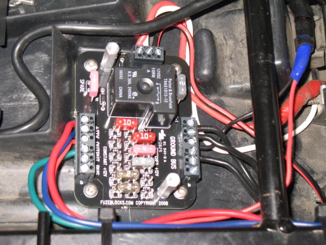

For all the ways to hook it in, I ultimately went with the FZ-1 from Fuseblocks.com. It was $80, but since I had several electrical devices I wanted switched power for, this was a smarter move over splicing into the wiring harness wherever I found a place to do so.

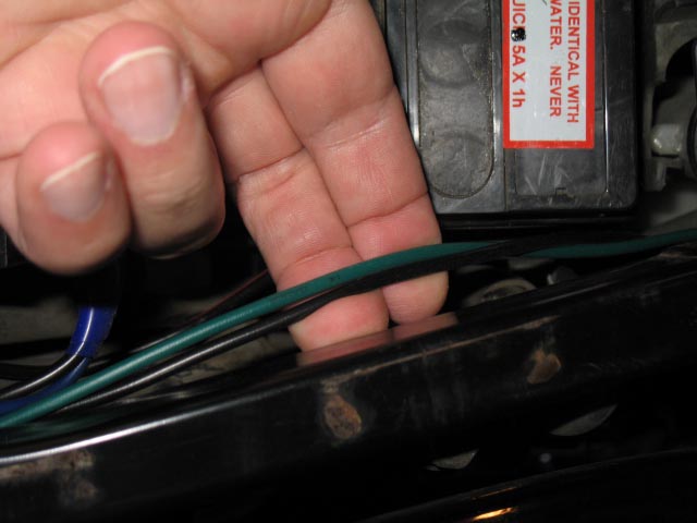

I spent the money on several spools of colored wire, and for the Datel I used Green for hot and Black for ground. The feed for the Datel comes right off the battery through the FZ-1. The unit hooks directly to the battery, and the wire you connect to a switched circuit serves only to toggle the relay that closes the circuit for switched power accessories.
I also bought special connectors from Vintage Connectors (or something spelled like that [verify]). I used one of their two-wire unlatched connectors to be a "break away" point for the connection to the FZ-1 (done behind the right cowling). This makes it easier to remove the trim panel the Datel is mounted to as I don't mess with detaching wires from the Datel each time. This also helps to protect the wiring should an accident make the panel fly off. The unlatched connectors hold tight enough that they won't work loose, while allowing a sufficient force will pull the connection apart rather than rip the wires out.

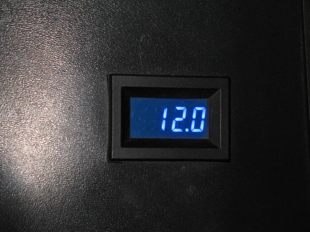

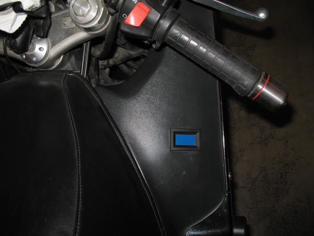

While the Datel looks good in the picture, you should know that it is somewhere from 1/4" to 1/2" too high up (it should be more towards the aft of the bike). I measured but either marked the trim panel wrong or didn't compensate for its curved surface properly. Once the Datel was on, the trim panel couldn't go back on without the Datel hitting the duct feeding the airbox. I had no choice but to carve out a notch from the duct until the panel could go back on easily. Then, I sealed the hole in the duct with aluminum tape. It works fine, but I wish I got it right the first time. This is one of those, measure 5 times and cut once situations.
As far as placement goes, this is the best I could do with the stock surfaces on the XX. It's not a great location if you want to watch your voltage all the time or at easy glance, but you really don't need to watch voltage that closely. I liked the blue more than the red, but it is BRIGHT at night, so if you want to place your Datel somewhere more in your line of sight, be advised. I can move my forearm or just momentarily release the throttle to glance at the meter. At worst, when the sun's at a unfavorable angle, I have to shade the display to read it.
