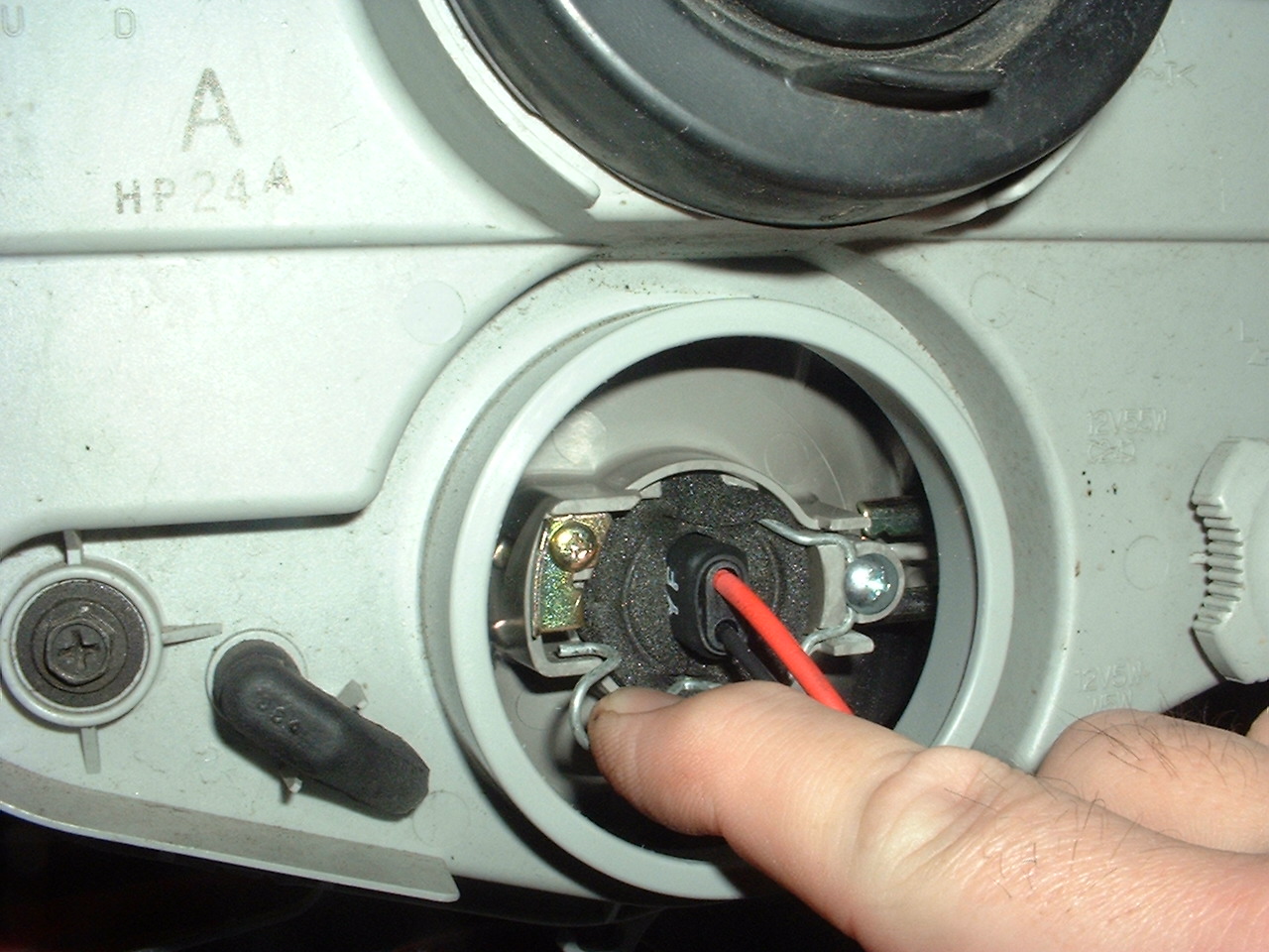

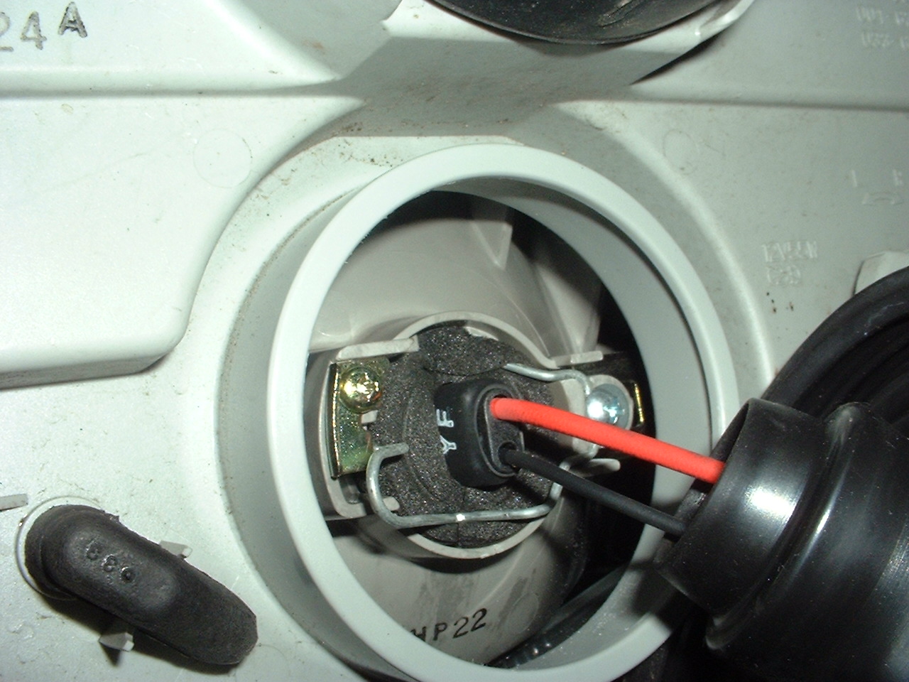

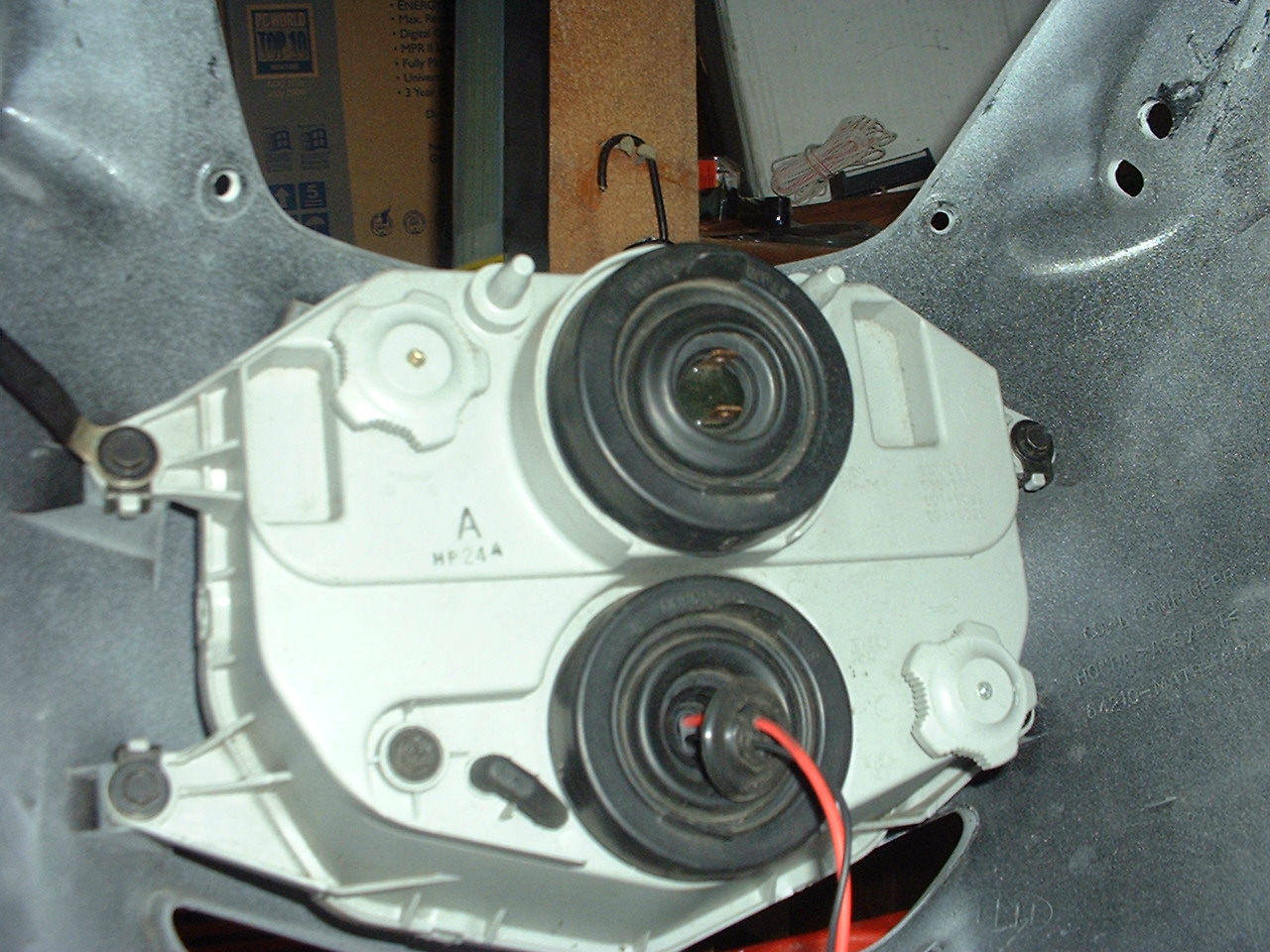

Guest rockmeupto125 Posted August 13, 2006 Posted August 13, 2006 You can change bulbs without removing any of the access panels. Its a chore, but it can be done. It really helps if you know how things work up there. Here's a pic of the back of the headlight. [attachmentid=2553] Pull the rubber boot off and you'll have this. [attachmentid=2554] The spring wire clip swivels at the right. Depress the wire loop on the left by pushing it forward, then push it down to clear it out from under the brass colored catchplate (with the brass colored phillips head screw on the left). Swivel it up and the bulb will be loose. [attachmentid=2555] Quote
Fonzie Posted August 13, 2006 Author Posted August 13, 2006 VERY cool!! Thanx Dos & Joe!! :icon_clap: I was in the right vicinity then........just didn't "feel" anything I thought I should be. This helps a lot! :icon_thumbsup: P.S........nice carbon fiber fender Dos!! Quote
