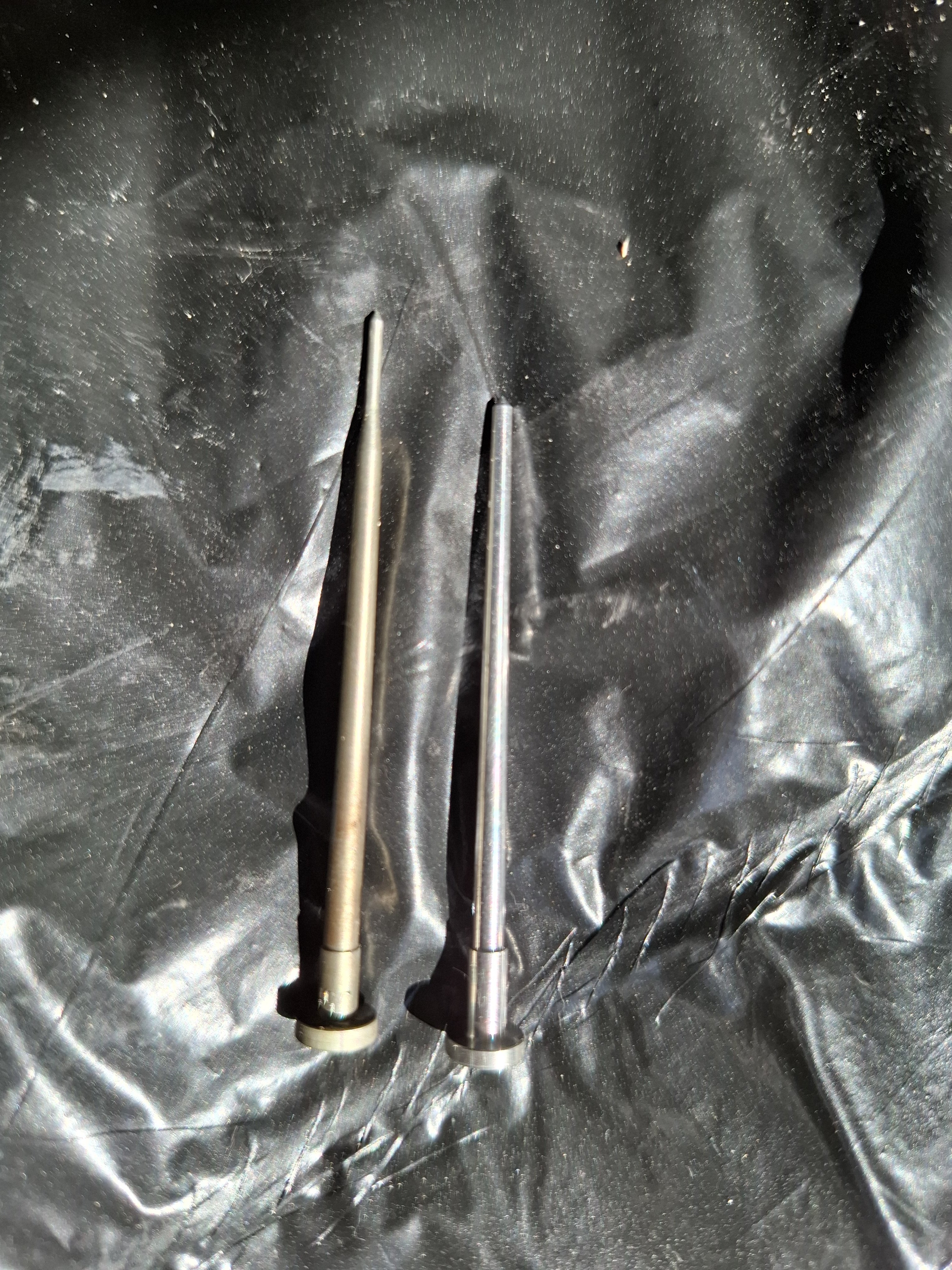

  4. Just got the rebuild kit for my carbs... the old needles are longer and have a very thin end 1/4 inch or so... Normal? Worn? New needles wrong?

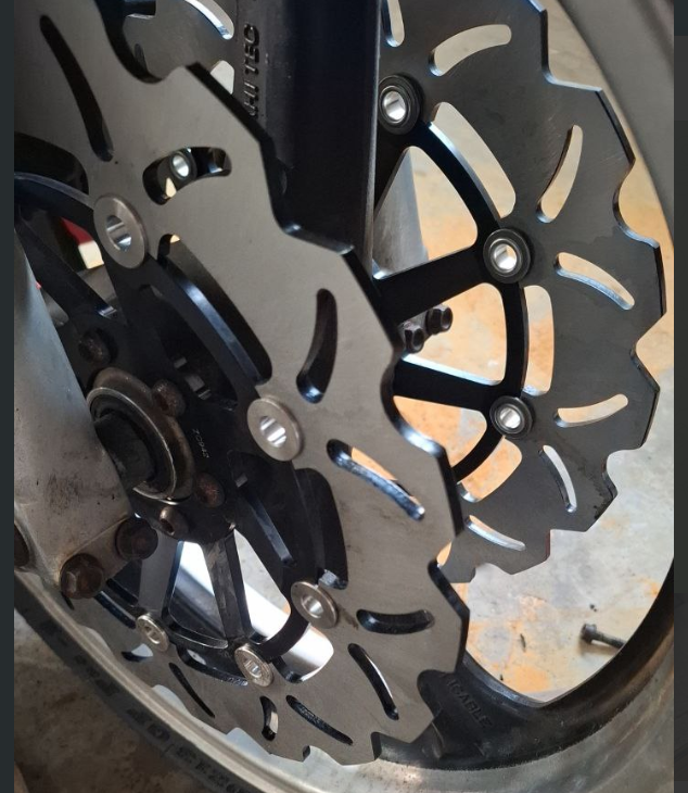

  6. Honda overengineering for the win. I do screw around more than is healthy and I'm astounded by the condition of the OEM clutch

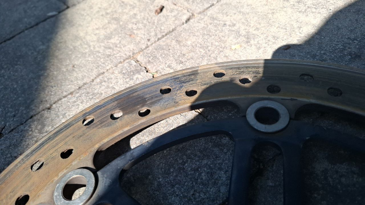

  8. y old front disks are a tad worn I think Should be 4mm - the wear part was down to 1.6mm after 276,000 km Got new ones tho so.......
  9. Will try this tomorrow Reconditioning them might be a chemistry experiment
