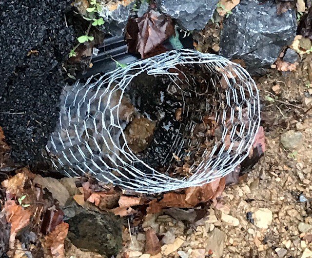

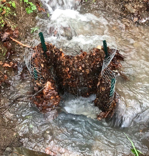

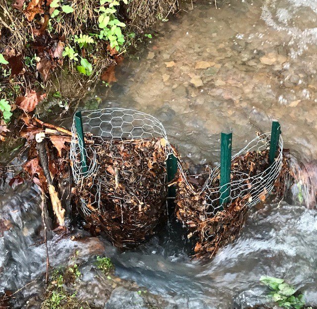

Zero Knievel Posted April 13, 2020 Author Posted April 13, 2020 (edited) Well, I’m semi-happy with the results. I’ll take pics later today, but for two openings I used 4 foot t-posts (the green ones) and chicken coop wire. They weren’t easy to install because the area around the inlets are mostly rock. On lesser storms, they caught debris and let the water pass over/around. Saturday, I went out and pulled out the debris that accumulated and for the third culvert where the inlet appears to be part crushed from the driveway paving, I just took a section of chicken coop wire, folded it in half, and fashioned an oval to catch debris without standing higher than the edge of the drive. I checked them this morning after the storms passed through. The two big ones need to be cleaned, repaired and reinforced, BUT they did the job. Enough debris hit the wire to block water flow and collapse the circle of wire I erected, but water flowed around the barrier and entered the drain pipe from the back side. No overflow issues in drainage. PICS... Edited April 13, 2020 by Zero Knievel 1 Quote

Zero Knievel Posted April 30, 2020 Author Posted April 30, 2020 I've since augmented the larger ones with an extra t-post and a metal rod inserted at 45 degrees to brace the one facing the inflow of water. Quote

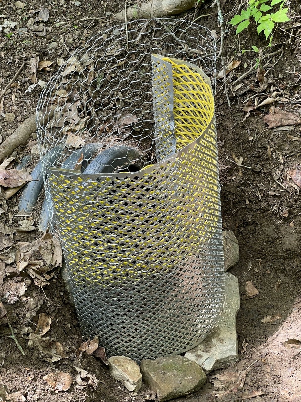

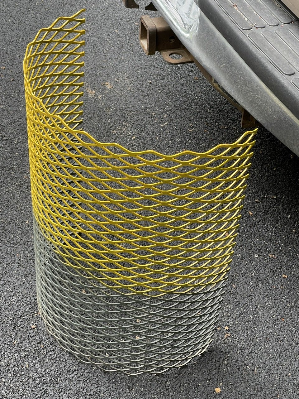

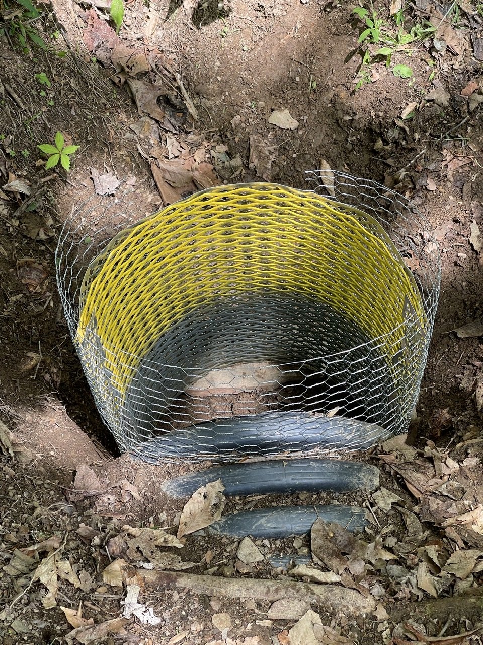

Zero Knievel Posted May 15, 2022 Author Posted May 15, 2022 Well, I found a metal fabricator in town and had him make three of these…I painted them when I got home. Under $80 for all three. Installing, I repurposed some of the old stuff and used chicken wire to prevent stuff falling in from behind. 1 Quote
XXitanium Posted May 16, 2022 Posted May 16, 2022 Did you say that was stainless steel expanded metal? Quote
Zero Knievel Posted May 16, 2022 Author Posted May 16, 2022 No. Regular steel…that I know of. Fairly thick, so it should last for a while…and it will be easier to reproduce now that I know how these were made. Quote
