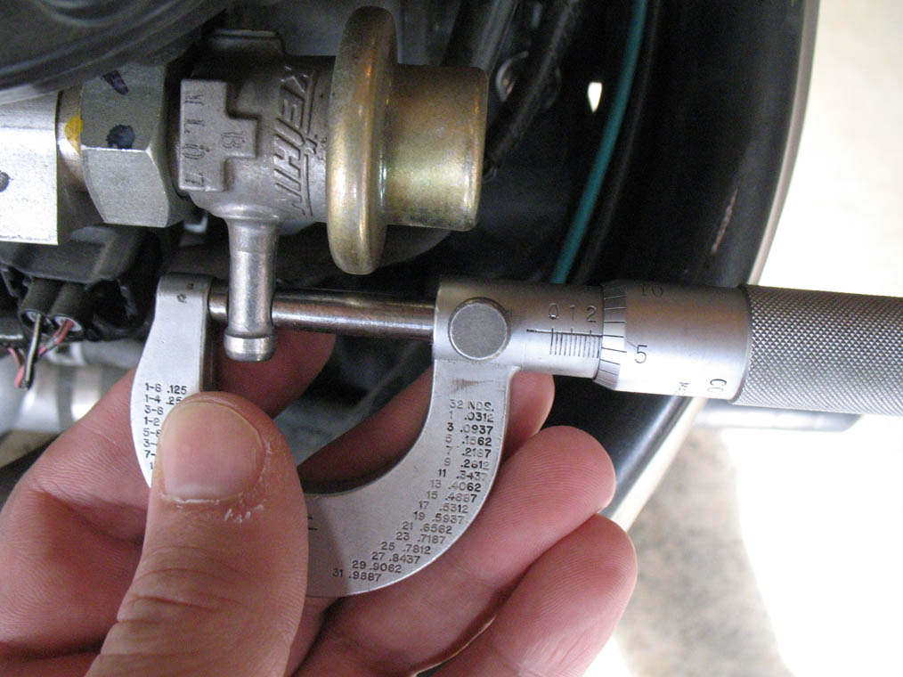

Zero Knievel Posted November 15, 2010 Author Posted November 15, 2010 I might go ahead with this idea. I found this site - http://www.beemerboneyard.com/fuliqudise.html Those are for BMWs. When I contacted them, they said: If your fuel line is 5/16" inside diameter (8X13mm metric) then that kit should work fine assuming you have enough room to install them. You'll need about 3 1/2" on free line in a place you can get at to connect and disconnect them. Hope this helps Of course, I don't know the INNER diameter of the fuel lines and the Honda manual doesn't give specifics. Anyone know? arcon, You said you needed -10 lines, but that you suspect the stockers are -6. This means you are running modded lines and not OEM, right? I e-mailed Jiffy-Tite to get their recommendations as well. Quote
Zero Knievel Posted November 16, 2010 Author Posted November 16, 2010 Well, Honda is no help. Anyone have OEM fuel lines they had to cut open to get the inside diameter of the line(s)? Quote
Zero Knievel Posted November 16, 2010 Author Posted November 16, 2010 arcon, You said you needed -10 lines, but that you suspect the stockers are -6. This means you are running modded lines and not OEM, right? I e-mailed Jiffy-Tite to get their recommendations as well. Correct -- and those in you link look interesting too. Check out SummitRacing.com too. Remember, it is fuel.. a liquid. Nothing major except it has to handle more PSI than a NA motor. Do you need a special tool to make these things go onto the fuel line? Link? Better have all I need BEFORE I cut any lines. Quote
Zero Knievel Posted November 17, 2010 Author Posted November 17, 2010 Well, Honda is no help. Anyone have OEM fuel lines they had to cut open to get the inside diameter of the line(s)? Ah, someone at ST.N linked to a thread at the XX.com site. pressure pipe is 14mm (9/16") OD 7mm ( 9/32") ID return is 12mm (7/16") OD 6mm (7/32") ID Quote

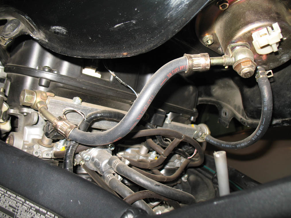

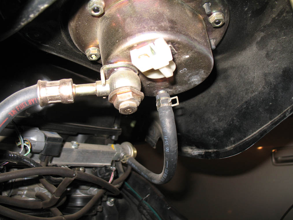

RXX Posted August 21 Posted August 21 OK, guys I am going to ask some pretty nitty-gritty questions and I am down to the wire. First off know that I am not criticizing the existing unit. It has been a real sweet deal. Mike, it appears that when you installed the device you cut the existing fuel line to attach to the disconnect. The seeping is occurring at the crimped part of the old hose and I do not believe there is any way to fix that. It has lasted what, 15 years and thousands of miles. There is some stress on that part whenever the tank is raised or removed so I can understand it failing over time. If I were to reproduce the setup I would need a new/used hose, which is unobtainable as far as I can tell. If I could find the hose the simplest quickest thing to do would be to scrap the disconnect for now and go back to stock configuration. I am running out of time to dick around. If anyone here has a Hose, Fuel Feed 17527-MAT-D00 text me for my address (865) 567-5469 and I will give you CC number for fedex overnight. My other option is to take my Triumph, which would raise the adventure to a whole new level. Naked street bike, 5,000 miles. Canada. Sheesh. Quote

rockmeupto125 Posted August 21 Posted August 21 I suspect I have one. But I suggest that removing the crimp and shoving a regular high pressure/FI hose on there with some high pressure clamps would work just fine. They only run 50 psi. Quote

rockmeupto125 Posted August 21 Posted August 21 Anybody in their garage can handle it. Smooth band fuel injection clamps are good for 90psi Quote
poida Posted August 21 Posted August 21 i had the fuel hose on my 99 replaced many years ago by a hose shop.they just fit the new hose onto the old fittings 2 Quote
CALCXX Posted August 21 Posted August 21 (edited) Up to you Phillip. Certified DOT shop near you could handle this easily. Fresh start, peace of mind for the long term. Edited August 21 by CALCXX Quote
tomek Posted August 21 Posted August 21 3 hours ago, poida said: i had the fuel hose on my 99 replaced many years ago by a hose shop.they just fit the new hose onto the old fittings I've used old fittings. Removed old hose, cleaned fittings, appropriate ID fuel hose, safety wired couple screw clamps so they wouldn't get lose. Boom.!!! Done. Quote
SwampNut Posted August 21 Posted August 21 7 hours ago, rockmeupto125 said: I suspect I have one. But I suggest that removing the crimp and shoving a regular high pressure/FI hose on there with some high pressure clamps would work just fine. They only run 50 psi. This is the perfect place for the single ear crimp clamps I've posted about before, and agree with Joe. Particularly when used like this, which has held 125 PSI just fine. Not rocket surgery. I wonder what silicone rescue tape could do. Not on a 5k trip though. Quote
RXX Posted August 22 Posted August 22 On 8/21/2026 at 4:08 AM, rockmeupto125 said: I suspect I have one. But I suggest that removing the crimp and shoving a regular high pressure/FI hose on there with some high pressure clamps would work just fine. They only run 50 psi. This. cut the crimp off get down to brass tacks. Cleaned this up, went to hose store and got hoses and clamps, reinstalled. No leaks. No final pictures, I got interrupted and had to install a new carb on the bike for the nexxt generation of nut jobs. 1 2 Quote
