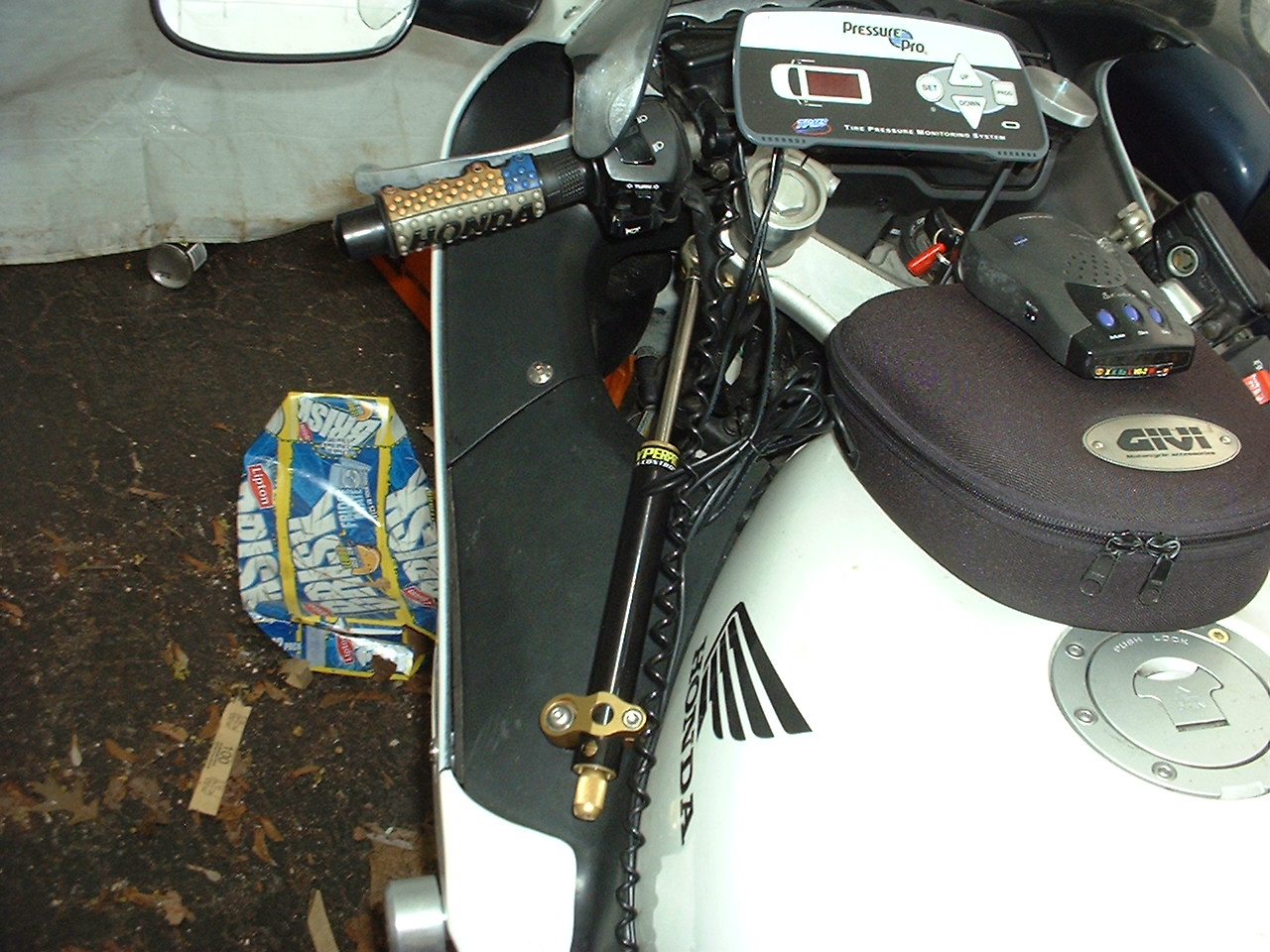

macmcd Posted May 12, 2006 Posted May 12, 2006 What's headshake? I was thinking about getting a hyperpro steering damper it would work great on those PA twistys how much work to install one on my 03 ? Quote

Pete in PA Posted May 13, 2006 Posted May 13, 2006 What's headshake? Do the handlebars even turn with all that stuff? Quote
Guest rockmeupto125 Posted May 13, 2006 Posted May 13, 2006 Hey, have you looked around? My dash is bare....no XM, no GPS, no missile launchers, garage door openers, EZ-Pass...... Quote
Para045 Posted May 13, 2006 Posted May 13, 2006 What's headshake? I have one of those Hyperpro dampers on my 98 Ti BB but still get a bit of headshake sometimes when no hands and decelerating from 90 odd kph but then the front Dunlop 208 is basically fucked and cupped badly :icon_doh: - going to get a Mich P/ Power very soon , Btw also have a Nonfango topbox which obviously does not help whith the headshake thing :icon_nono: Quote
