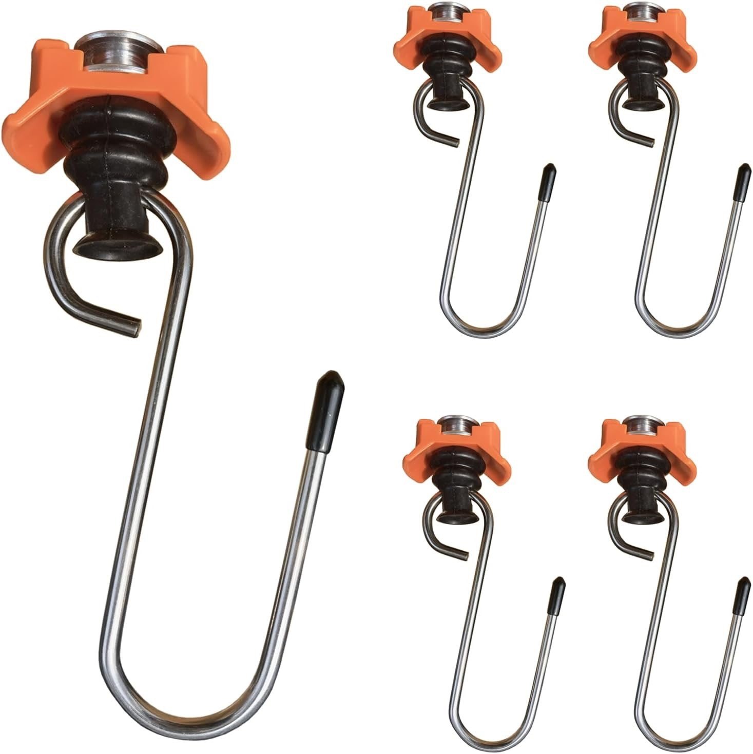

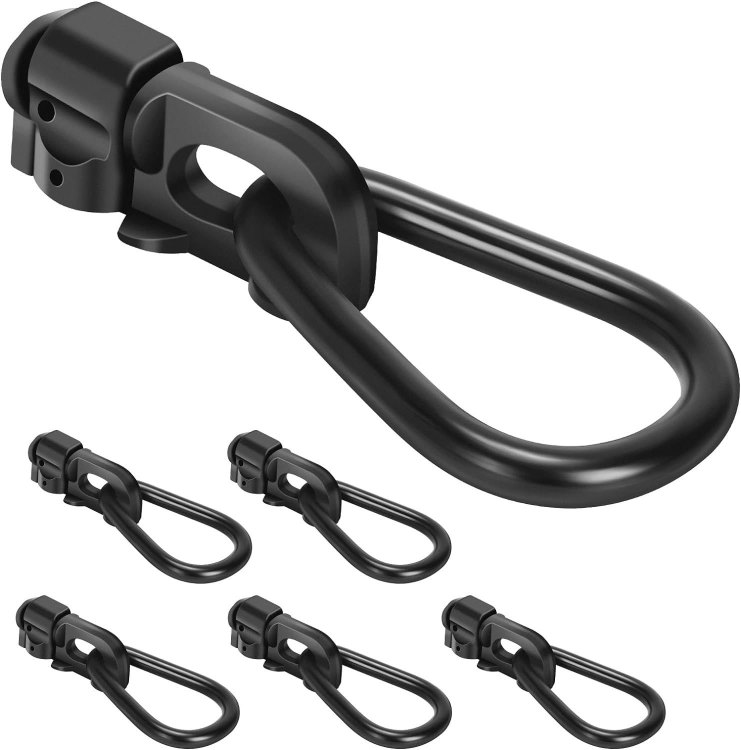

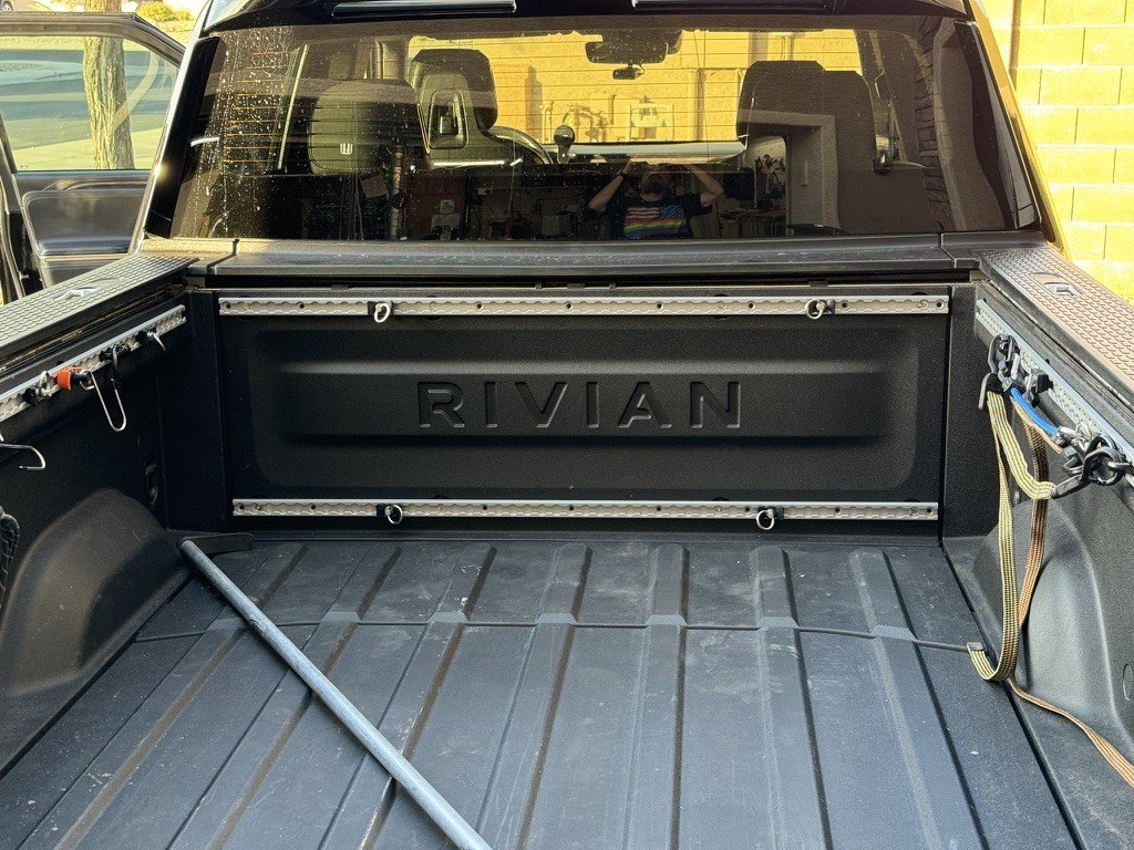

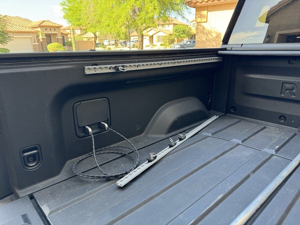

SwampNut Posted May 21, 2024 Posted May 21, 2024 My Gladiator had cargo rails and the typical sliding anchor points. Super useful. It was very heavy and could be used to tie down anything, load limits were realistically nearly as good as solid tie down loops. So I decided to get a similar system for the Rivian, and after looking at so many options, went with generic aircraft L-track. It seems lighter than the track in some trucks, but people seem to love it. Anyone have this? Experiences? Tips? The bed has a series of existing threaded holes intended for mounting tie-downs or MOLLE panels. I'll use those, and if needed, some spacers to attach the rails. They are said to be solid. My routine usage will be random small shit with light straps (Ron Straps, bungees) and occasional motorcycle loading with ratchet straps. I got these for more heavy duty use and flexibility. And these for casual hanging stuff, low load needs. Edit to add: I got four tracks. One for each side up high, and two across the front. This is how the factory mount holes are set up. I have seen some motorcycle chocks that can go into the front rails, not sure if I would want them or not. Quote

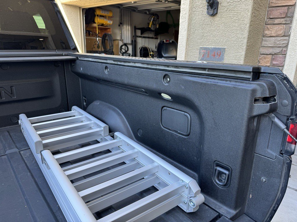

SwampNut Posted May 26, 2024 Author Posted May 26, 2024 Well you guys were useless, LOL. Works great, pretty cheap for the utility. That odd looking thing with the two plugs is the Rivian's gear cable, it locks/unlocks the connectors with the truck lock/unlock. So you can secure shit in the bed even if you have to leave the cover open. Quote

SwampNut Posted May 29, 2024 Author Posted May 29, 2024 For light use, self-tapping screws would be just fine to attach. Next up would be outserts if you have single sided access, and of course normal bolts and nuts is ideal. 10 hours ago, TOXXIC said: gun rail ...? Gunwale converted by Siri? The cargo area lip should be just like a truck bed right? Where they are meant to go? Quote
