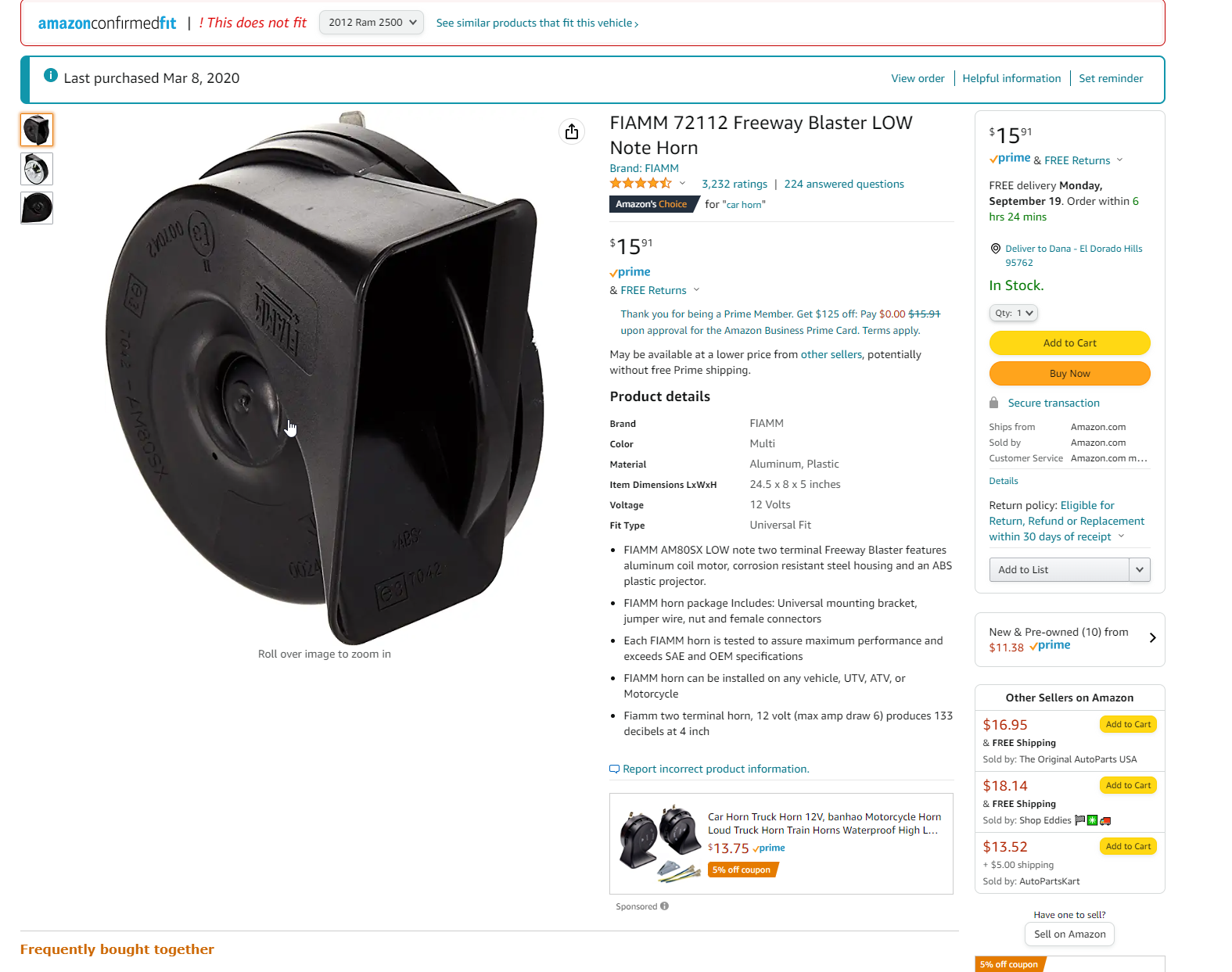

SierraKLR Posted September 18, 2022 Posted September 18, 2022 (edited) This...have used it on multiple bikes with no rewiring or relays. Bolts right in to OEM location and OEM connectors. and available on AMAZON: Edited September 18, 2022 by SierraKLR added content Quote

XXBirdSlapper Posted September 18, 2022 Author Posted September 18, 2022 2 hours ago, SierraKLR said: This...have used it on multiple bikes with no rewiring or relays. Bolts right in to OEM location and OEM connectors. and available on AMAZON: I was looking at these. You put one on your bird? Quote

SierraKLR Posted September 18, 2022 Posted September 18, 2022 (edited) 14 hours ago, XXBirdSlapper said: I was looking at these. You put one on your bird? Stock location. Stock bracket. Stock wiring. No relay. and yes on both birds. Edited September 18, 2022 by SierraKLR 1 Quote
XXBirdSlapper Posted September 18, 2022 Author Posted September 18, 2022 1 hour ago, SierraKLR said: Stock location. Stock bracket. Stock wiring. No relay. and yes on both birds. Great. Good information Quote
XXBirdSlapper Posted September 18, 2022 Author Posted September 18, 2022 1 hour ago, SierraKLR said: Stock location. Stock bracket. Stock wiring. No relay. and yes on both birds. Was it the low or high note? Quote

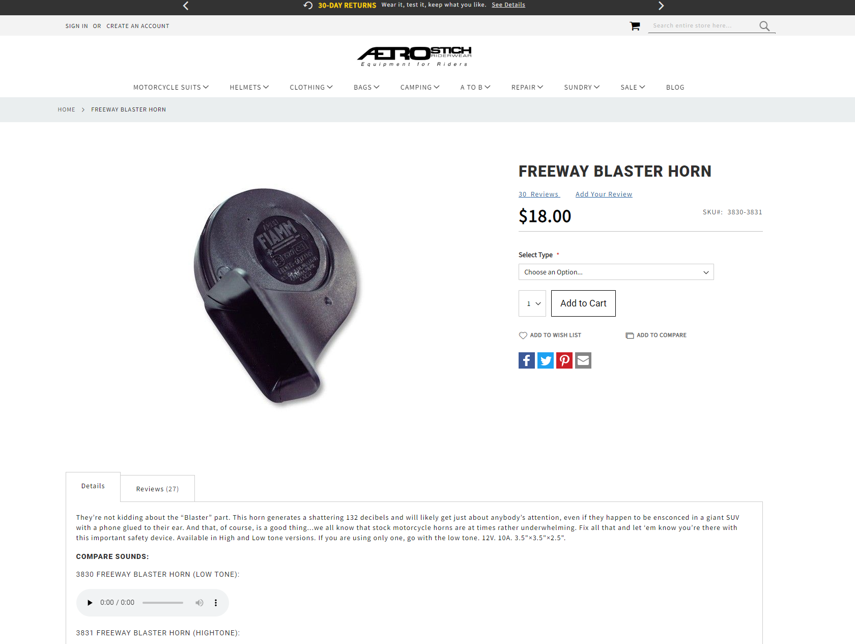

SierraKLR Posted September 19, 2022 Posted September 19, 2022 21 hours ago, XXBirdSlapper said: Was it the low or high note? Low tone. The Aerostich website has sound clips of both. 1 Quote
XXBirdSlapper Posted September 21, 2022 Author Posted September 21, 2022 On 9/18/2022 at 11:57 AM, SierraKLR said: Stock location. Stock bracket. Stock wiring. No relay. and yes on both birds. Ordered one. Not sure when I'll install it, but I'll report back. Quote
