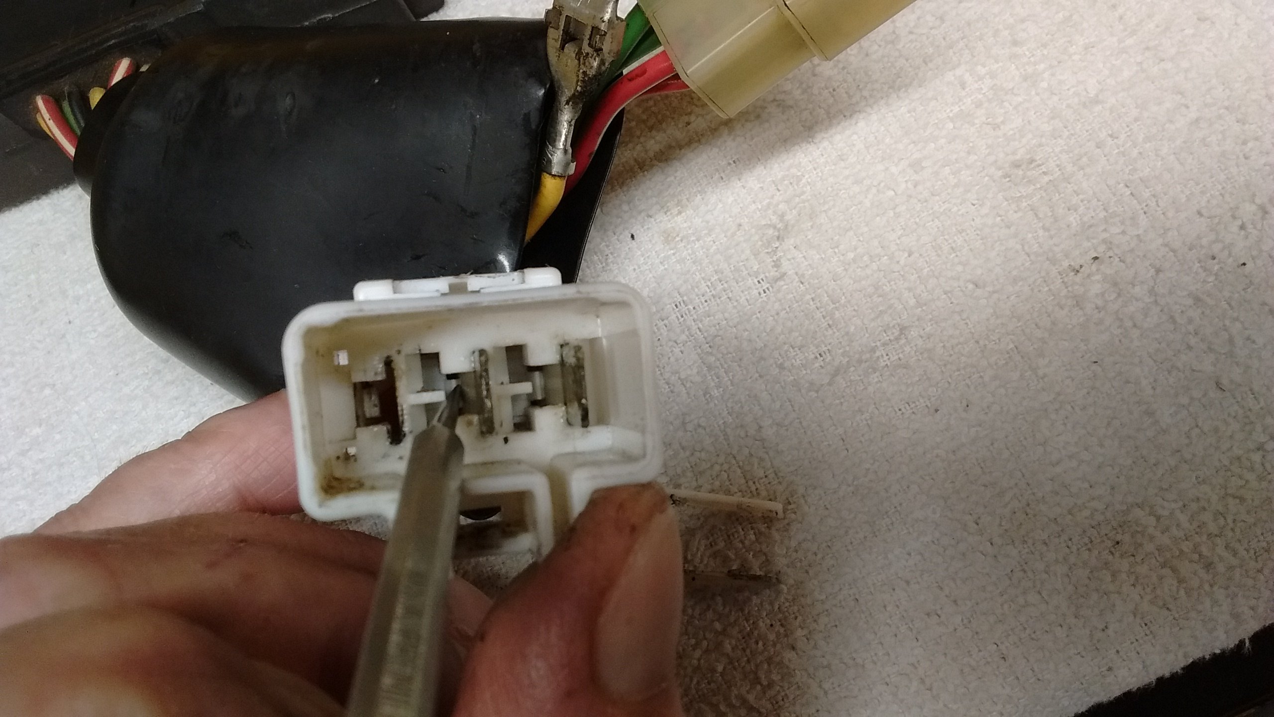

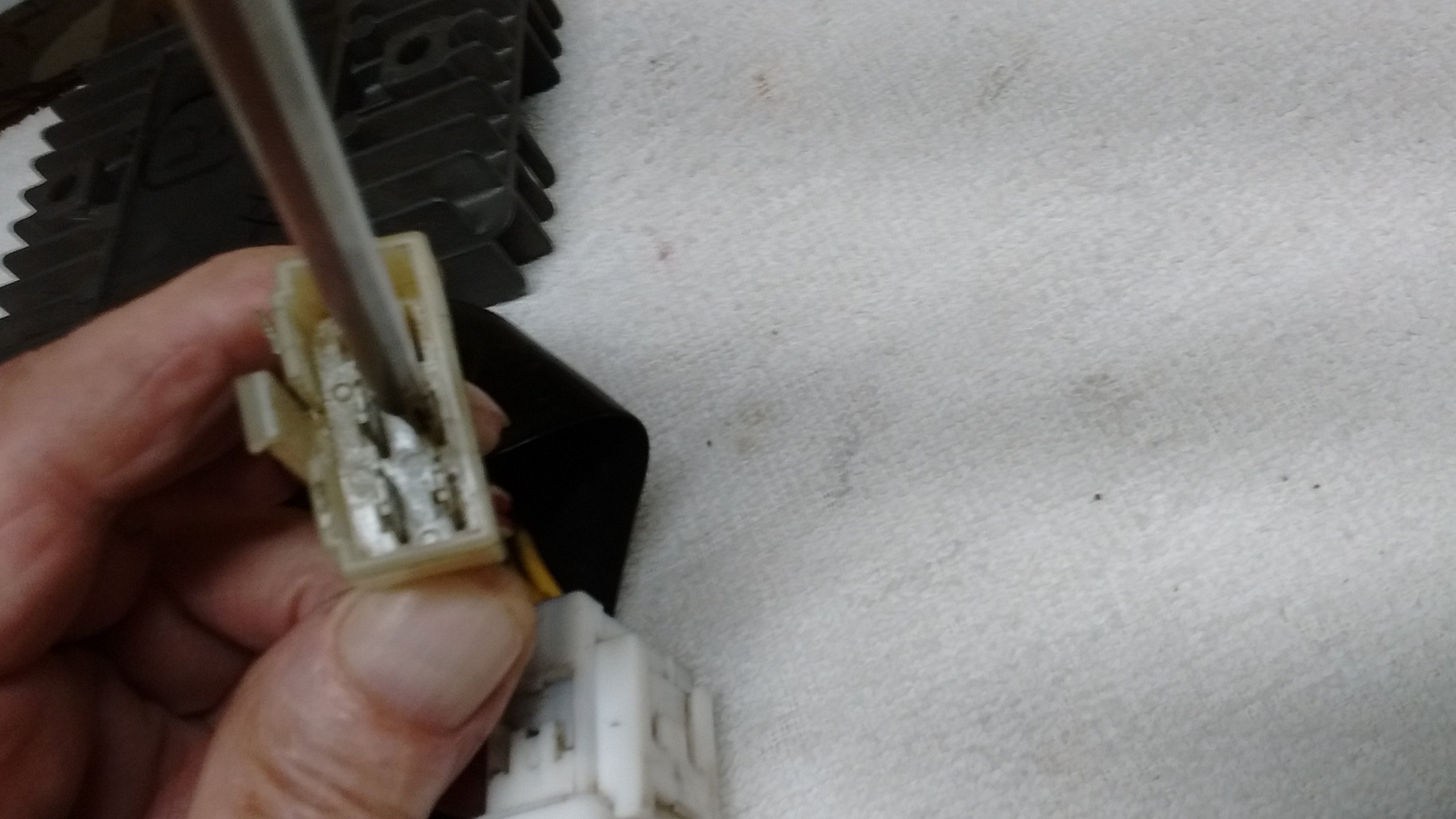

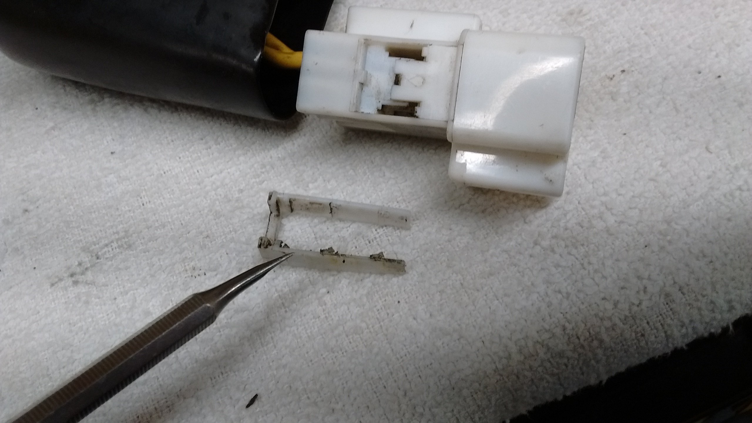

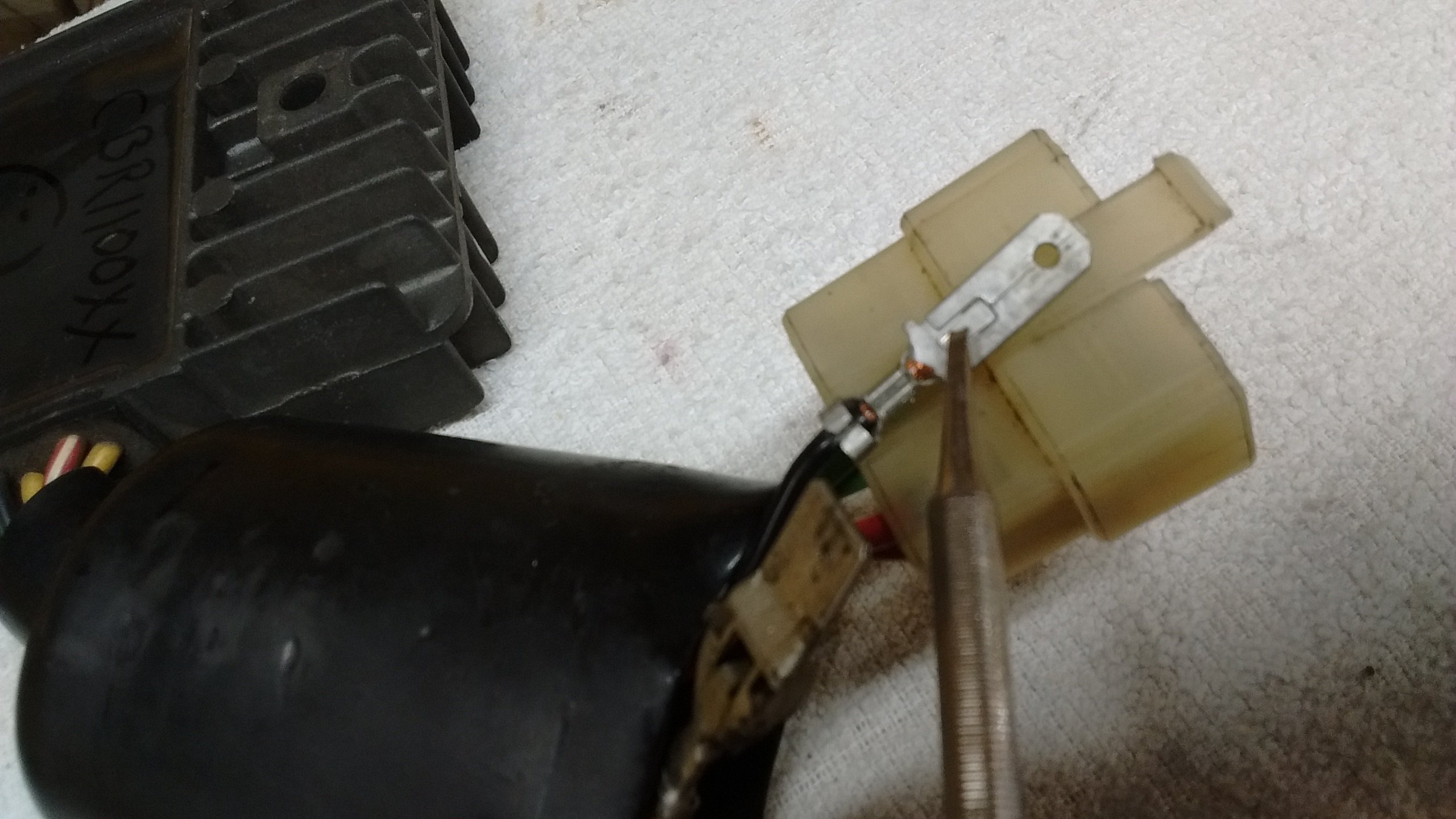

on the cream-colored connector you depress the metal Tang on the Spade terminal. on the white colored connector you remove the u-shaped lock piece and then release the plastic catch at the side of the terminal. H

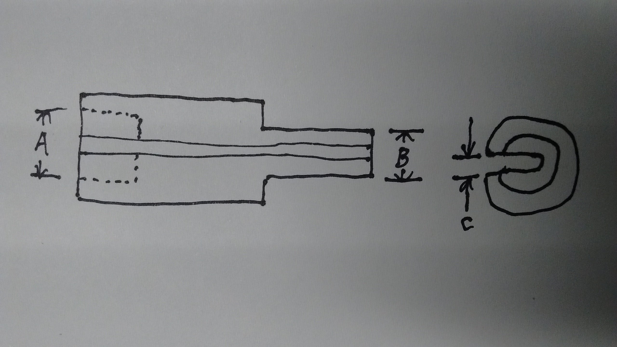

Adjuster extender. If you have access to a lathe it's a pretty simple project. Actually it can be done with a drill motor a file and a hacksaw. Dimension A is a slip fit on the cable sheath Ferrule. Dimension B is a slip fit in the adjuster. Dimension C has a generous clearance on the cable itself.
