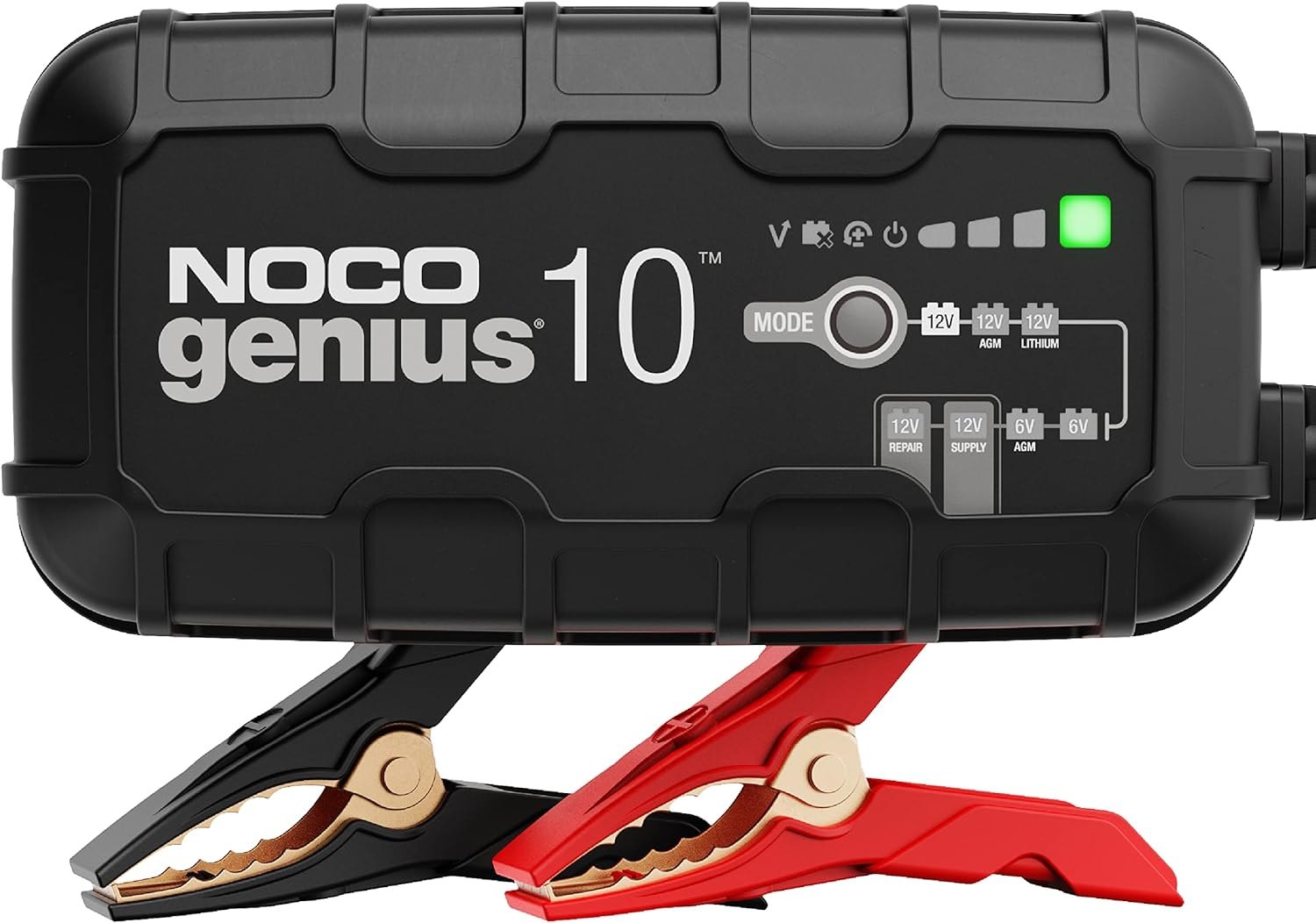

So far, none from premature failure. My OEM BMW battery didn’t last long, but other owners complained that the supplied battery wasn’t that great. I still have it for bench top 12v projects. Mostly, a charger that covers all options is just a few bucks below one that does everything. My current charger was around $30 when I bought it. For that price, all I can find now is a one-trick pony 12v trickle charger.
So is your strap on. Well, the BMW and lawn equipment that have batteries don't get enough use to keep the batteries peak. I used the zero-turn mower this week for the first time...I used the charger to ensure the battery was topped off after sitting for several months. The BMW will need to be topped off once a month (at least) if it sits because the computer does draw constantly scanning for the key fob.
My existing 6V/12V trickle charger works fine...that I can tell, but I'm debating getting a newer one. After all, it is from WalMart and must be from around 2005-2006 when I got it. Then it cost around $35 (IIRC). Amazon has this one for just under $100. The main benefit over the lesser model that will work on the batteries I have is that there are a few more options on this one. Thoughts? https://www.amazon.com/dp/B07W3QT226/?coliid=I2ID6J5UHC4MSU&colid=AWDUQRHHEGGR&psc=1&ref_=list_c_wl_lv_ov_lig_dp_it
