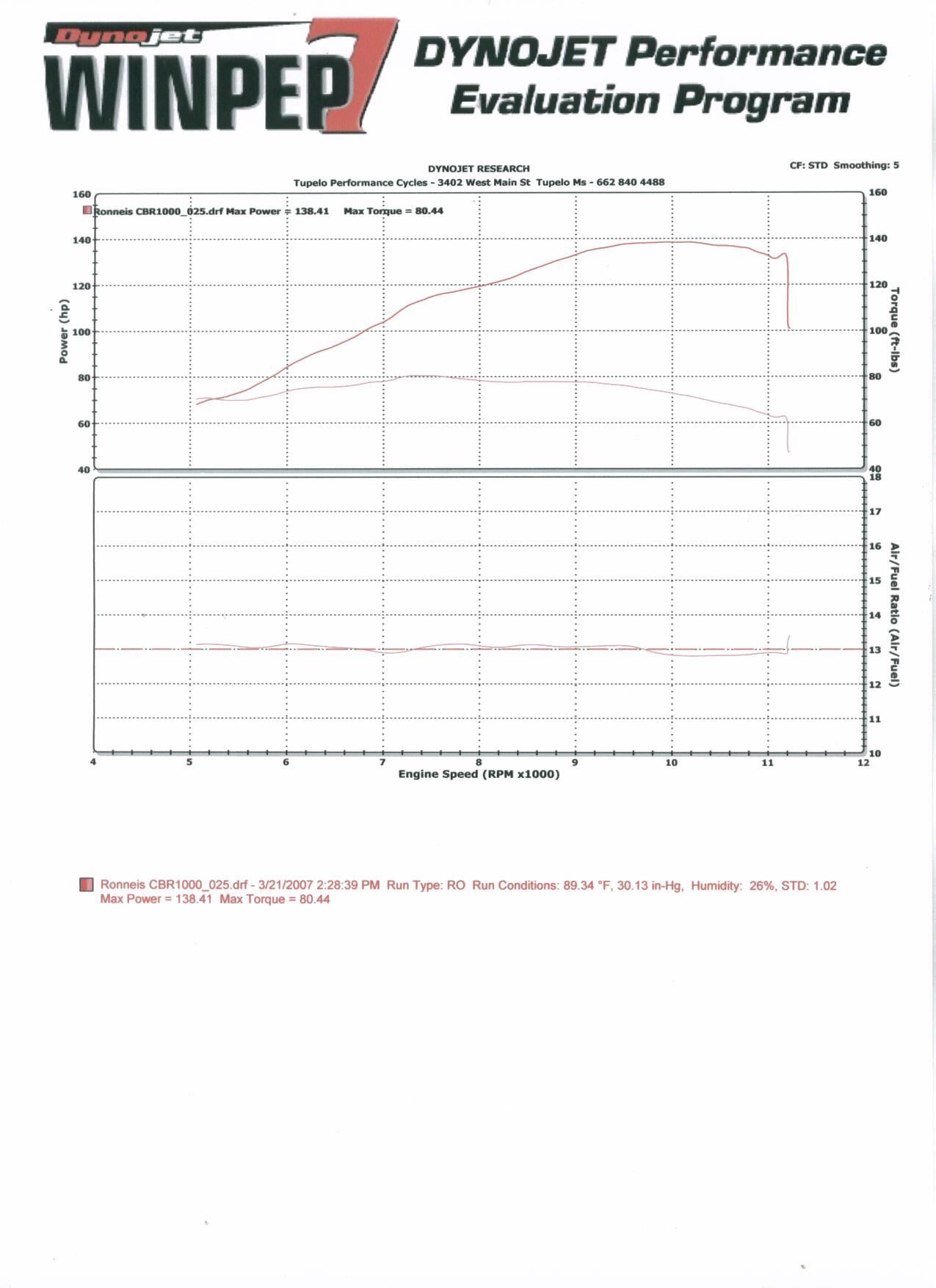

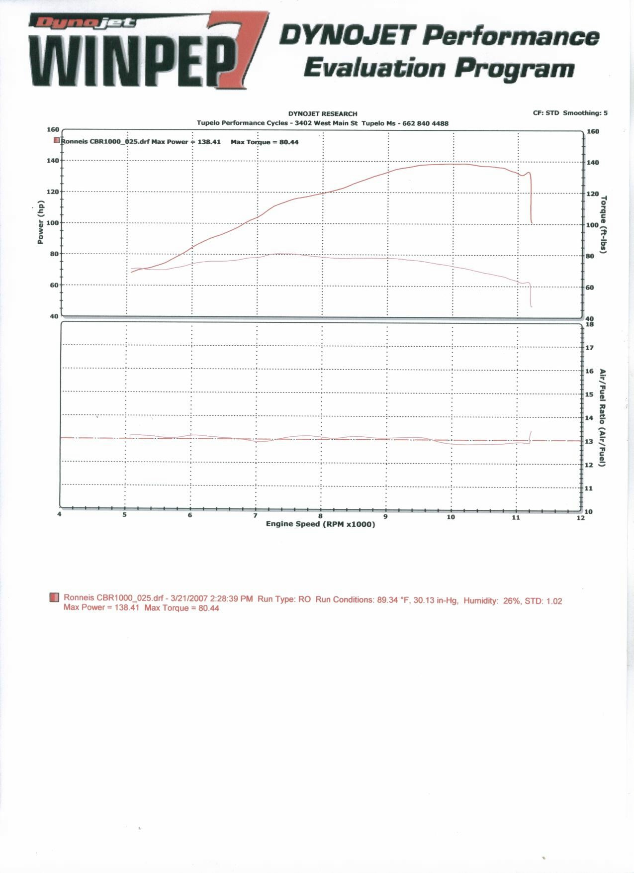

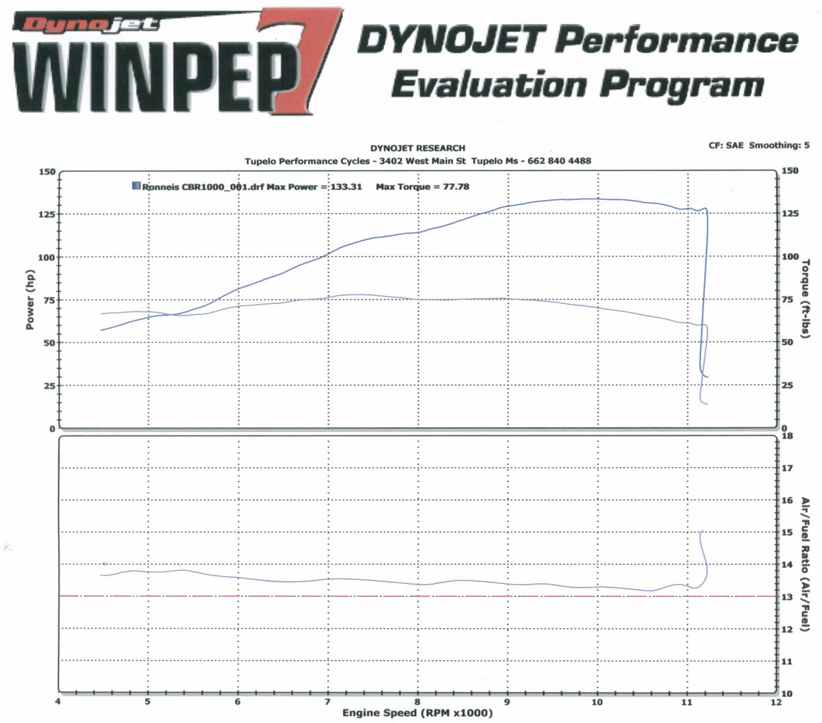

just got back from having my dyno done on my XX. Stock with PC-111 usb new, K&N filter new, new spark plugs, Erion slip-on. reg. gas, 34,000 miles not as good as some have reported these are corrected with map from Dyno Jet, it was running lean HP 132 troque 77 with custom map HP 138 torque 80 I do think it was worth the money. it is more response below 6.000 rpm. from say 4,000 to 8,000 it will run better and smoother. from 40 to 80 is better 60 to 100 is much quicker. 125 is as fast as I got it up to. from 60 to 125 is nice this is where I think the money spent was worth it. all test speeds were shifted at 9,500 Ron
I just got back from haveing my XX Dyno. PC didn't have a may for my setup, I went with the one you got from PC. It was off on my set up it was running very lean. I got it dyno and it made a big defference. pick up 8 hp over PC map. I would go for a coustom map. it is worth the money. IMO
