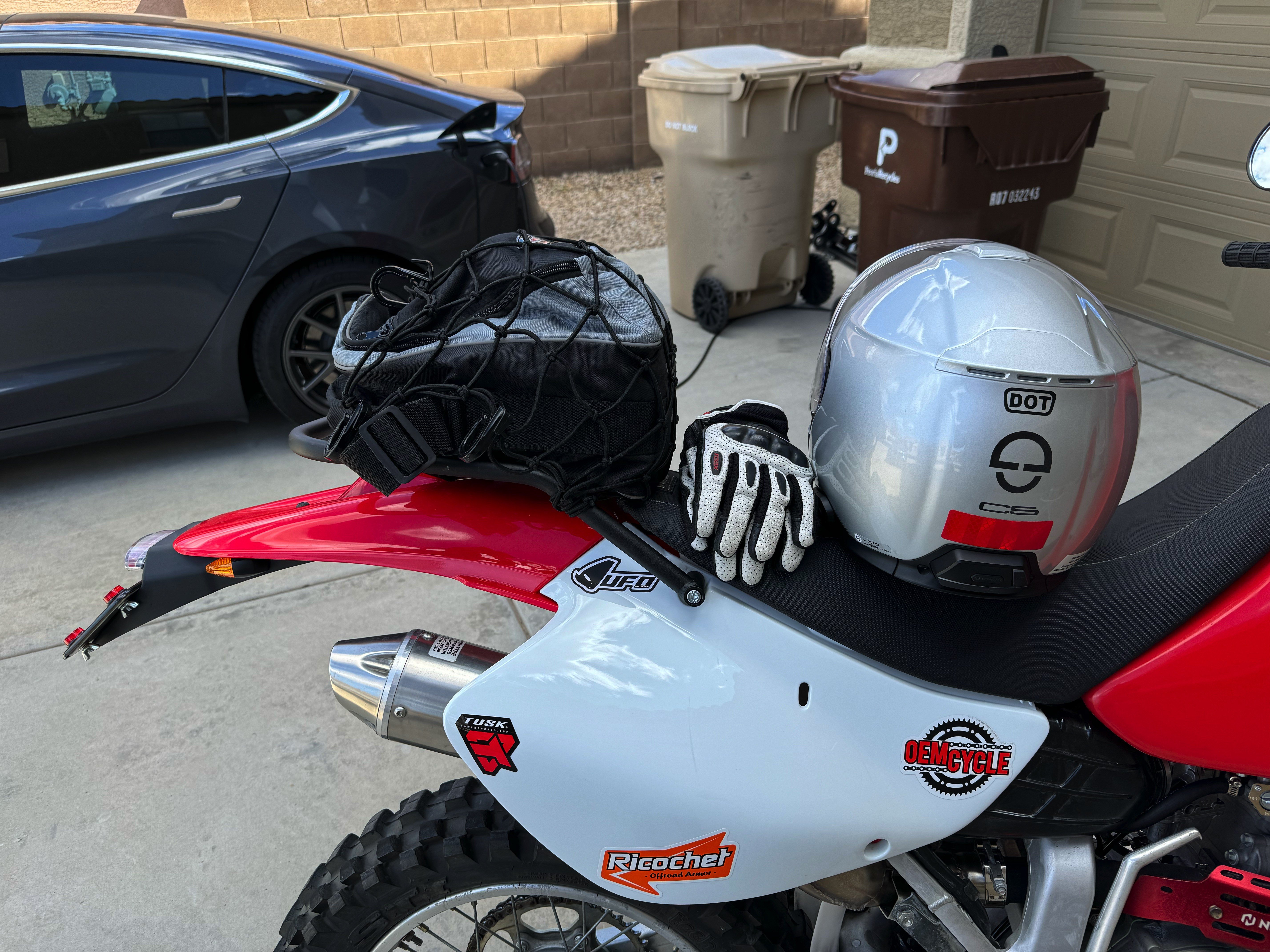

  4. The throttle is super snappy and linear now. I rode out of my neighborhood for the first time today, rolled on in third gear, and took the front tire right off the ground. I then proceeded to go ahead and give it the first crash, why not? Opened the throttle in second on a slow turn on dirt, and it stepped out way more than it should for being lugged. Good shit. Not a great highway bike, LOL. It's skittery even just on the streets, like it's on ice sometimes. Little imperfections in the road move the tire around. It's weird though; the tire moves as if you're about to die, but the bike doesn't. Meaning that the actual feeling through the bars is like the tire is sliding, but the bike stays pointed where it should. Going to take some adjustment, but I think eventually I'll just tune it out. It was way less shitty at 90 than expected. Oh also it feels slower than it is; so at what my gut says is 30, I'm doing 35, and gut 50 is closing on 60. I can usually get to a speed really closely. I don't have the speedo hooked up so I did some passes on a speed sign. One kick starts, hot or cold, but not when flooded. So when I dumped it, it flooded, and took quite some effort. This is the downside of the pumper carb; I need to figure out how to best un-flood it. If loud pipes save lives, I'm invincible. I need a better bag for grocery-getting. Or do I say fuck it and put one of my existing Givi mounts on there? Seems so wrong.

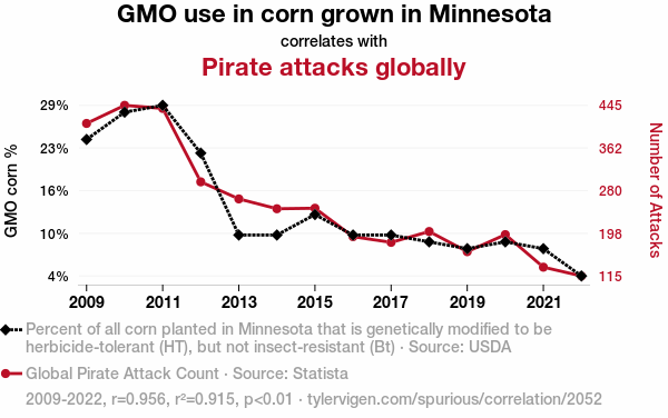

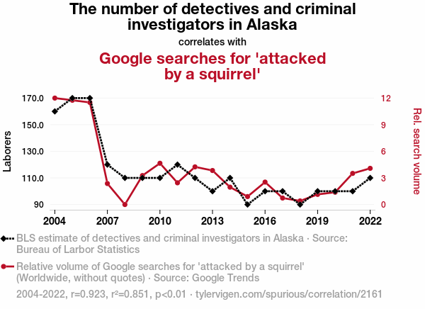

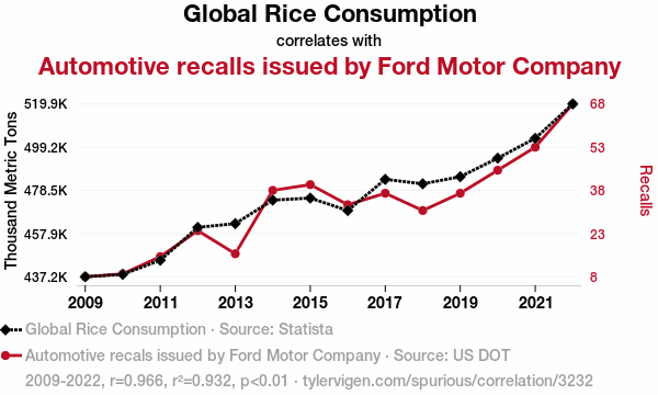

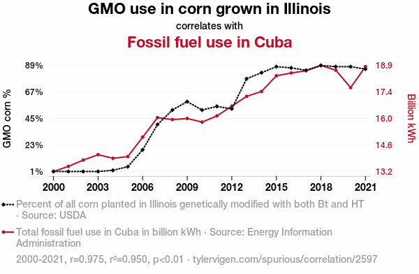

  8. Everyone in the meeting when I presented this thought it was carpet installers, working on a drug and alcohol stereotype about them. The number of carpet installers in AZ does correlate with... The number of robberies in AZ Petroleum consumption in Ireland Popularity of the first name Kasey

  15. Kickstarter and foot peg, didn't fall over. The bike is perfectly stable on the kickstand, and you start it that way. It's weirdly hard to knock over. Neither the kickstarter or pegs are sandal-friendly.
  16. Started on the second kick with the brand new carb. Restarts hot or cold in one kick. Success. “The way to know if you’ve adjusted the accelerator pump correctly is if you can do third gear wheelies on demand.” LOL I did a short ride around the hood and found the steering to be heavy as fuck and also jittery, so I raised the pressure but haven't ridden again. I was at about 28 and 32 front-rear, and now at 34 36 to see how that does. Neighbor came by later, at whisky-o-clock and wanted to hear it. I was wearing Fivefingers, not boots, but hey, worst cas...... But it did start. There was no mount for the enriching knob, easy solution...
