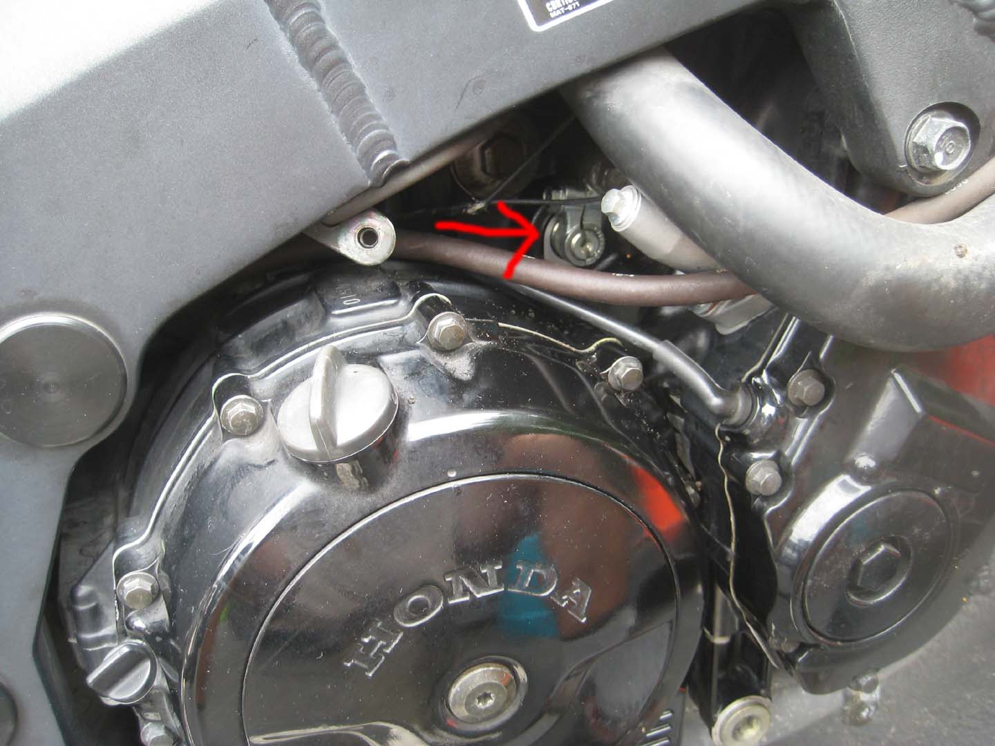

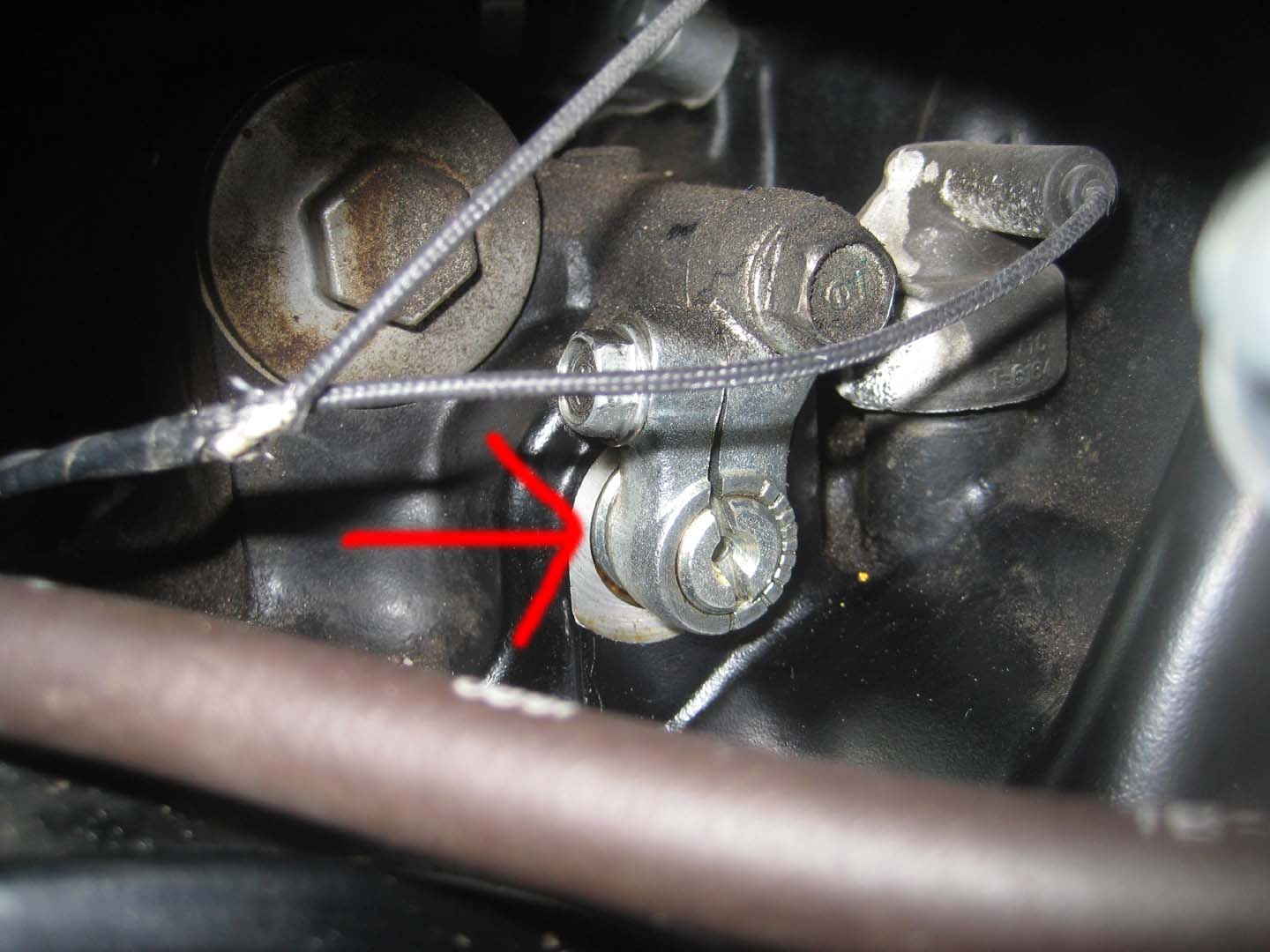

I've been trying to trace a small oil leak and i think I may have found it but not sure. I have the shop manual for my'97xx but cant seem to find what this may be. Any input will be appreciated. The first picture is for reference. Next is of the area itself I think the leak is coming from.
I was just going to shoot some pictures of Brent's engine as I am putting that part together. I will see if it is possible to change that o ring and not have a problem..
ok, I will put the pictures up in a little bit, but, it should be no problem to take the holder bolt out and turn clockwise till the dot on the shaft is down and pull it part of the way out. Then take the holder off and remove the oring, put a new one on and reverse. Make a note where the dot is on the shaft so you can return to the original location.

but, don't pull it all the way out, just enough to change the ring
installing this balancer it seams to me it is held in place by it self, pretty much, and will not go anywhere, if you pull the shaft. Just to be sure, don't take the shaft all the way out.

Finally got around to replacing the seal this morning. Toughest part was getting the old seal off. Thing was like concrete. Probably only a 30 minute job including plastics if it wasn't for that. Other than that it was very easy.
