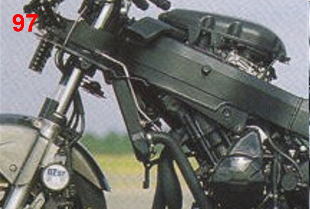

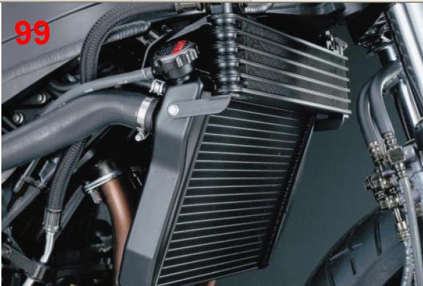

Madcow Posted January 2, 2007 Posted January 2, 2007 My bird has gone up to 232 in city traffic. I've read that the 97-98 birds with carburetors run cooler. This is what i've found, the radiator core is 8mm thinner on the FI bikes that's like taking a 3 core radiator & reducing it to a 2 core, & the radiator is lower so it's closer to the exhaust. 3rd picture isn't very good. [attachmentid=5850] [attachmentid=5851] [attachmentid=5852] Quote
