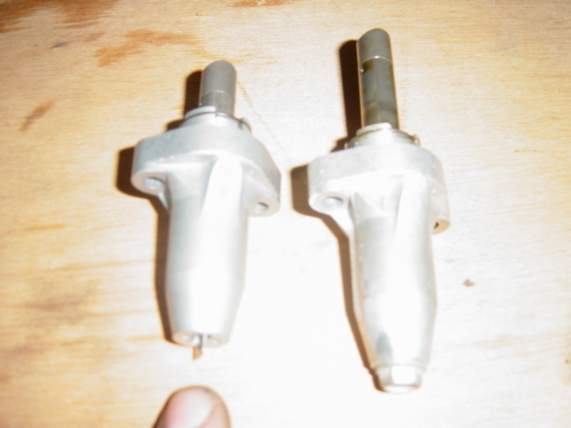

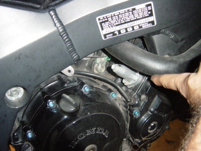

Jaygermeister Posted March 28, 2006 Author Posted March 28, 2006 Easier than changing your own oil. You don’t even have to take the right side plastic off if you don’t want to. Two little screws that’s it. here it is...... you can see on the new one (left) it has a "key" in the tip of it that keeps the piston/cam in place till it installed. Once on/in the bike you pull out the key and the spring inside unwinds and pushes out the piston/cam to hold tension on the can chain guide. Then put the little dust cover nut on and your done. Easy easy easy !!!!!!! Quote
JuXXtin Posted March 28, 2006 Posted March 28, 2006 What's all that hair in the picture #1... actually, what are you pointing with? Quote
Jaygermeister Posted March 28, 2006 Author Posted March 28, 2006 What's all that hair in the picture #1... actually, what are you pointing with? What are you getting at??? don't beat around the bush...... say it Quote

porterb123 Posted March 28, 2006 Posted March 28, 2006 What's all that hair in the picture #1... actually, what are you pointing with? Justin, you beat me to it Jay you are one hairy shit Quote
