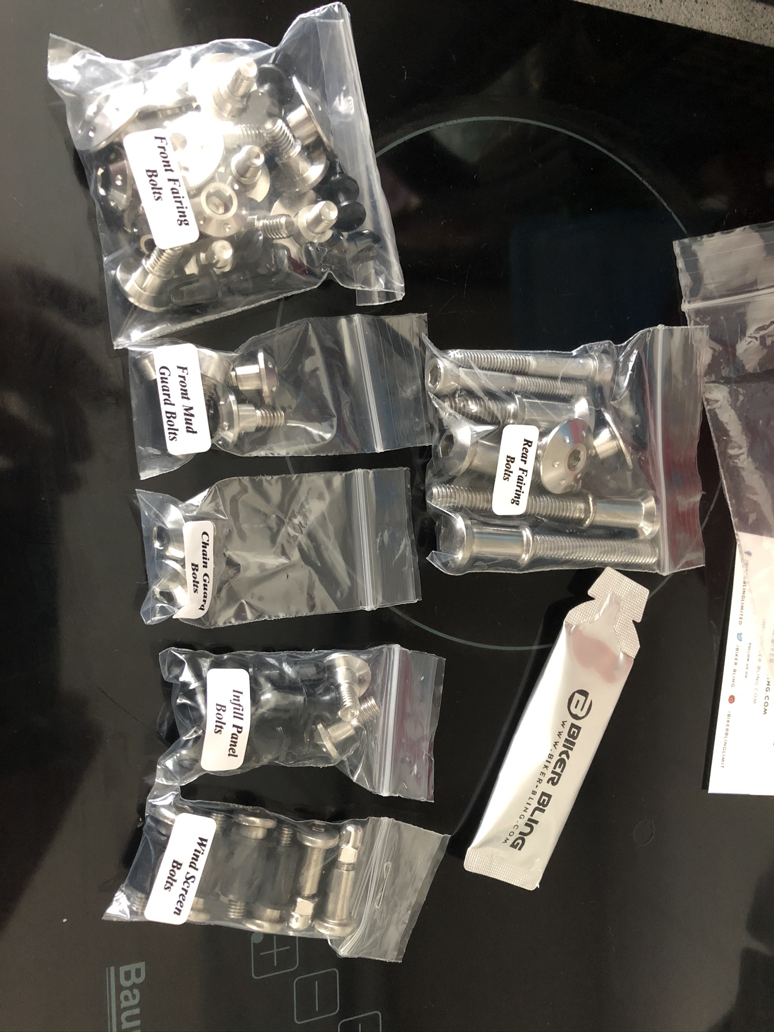

Also, in other news, the new stainless steel fairing bolts from biker bling arrived today.  Looking smart :)

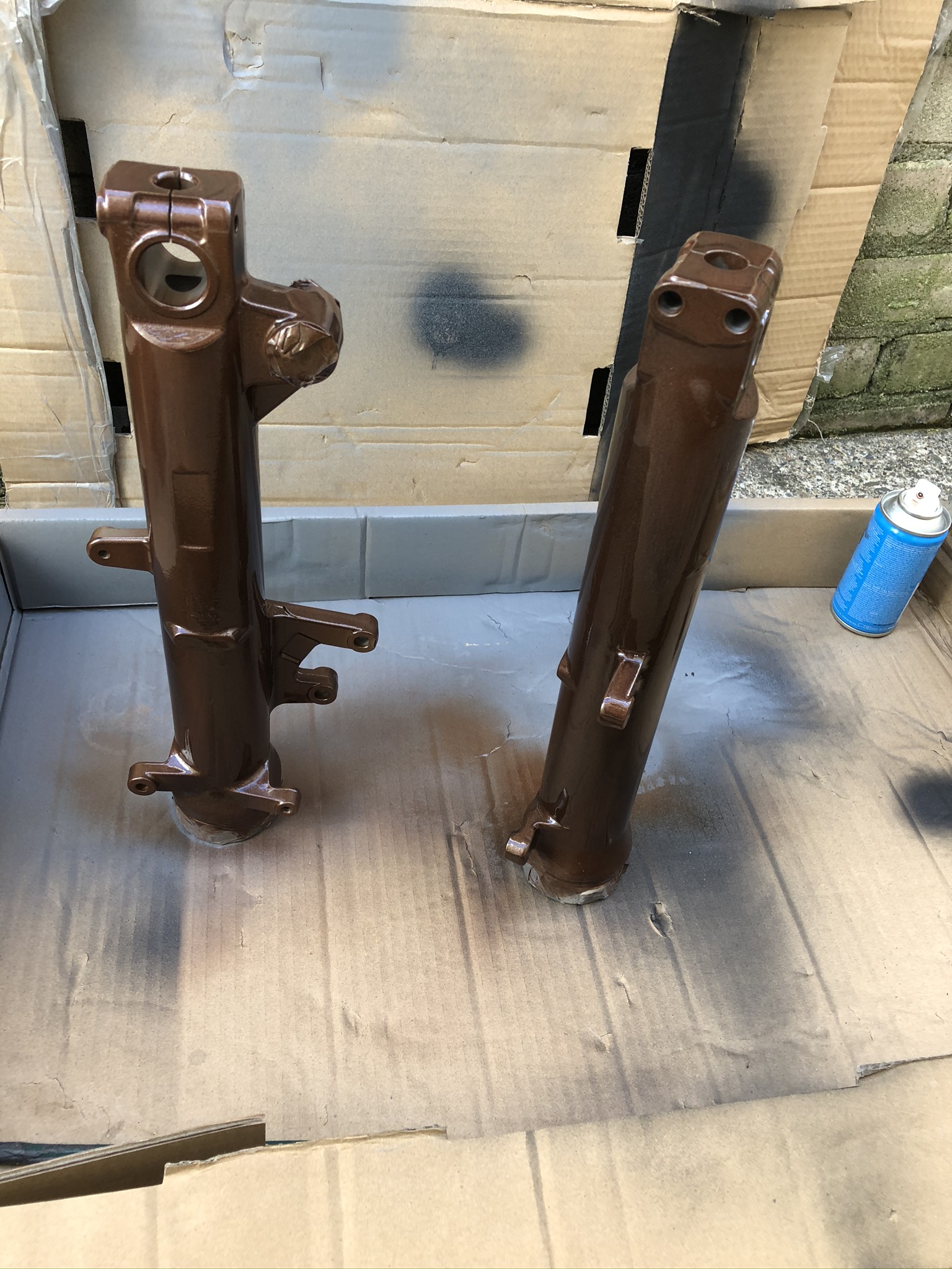

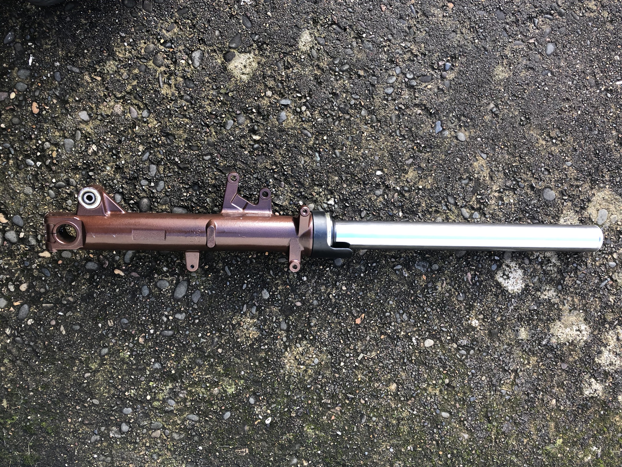

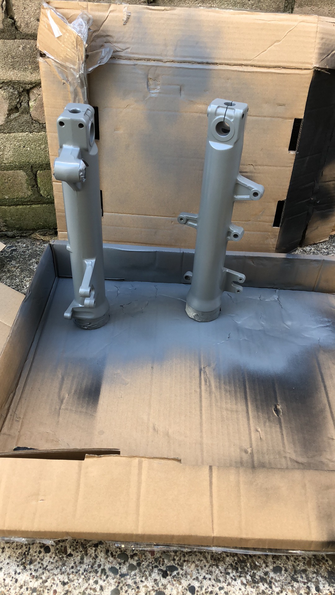

Actually got to do a bit this weekend, finally the legs are repainted in Ford Roman Bronze, hoping it will set off the titanium paintwork.
Layer of primer
And a layer of paint :)
Have also lacquered them.  Looking reasonable, i'm no sprayer so one side has more runs than grannies tights but the other is pretty good.
I'm going to make a recommendation of putting some of that clear self adhesive paint protection film at least on the front half of the fork legs. Should slow down the rock chips and keep the legs looking better longer.

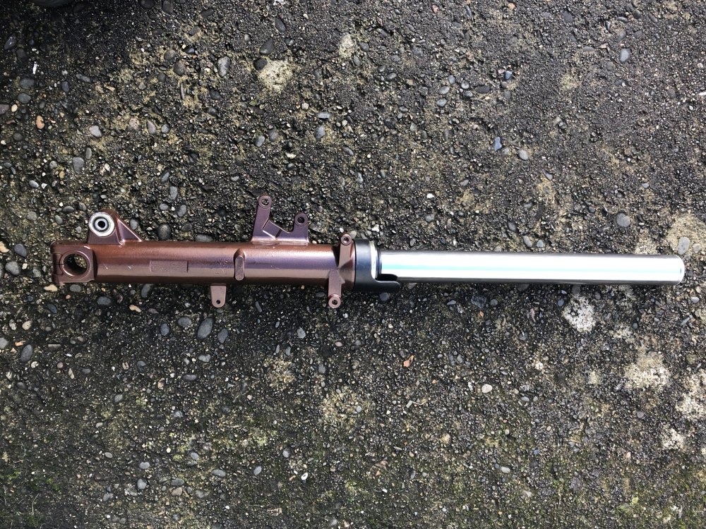

So finally the first fork leg is completed, rebuilt, new oil and looking way better than the old ones.
Have to say, this was painful to get done.  After several attempts to get the new upper bushing in I reverted to the old one, it was in good condition, the new one simply would not go into the seat as it was too thick.
I measured the 486ml of oil in, only to find the airgap was way too big after pumping the outer sleeve and cartridge, it ended up with closer to 600ml, so now I've ordered another litre of oil to let me do the second leg.  Ah well, it's only money right :)
Pushing down on it, it does feel way better than the original legs did.  For now I've kept everything standard in terms of oil and bushings, if I'm feeling flush in a couple of years when these are due for seals I may look at fitting some fancy cartridges I've seen, I'm way over budget now so trying to curb it a little.
Paint job is a little amateur, but then I guess, so am I ;)

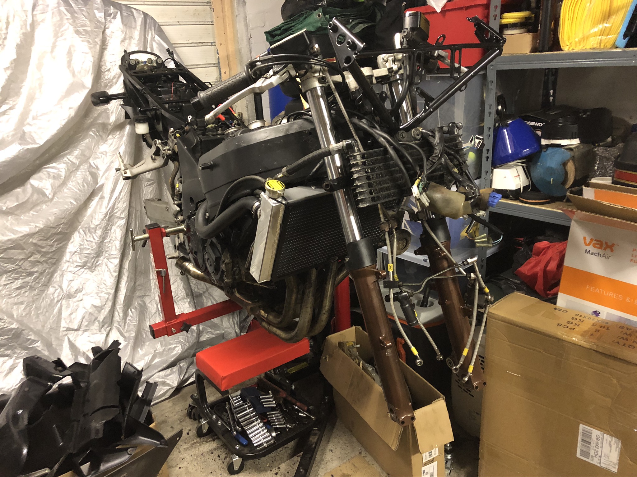

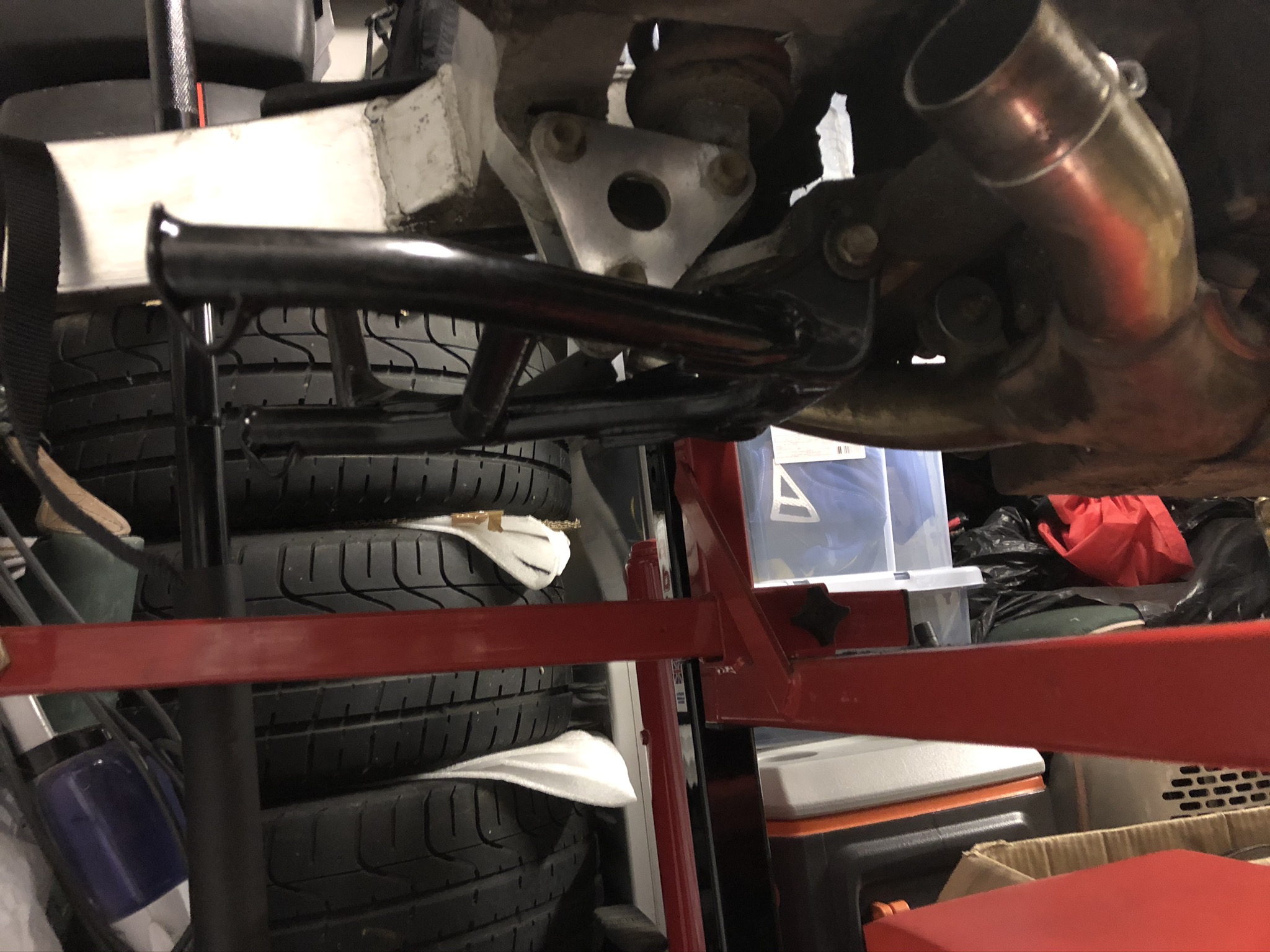

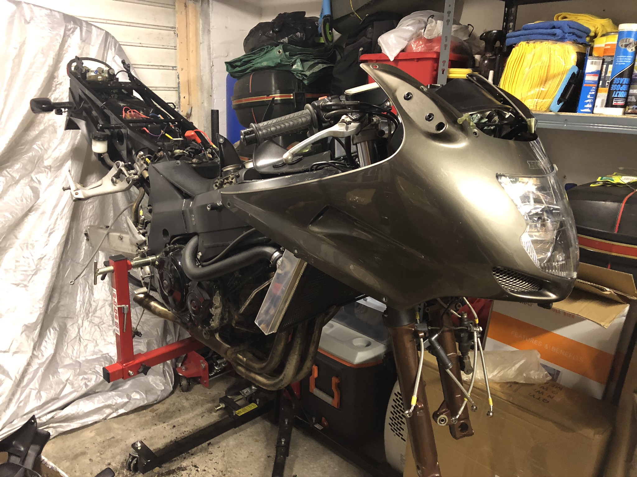

So much more progress this weekend than anticipated, the expectation was to complete the second fork leg and that would be it.  As it turns out I was able to get a little further.
The newly powder coated centre stand is on, the exhaust and radiator are now reseated and tightened up, I had to loosen them to allow access to the left centre stand bolt.
After that I decided to offer the fork legs up to the bike, those are now in and torqued up correctly
Finally, the upper cowl stay has been refitted, another part I had powder coated for this rebuild.  The wires have been routed correctly since this photo was taken :)
Getting the fork legs back on makes me feel like I've really made some progress, feeling much better after this.  I'm off work next week so should get a few solid days in on it as well.

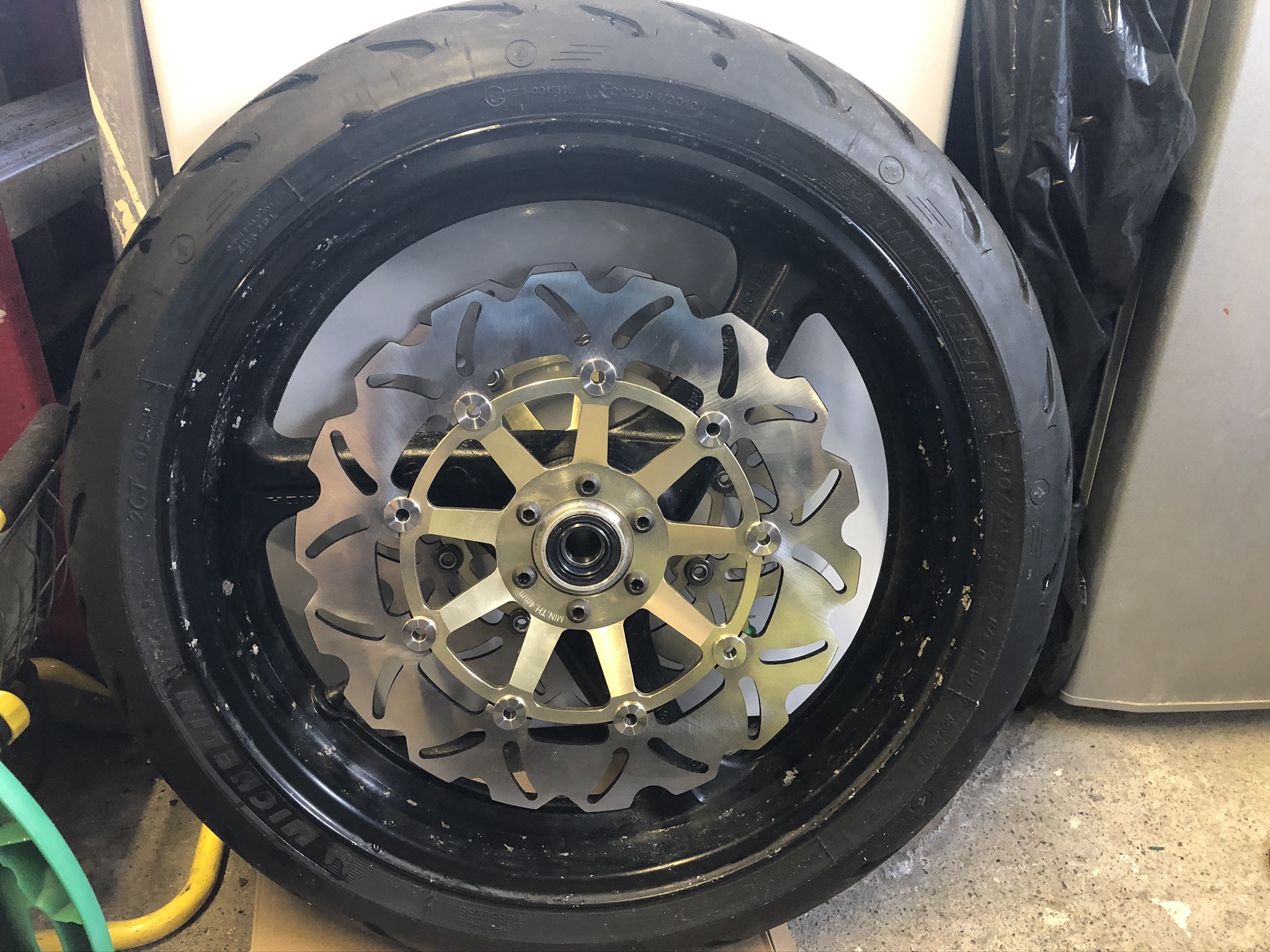

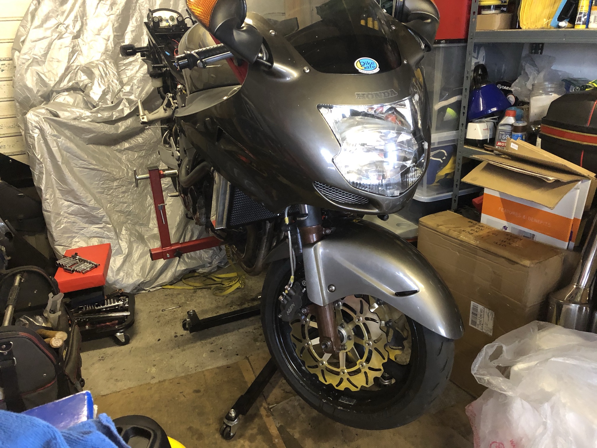

First job was to clean both wheels and fit the new front disks.

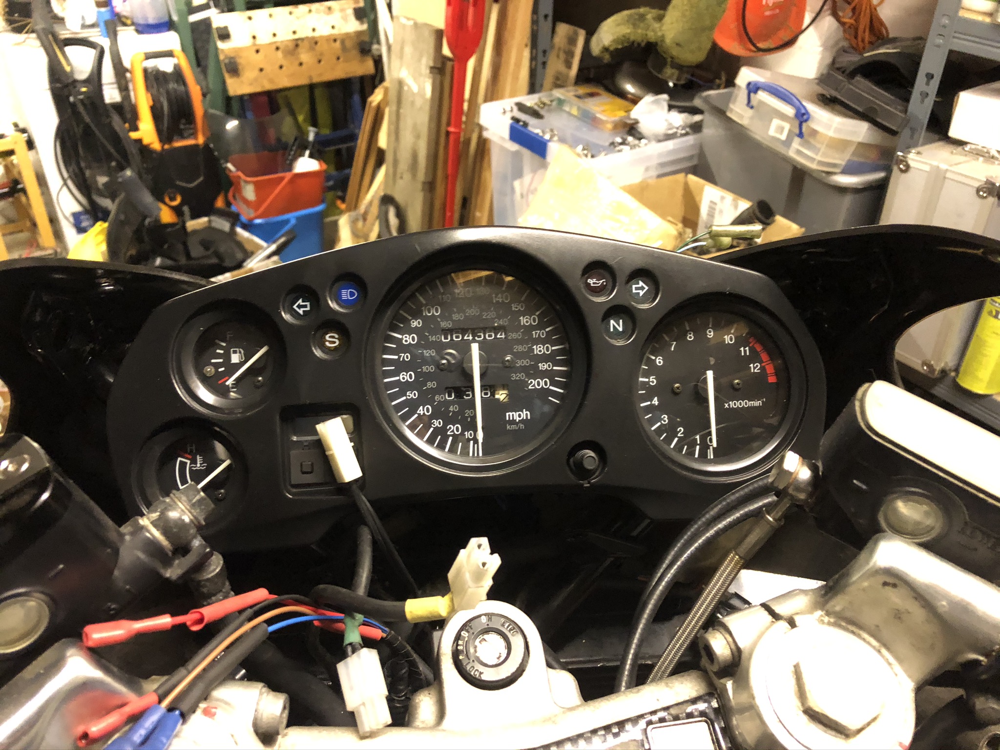

Then the clocks went on

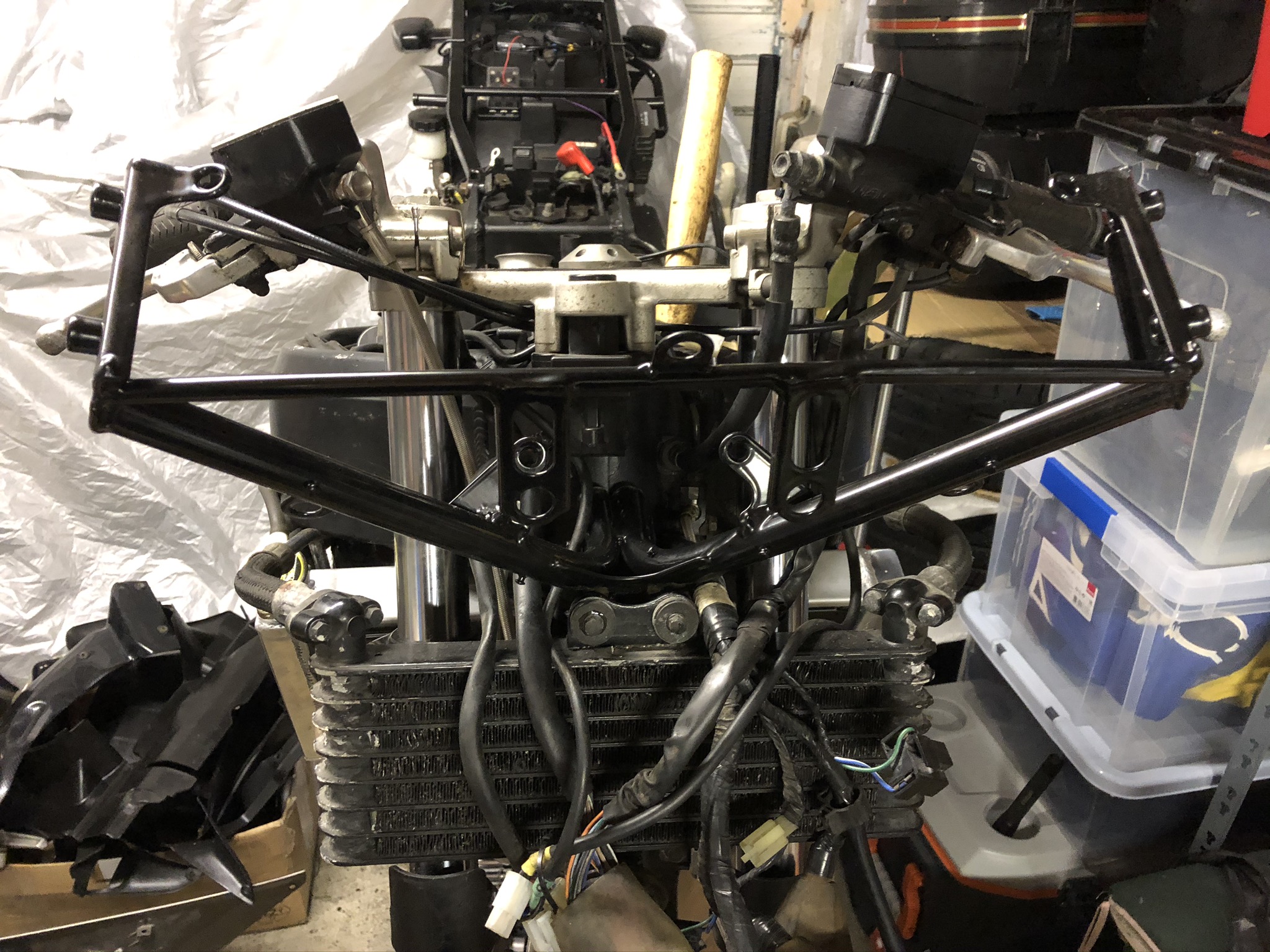

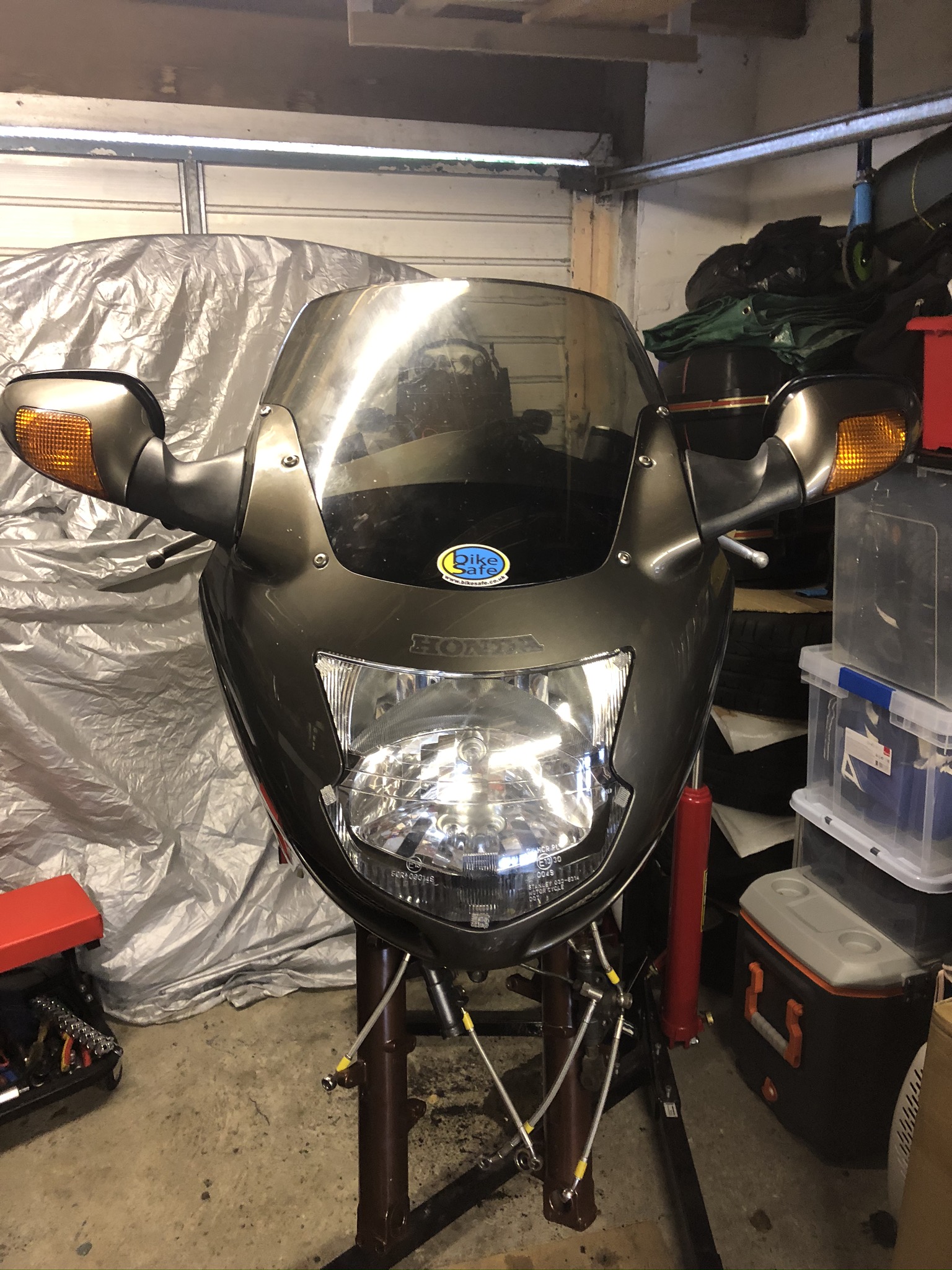

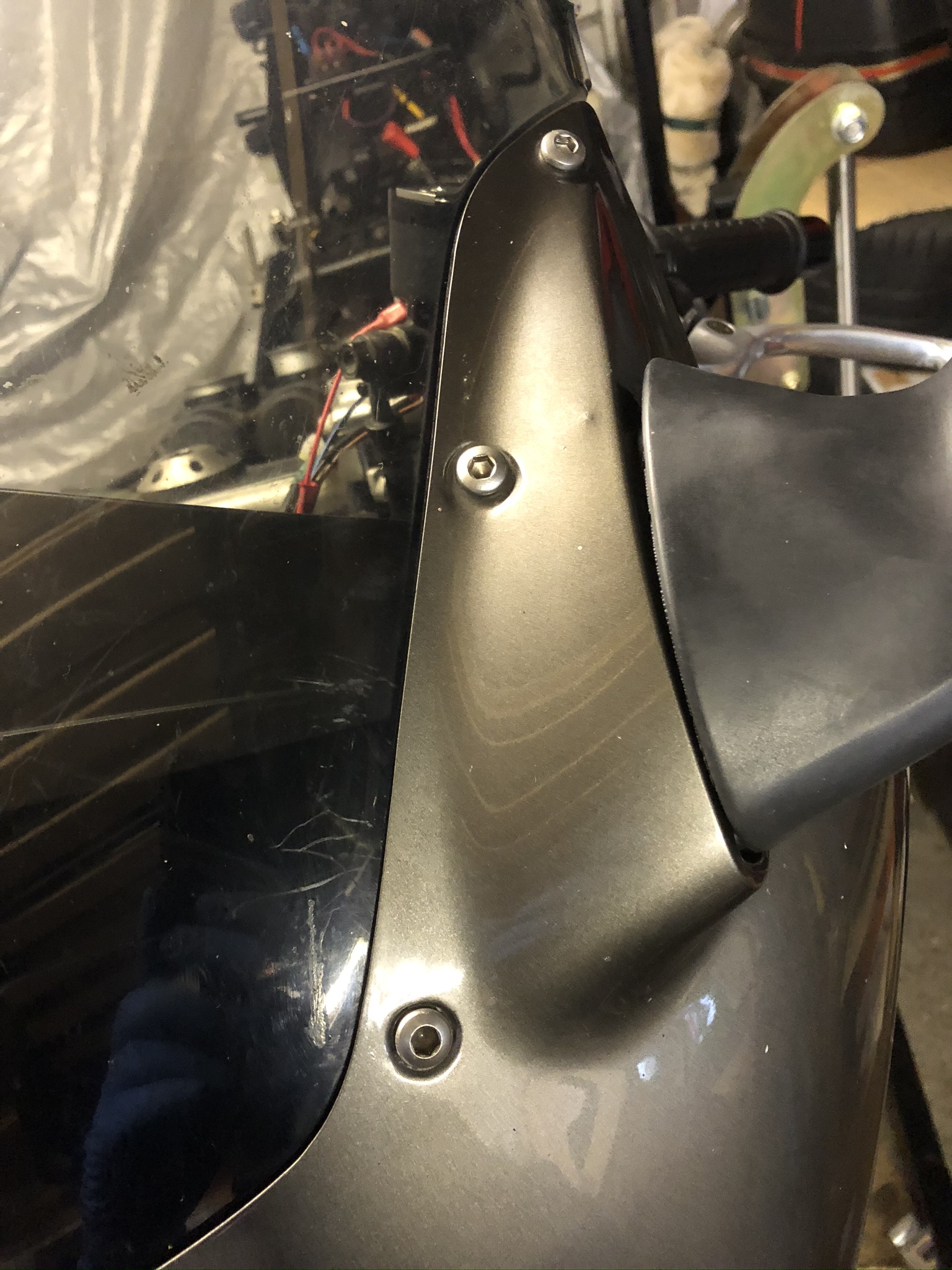

Followed by the upper cowl on to the stay.
And the mirrors...

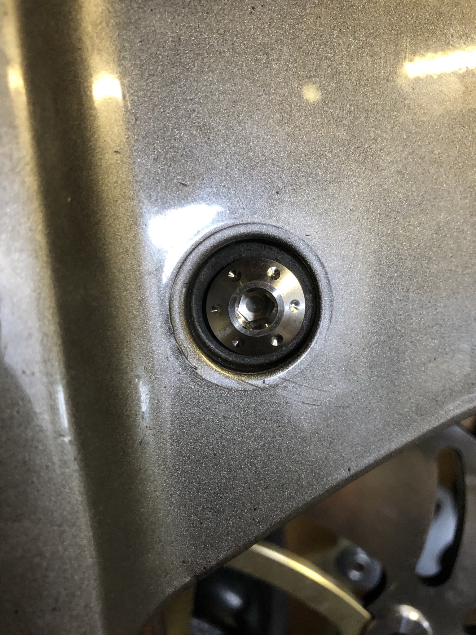

All fitted with new stainless steel bolts from Biker Bling
And to protect the bolts I also have stainless steel bits.  Not cheap, but typical high quality from Wera.
Infill panels went in next, those of you who've done this before will notice the glaring error at this point.  Yep, they had to come back out so I could fit the airbox 🙄.
New Accessories infill fitted, wires have since been wrapped

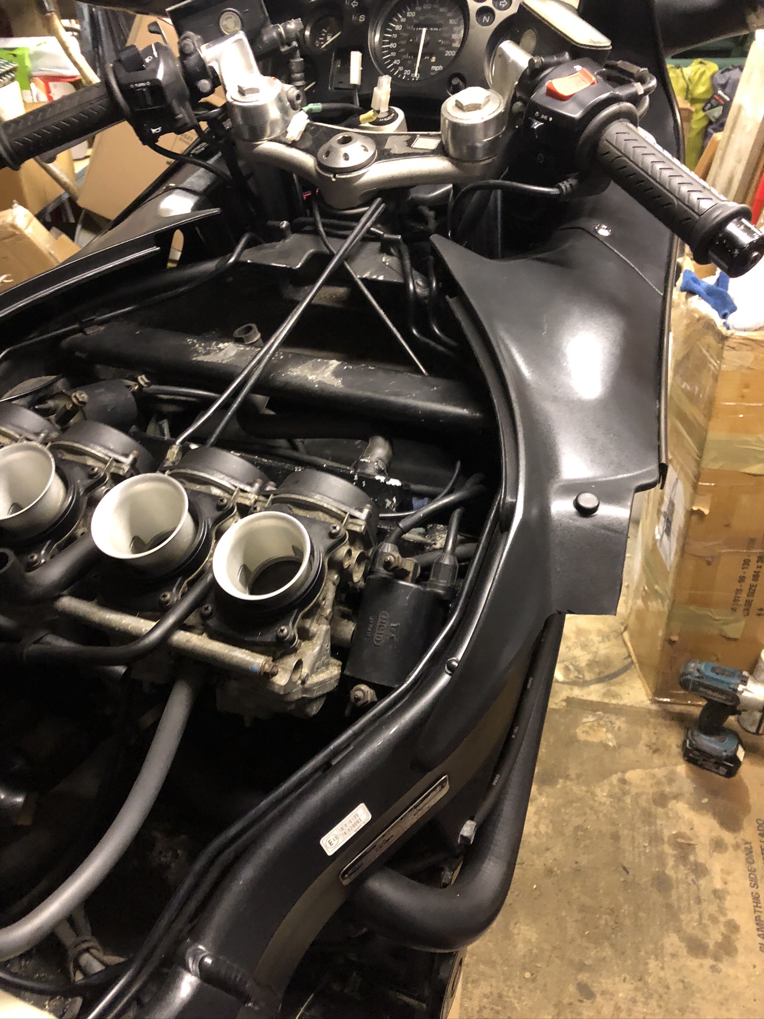

So at this point we're quite a bit further on, airbox and tank are now in place.  One of the carb vacuum screws had been removed to fit a scottoiler at some point in the past, when the oiler was removed, the vacuum pipe was left in place and open and it could suck air in, this has now been removed and a new blanking screw fitted.

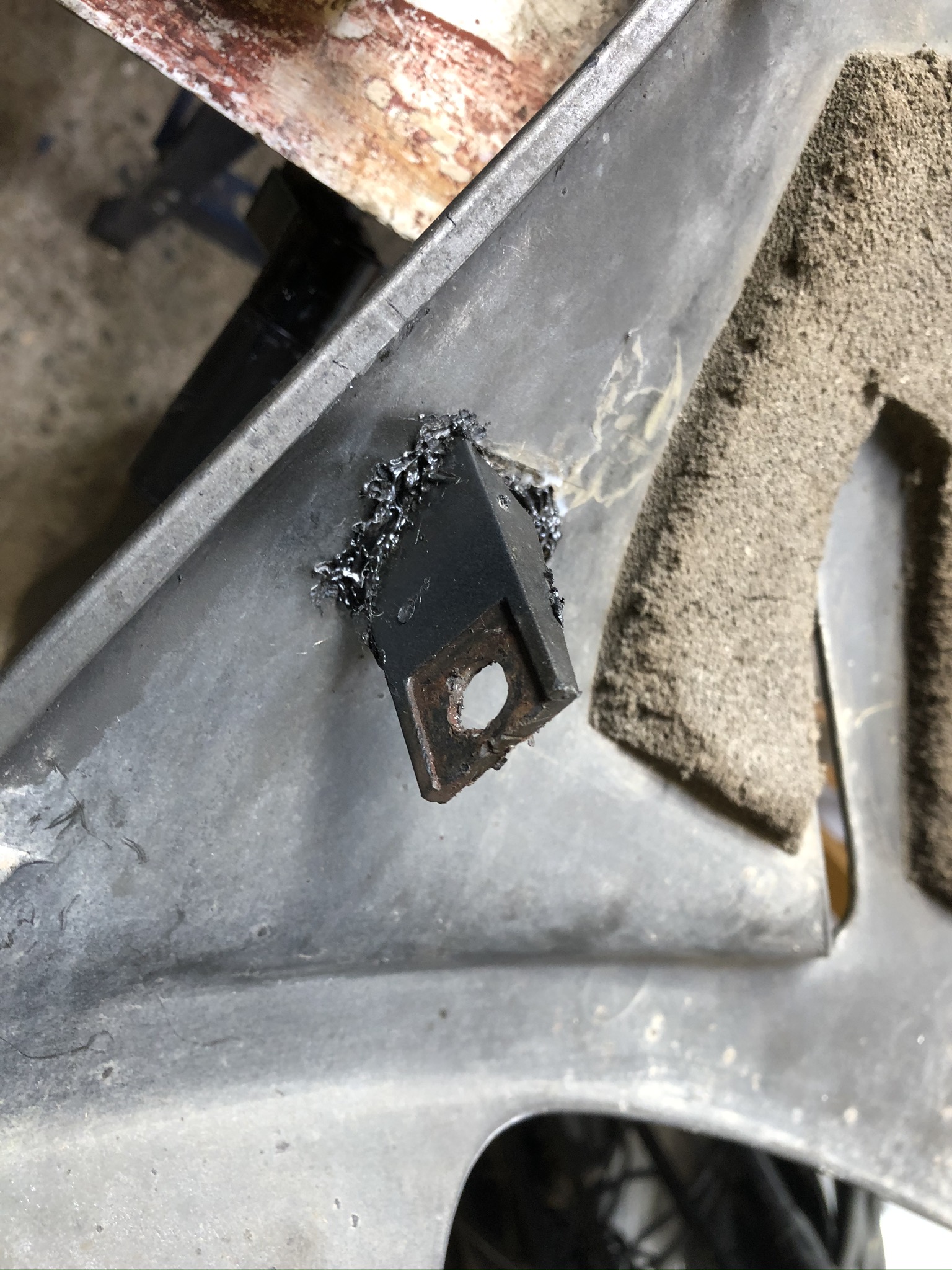

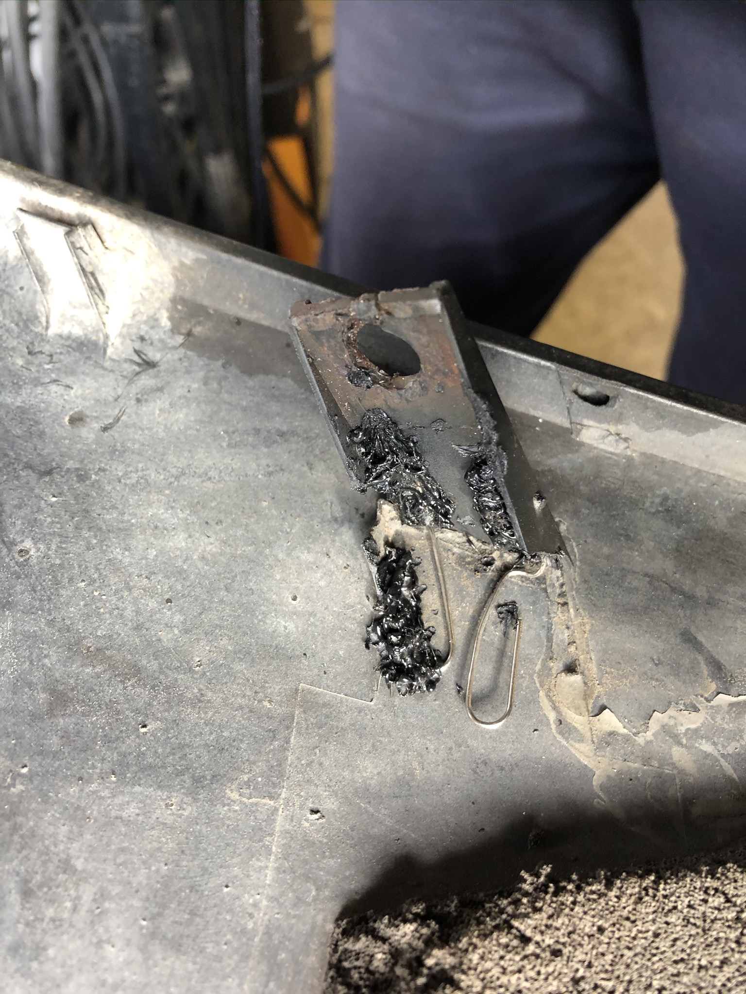

One of the tasks I hadn't looked forward to was plastic welding the side panel to V-panel mounting point.  It was completely detached with virtually nothing left on the side panel to mount to.  Paperclips enter stage left...
I used cable tie offcuts as welding rods, not a pretty job, but very strong now.

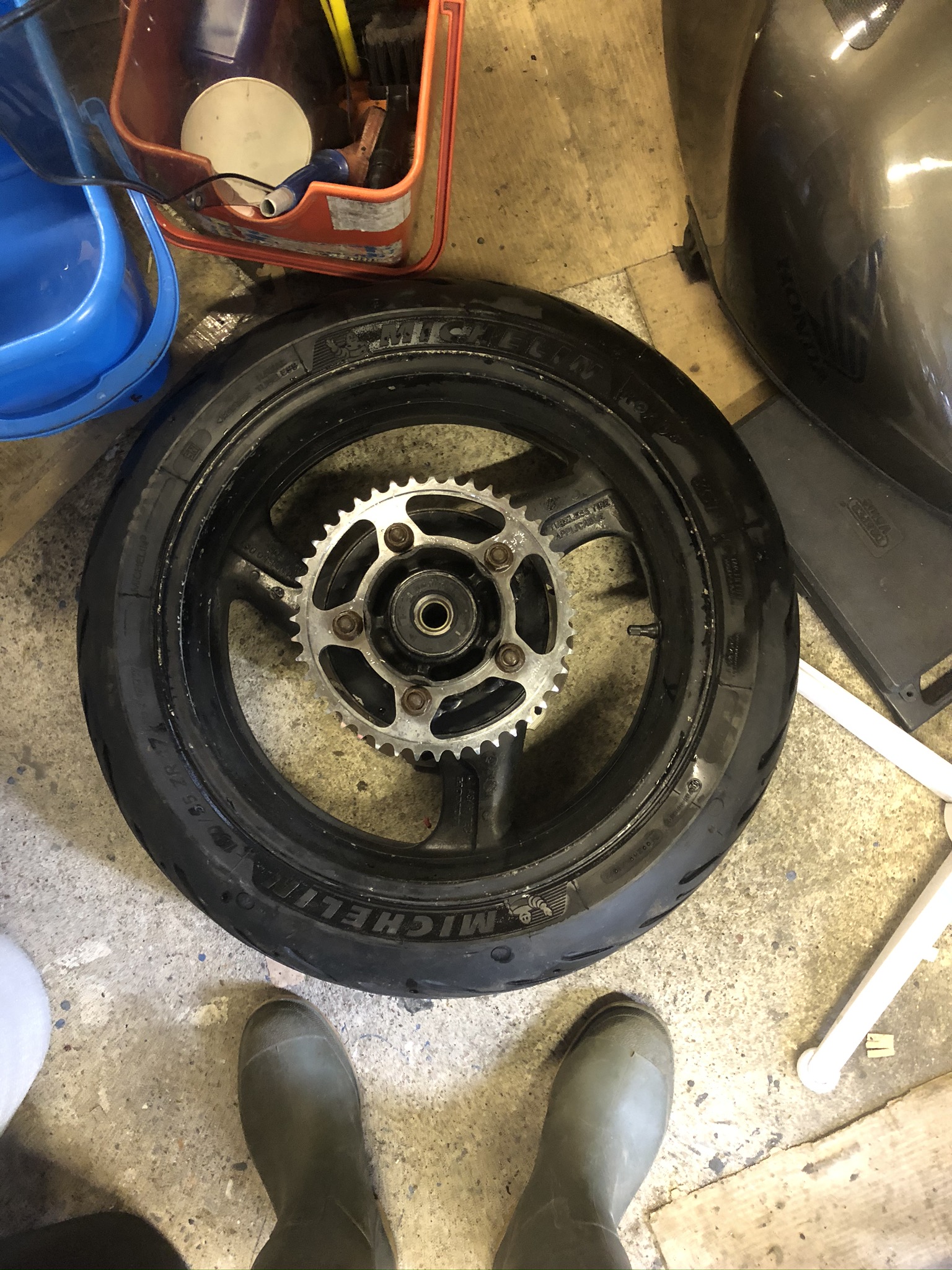

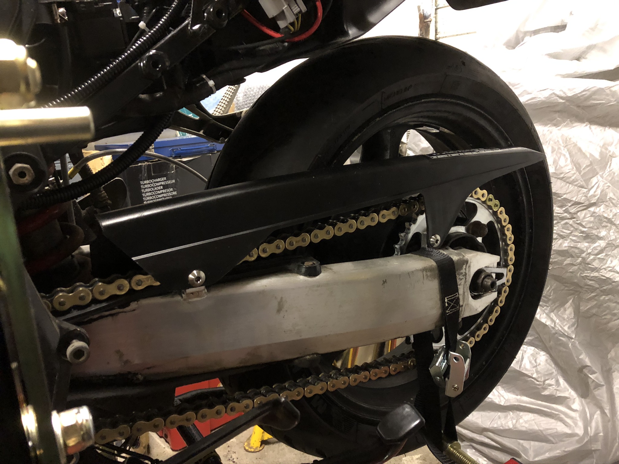

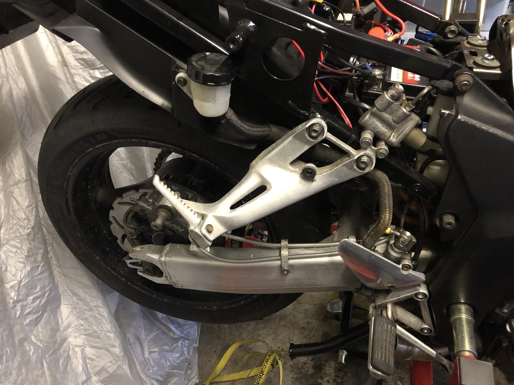

Rear wheel mounted and aligned, and new chain tensioned.  Back to an original chain guard instead of the poorly fitting hugger that was installed, at some point I'll invest in a decent hugger.  Chain monkey laser alignment tool and tensioner, absolutely brilliant.

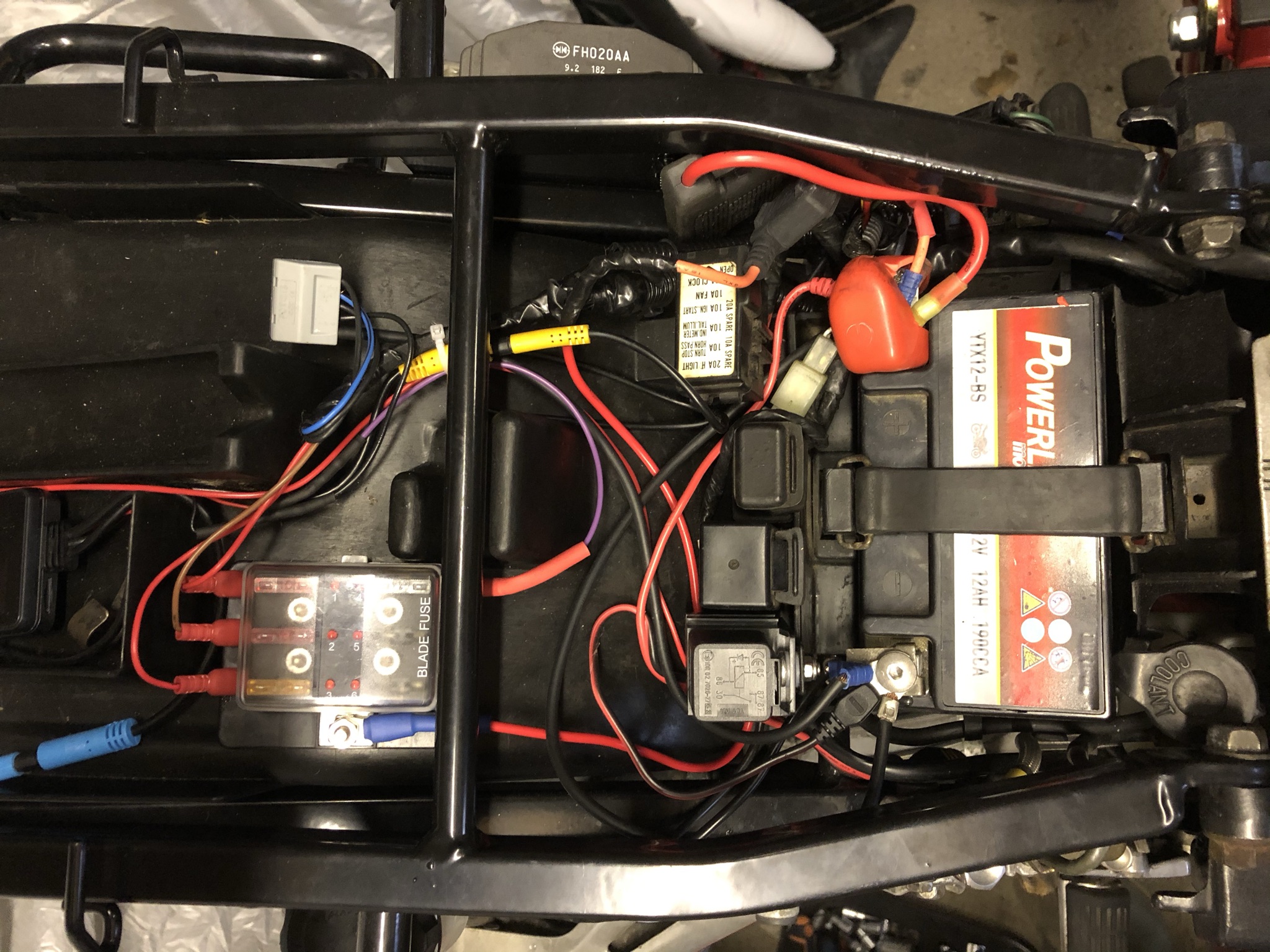

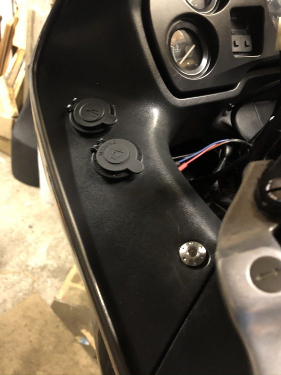

The wires still need a little tidying but the new relay and fusebox are in and connected, I've fused the line to the accessory fusebox at 30A (Fusebox rated at 40A), currently using 26A of fuses in total, I could reduce the USB sockets fuse to 5A which would leave me 9A of capacity for future use, cameras are on a 1A fuse.  4 of the 6 ways are currently in use so there is space for some low power future additions if required, a rear accessory port comes to mind for passenger use.  A few extra battery connections were required, (Reg Rec / CTek Port / Relay) so I have fitted slightly longer screws to the battery terminals and they sit fine.

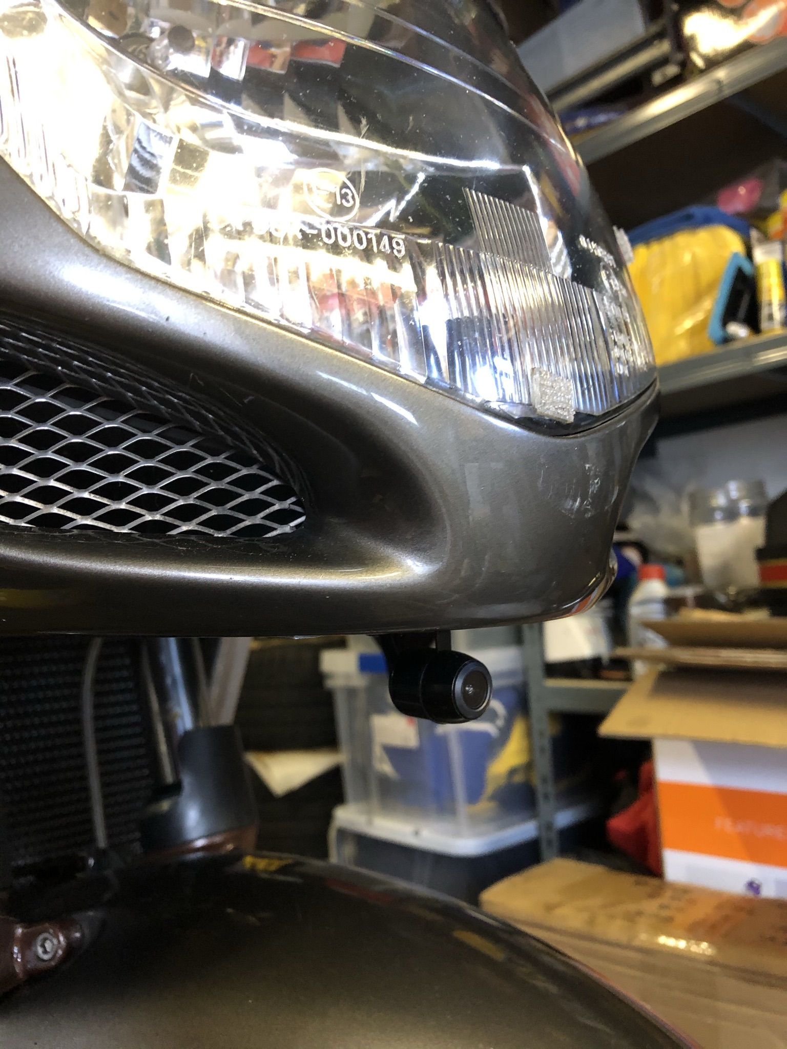

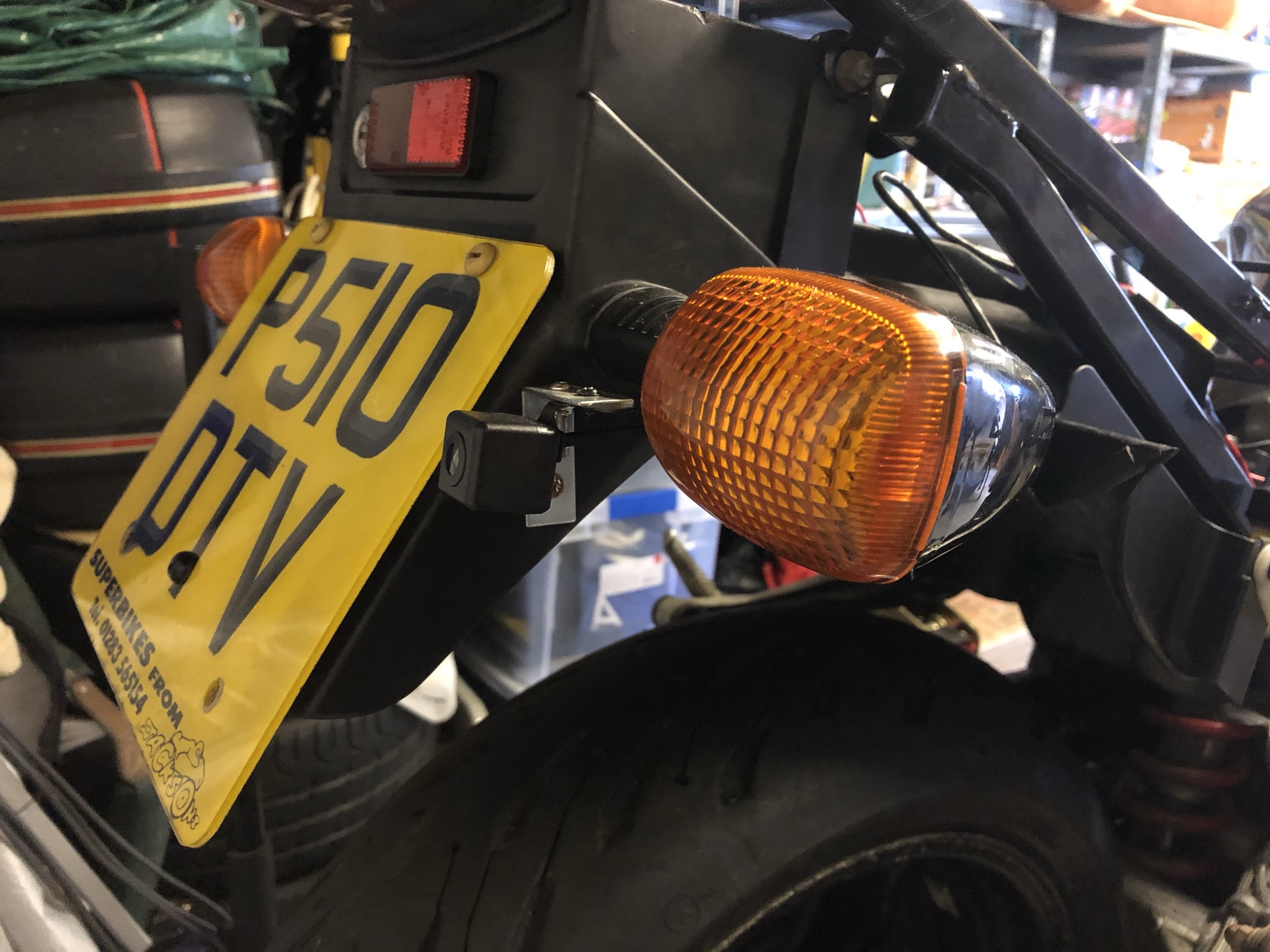

Cameras have been set up and located.

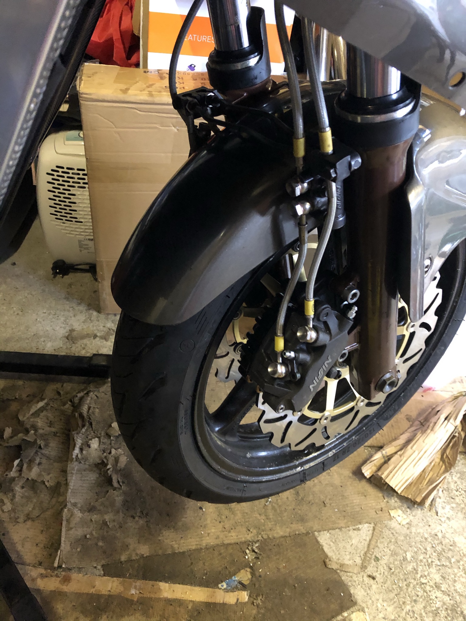

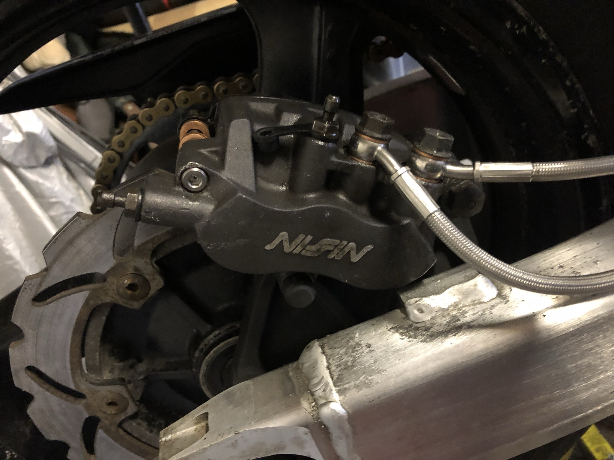

Front and rear brakelines done, calipers fitted and awaiting bleeding.

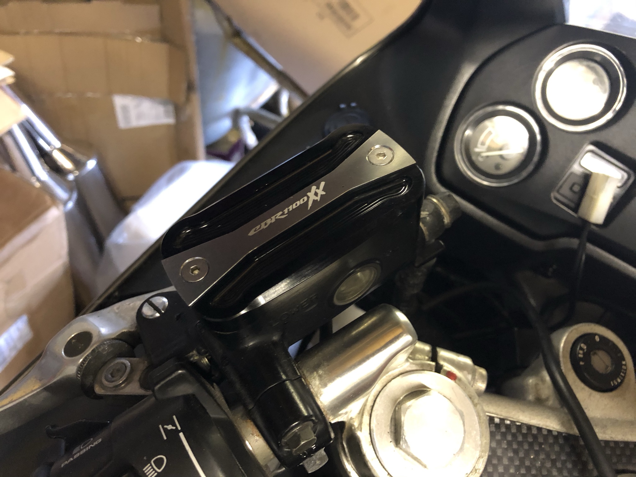

Fancy clutch fluid reservoir cover, have the same for the brakes.

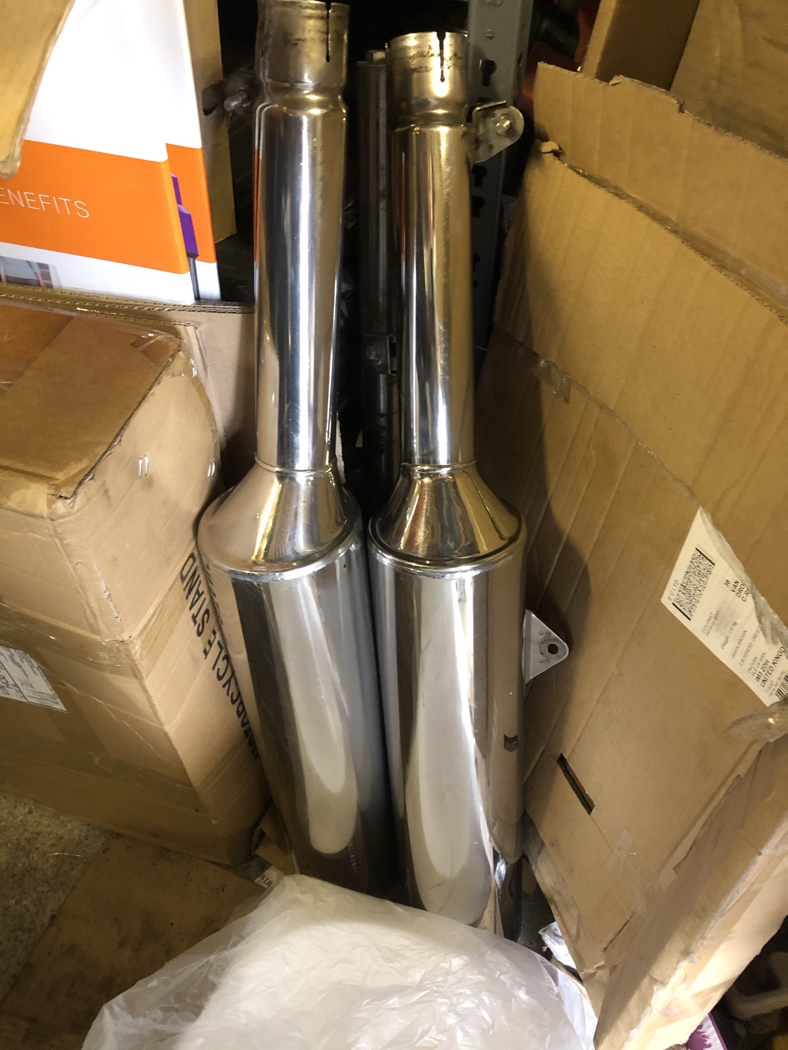

Cans are polished and awaiting fitment.  Far from perfect but way better than when they started.

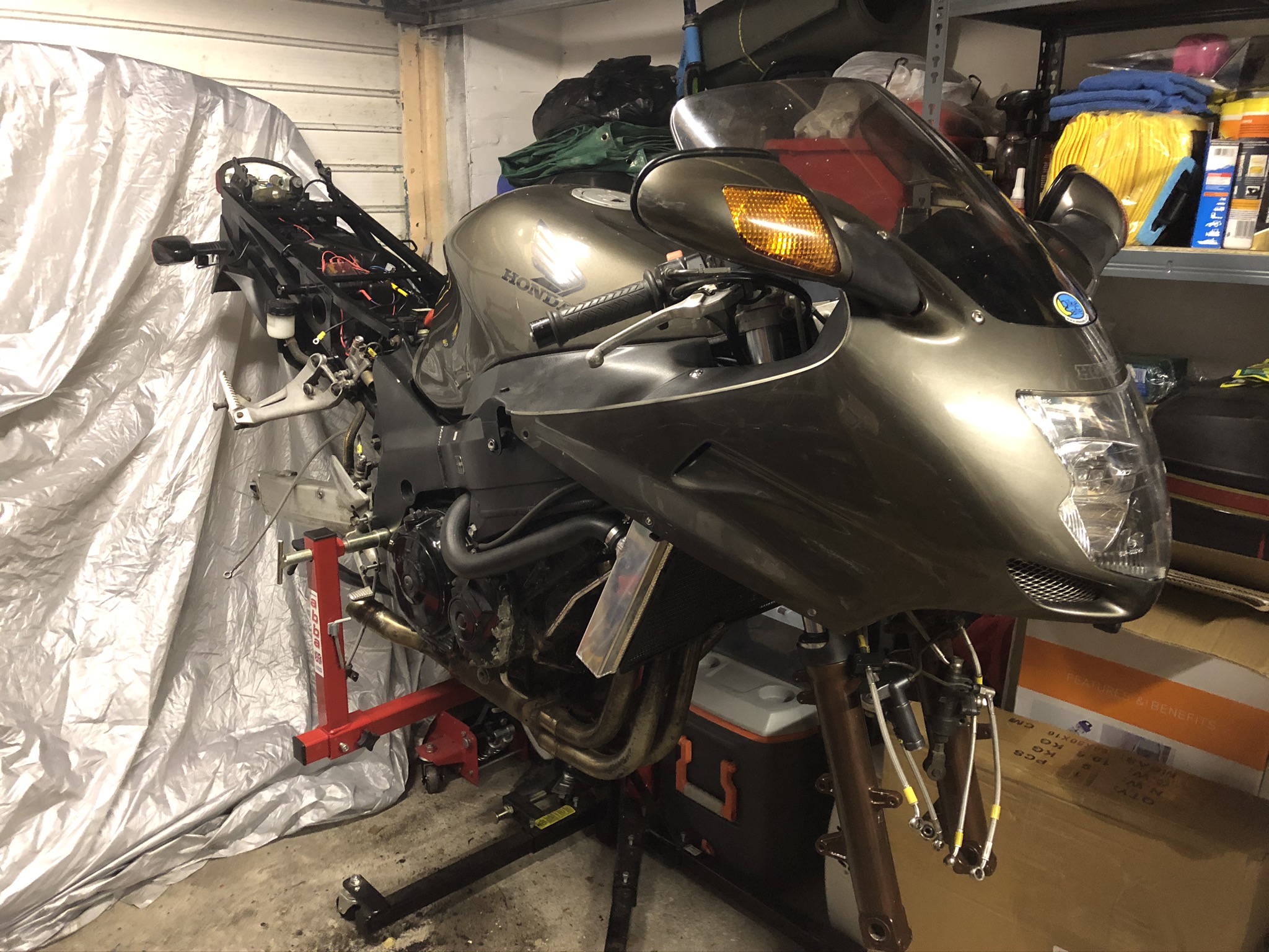

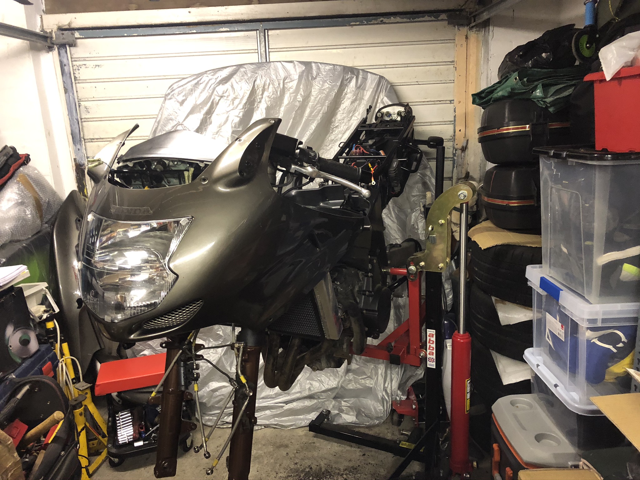

The last bit for now, the Abba Skylift has been tremendous, it wasn't cheap by any means but I couldn't realistically have done this rebuild without it.  The box to the right of the bike in the above picture is the Abba front wheel chock, that's another new toy for me to play with :).  The only other work I feel is needed is the bodywork restoration, this will come in time, for now I'll be happy to have a bike with everything else sorted.  Mechanically I think she's sound now, I'm going to do the CCT as a precaution, and possibly next year replace the clutch.
Is that a brand name, interested?
