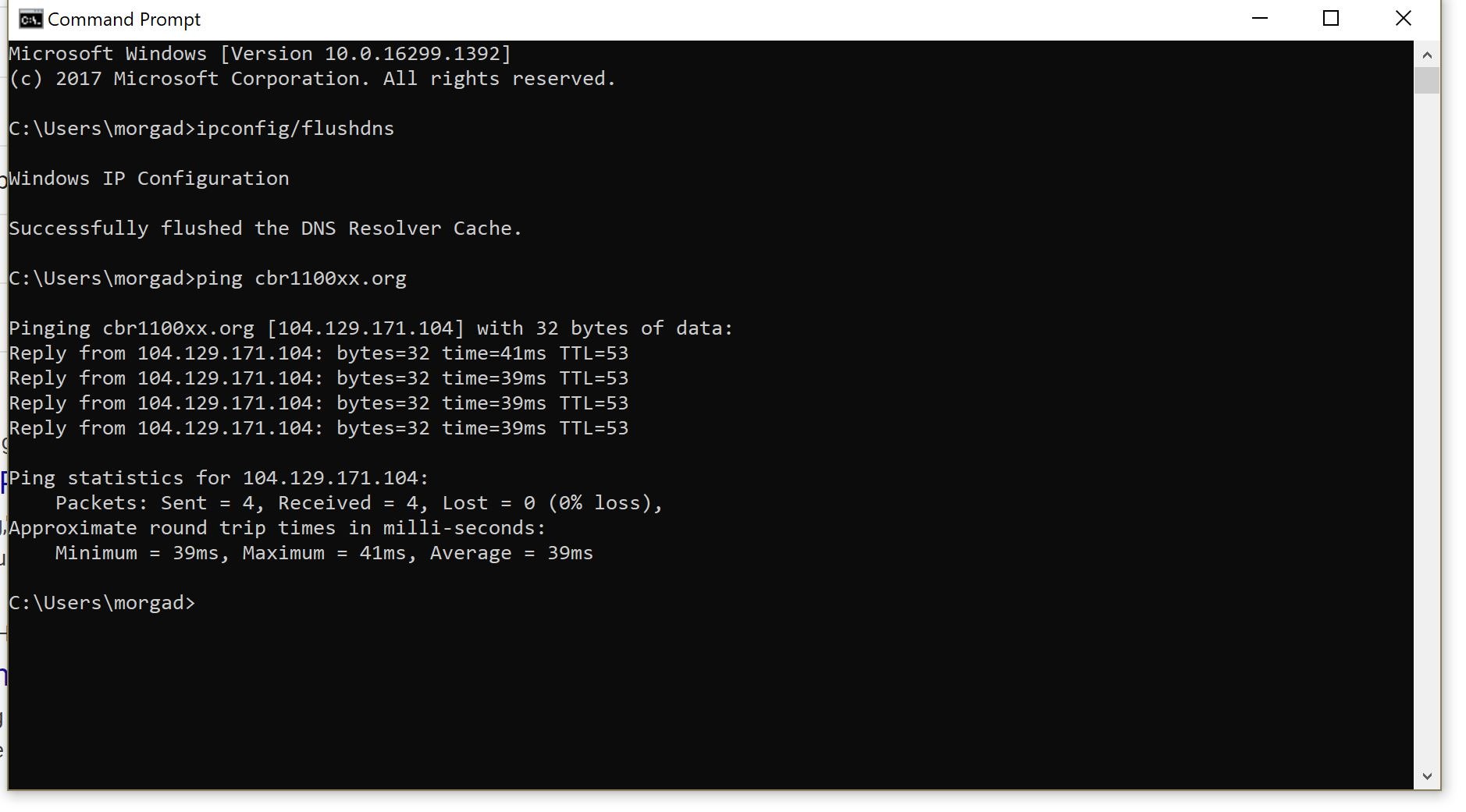

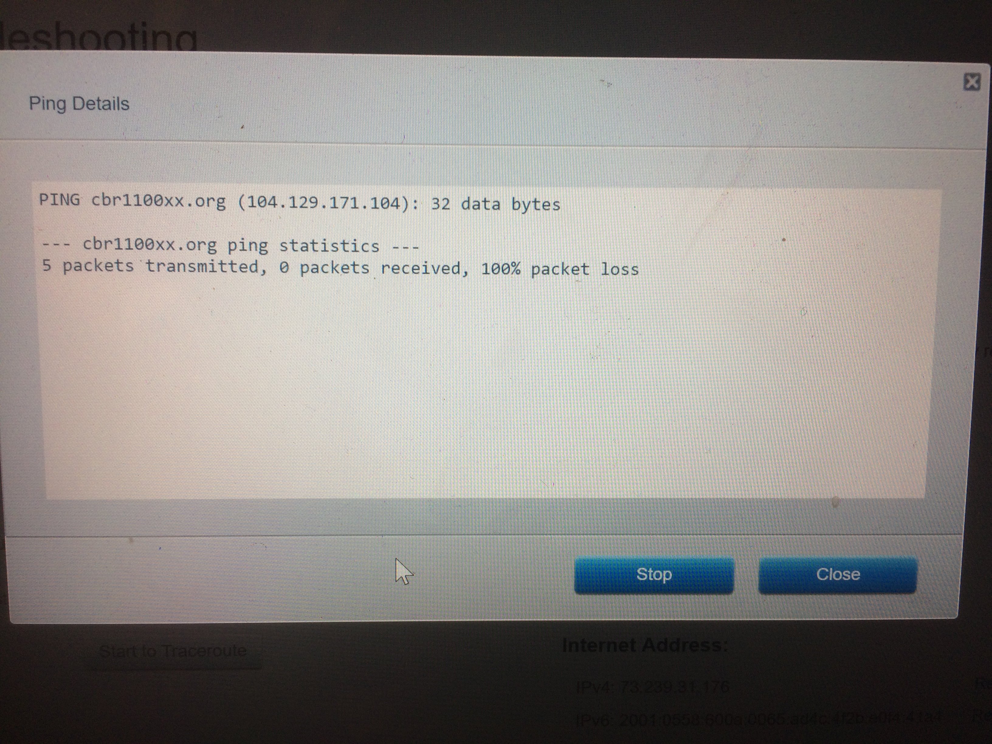

SwampNut Posted January 28, 2020 Posted January 28, 2020 Super fucking weird. Who is the ISP? Can you get your IP address from whatismyip.com? Do you know how to ping cbr1100xx.org and post the results? Quote

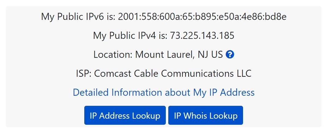

nomadicdread Posted January 28, 2020 Author Posted January 28, 2020 (edited) Through the router. Comcast IPv4: 73.239.31.176 IPv6: Not Detected Edited January 28, 2020 by nomadicdread update text Quote

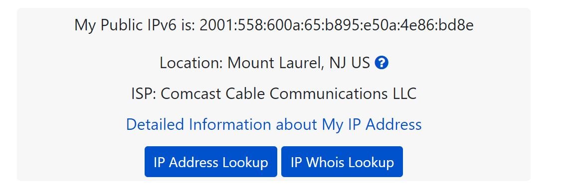

nomadicdread Posted January 28, 2020 Author Posted January 28, 2020 Now going direct to the modem: Quote
nomadicdread Posted January 28, 2020 Author Posted January 28, 2020 For some reason it's just now giving my IPv4 wired direct to the modem. Quote

nomadicdread Posted January 28, 2020 Author Posted January 28, 2020 I'm not a web guru but, I think your hosting/service provide may have 73.239.31.176 blocked. Quote

SwampNut Posted January 28, 2020 Posted January 28, 2020 No Barracudas here, and no hosting provider. I run a bare server with open source tools on Debian Linux. So if I understand correctly, you're being blocked or unable to use the site from BOTH 73.239.31.176 and 73.225.143.185? Or you're saying that the latter does allow you to access the site? Sorry, it was unclear. I'm going to look at IP blacklists now, there are various automatic blacklist services running to block IPs that have too many (dozens) of login attempts or unauthorized access such as SSH. Quote
SwampNut Posted January 28, 2020 Posted January 28, 2020 Found it. What did you do? Lots of failed logins? Try to SSH/FTP? I've never seen CSF/CSH incorrectly blacklist an IP before, so I'd like to know. It's been removed from the list. Table Chain num pkts bytes target prot opt in out source destination filter DENYIN 34 1433 78394 DROP all -- !lo * 73.239.31.176 0.0.0.0/0 filter DENYOUT 34 0 0 LOGDROPOUT all -- * !lo 0.0.0.0/0 73.239.31.176 Quote
