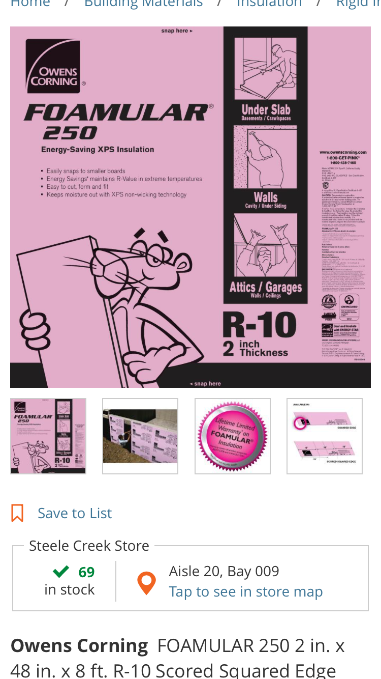

googus Posted January 22, 2018 Posted January 22, 2018 Maybe this for the floor with plywood over it? Quote
blackhawkxx Posted January 22, 2018 Posted January 22, 2018 37 minutes ago, googus said: plywood over it? In my cellar man cave, I used quarter inch finished plywood that I oil stained and attached the panels with rounded head screws so I could remove them if needed. I think that it looks OK for what it is. Quote
Redbird Posted January 26, 2018 Posted January 26, 2018 Insulate the floor? That’ll be a project, and one with limited benefits. When you’re done you can pray you never have even minor water issues or you’ll be pulling it all up. You’re honestly better off insulating the walls and putting down some rugs if you want to warm up the space a bit. Quote
