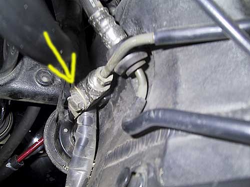

testrider Posted May 5, 2006 Author Posted May 5, 2006 I think I snaked my old line out without removing the tank. I don't really notice much difference in the clutch action or feel with the new line, but it looks cool. Thanks, Jim, How did you remove the line (steel line from rear brake) that's blocking the clutch line? Quote
CBRBob Posted May 5, 2006 Posted May 5, 2006 How did you remove the line (steel line from rear brake) that's blocking the clutch line? You remove that center bolt, it just holds the block in place. Put it back when you are done. Lifting the tank makes life MUCH easier so I would suggest doing it. The gain is a bit better and more consistent feel from the clutch. Of course it does NOT make the lever any firmer or softer as lever resistance is from the clutch springs (different from brake 'feel'). Quote
ccriderXX Posted May 5, 2006 Posted May 5, 2006 Thanks, Jim, How did you remove the line (steel line from rear brake) that's blocking the clutch line? I only loosened that bolt in your picture. Then I pulled the rubber part of the hose aft (towards the back of the bike). Once I got that portion past the bolt I was able to pull up the whole steel part of the line up and out. I did loosen my tank bolts and moved it over slightly. I haven't noticed a big improvement in clutch feel but the line does look cool . I needed the extra length for my vfr bars. Quote

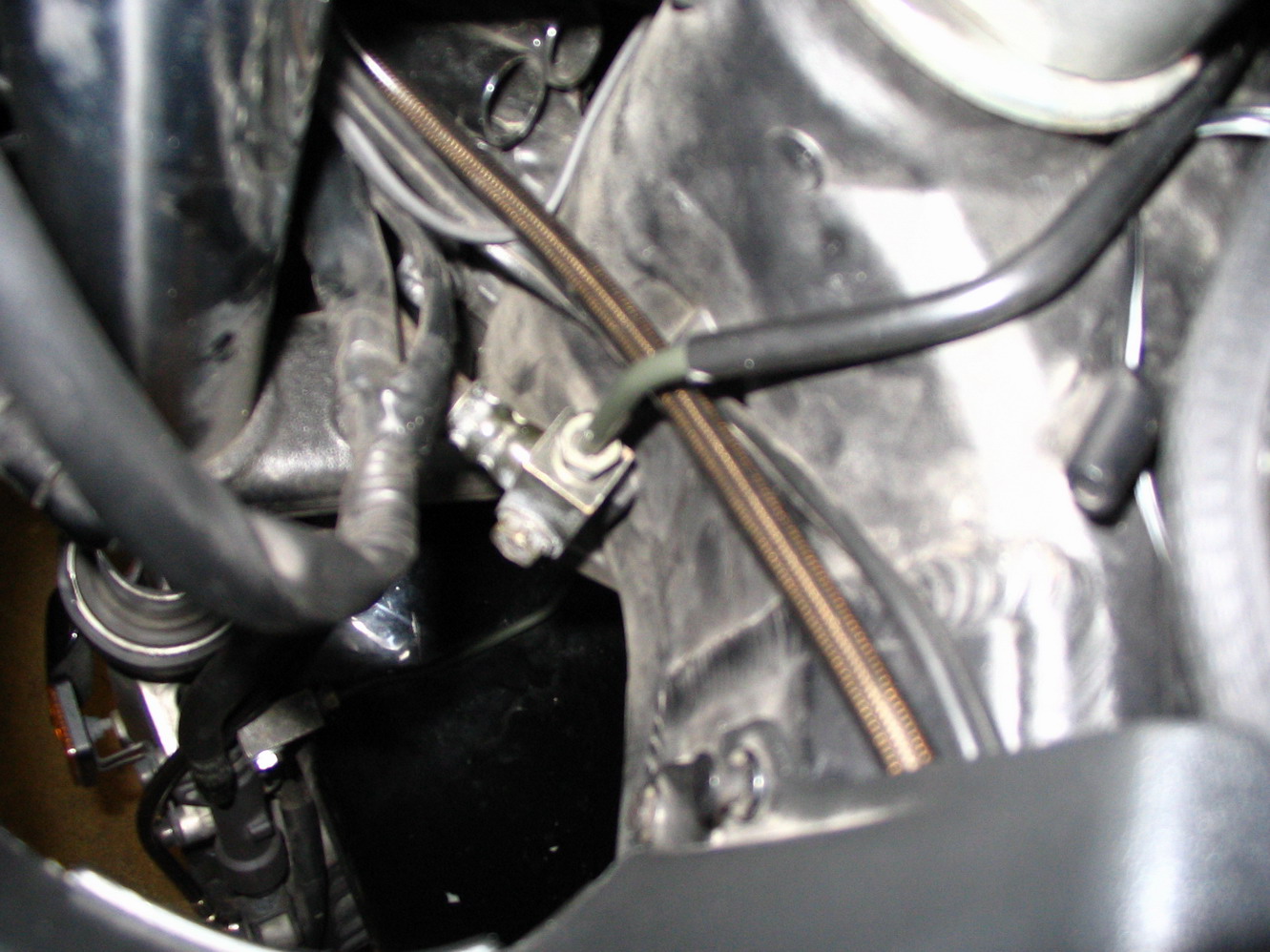

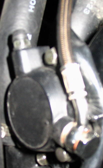

ccriderXX Posted May 6, 2006 Posted May 6, 2006 Please do if it's not too much trouble. Thanks. OK, Not much to see though. First picture shows clutch attachment. Second picture shows how line is routed behind steel line. I also will post some other pictures of my front brake route clamps in your other post. The clutch is easy to do. The hardest part is pulling the rubber hose out. Quote
testrider Posted May 6, 2006 Author Posted May 6, 2006 Please do if it's not too much trouble. Thanks. OK, Not much to see though. First picture shows clutch attachment. Second picture shows how line is routed behind steel line. I also will post some other pictures of my front brake route clamps in your other post. The clutch is easy to do. The hardest part is pulling the rubber hose out. Thanks for the pics. I appreciate it. Did you have to tie it up along the clutch line somewhere? Quote
ccriderXX Posted May 6, 2006 Posted May 6, 2006 Thanks for the pics. I appreciate it. Did you have to tie it up along the clutch line somewhere? I suppose I should have, but I didn't. Maybe I will put a nylon tie near the bolt. Only the rubber grommet holds the stock line there. You don't have up and down movement like you do with the brake lines. Quote
SSUXX Posted June 24, 2020 Posted June 24, 2020 On 5/5/2006 at 1:27 PM, testrider said: Thanks, Jim, How did you remove the line (steel line from rear brake) that's blocking the clutch line? I'm reviving an old thread because this pic is perfect for askign my question. I have Helibars and want to add Genmar risers as well (Im getting too old for this shit). I absolutely want to use teh stock brake and clutch lines. the problem seems to be the little rubber plug just above the yellow arrow in the attached pic. The clutch line goes straight up to the left clip-on from that rubber piece and it's pretty tight. I suspect I would have to get the line away from the frame to free up some slack. does anyone know how to remove the line from the frame at this point? Quote
rockmeupto125 Posted June 24, 2020 Posted June 24, 2020 At the arrow is a 10mm bolt. take it out, and pull the clutch line up to get some slack. That's what many people do when they put on VFR bars or such. Mines been loose like that for 50,000 miles and I haven't seen a problem yet. Quote
blackhawkxx Posted June 25, 2020 Posted June 25, 2020 Like Joe said, just take the bolt out but I'm not sure that you will get enough length with the stock line. Quote
