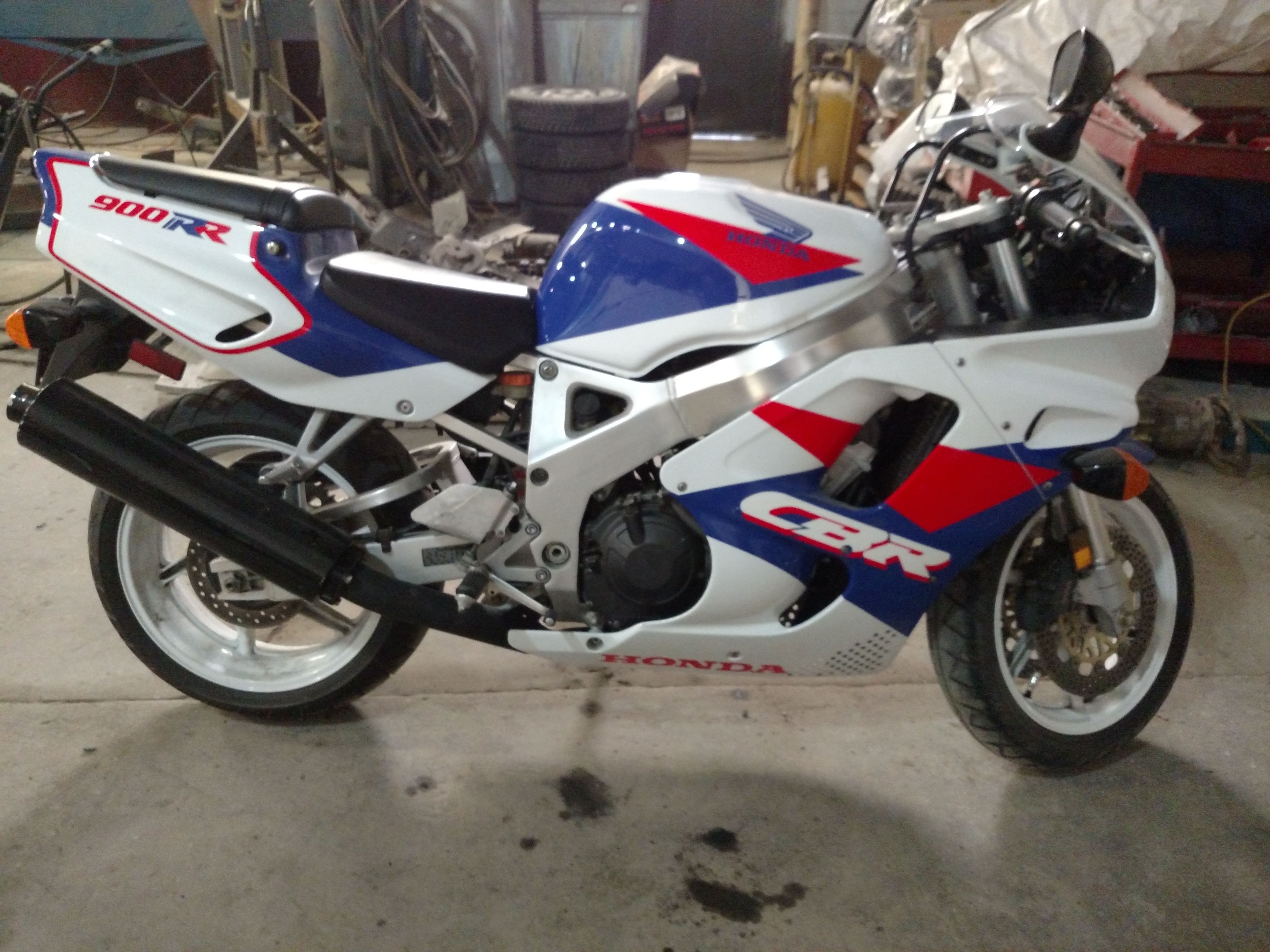

Posting for a friend in Baker City, OR. He is a great mechanic and was asked to get this bike going: It has 7xxx miles. runs great. clean. contact info Josh 415-699-6207 He is open to offers.

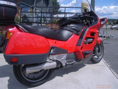

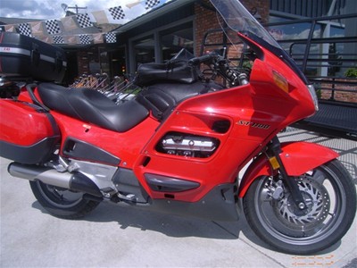

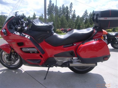

This bike is still for sale. Quentin has lowered his price. My friend Quentin has his ST1100 up for sale. He is retired and away from home at the moment. The bike is located in Bonners Ferry, ID. 1997 red St1100 with 59000 miles on it. It is in exceptionally clean condition for a 97. I would take $3750 for it. It is equipped as follows: I bought the bike new in 1997. Progressive fork springs Progressive rear shock SS Front brake lines Clearview windshield plus a shorter clearview that was too short for me Heli Bars, 6 way adjustable Heated grips BMW style socket to plug in electric jacket liner Accessory shelf GPS mount and plug Radar detector plug Rich's seat plus a corbin seat(piece of crap) Bagster tank bag Givi tail bag RKA liner bags for the side cases over $2500 for the listed accessories If interested contact Jeff (ccriderxx) at vf700f@gmail.com and he will put you in contact with Quentin.
