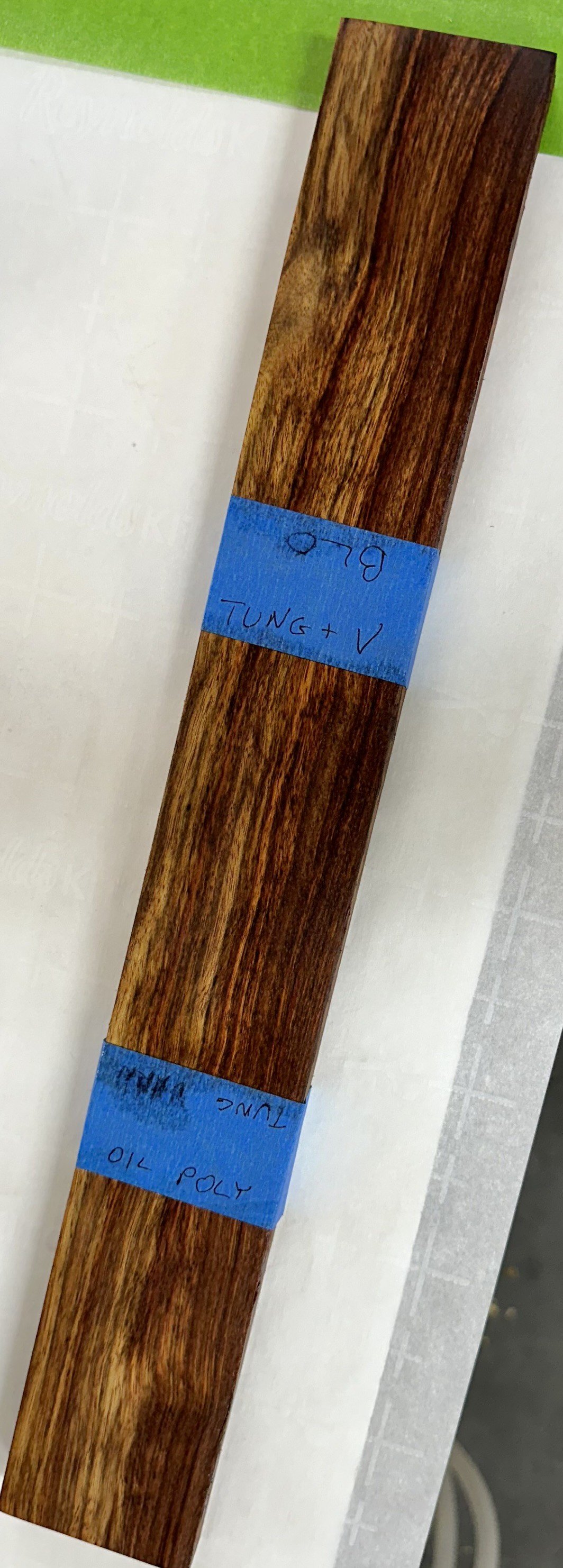

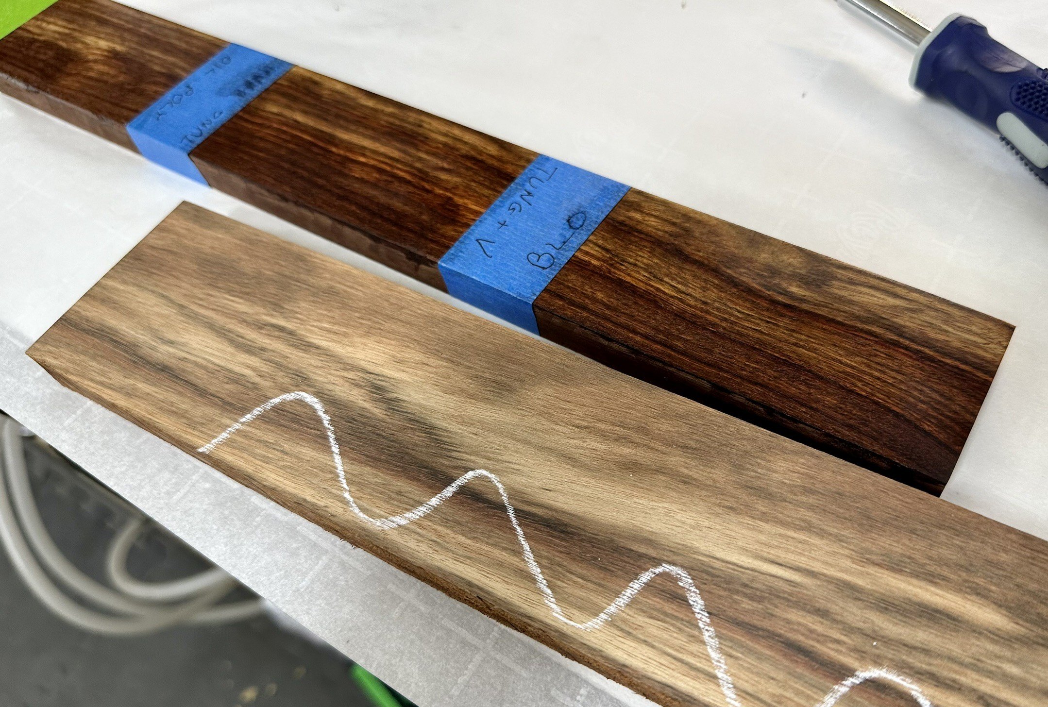

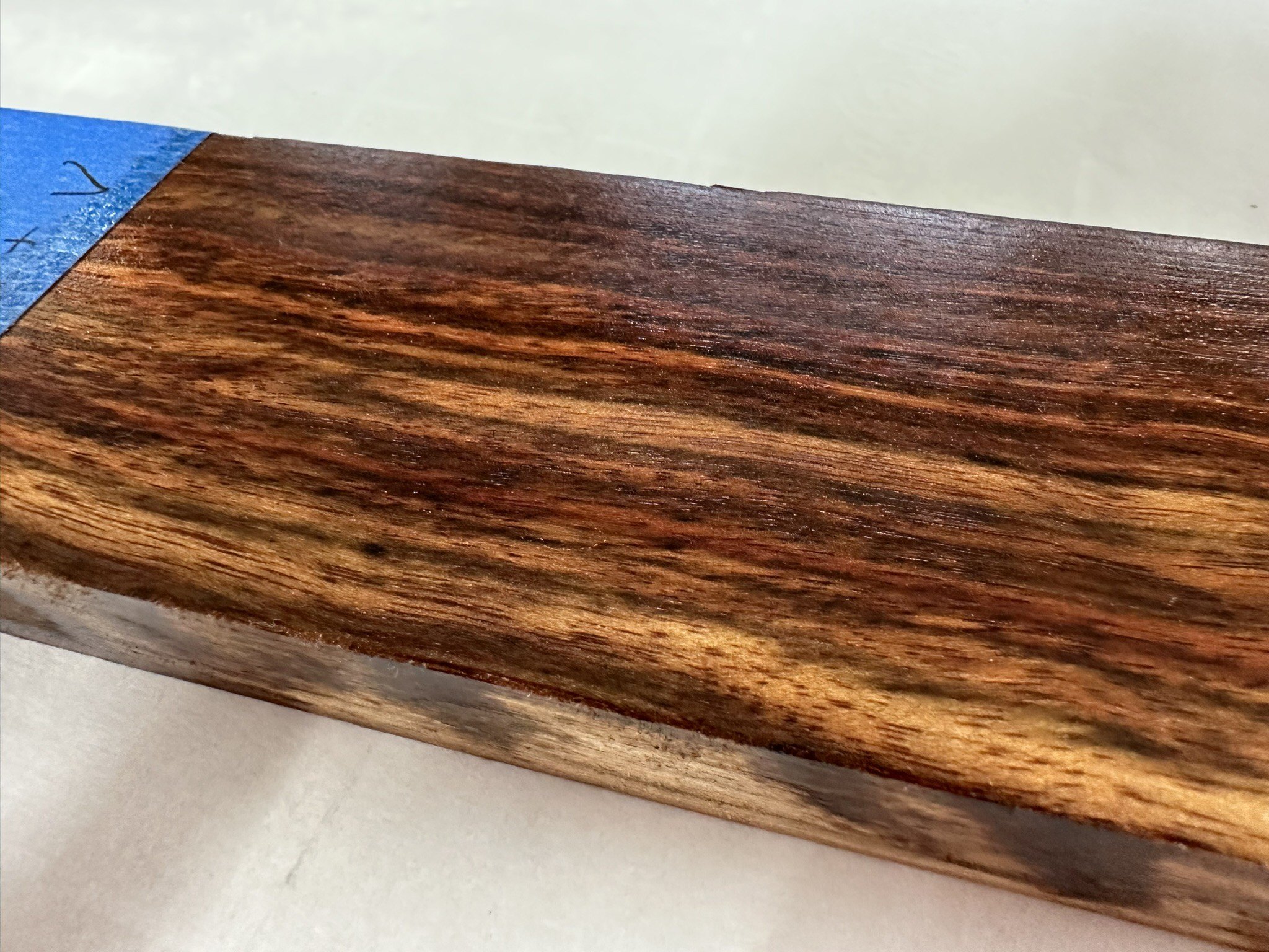

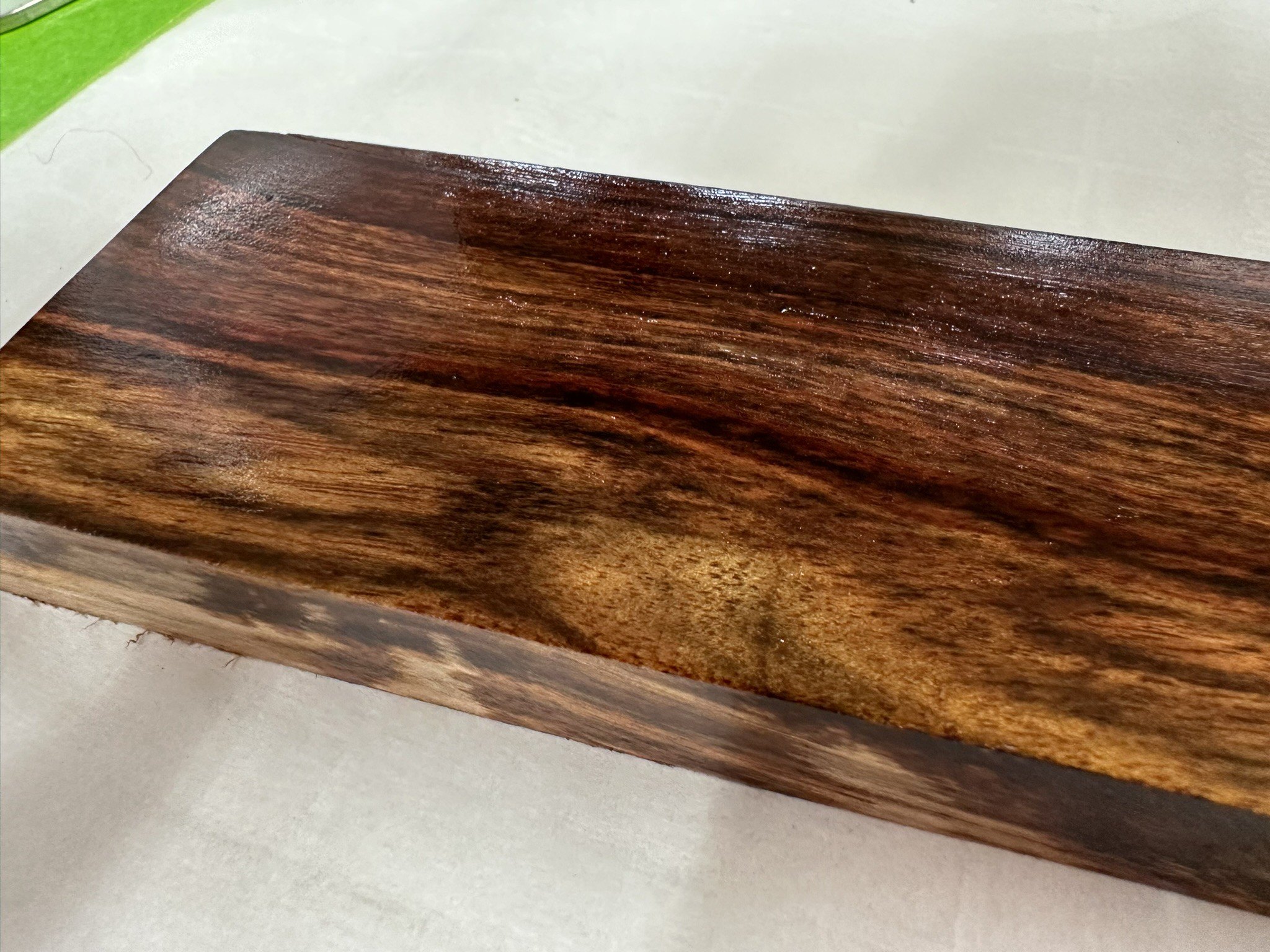

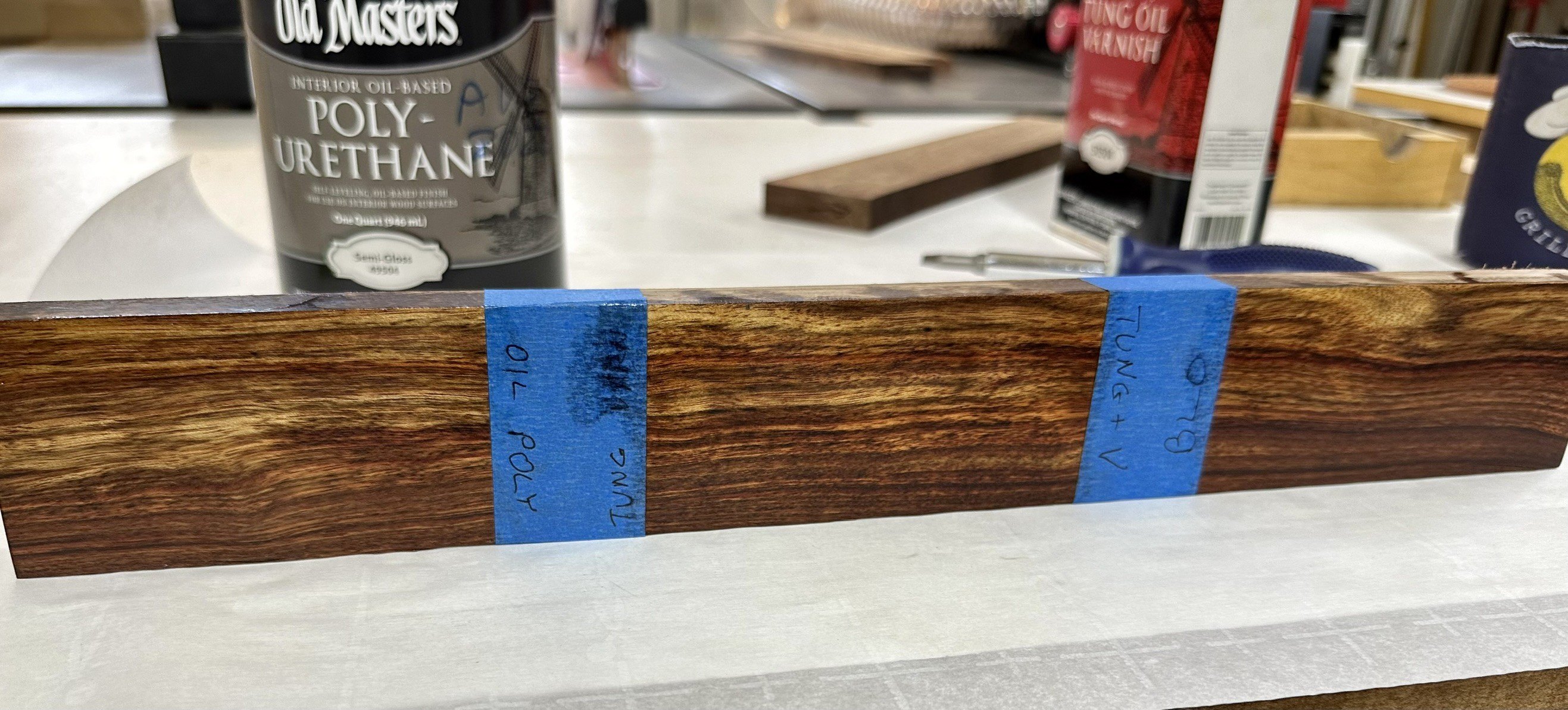

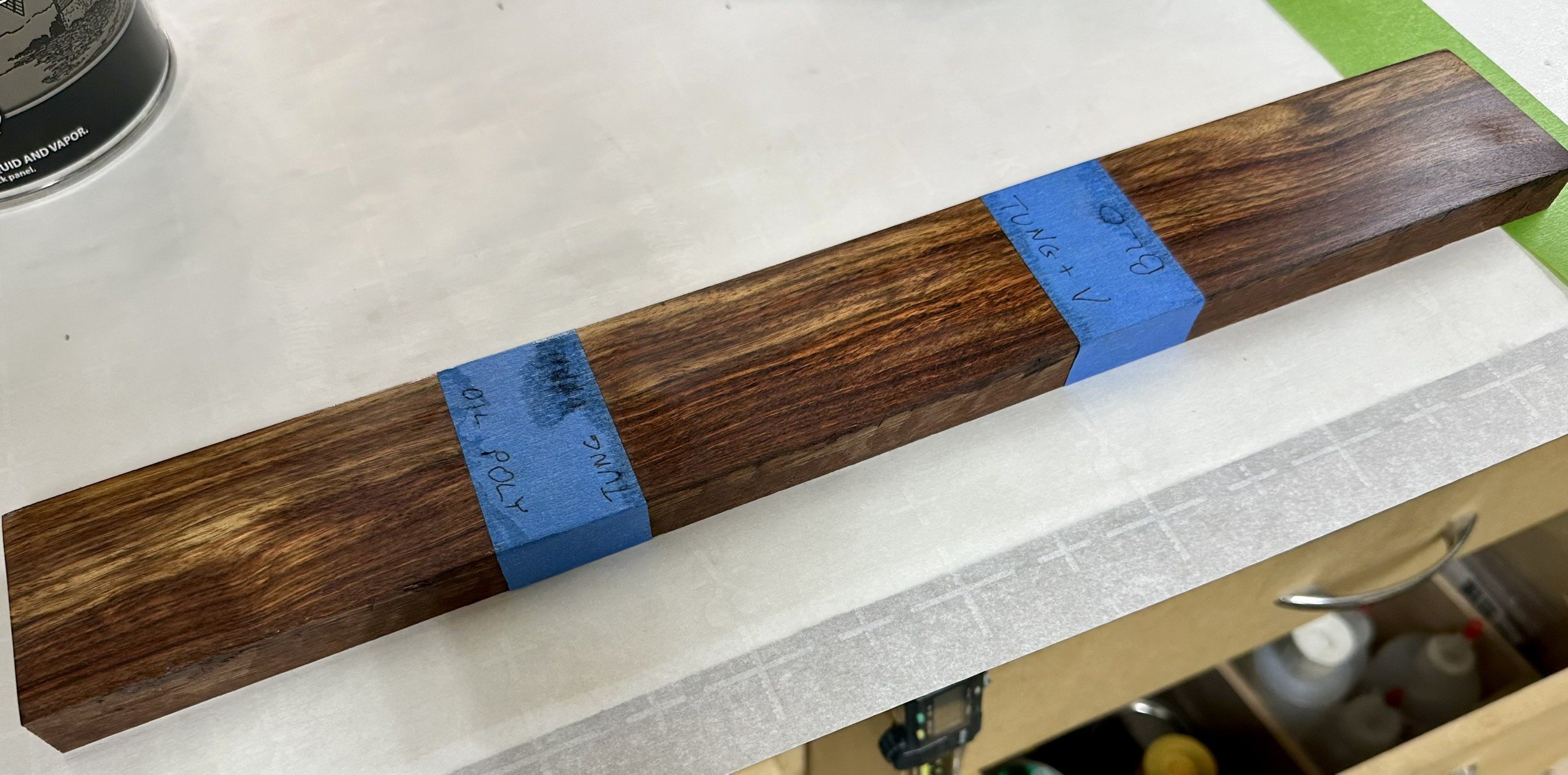

So I did a test here with a few much easier finishes.  They all seem the same so far.  Coat 1.  I'll add one more poly (per directions) and a couple more of the oils.  I might topcoat the oils with the poly, dunno.  But stay tuned for progress.
Brush-on oil based poly, tung oil and varnish blend, and boiled linseed oil.

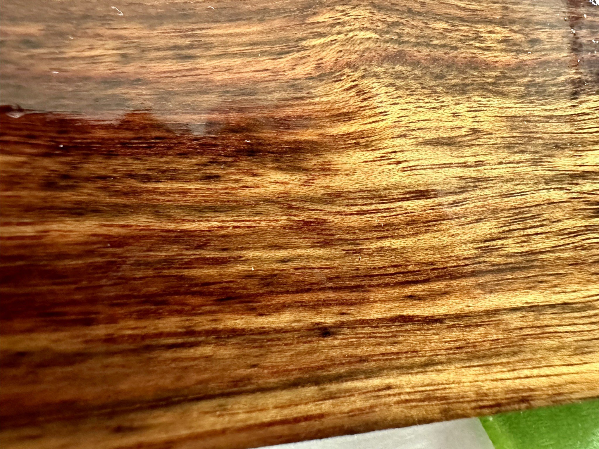

Below is a raw sample.  I had been shooting for only slightly dark/wet look, but I'm not setting that as a must yet.

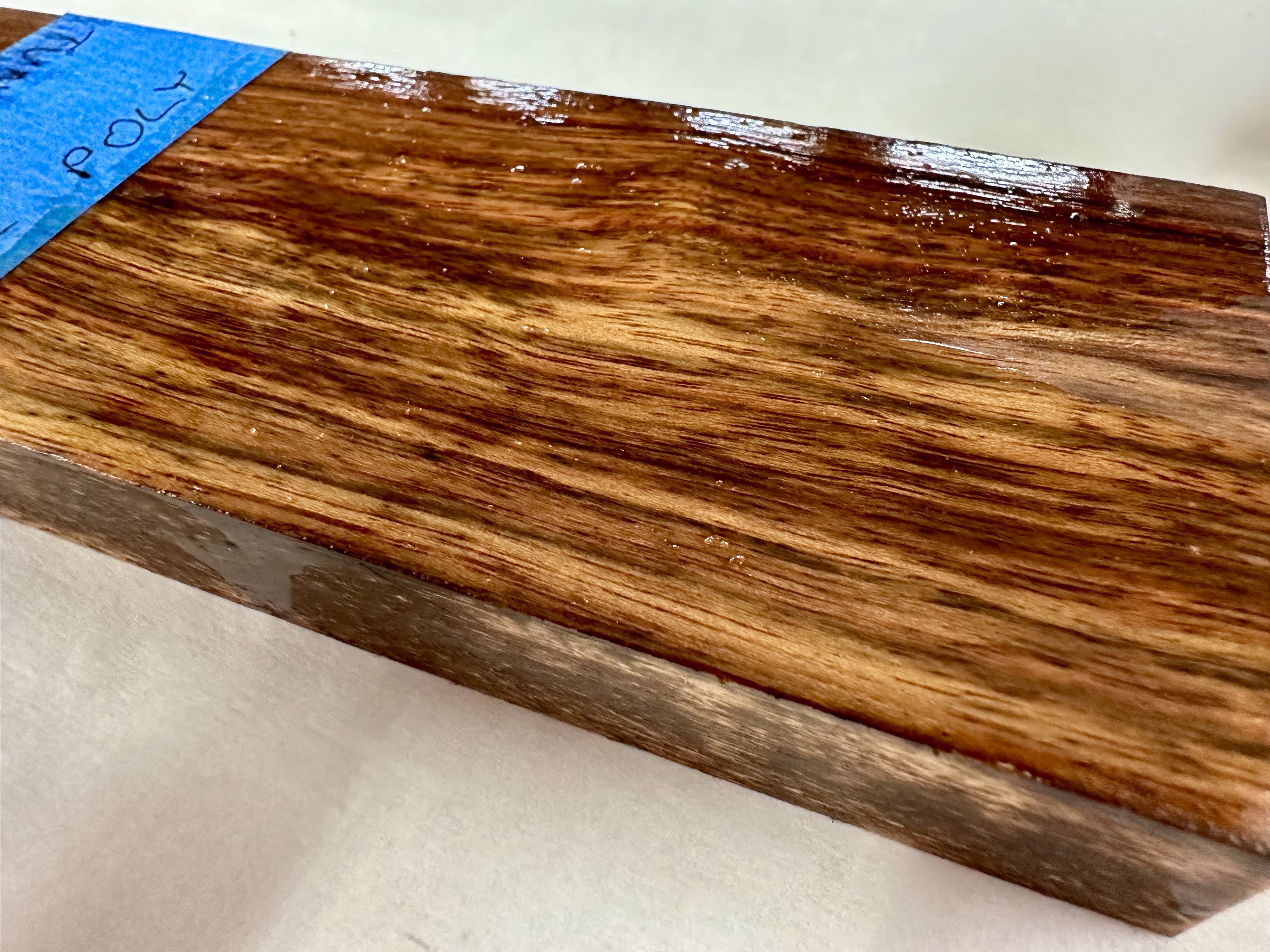

I think I like the poly.  It's also fast, and super easy, low VOC, no cleanup.  There is no way to truly get this in a photo, but the grain looks 3D and crystalline with the poly, not the oils.
(Air bubbles are my carelessness since it's just a test)
The others lack depth and pop.

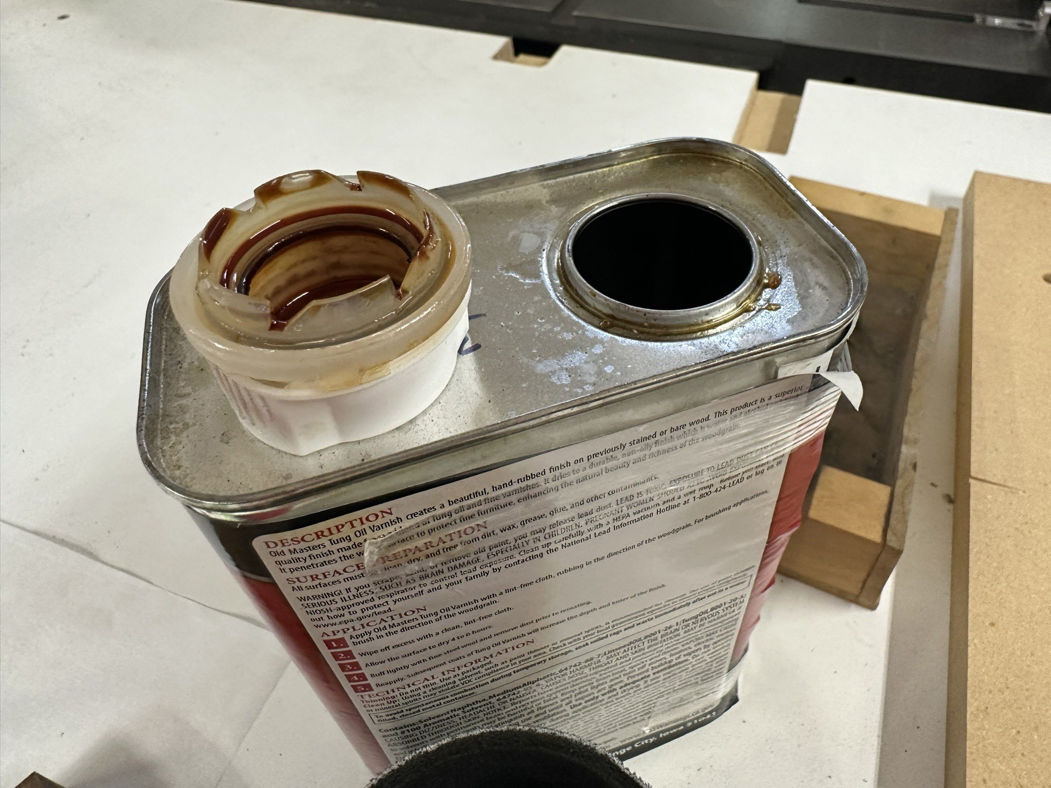

Also, look at this retarded shit.  The child safety cap glued itself closed.  When I really tried hard to move it, the entire thing came off.  So much for "safety" and now I need to find another container for it, I guess.

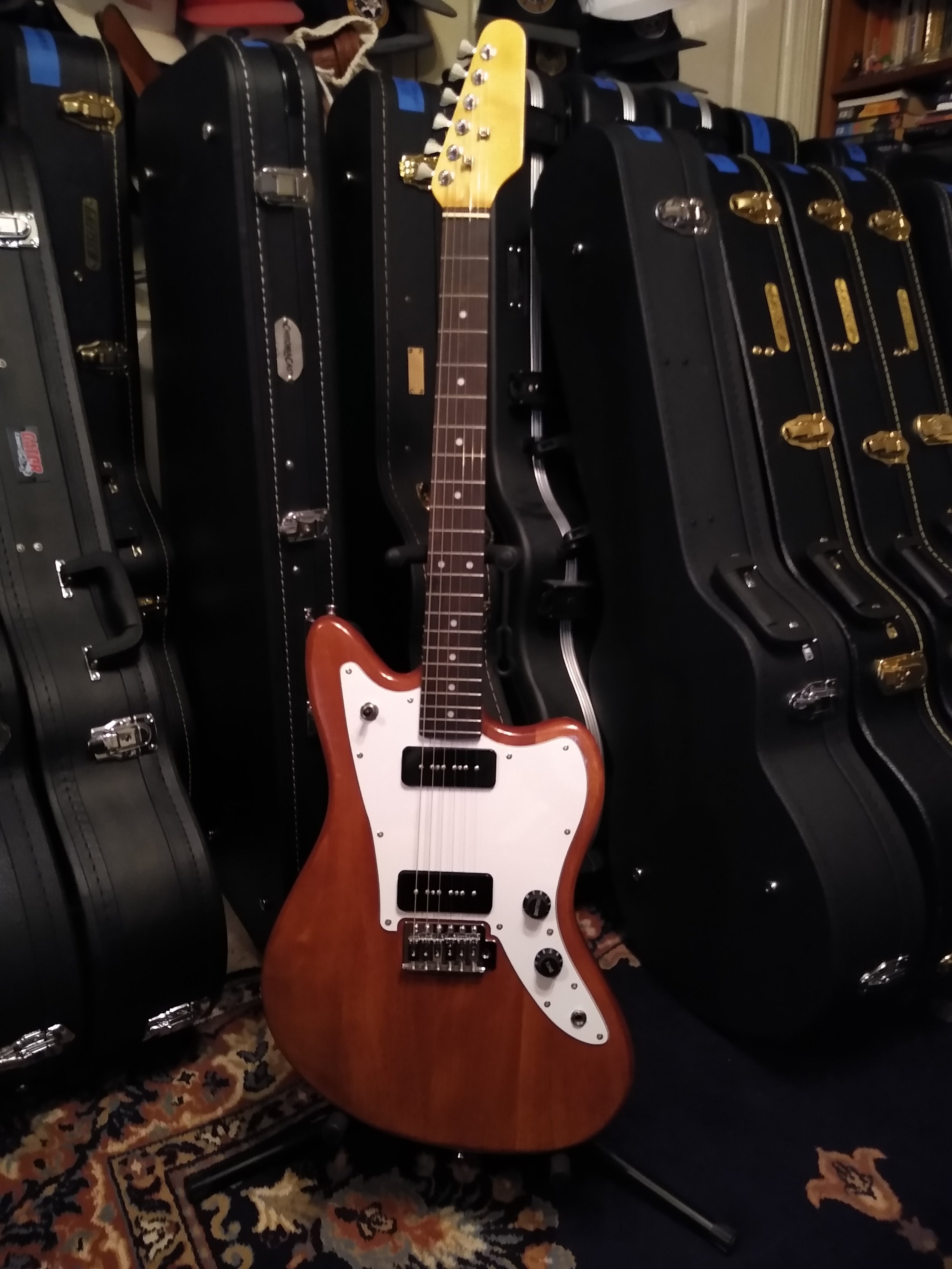

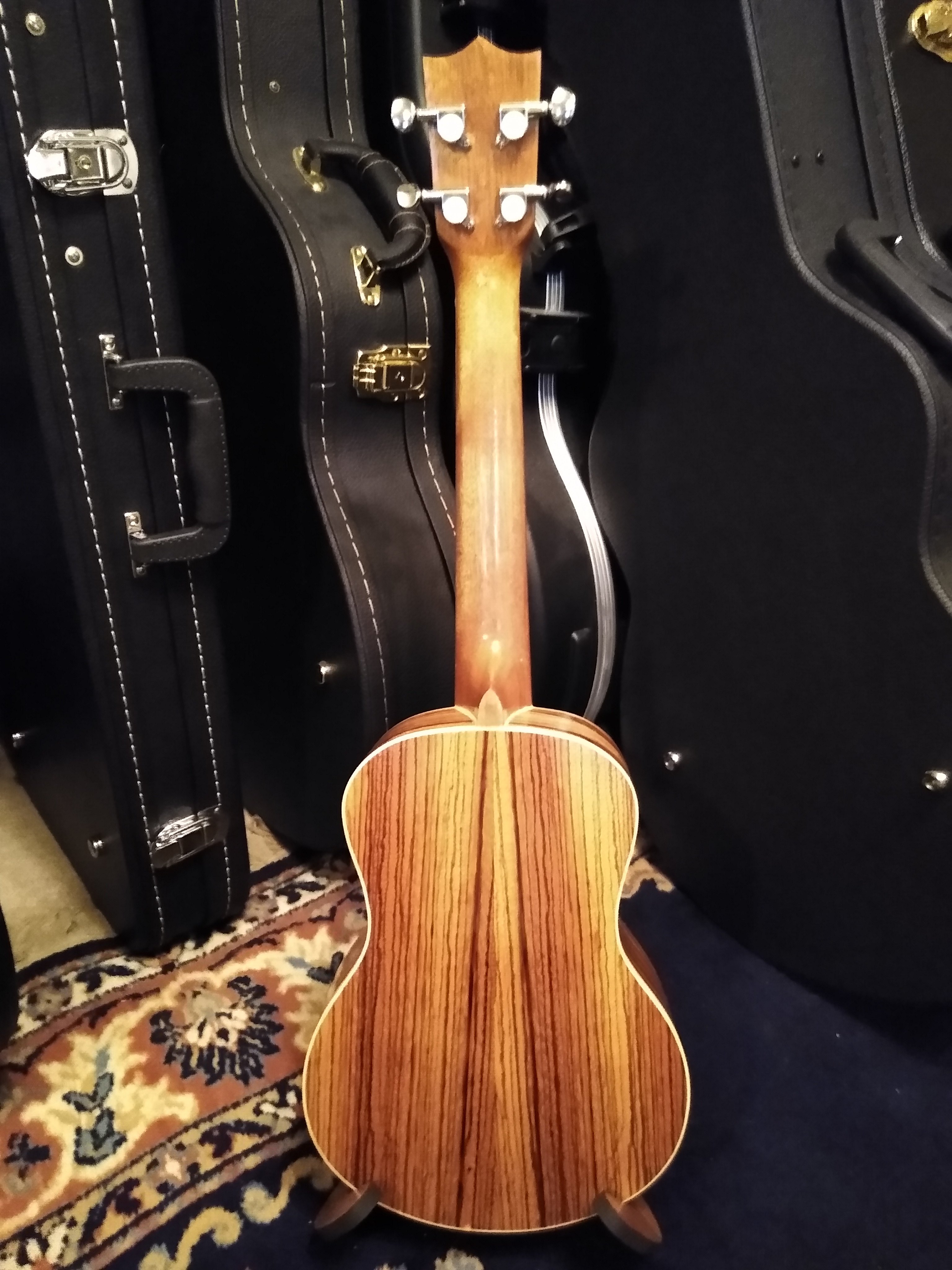

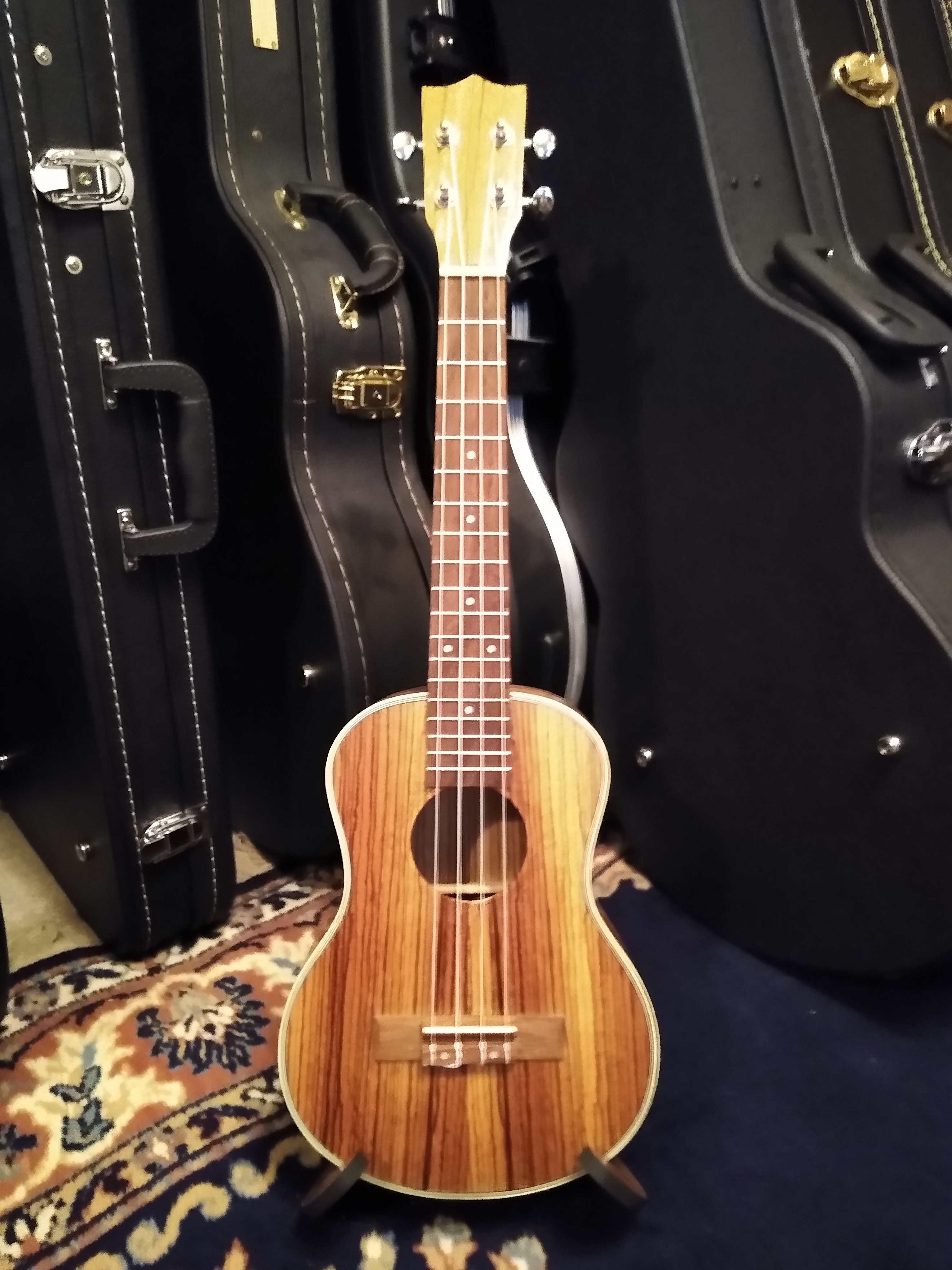

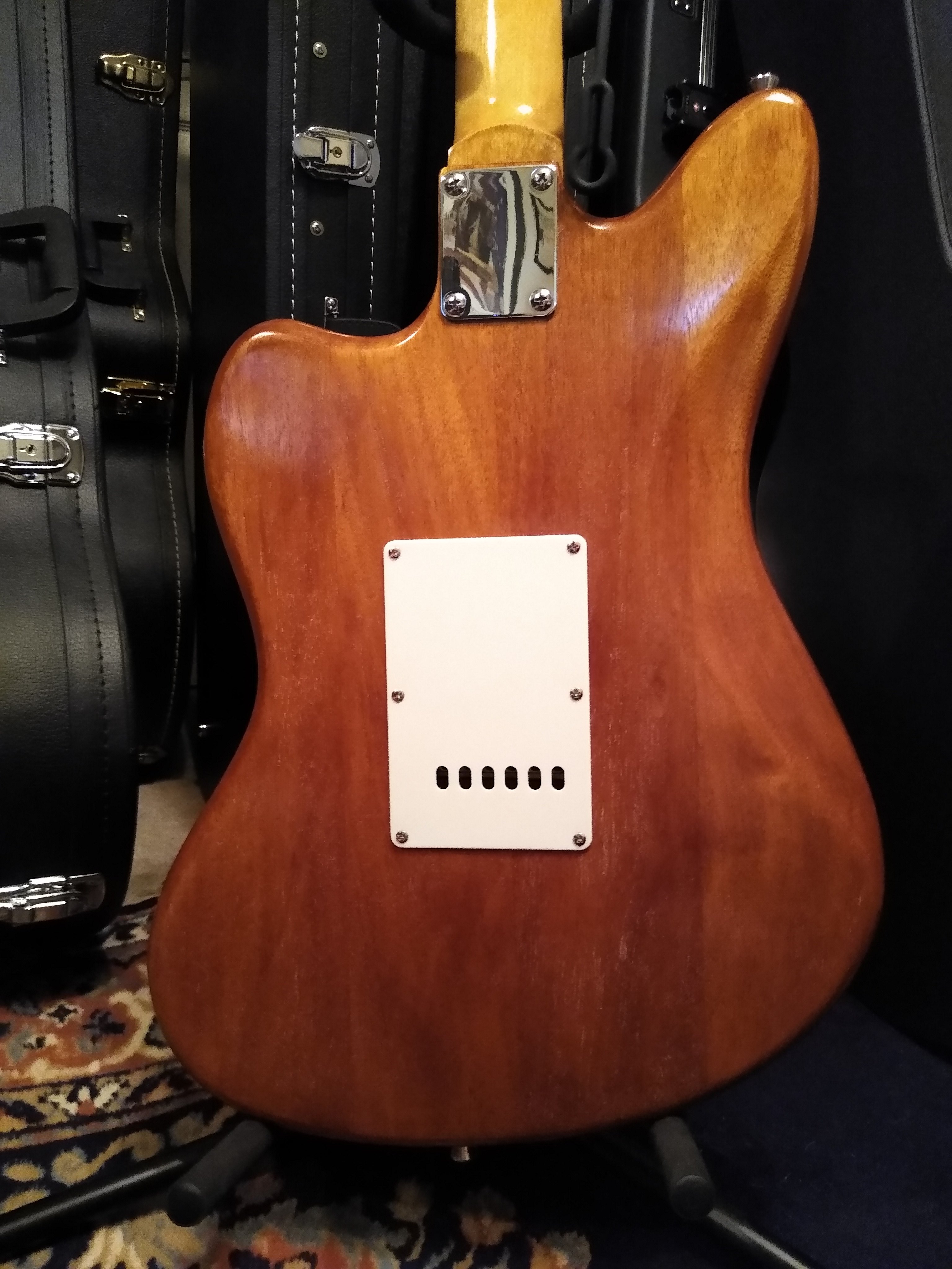

The last two instruments I built (from kits) were a ukulele (zebrawood & mahogany neck) and an electric guitar (mahogany & maple neck). For the final finish on both, I used Minwax Wipe-on Poly (gloss). The building & finishing processes took considerable time since it's pretty much all hand labor. I'll take & post some pics when I get the time.
Poly is the clear winner here.  It's the glossiest semi-gloss I've ever seen, and not sure I like that though.

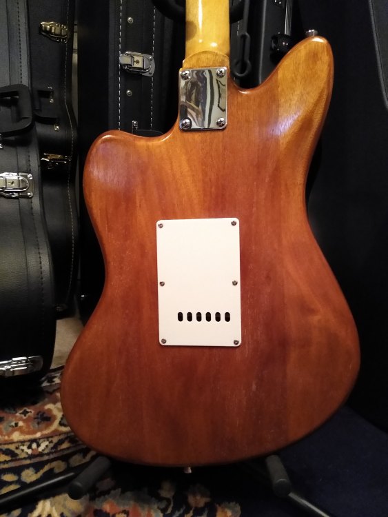

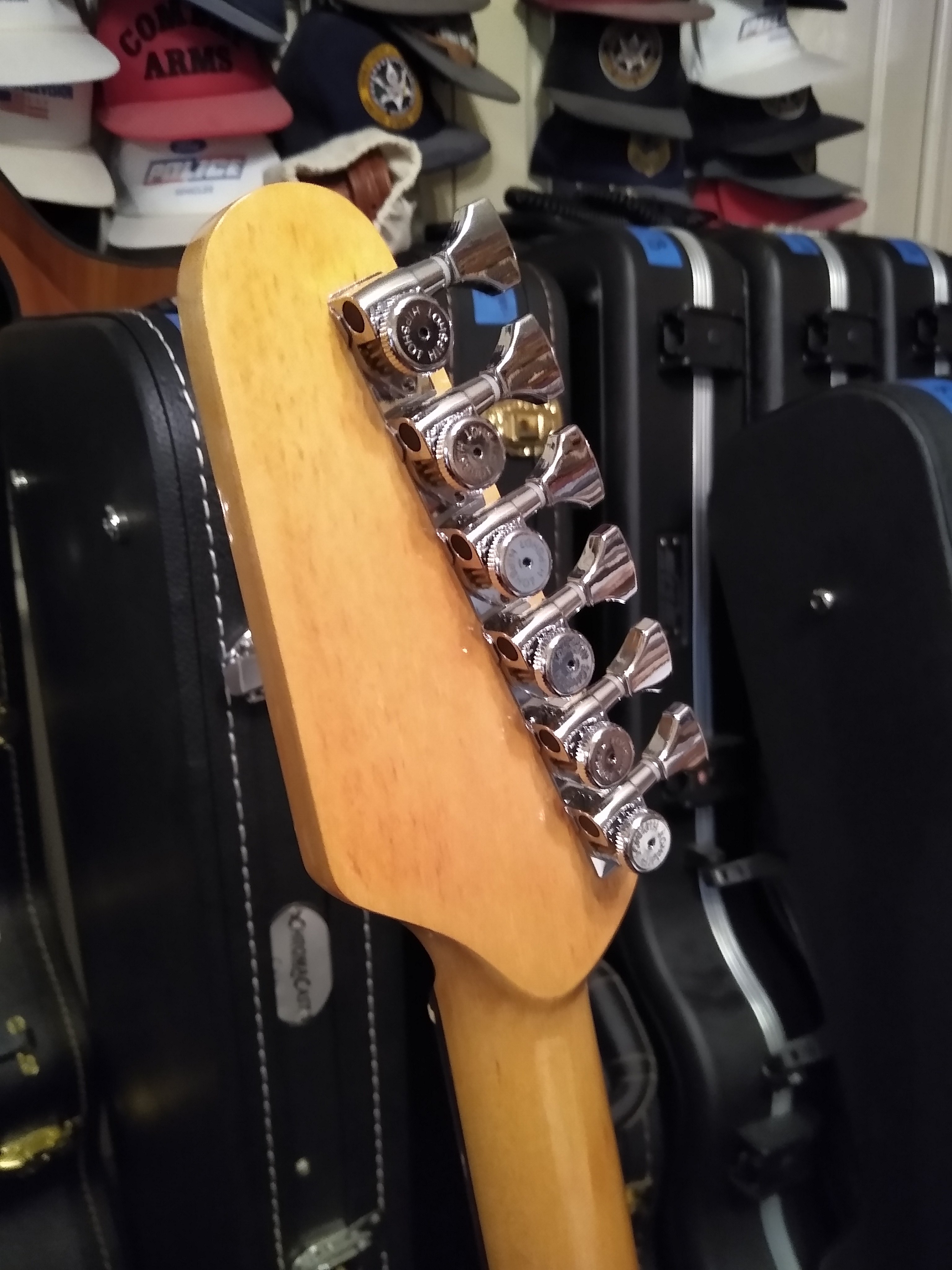

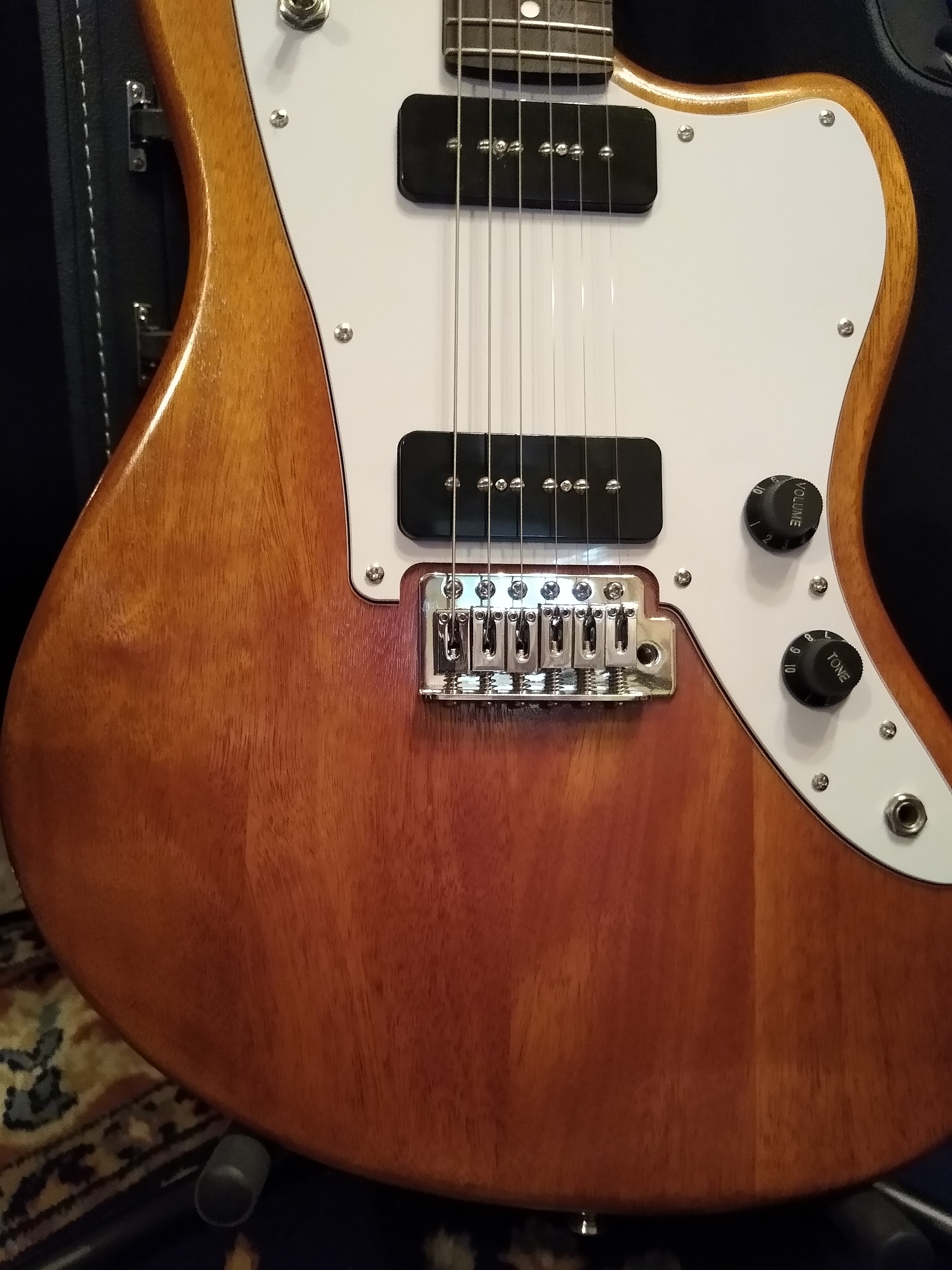

Instrument pics, as promised, Carlos . . . feel free to resize as warranted.
On the guitar, I didn't do more than a modest pore-fill & light amber tint in the sealer coat as I wanted to emphasize the warmth of the natural mahogany. The maple neck/headstock took on a slight amber tone just from the multiple coats of poly.
The uke has no pore-filler or sealer, only multiple coats of poly on the zebrawood, binding, and the mahogany neck/headstock.

Damn.  Making a guitar, particularly a hollow body one (no points detracted because it's "just a uke") has got to be near the pinnacle of the woodworking craft.  It not only has to look good, but it has to be very stable and sound good.
Very impressive!
