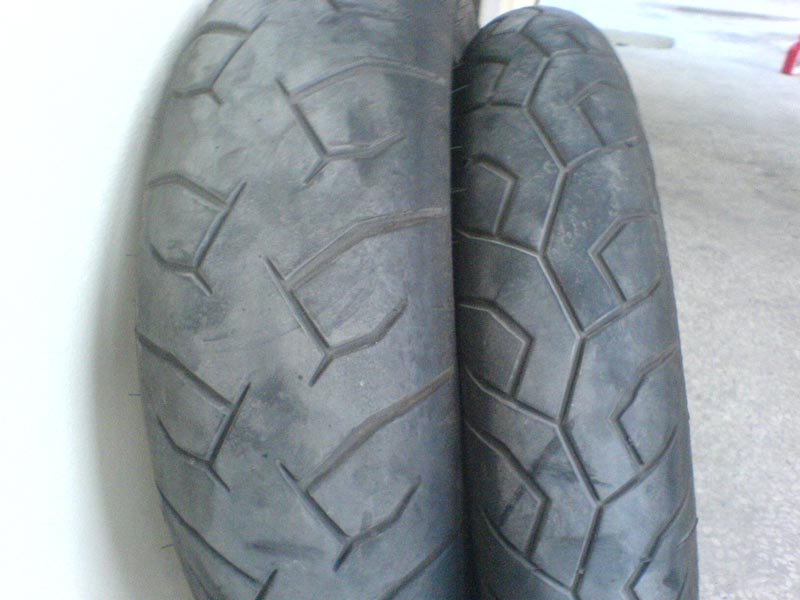

  16. You will regret it. I've just sold yesterday my 4K miles Diablos for 70 Euros (bought them for 370 installed so everybody over there stop complaining about tire prices and wear and yes I know I've written that before :icon_hand: ). The rear was in its half but the front was about 2/3 of its life,but I couldn't stand them anymore because of : a)their 'slow' handling (especially the front) b)their tendency to self-inflate (mainly te rear) which shows excessive movement of the carcass (this is the main reason for a tire to get hot :icon_pray: ). I don't think thet match the XX well, maybe are better on a smaller, lighter bike. Moreover, the rear offers less traction than the Power or BT12&BT14 (ok the last one is good for only 1.5k) I used before. Instead, I put back my half-worn, siting for 3 months Powers. Probably, next set will be Powers 2CT. Don't know first hand about the stradas (and perhaps I never will)[attachmentid=4225]
