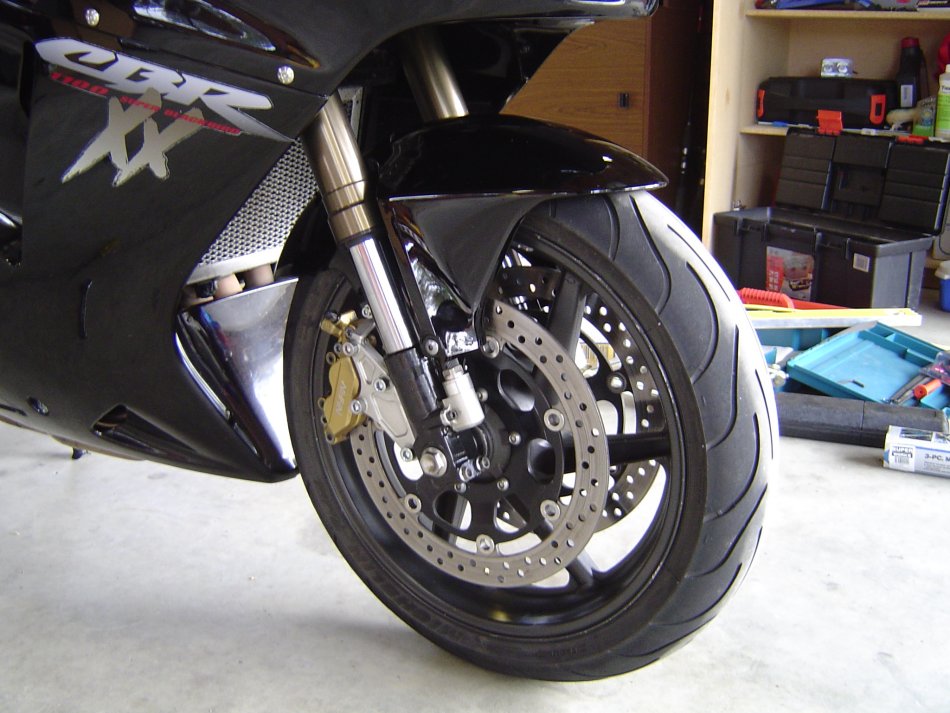

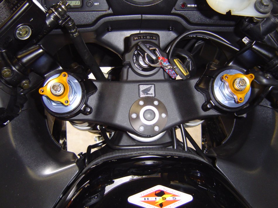

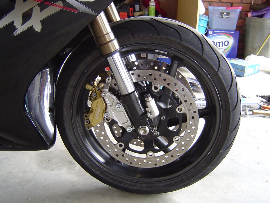

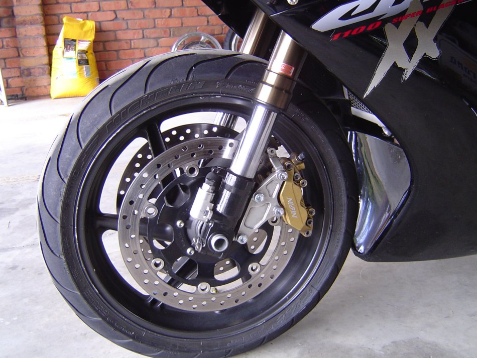

Byrdman Posted October 10, 2006 Posted October 10, 2006 Yep sure have. Andrew, I think we need more pictures......... Especially ones of the front end. Quote
OzCrow Posted October 11, 2006 Posted October 11, 2006 Andrew, I think we need more pictures......... Especially ones of the front end. [attachmentid=4071][attachmentid=4072][attachmentid=4073][attachmentid=4074] Quote
