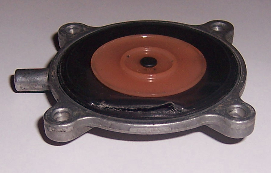

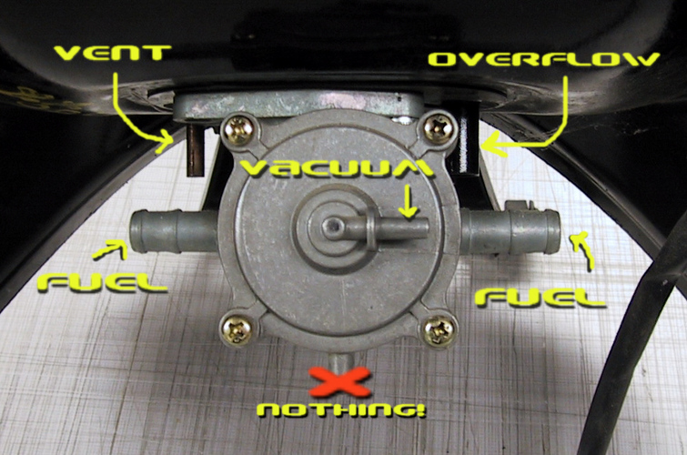

BeerXX Posted March 17, 2007 Posted March 17, 2007 The bike suddenly died after a fuel stop. It went fine until I throttled up, and now after reading this board I disassembled the petcock. Here's the cause. :icon_wall: The problem is that I didn't take a pic under the tank before removal of the hoses. :icon_doh: Does any have a pic of a 97/98 petcock with the fuel lines and vacuum hoses attached ? And does anyone have a spare part catalog on file ? I need to get a new diaphragm. Quote
redxxrdr Posted March 17, 2007 Posted March 17, 2007 Ron Ayers has a on-line Fische and parts. Prices aren't bad, but they take a while. They tell you this up front. I have seen a couple posts that show the petcock and the line config, It may be in the important thread section of the Garage. Ron Ayers parts manual from Important threads.Parts manual Quote
kiwimack Posted March 17, 2007 Posted March 17, 2007 The bike suddenly died after a fuel stop. It went fine until I throttled up, and now after reading this board I disassembled the petcock. Here's the cause. :icon_wall: The problem is that I didn't take a pic under the tank before removal of the hoses. :icon_doh: Does any have a pic of a 97/98 petcock with the fuel lines and vacuum hoses attached ? And does anyone have a spare part catalog on file ? I need to get a new diaphragm. Mate in th post below this one here: http://www.cbr1100xx.org/forums/index.php?showtopic=43840 there is a pic of the fuel petcock. cheers isn't it fun to have a carbie bird.................... Quote
BeerXX Posted March 18, 2007 Author Posted March 18, 2007 The bike suddenly died after a fuel stop. It went fine until I throttled up, and now after reading this board I disassembled the petcock. Here's the cause. :icon_wall: The problem is that I didn't take a pic under the tank before removal of the hoses. :icon_doh: Does any have a pic of a 97/98 petcock with the fuel lines and vacuum hoses attached ? And does anyone have a spare part catalog on file ? I need to get a new diaphragm. Mate in th post below this one here: http://www.cbr1100xx.org/forums/index.php?showtopic=43840 there is a pic of the fuel petcock. cheers isn't it fun to have a carbie bird.................... Thanks dude ! This one helped allot. :icon_thumbsup: isn't it fun to have a carbie bird.................... More power on a carbie bird Quote
Venus97 Posted March 19, 2007 Posted March 19, 2007 My question is how did this happen? It looks like something tore this rubber diaphram. Did the full pump nozzle do this? Quote
rockmeupto125 Posted March 19, 2007 Posted March 19, 2007 My question is how did this happen? It looks like something tore this rubber diaphram. Did the full pump nozzle do this? Now THAT would be a trick. Quote
EVLXX Posted March 19, 2007 Posted March 19, 2007 My question is how did this happen? It looks like something tore this rubber diaphram. My guess is someone was doing some cleaning.... Quote
kiwimack Posted March 19, 2007 Posted March 19, 2007 My question is how did this happen? It looks like something tore this rubber diaphram. My guess is someone was doing some cleaning.... and sometiems they just give up............. Quote
BeerXX Posted March 19, 2007 Author Posted March 19, 2007 I don't know how it got that bad. This is the second part on the bike that has broken. I bought the bike in 2000, and the first part that had to be changed was the regulator/rectifier. That was in 2004, and in October last year the bike suddenly died in the end of a 1100 mile trip. I didn't bother to look at it before now. It is the first time I have taken any body parts of it. I put the bike in every year for service, and it has never died or given me any headache before. I was amazed at how big the rift at the diaphragm was. But now the bike has almost 30.000 miles on the meter, some parts should start to show some wear and tear. 2 parts in 7 years is nothing to complain about. The bird is a sweet and loveable ride. Can’t get any better. Ps. I forgot. I've changed the battery once. Quote
