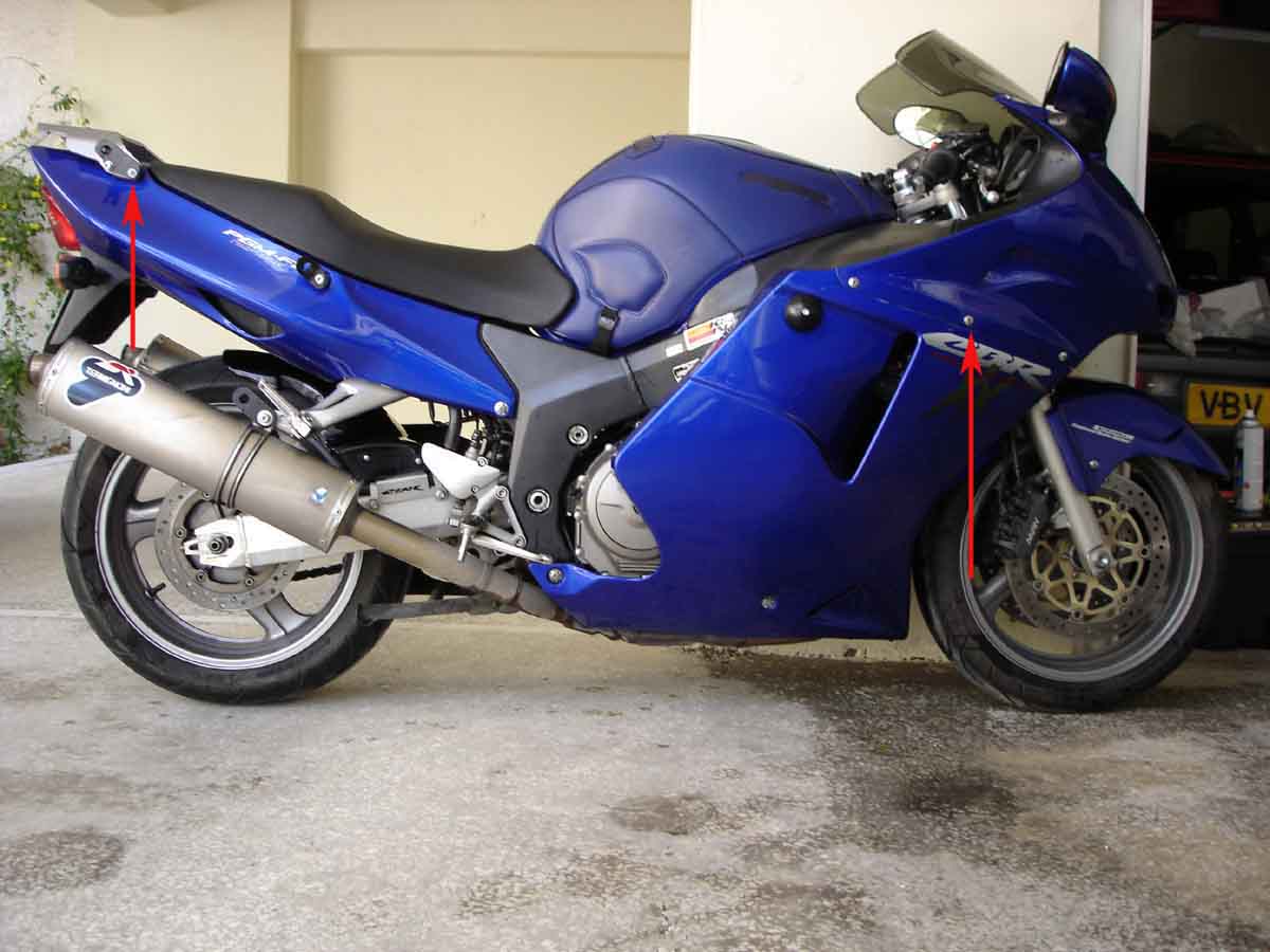

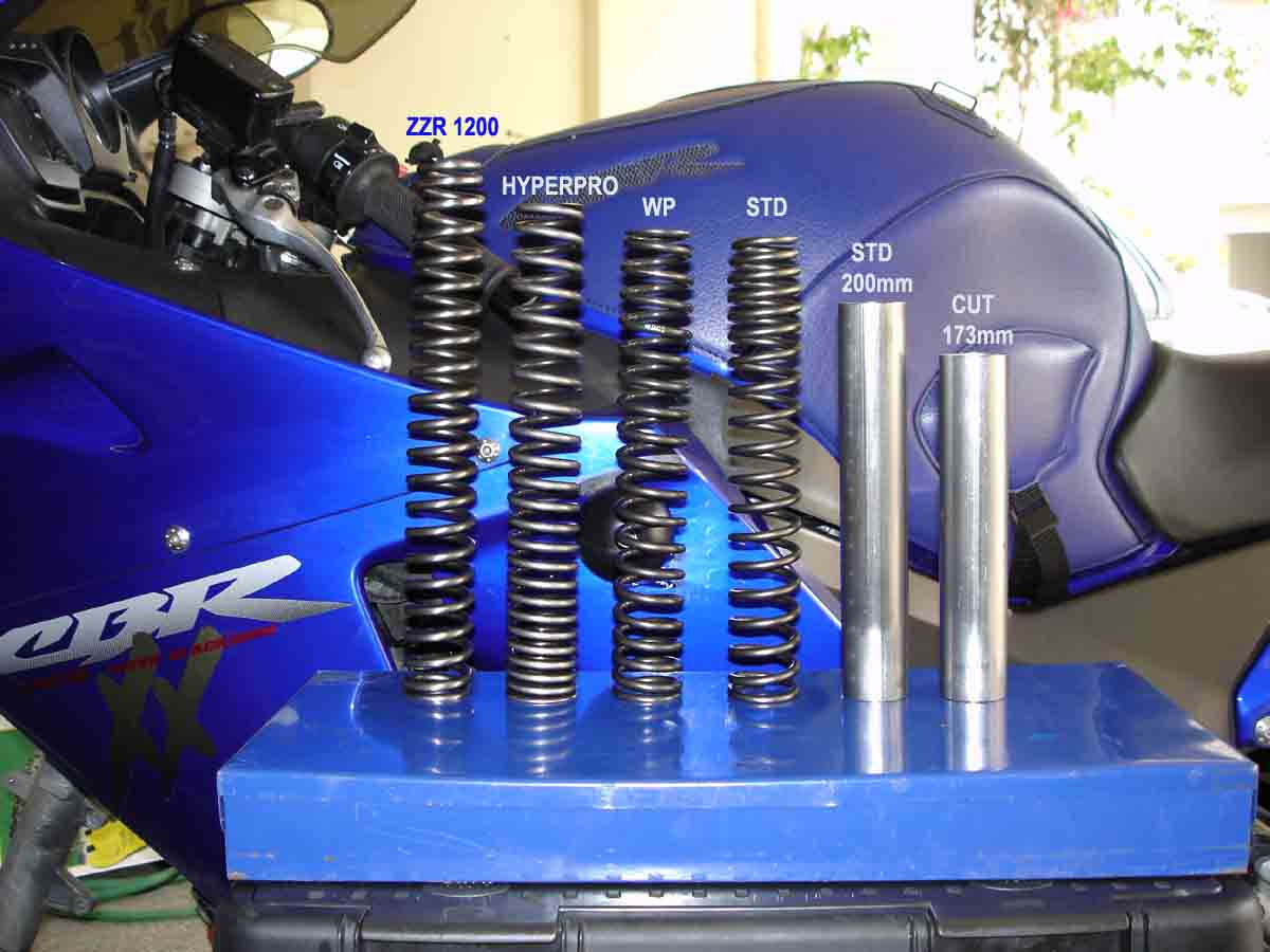

pug Posted March 5, 2006 Share Posted March 5, 2006 The zzr springs are now installed. Before starting I gave the bird a good wash and before starting dissasembly I took some measurements. I measured the ride height fore and aft. My suspension settings wer Hyperpro springs at the front with forks 46 mm above tripple clamp, where at the rear is -same length with std- WP shock with a 18 kg spring with 14 mm preload and 4mm shimming. In the front I took as datum point the distance from the top fairing's middle bolt to the floor, while at the rear I used the rack's front bolt. Since I didn't have any helping hand, I put the bike to the wall as upright as I could. Front was about 81.9 cm and rear 103 cm. One thing I forgot to do was to check my tire pressures. Because of the washing might be a couple psi down. Last time I checked them was last Monday (42 psi). Then I took the forks off and got the springs out of them. Also I had a second set of spacers which I had cut to 173mm when I tried some preload adjusters. In the photos you can see all of my springs-spacers collection: After replacing the used oil with TORCO SAE 10 at 140mm, I put the ZZR's springs with the shortened spacers. Combined lenght is 443 mm while the std combination is about 433 mm. That means that I have 10 mm preload over std. While compressing the right leg before puting it on the bike, I noticed a crieking (is that right?) noise. Strangely, the left leg wasn't producing any strange noises. I pulled the spring off and I couldn't see any signs of contact with the leg. One thing that I noticed is that the lower I.D. of the ZZR spring is smaller than the other's. After putting the forks onto the bike, I did the ride height measurements. Well at the front was about the same but at the rear was almost 1 cm lower. The only technical explanation I can give is that weight distribution was changed. Or I didn't put the bike to the wall as in the initiall measurement... Ridewise, my first impressions (about 15 miles mostly 2-up) is that the bike rides higher at the front but compared to HYPERPRO it rides better over potholes and bumps. I increased afterwards the 'fork above tripple clamp' to 47 mm but I only rode it around the block. I think that my next step will be to shorten the spacers 10 mm. Quote Link to comment Share on other sites More sharing options...
