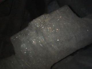

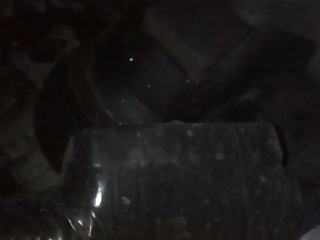

Here you go, pulled these pics off of bird#3. If you pop the filler panel off the left side of the tank and look down at the harness, that's where you should see this big square lump. Picture 3 shows you the throttle body boot clamp bolt as a point of reference. So it's actually just behind the engine, not beside it, like I originally thought. Like I said, it's been about 10 years since I had to bypass it on the dragbike. Sorry for the insanely small pictures, I had to take these with my borescope.
It's been a long time since I had to do that repair, but I'm pretty sure it's in the main wiring harness, inside the left rail (clutch side) somewhere near where the coil bolts onto the airbox. I stumbled upon it chasing corroded wires in the dragbike and it is nearly identical to the one for the grounds, which is back behind the battery box. IIRC, the ground one is brown, the power one is green. Both are taped up into the harness.
Don't know what year bike you are working on, but if it's the ground connector corroded you're going to be pissed. And if it's the positive connector like all my 99's have (identical to the ground one but all hot wires, located on the clutch side frame rail by the valve cover) you're going to be even MORE pissed as you have to pull the tank AGAIN.
