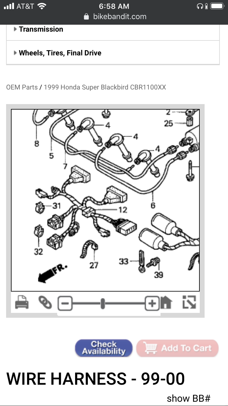

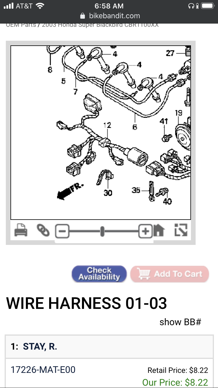

  14. A post on going from analog to digital. https://www.cbrxx.com/threads/dash-upgrade-99-to-05.9447/ After reading it, I wonder if I just need the cluster, temp sending unit, wiring sub assembly, and thermo switch from a '99-'00 to put into an '03
  15. I've got the same conversation going on at the other forum https://www.cbrxx.com/threads/change-cluster-from-digital-to-analog.49673/#post-639529 The mention of the analog using two sensors, one for temp and another to start the fan has me going deeper down the rabbit hole of figuring this out.
  16. lol not quite. I am seriously considering an '03 and have eyes on a decently priced '99-'00 instrument cluster and the sub-wiring assembly. In theory, I could use a '99-'00 temp sensor? Or are they different plugs?
  17. 6-7 years ago we got word from my dad and uncle that us cousins had an aunt we didn't know about. They had been contacted by a lawyer that was retained by a woman who was adopted in the 40's. They met her and did their own research before telling us about her. Allegedly she was the daughter of my previously deceased grandmother and their half sister. A few months later I bought a 23andme kit and a few weeks later got the results. Who was tagged on there at 10% related and likely my aunt? That woman.
  18. So, if I had a ‘01 or newer bike I’d have the engine temp sensor, and that installs into the ‘00 or older cluster?
  19. I see what you’re saying now. I wonder if a person would have to make changes to the plug that connects the sub assembly. For the temp sensor that’s mentioned, is that a engine temp sensor or air temp sensor?
