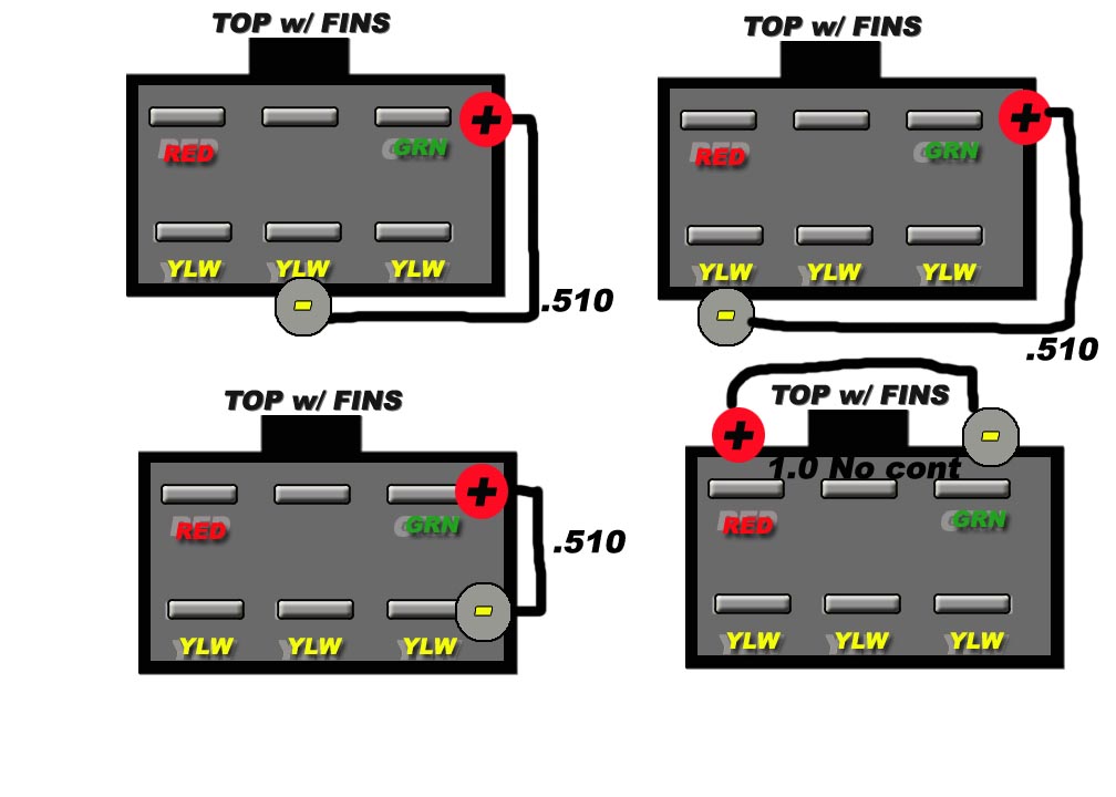

Thanks for checking Keith! That is what I needed to know. I checked the three yellows against a ground at the R/R plug (not really the plug cause its burnt, but from the wires never the less) and I dont get any continuity or resistance (I switched the leads to make sure). The book shows that the standard is .22-.26 ohms but then states that there should not be any/no continuity. I don't have continuity. I checked the three yellows against a ground at the 3P white plug and I dont get any continuity or resistance (I swithched the leads to make sure). The book shows that the standard is .22-.26 ohms as well but then states that there should not be any/no continuity. I don't have continuity. At this point I am thinking I am ok as far as Stator and R/R. I can't adjust my voltmeter to go any lower than 2000 ohms. Would a bad battery cause the short in the red wire... enough to melt the plug?
Greetings, The + lead to my R/R somehow touched/burned/overheated and came in contact with one of the yellow wires in the plug. So I have a big crispy plastic mess! I want to see if the R/R is still good. If someone has the Yamaha R/R and could check resistance for me, I would greatly appreciate it. Attached is a jpeg which shows what I am looking for and the measurements that I have on my R/R. I have my voltmeter set to Resitance @2K I am off to check resistance on the wires them selves. I need to figure out what caused the short. If you all have any suggestions, please let me know. Thanks! Kelly PS I have a 1997 Honda Blackbird. The Yamaha R/R was replaced about a year ago and I have put about 5k miles on the bike since the R/R swap with no issues until today.
