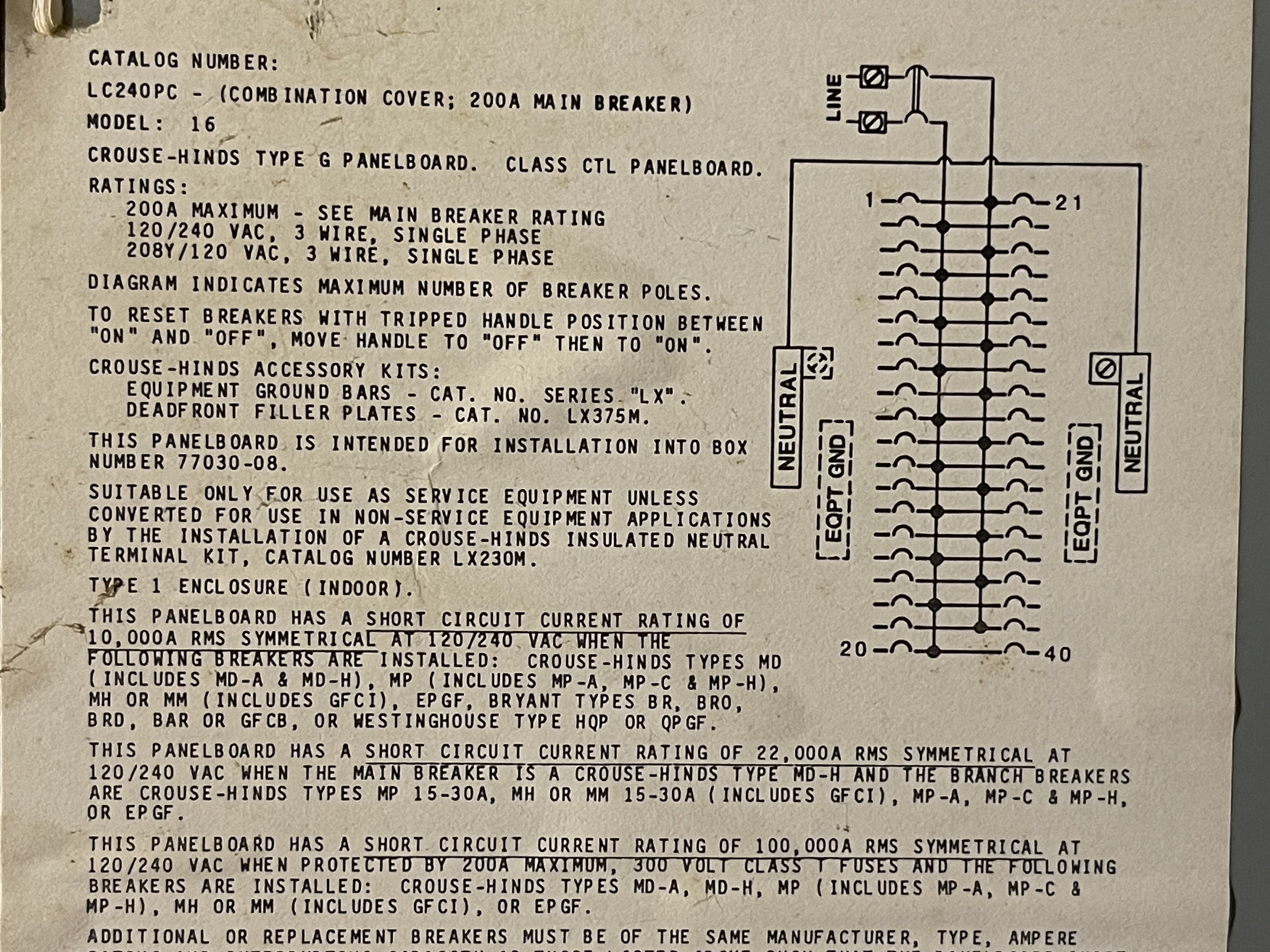

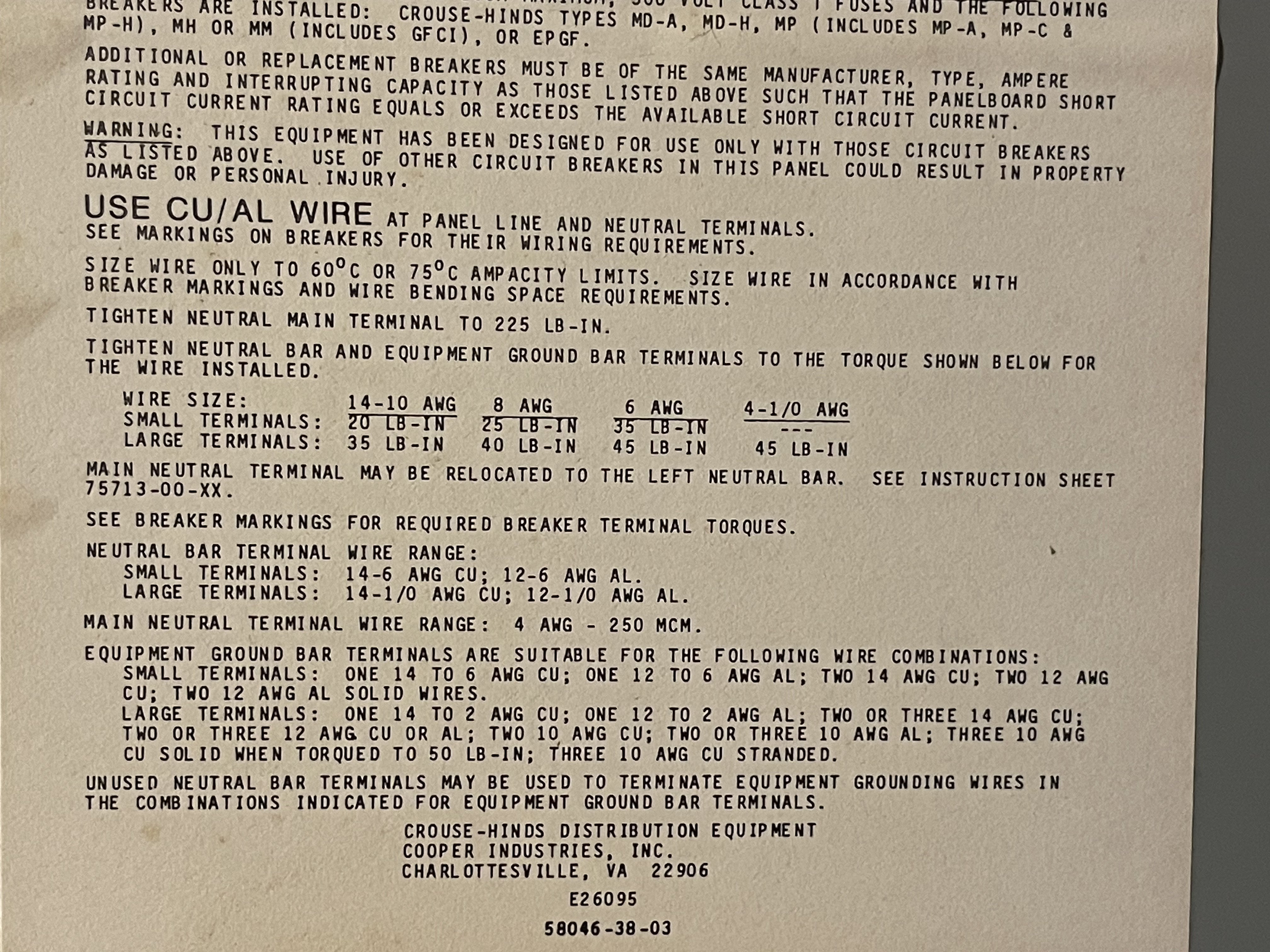

  18. 4 hours ago, SierraKLR said:
    Surge supression devices are rated in kA, not AIC.  Addressing Surge per breaker is non effective given typical home wiring.  Use a whole house device or address at the load/plug level.
    AIC rating is for electrical equipment based on the fault current available on that circuit.
    The breakers in your panel are 10,000 AIC rated, which is typical for a residential service.  10,000 AIC is the current minimum rating at 120/240V of all the major manufactures for Loadcenters.  (Eaton, Siemens, Schneider Electric & GE/ABB
    You must provide equipment to or above the AIC rating.  Calxx is wrong, exceeding the AIC rating of your service is not an issue, but adds no value.  Providing equipment rated below your AIC requirement is not allowed.
    I do this for a living and have for 35 years (Schneider Electric = Square D Company).
    Hire someone that knows what they are doing as you do not.
    This is why I'm asking here.  The electricians in my area either don't install whole house/circuit surge suppression devices or have a lack of experience doing so.  I was willing to hire an electrician, but I want one who can recommend the products that meet my need.  I don't want to pay a guy to come out only to demonstrate that he has no idea what he's doing in this situation.  Installation of these devices is something you can DIY with basic electrical knowledge.  Knowing which items are best for your application is where you need someone knowledgeable.
    The reason for surge suppression on the breaker is because they don't make plug-in 240v units.  The breaker-level application is for redundancy.
