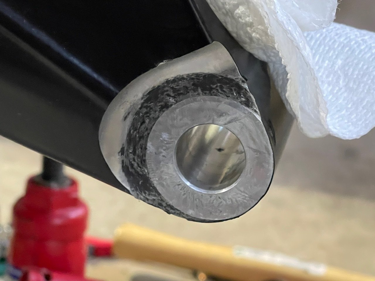

Okay...removed the bolt and redid it to 100 Nm.

Yes…clearly you didn’t read the PDF. The inside spacer was crushed…this led me to believe I over tightened the bolt. I’m consulting with other BMW owners, but the bolt should not need 100 nm of torque. The only source of information I have is the Haynes manual…which, at times, is a bit lacking in accuracy. Indeed, it says NOTHING about working on the rear drive aside from changing the fluid. It’s very possible I was using the torque value for the wrong bolt. BMW is a tad notorious for not putting out DIY resources for repairs. Other than routine maintenance, they want you to take it to a shop. You can no longer buy service manuals, and aftermarket manuals are not comprehensive. Bearing failure is inevitable, so why the manual addresses the front wheel but not the rear is troubling. Well, I do have a bootleg repair DVD, but I’m not sure how current it is (whether it covers my model year…although many models for several years used the same parts in this case). *** Checked the DVD. The bolt does call for 100 nm. Not a biggie. It’s easy to tighten it more with the bike reassembled.

Well, it’s back together. The manual I have says the pivot bolt is torqued to 100 nm. No way…I suspect that’s what caused the damage. I went to 35 nm and stopped…using thread locker on the bolt. Attached is a PDF of the repair job. https://app.box.com/s/75lxnruz1hy0lm63v5mgvux0cspznz9e

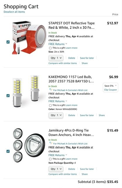

Stuff for the new trailer. I have two of the anchors from Carlos, but 4 more means I can place them in the corners and the other two where they would be the most useful mid-trailer. The taillights aren’t anything impressive, so brighter LED bulbs.

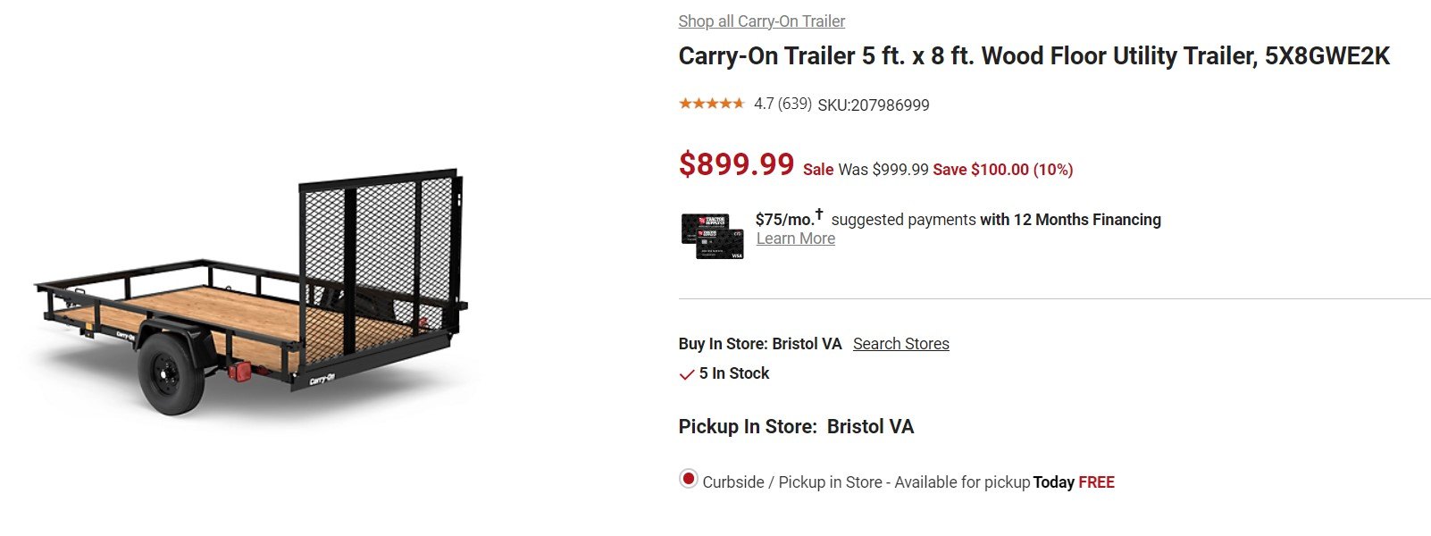

It's under 600 lbs. Spring. FWIW, U-Hauls are rated for 55 MPH (per the manual). We've all seen them go faster than that.
Let the ridiculing begin.... FWIW, I'm buying this largely because IF I need to take the zero-turn mower anywhere, I'll need it. I might as well use it for the motorcycle too. The folding trailer would be worth it IF I could strap the BMW down symmetrically, but the position of the exhaust can and the shape of the rear drive prevents that. I also don't care for how the folding trailer DOES NOT have springs separating the axle from the rest of the trailer. I don't know if the lack of a spring causes damage on long hauls, but I've NEVER had an issue trailering a bike in the back of a pickup truck or trailer with a sprung axle. I could see about an upgraded folding trailer, but since I need this for the mower, at this price I can't ignore it as the better option.

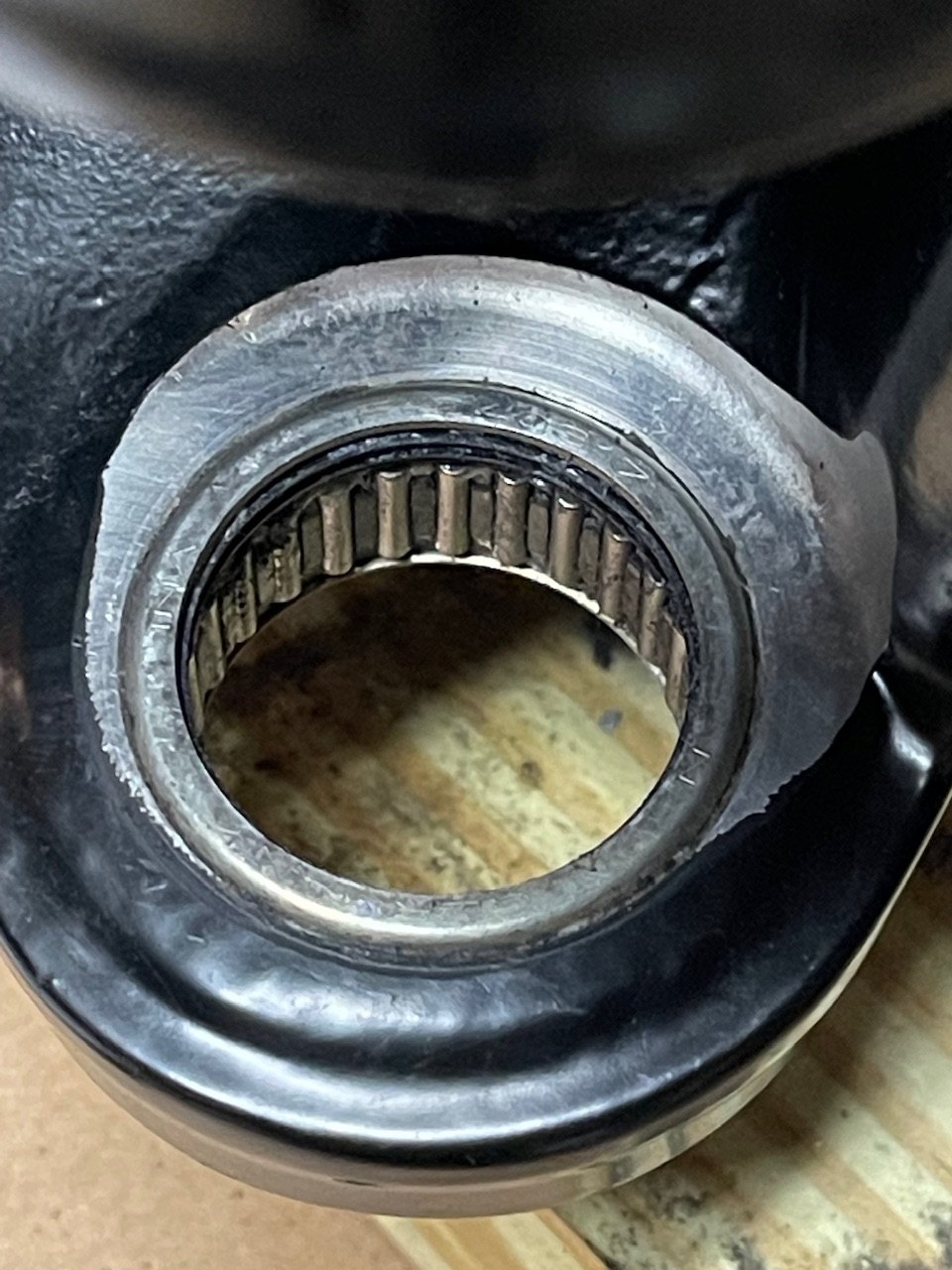

Well, I was fortunate today. I bought my DR field mower from Bluff City Cycles. Looking for motorcycle shops in my area, this came up. Got my parts in, so I brought the bearings and the drive assembly in to see what he thought. He didn't have that many more tools than I had, but he was much more familiar with driving these out and installing new ones. Total cost...just under $33. I can start putting it back together this weekend.

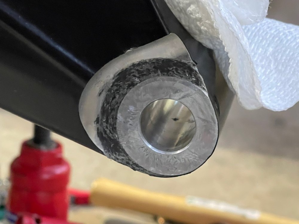

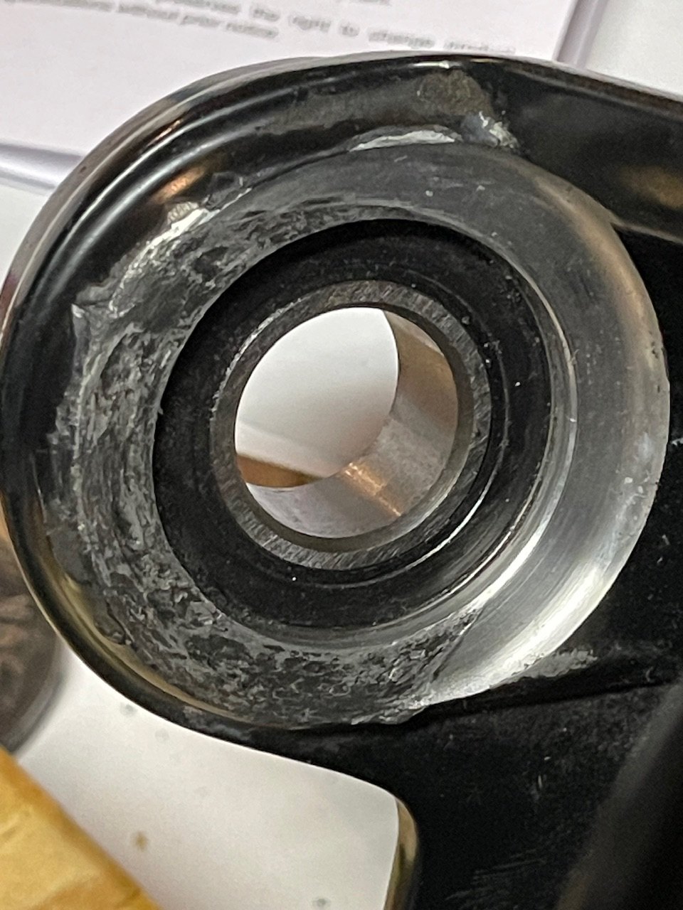

I could use some input from those who have BMW shaft drive bike (or have worked on them). What causes the marring in the following pictures? Is it normal? Can it be “cleaned up?” Normally I’d not give it a second thought…presuming this is the result of the bearing failing, BUT I want to be sure it won’t pose an issue going forward AND it wasn’t the cause of the failure in the first place. These are from the side with the failing/failed bearing. By comparison, here’s what the other side looks like…clean on both the drive unit and the driveshaft housing.

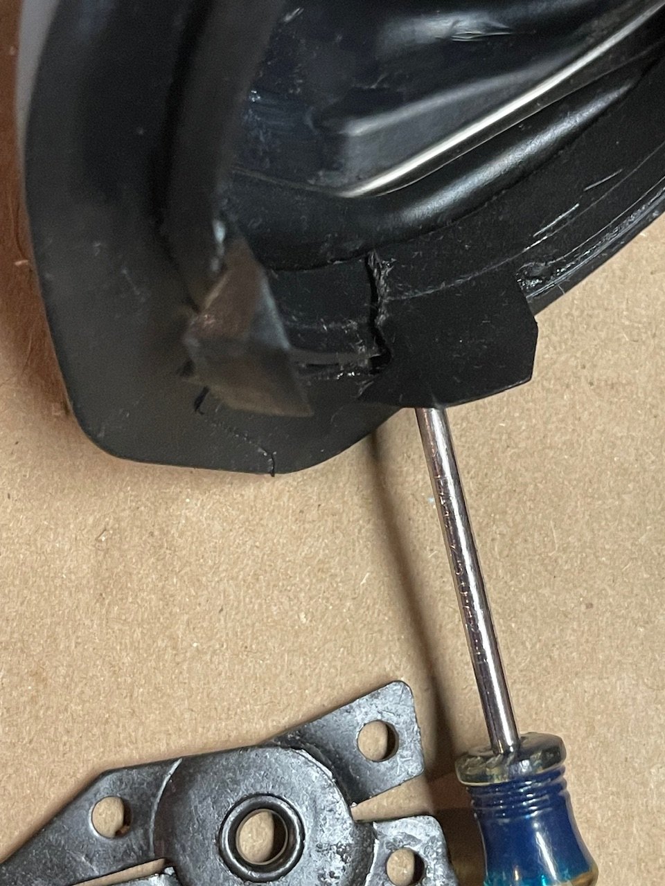

The tale so far. I have parts on order. The first should be arriving today. There’s a shop in Tennessee where I bought my DR brush mower. He does motorcycle repair, so Thursday (parts or not) I will swing by and ask if he’s set up to replace the bearings. This would be simplest. If that isn’t so, I’ll call the BMW shop in Knoxville and see if (1) they will use the parts I already have (BMW branded) and (2) give some commitment on when the job will be done. I’d want the unit back by the end of April since I have rides planned for May. If that doesn’t work, a BMW guy in the Nashville BMW club will do the job. Down bit is that I’ll have to take it in person. Yes, I could UPS the unit, BUT to ensure I’m covered should it get damaged or lost in shipping, I have to insure it for $3,000…making the drive there and back (even two trips) cost effective. On the bright side, I think I found the issue with the boot. The tabs that hold it in place are on a plastic ring bonded to the boot itself. I found a break in that ring that negates the pressure it applies once the boot is in place. So, a new boot is on order and should arrive soon.
