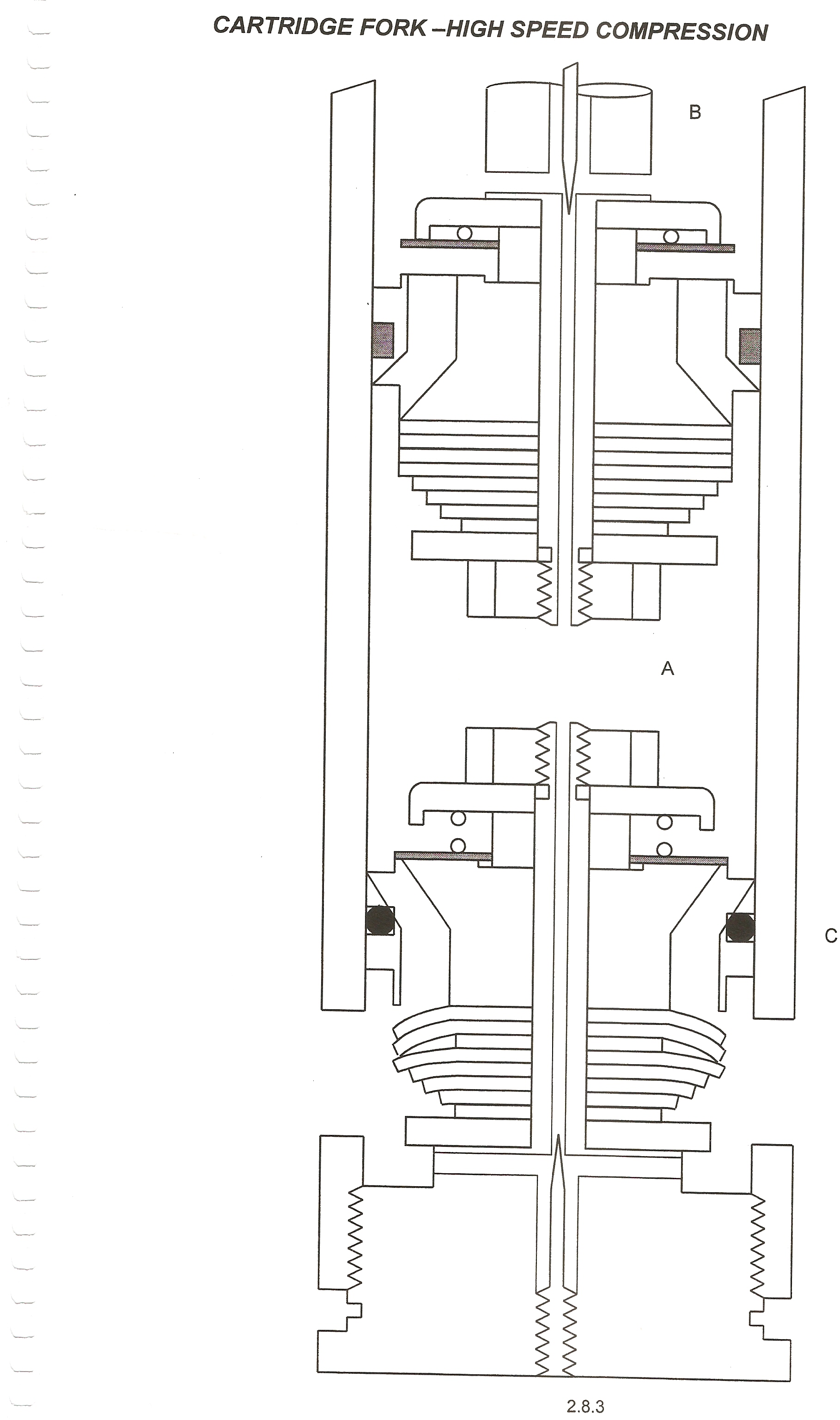

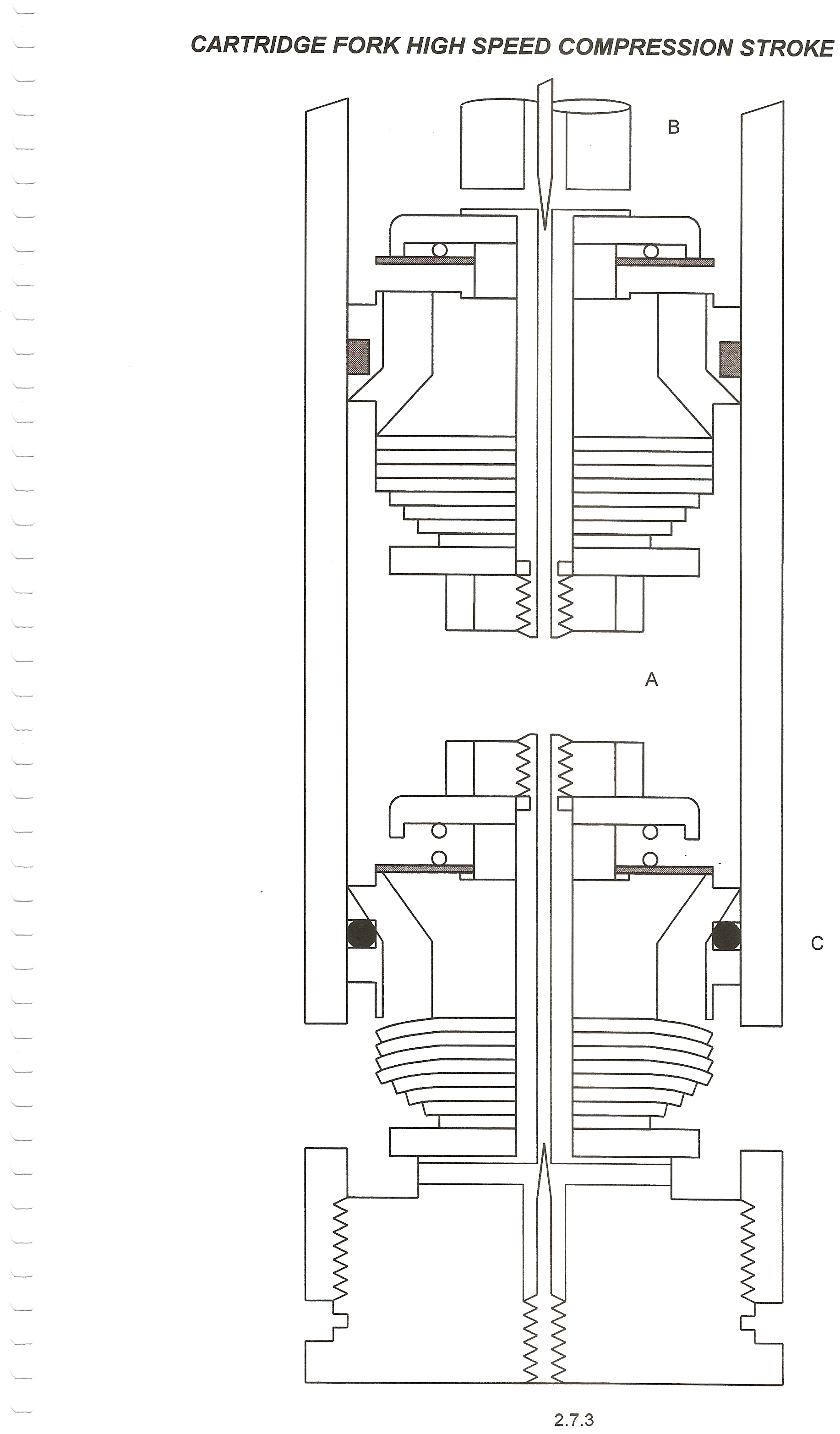

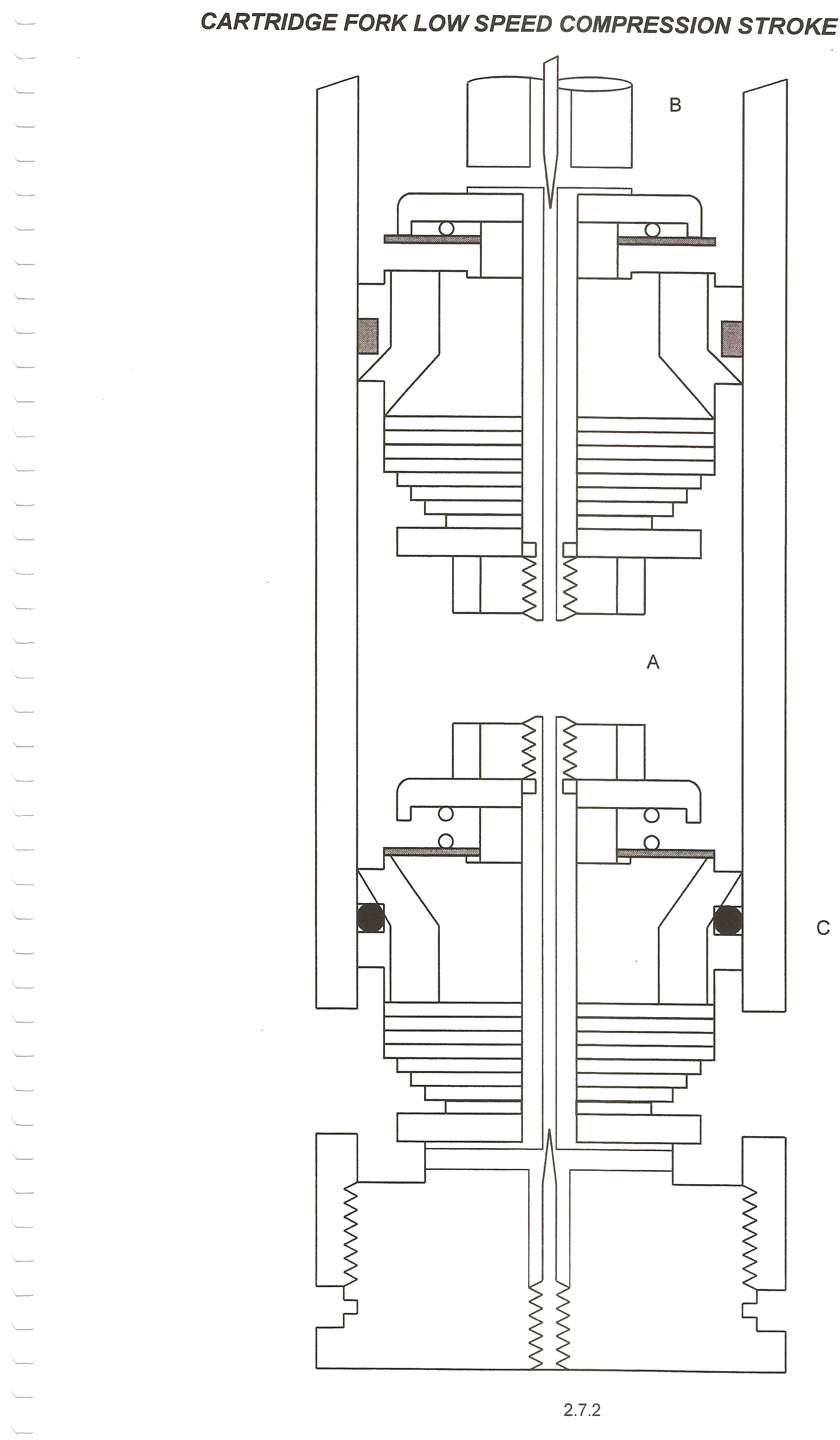

  18. Now if you look at the high speed stroke (big, nasty, square edged bumps) pictures you can see a little more takes place. Note how the shims get tweaked on the highspeed stroke.

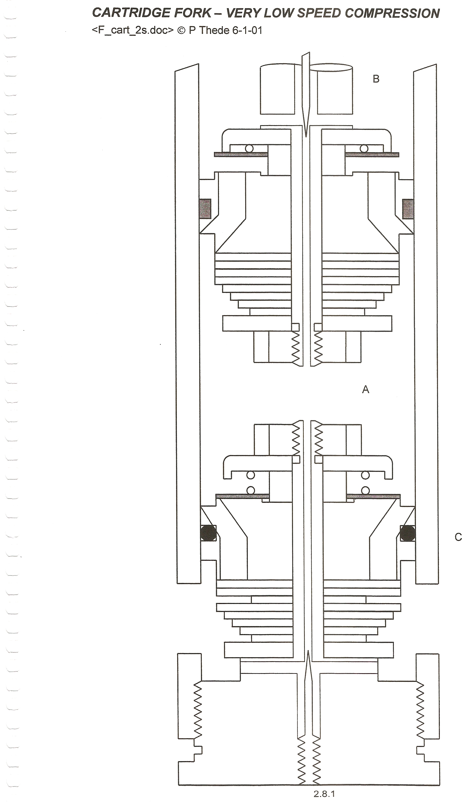

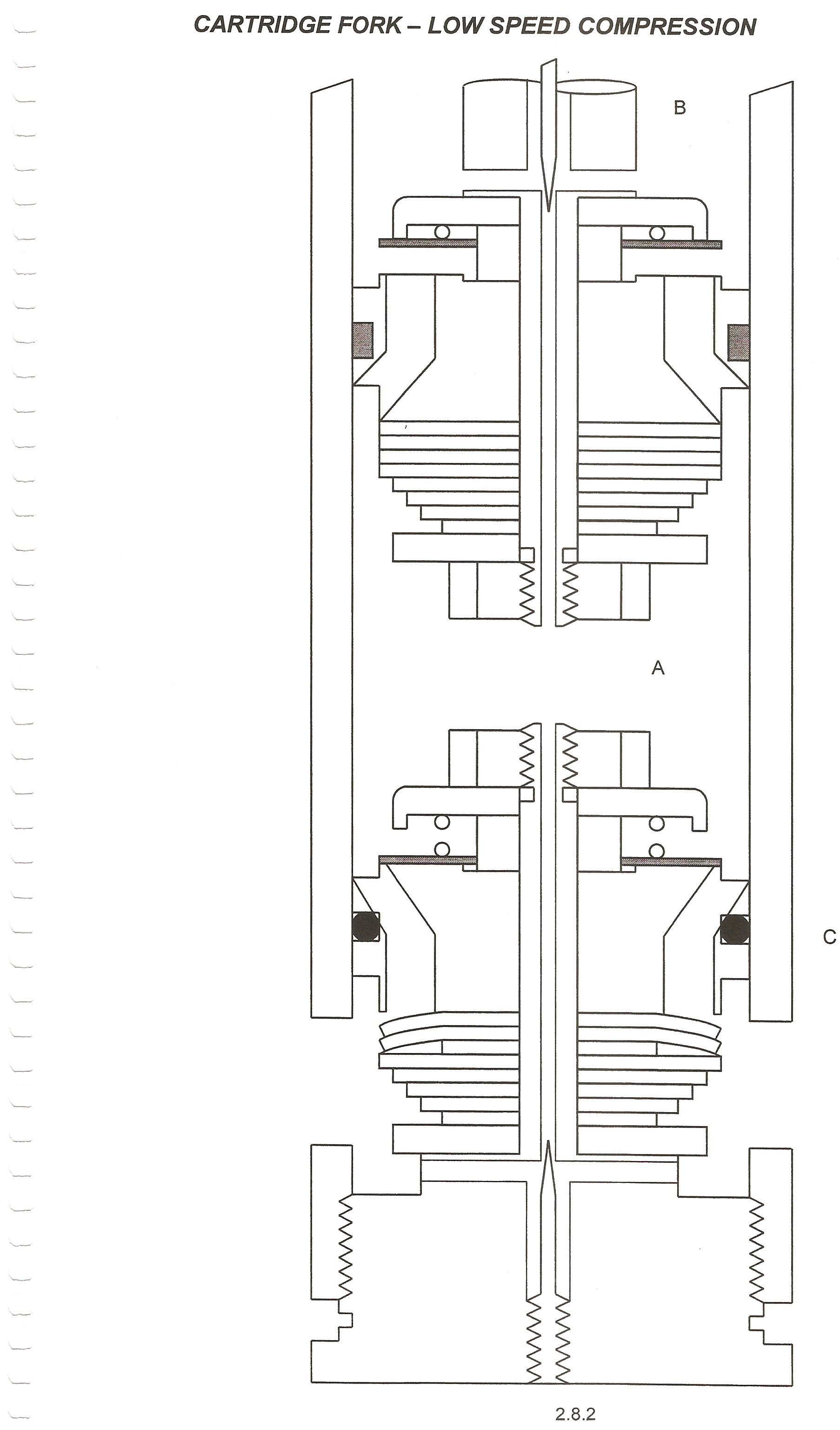

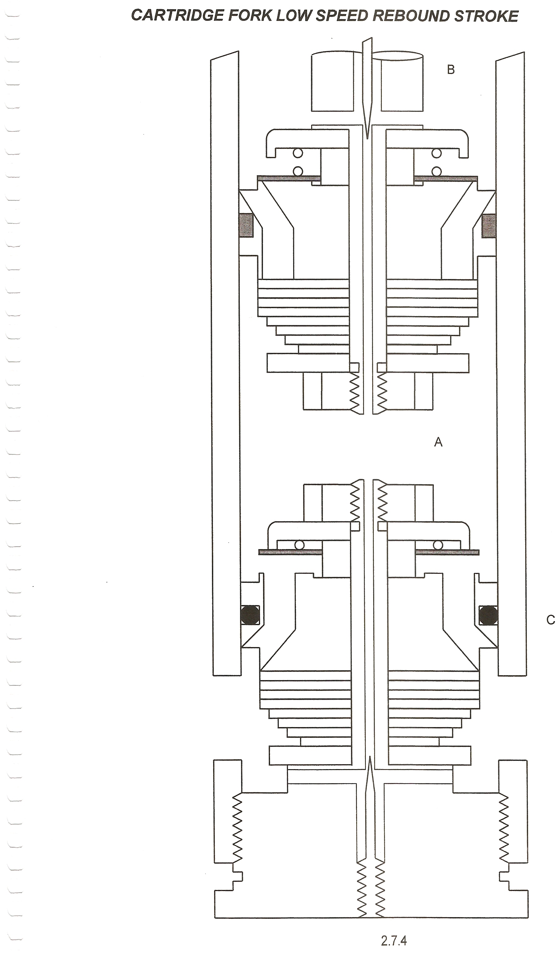

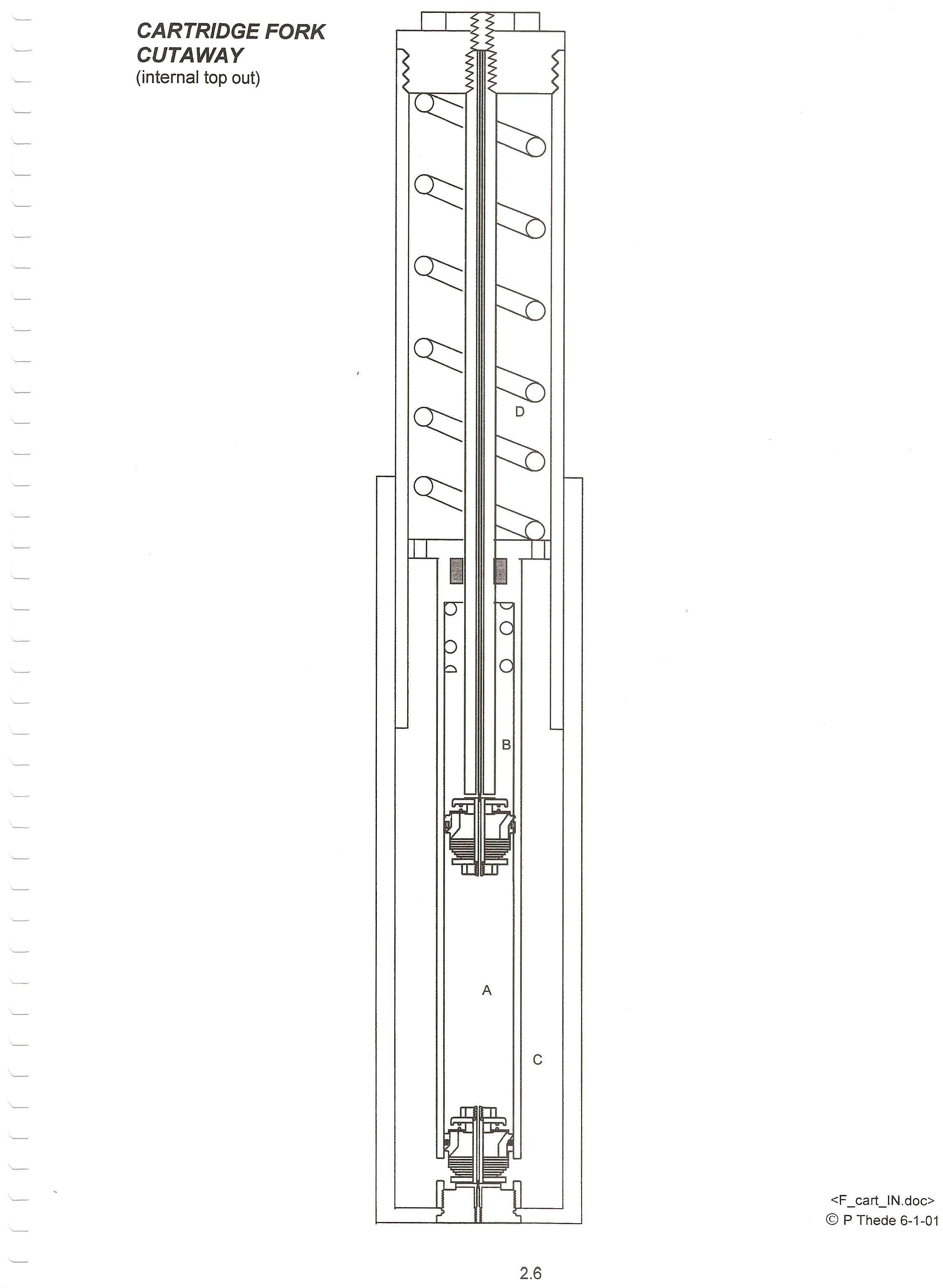

  19. Our stock compression and rebound strokes look similar to these. You my have to look at them for a bit to see what happening as this is the low speed or small bump reaction. But Paul Thede (all honor, glory, and praise be to him for these) has been kind enough to label the oil containing parts. The Compression Stroke flows from A to B to C to D (D - remember is the portion of the fork above the cartridge where the spring is) The Rebound Stroke flows from B to D to C to A

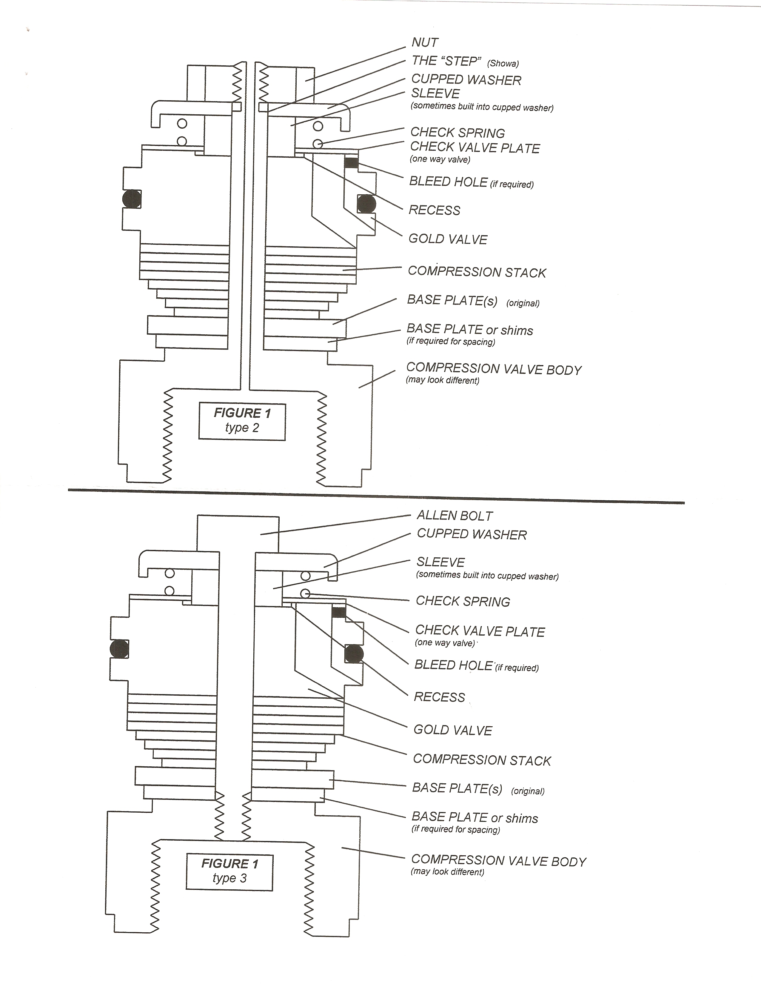

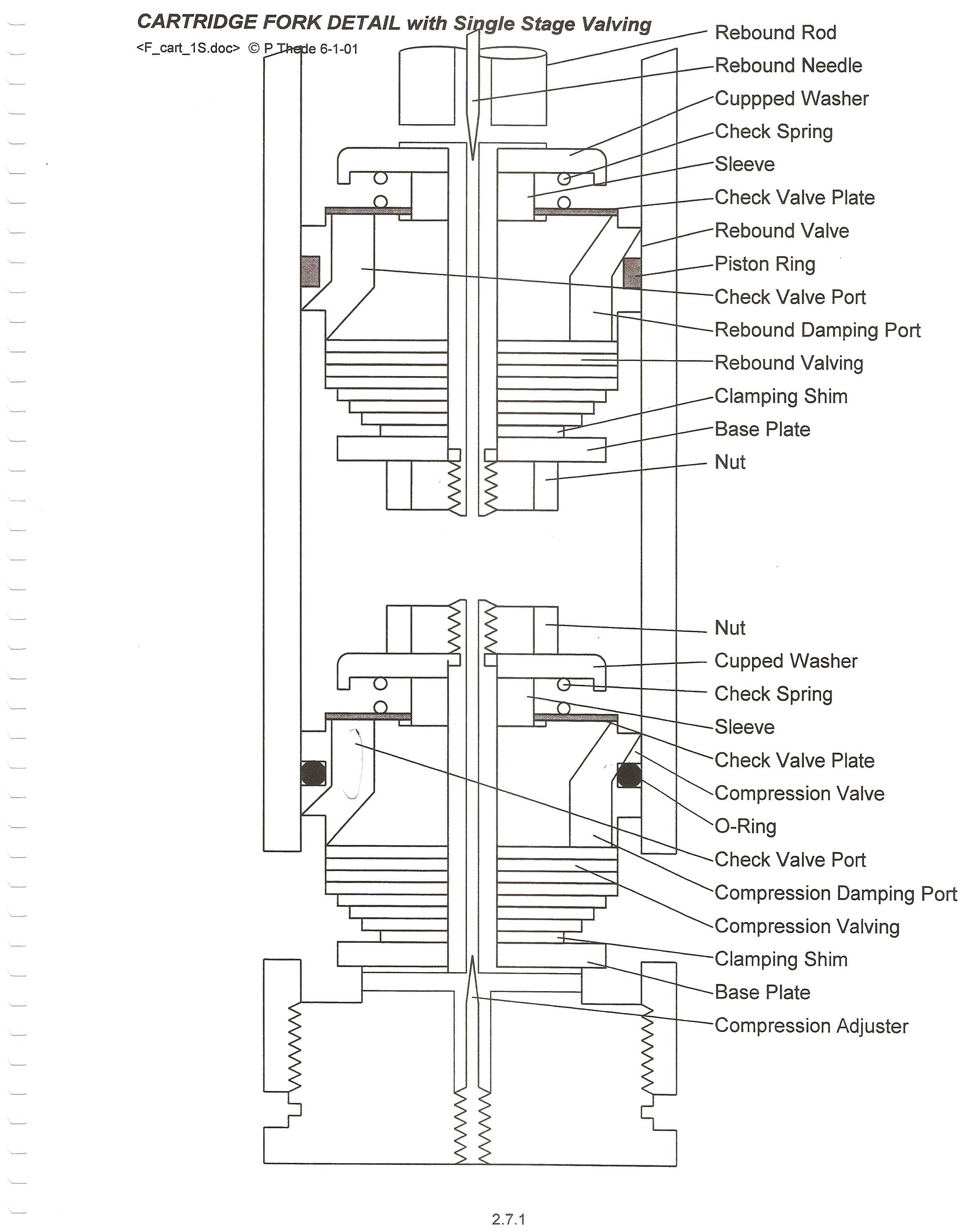

  20. If you bought gold valves then this should look familiar as it is from the instruction sheet. For reference lets look at the overall cutaway too. keep in mind the XX is blessed with comp and reb valves that are not externally adjustable. So here is our Showa typical cartridge fork with compression and rebound valves all parts labeled.
  21. Yes I went beyond. I use 2.5 wt oil and shim like so: (4) .15x17 - Low speed damping .10x9 - spacer (2) .15x17 - Med speed damping .10x9 - spacer (2) .15x17 - High speed damping then the: 15 13 12 11 10 9 normal RT stack finish I used to be fatter and did a 5,3,2, L, M, H shim stack basically a C40 (even though one is not listed in the instructions) _________________ _________________ _________________ low speed damping for the small bumps (soory my indent did not work) _________________ _________ _________________ _________________ medium bumps pick up these shims _________ _________________ _________________ big nasty bumps hit this high speed damping area ______________ ____________ __________ _______ What is your fork oil level? How's your sag look? How big a pre-load spacer do you have in?
