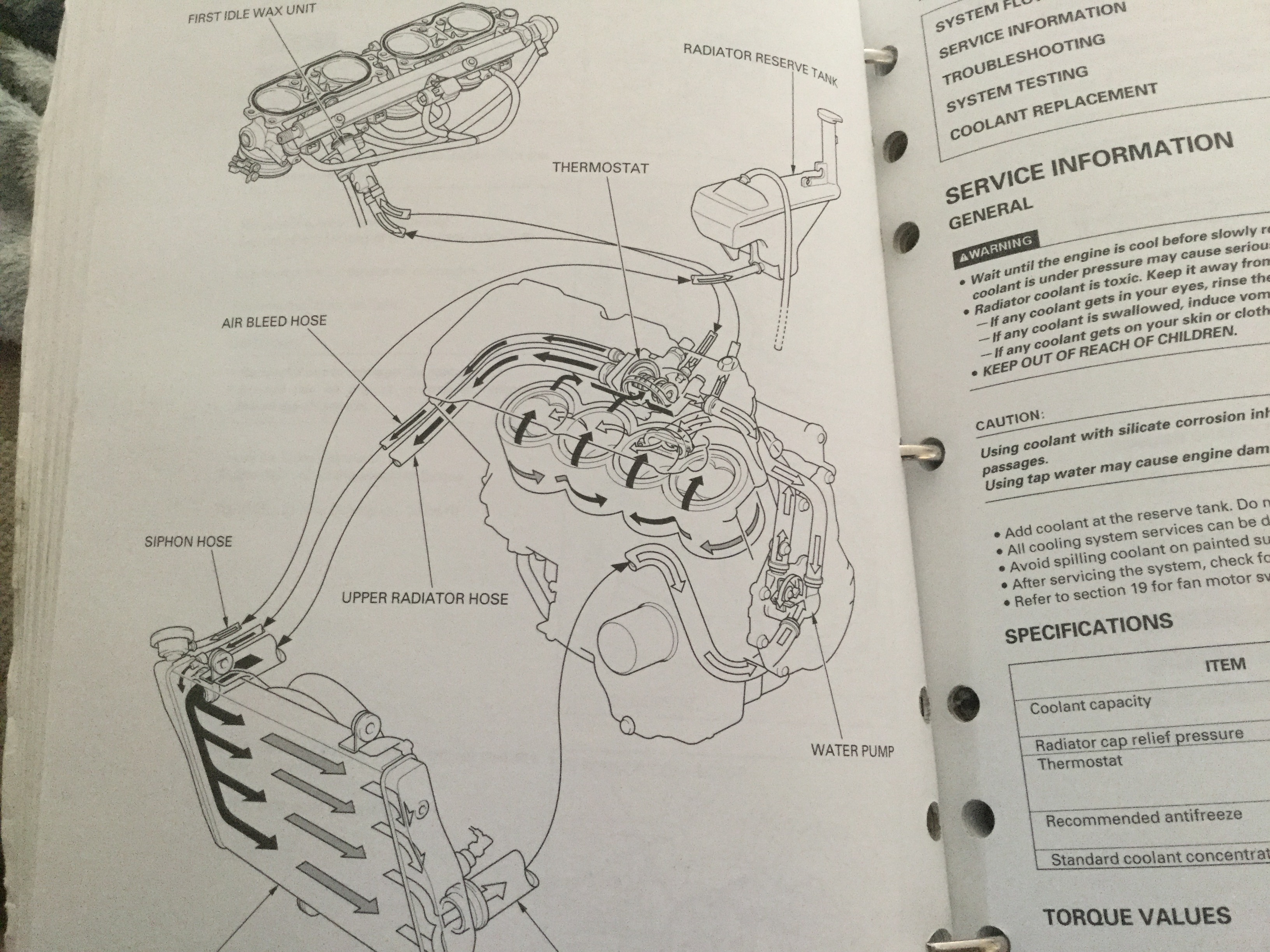

  1. First, I haven't done a complete drain, just a flush pulling the water pump drain and a lower hose. My 01 manual shows .84 US gallon capacity. Thats allot more than the .5 you say that you drained. Not a big deal for flush, but my reading on Evans says that you need all the coolant out. I would remove the radiator cap, to eliminate pressure build, and then warm up the bike to open the thermostat. You can then drain the coolant, and prevent it from being trapped behind the thermostat. I would probably remove a lower hose, and one to the wax unit too. You are correct, the manual talks about a block ( cylinder) drain. The picture sucks. Do us a favor and post a good picture when you find it. I would reach out to Philip, or others who have done this before finishing. Now I'm going for a ride to see how mine does with a new fuel filter.

  8. IF you got any liquid on the outside of the radiator, it will boil off as wisp of steam as it warms up. You can see the same thing after you take your hot car through a car wash. I would top the radiator, and take it on a couple mile ride with the lowers off and look again. If nothing, then let it cool and check the coolant level again. Hopefully your only chasing a ghost. Edit, if you really have a leak, the overflow won't help you. you must have a sealed system to pull a vacuum on the overflow bottle to return the expanded coolant back into the radiator as it cools. For leaks, check fluid level and top off the system at the radiator.

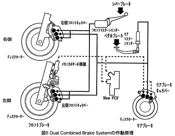

    Steve, After you pump up the brakes, does the pedal hold? No evidence of leaks anywhere? If so, I really think that a good bleed will fix it. Because this comes up often, I pirated a good write up and some pictures. The big thing about Honda's linked brakes is that there is no fluid connection between the front and rear Master cylinder circuits. The front brakes on the XX have three pistons per caliper. The two outer pistons are driven by the hand lever and bled from the top bleed valve on each front caliper. The rear brake caliper also has three pistons. The outer two pistons are driven by the rear brake lever. Then we add the linking. The center piston on the front brake calipers is driven by the rear foot lever master cylinder. It gets it's fluid from the rear brake reservoir. Bleeding of the front caliper, center piston is done using the lower bleed screw on each front caliper, and the rear master cylinder and reservoir. The rear caliper, center piston is driven by a third master cylinder that is mechanically connected to the left front caliper. But it gets the fluid from the rear reservoir. The rear piston is driven when the front brake lever is pulled while the BIKE IS MOVING. When the bike is moving, the left caliper rotates some with the rotor and actuates the third master cylinder. If the bike is not moving, there is no rotation of the caliper, and no actuation of the center piston on the rear brakes. This explains why we can hold the front brake lever, and do a burnout without dragging the rear brakes. The front wheel does not turn, so the rear gets no brakes through the third master. So after all this, My experience is that it is easiest to bleed the brakes with a MyeTvac style bleeder. I get someone to help me by keeping the reservoirs full. This way, I can pull a constant vacuum on each line, and get the air out. The rear master cylinder must not only feed the rear caliper through the short rear brake lines, It must also feed fluid forward through longer lines, and the third master cylinder, back to the rear caliper. That's a lot of places to hide air, and make the rear pedal soft. pirated bleed procedure another procedure with pictures
