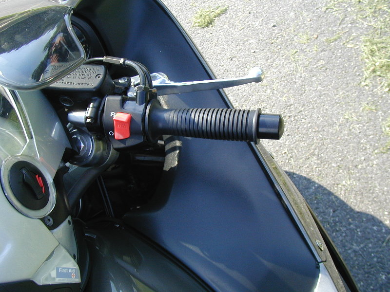

Best grips I've used thus far, BMW Sport Grips. The outward taper fits my hand well. [attachmentid=2546] Right: 32721458396 Left: 32721458395 $8.00 each at Chicago BMW

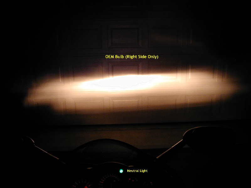

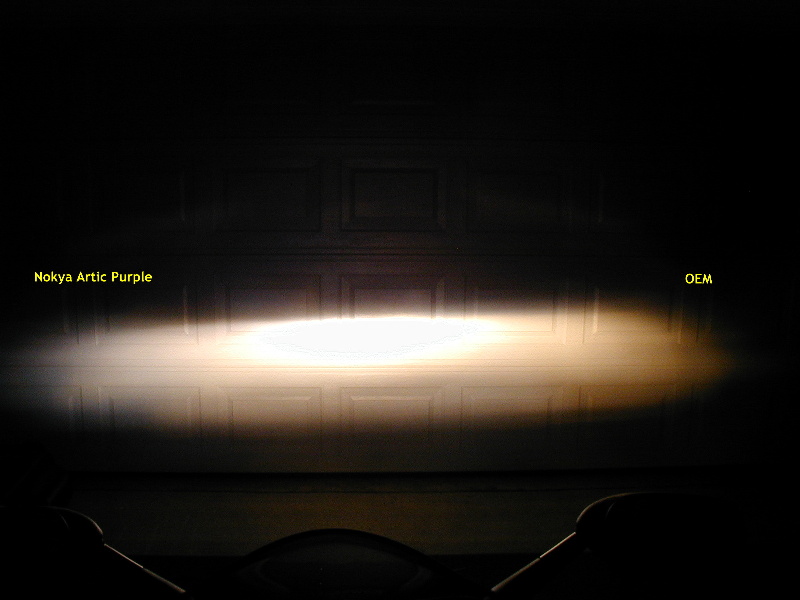

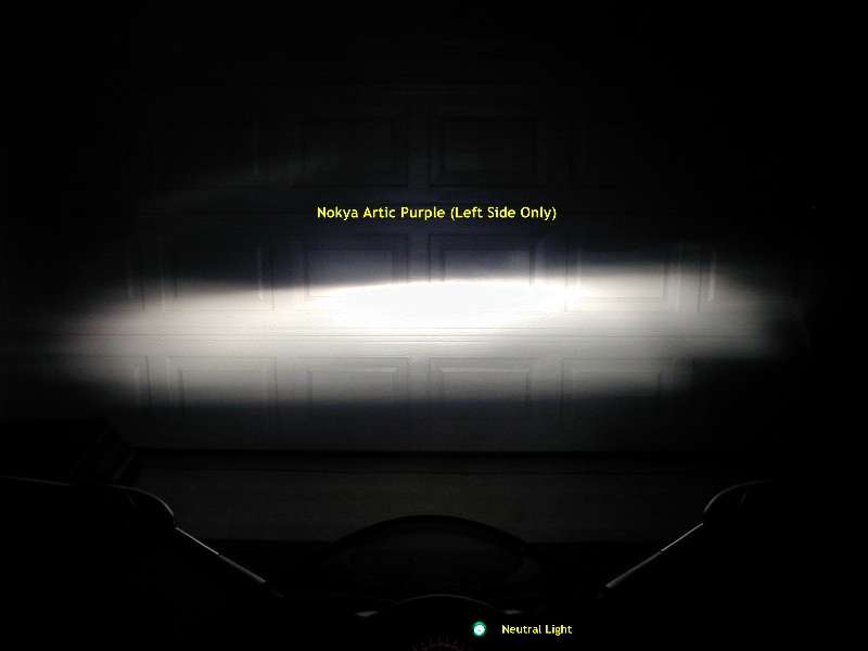

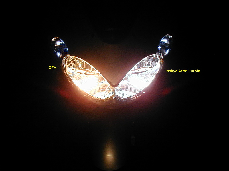

I recently changed the headlight bulbs in the ZZR from OEM to Nokya Arctic Purple, 8500K color temp. The dual headlights on the ZZR allows for easy side by side comparison. Yes I need to change the upper marker bulbs. I was trying to match the headlights with a pair of "super white" 194 bulbs. Obviously they aren't white or super. [attachmentid=1880] [attachmentid=1881] [attachmentid=1882] [attachmentid=1883] [attachmentid=1884]
