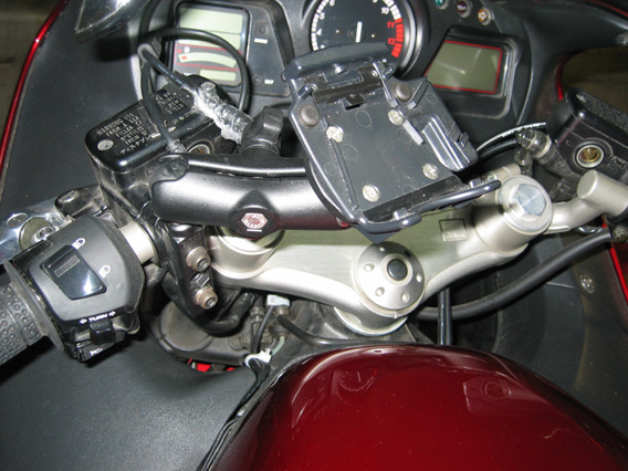

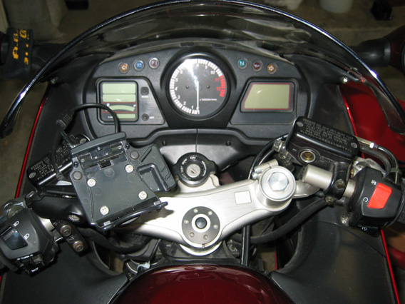

  1. I've got the Heli-bars with a Ram mount for the Garmin 2610 as shown in the above picture, but it is mounted to my clutch reservoir. It has two swivel points so I can maneuver it anyway I want. I check clearances at full left and right locks, then set it and forget it. I'll see if I can post the two pictures I took. Tony Edited: Clear of all gages. Direct connect to the battery with fuse in-line.
